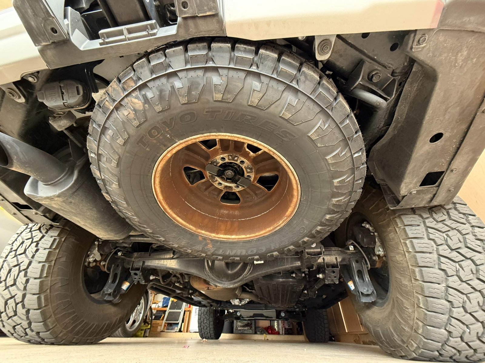

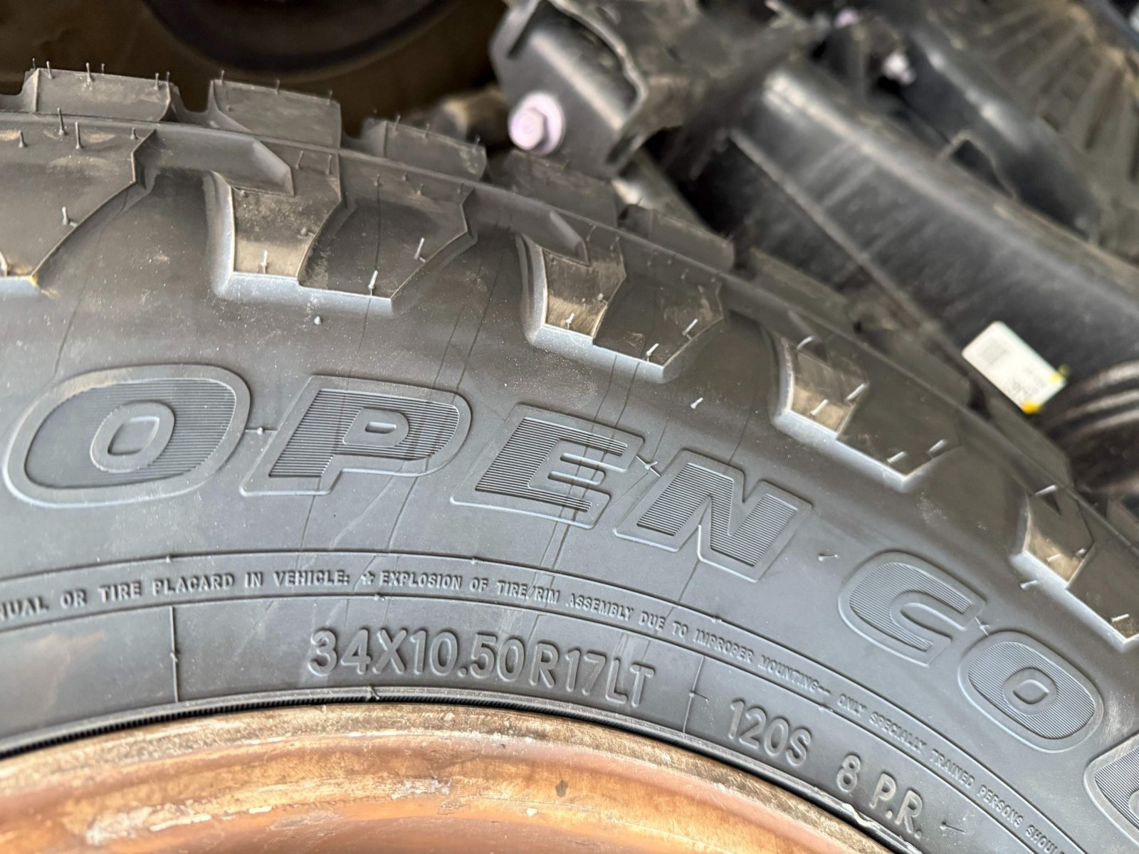

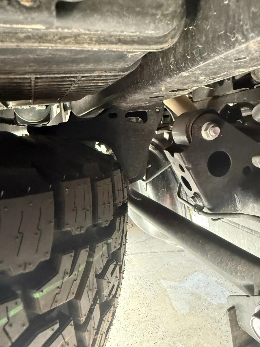

I fit a 34 x 10.5 x 17 and it legitimately fits - there is a piece, kind of a tab, behind the tire towards the axle that kind of holds the spare, and then the spare also has to clear behind the hitch and clear the back muffler. I can take more detailed photos but the 34 is pretty snug up against the forward holding tab.
I've heard others report that a 35 is just too big. Also note that a 35 x 12.5 will hang down vertically quite a bit.

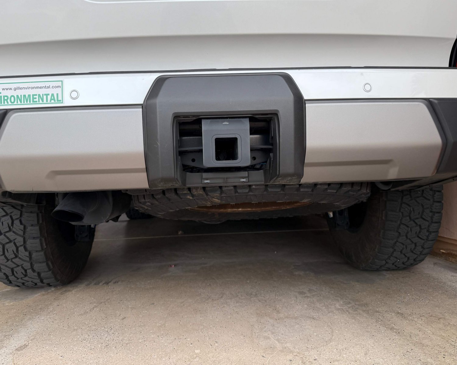

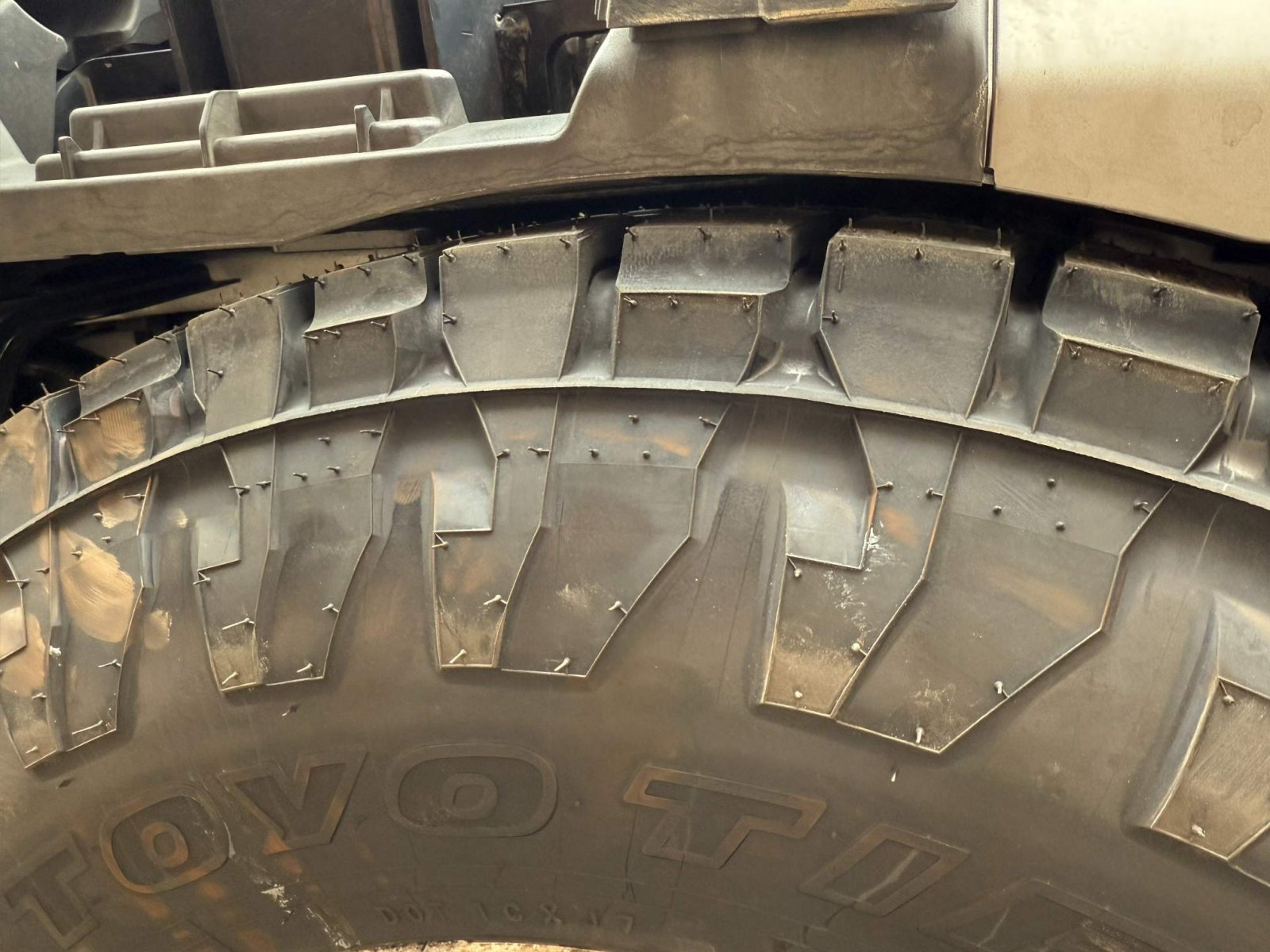

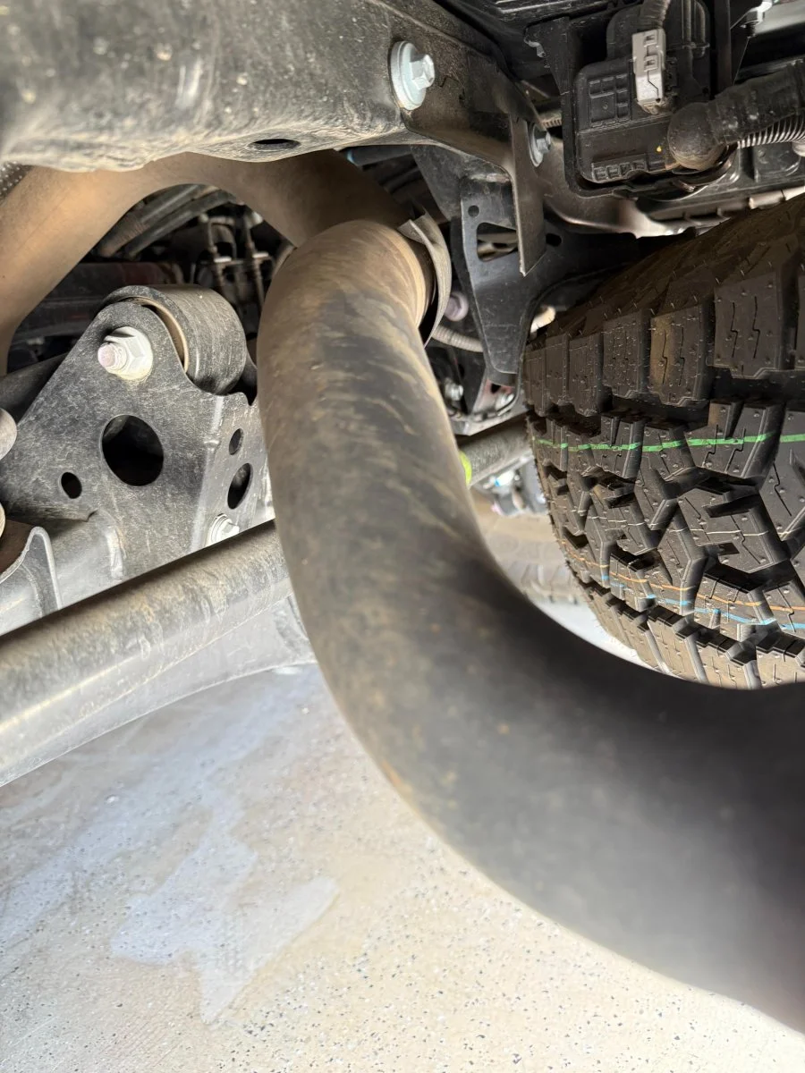

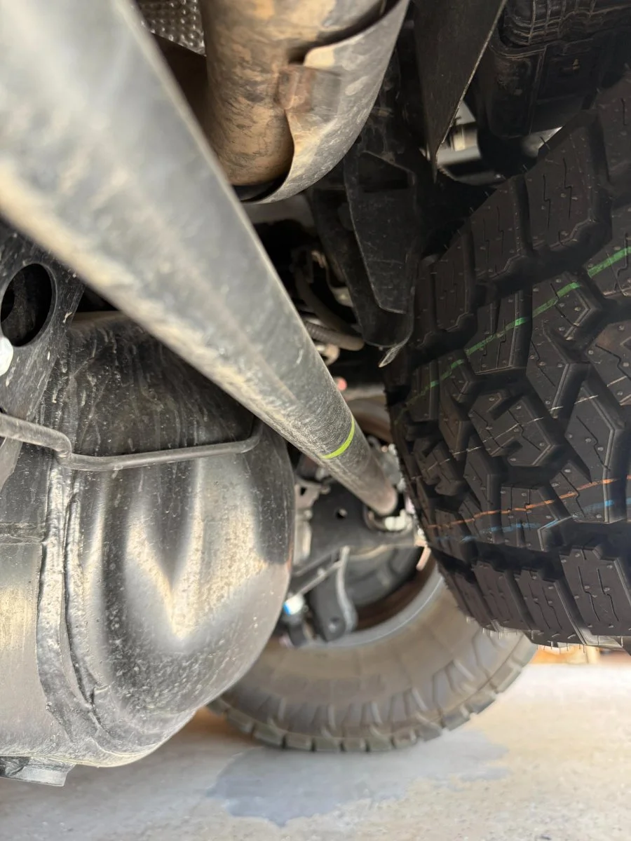

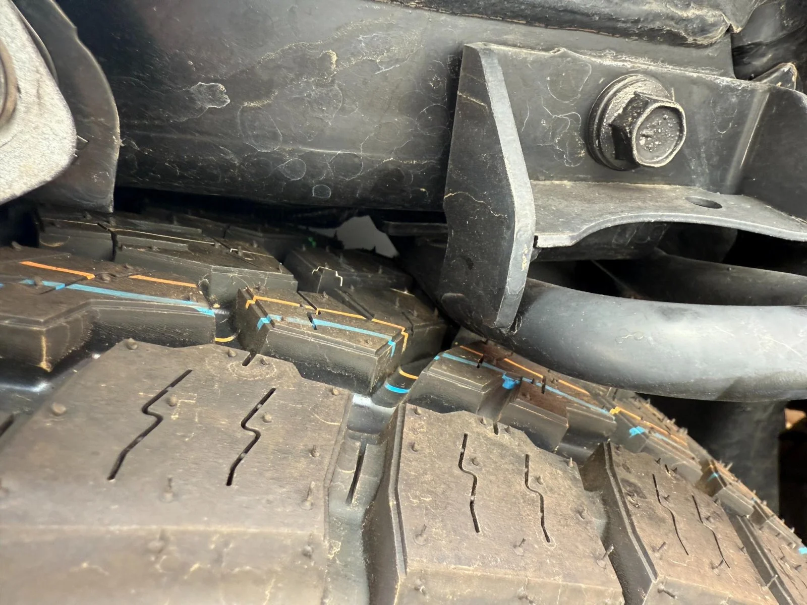

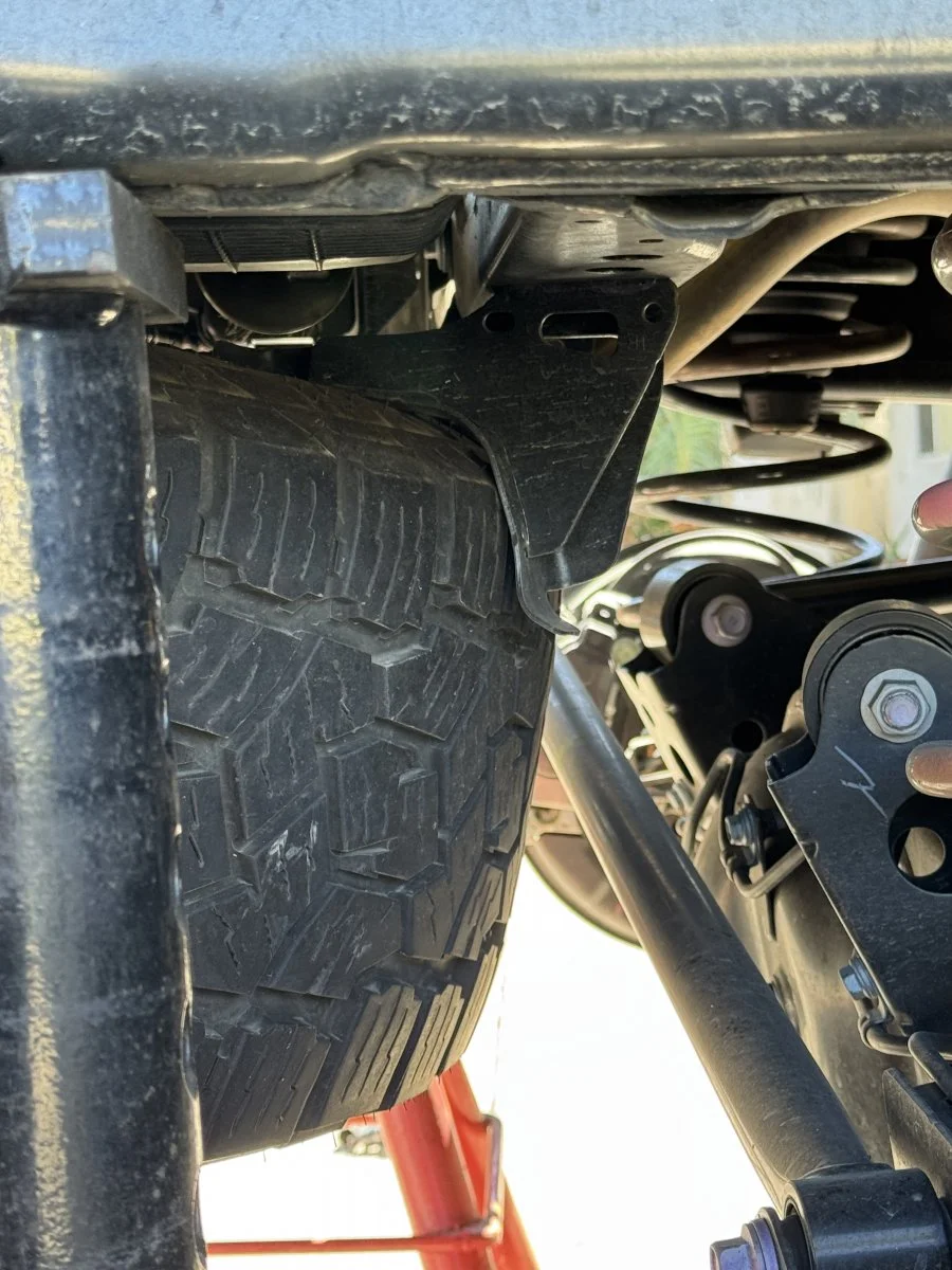

Here are those photos.

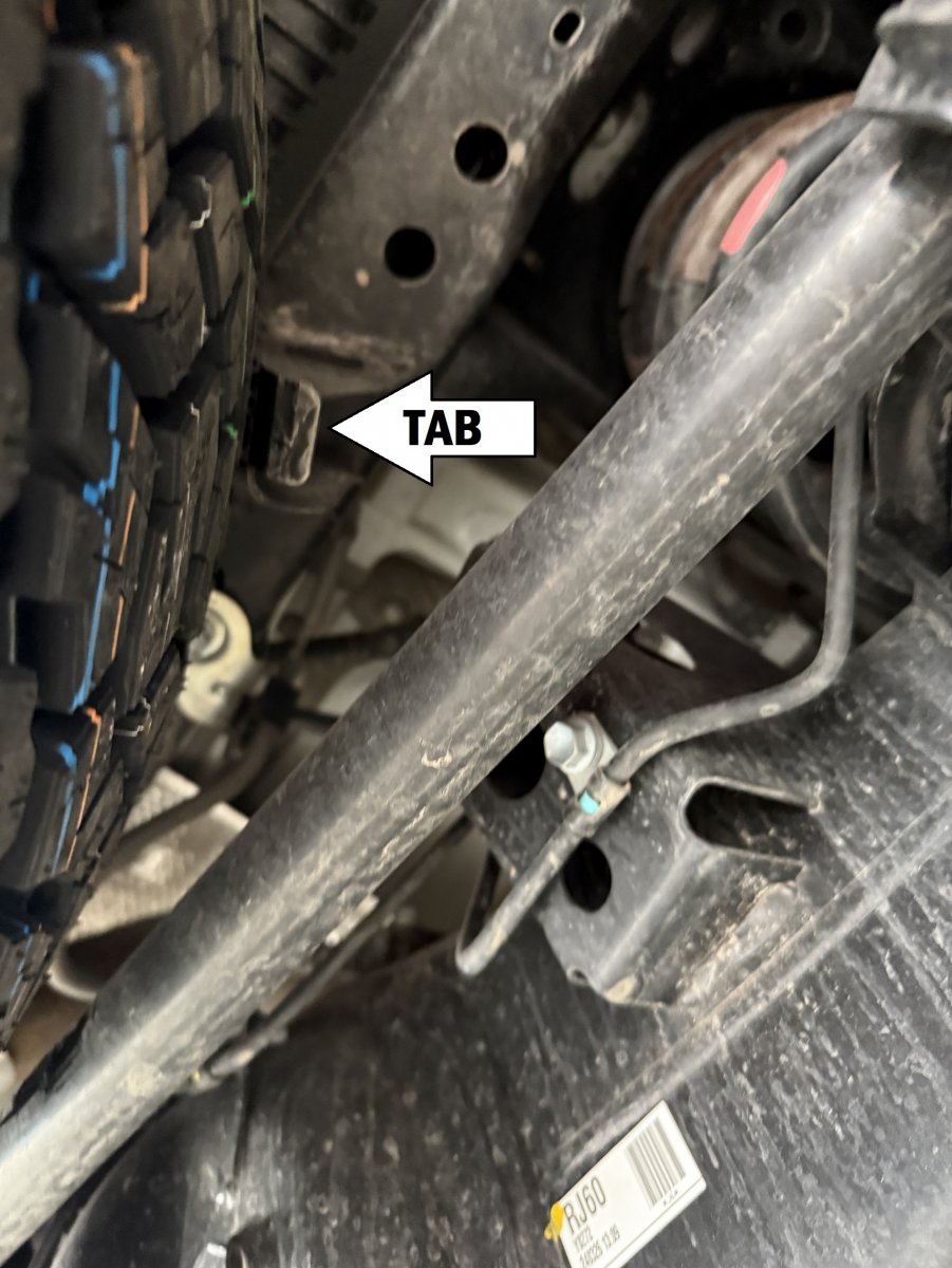

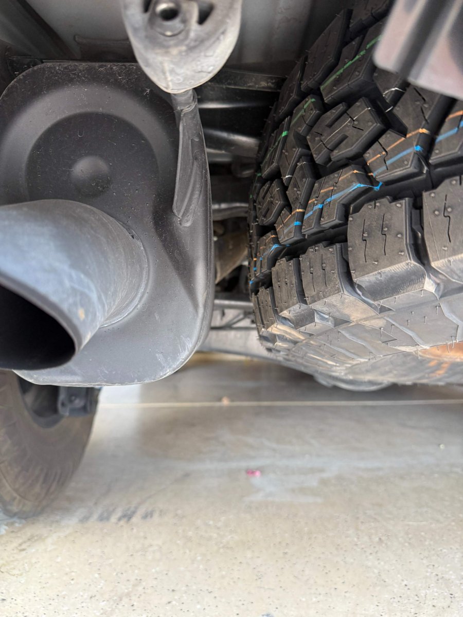

Notice that my 34" tire is not as tucked up into that tab as munkeeboi's 33" tire. I'm close, but not touching, the sway bar and I am touching the rear recovery point.
I suppose you could cut that tab off the frame and remove the rear recovery point but you have to watch the sway bar and also the clearance at the hitch receiver. I think that even a 35 would be clear of the exhaust...maybe slap some heat shield foil on the tire on the exhaust side.
Wow, thanks @Bluegill and @munkeeboi for the pictures. They help a lot with understanding the fitment issues. I think I would be fine with ditching that rear tow hook, and maybe cutting a 1/2" fillet out of that bracket near the sway bar, but it looks like the 34" is right up against the tow hitch. That could be a deal breaker for 35s.
Update: Thinking about it a bit more, maybe ditching the tow hook, deflating the tire as @thoff25 suggested, and shifting the tire to the right as far as it will go will buy us that extra 1" of clearance. I think the only thing left to do is wait for someone to try it. I will volunteer if a kind soul in SoCal wants to led me their 35 for an afternoon =).

I really hope you guys can figure it out, but there's not much room to move it to the right (passenger side) as you will lose the ability to use the relief cut at the rear bumper that is needed to barely fit the 34" tire as it is. You can probably deflate, but you will likely need to wedge the tire in to fit as it's still 1" more in diameter you need to find room for.
With that tab cut off, a 35" tire will still be a 35" tire without air in it. What will keep help compress the tire to a size smaller than 35" if there is no tab there? Let's say there is room for 35" without the tab, now you're going to need to rely on the chain tension alone to keep that tire from sliding forward into the sway bar and other suspension components. I hate to be so pessimistic about this, but i just don't see the room. I will gladly eat crow though for those more inventive an creative than me.
