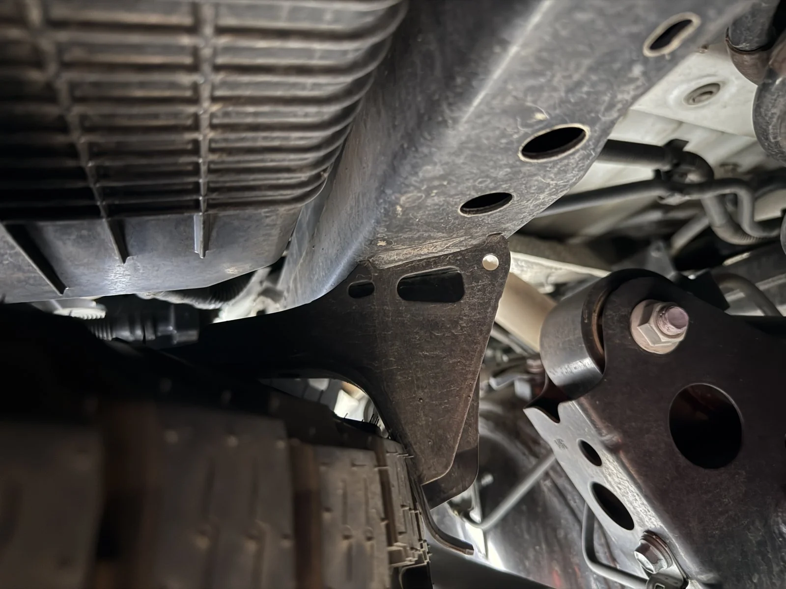

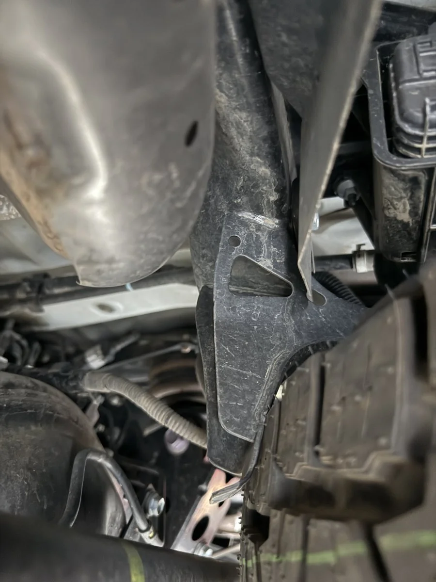

I tried several sizes for the spare. The 285/75R18 does not fit. I took the rear recovery point off, deflated the tire and shifted it to the right as far as I could and it wouldn’t clear the hitch. The only way it may clear is to do all that, cut off the bracket and have a new pan hard bar fabricated that is bent closer to the axel to try and keep it from hitting the tire. I think that would work on a 34 but not a 35…when I was getting my 285/75 we lifted several different size tires into the well and none fit…

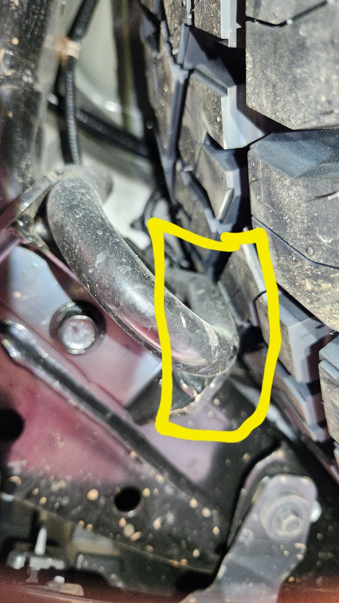

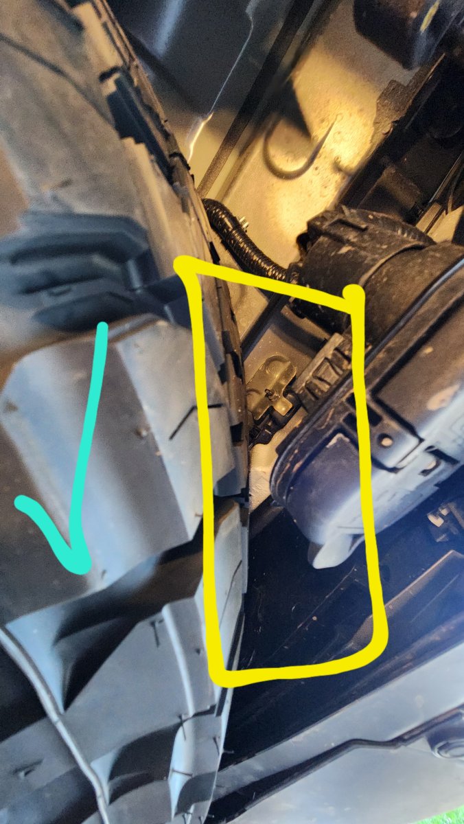

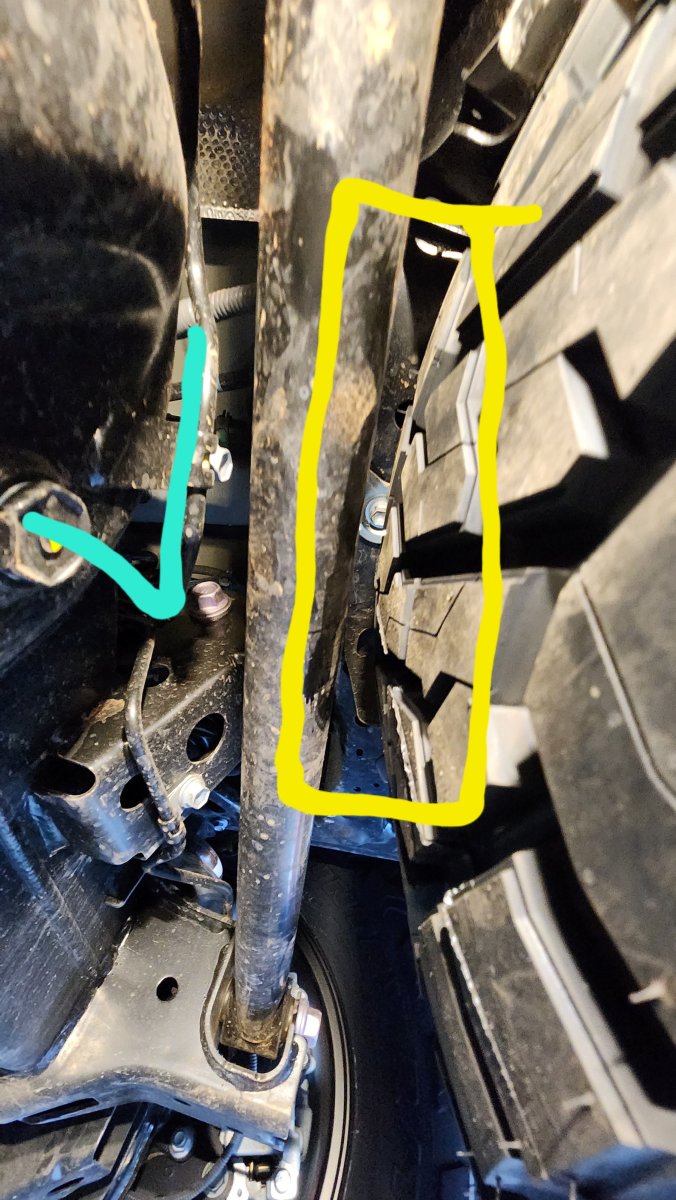

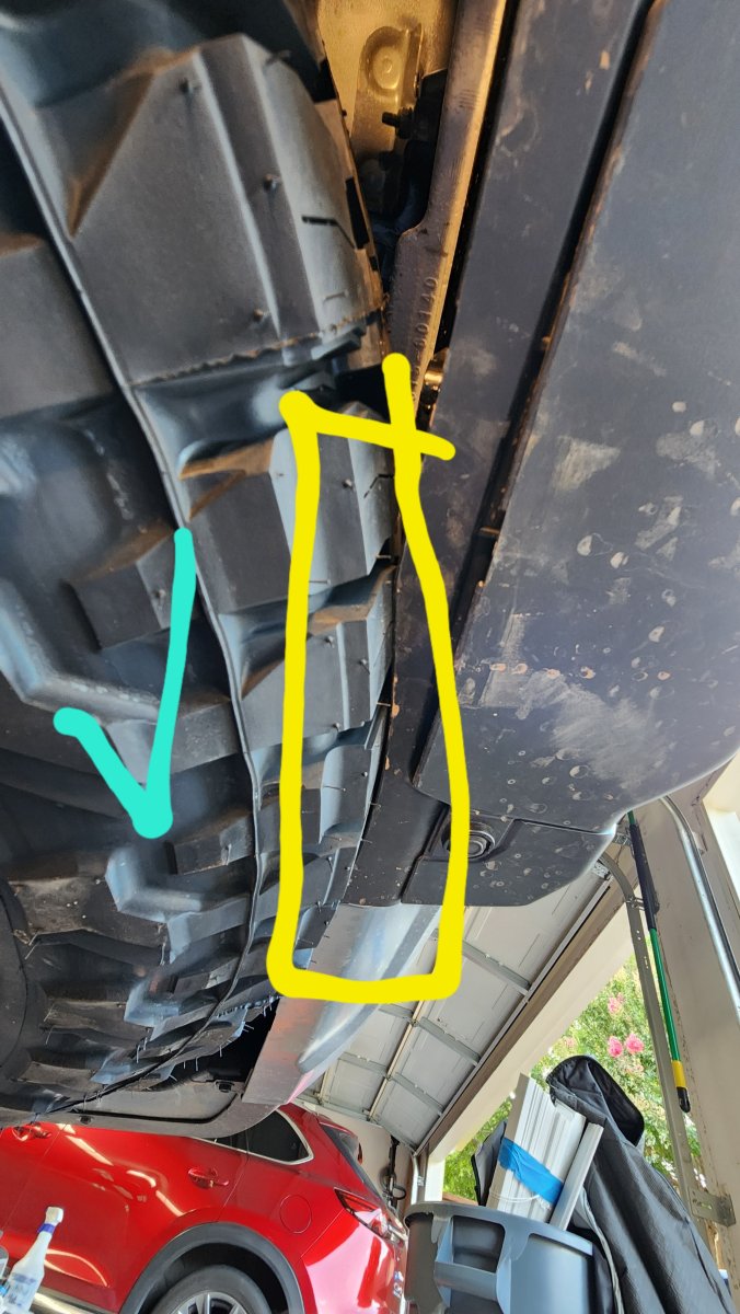

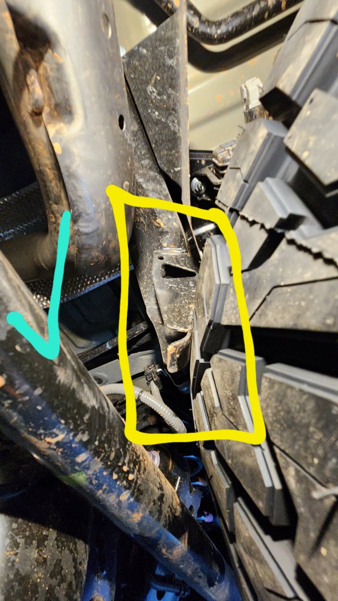

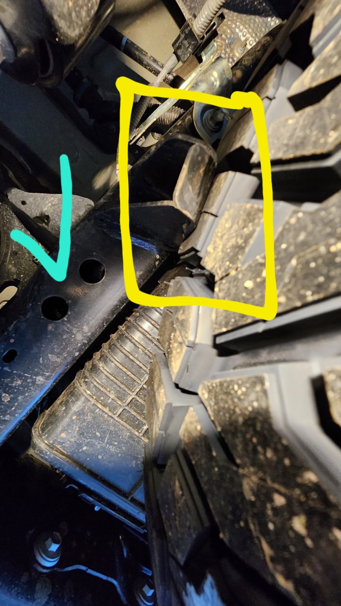

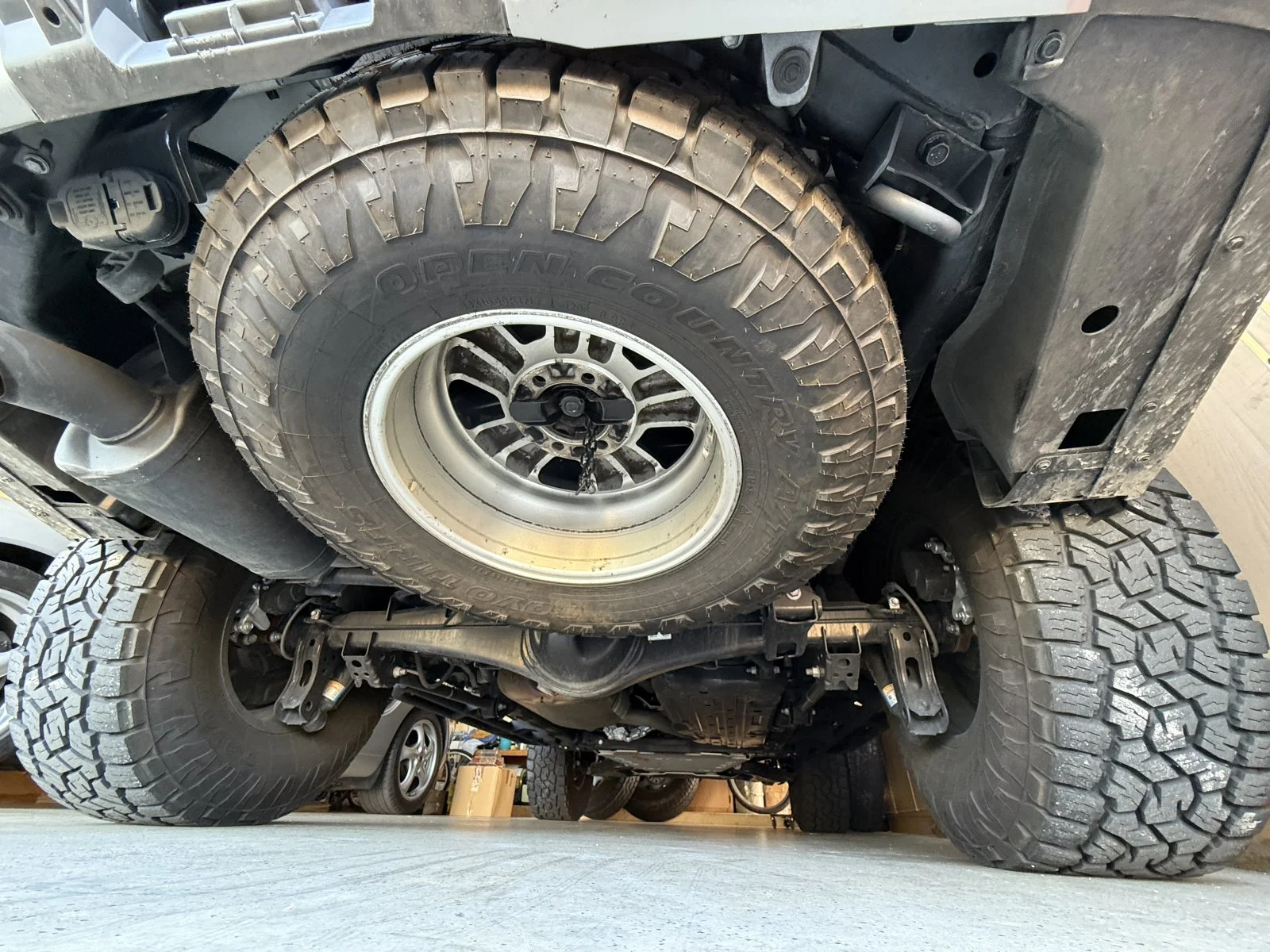

I just got Open Country RT Trails in 285/75/17 installed last night and they actually fit in the spare tire area! I was completely surprised. Remember each manufacturer's actual tire sizes are not the same, these are 33.9". I'll post up some pics of the underside but I looked where the bumper is cut out by Lexus to fit the curve of the OEM tire size and this fit's right up against it. Also, the poke below the bumper isn't to bad as these are 11.3" wide

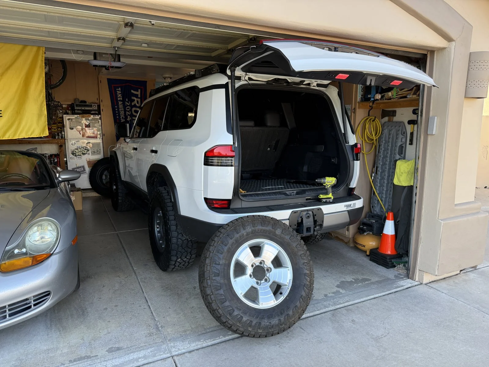

Took my 34" spare off today to get the TPMS swapped over to it from the stock spare (I forgot to do this when I had it installed).

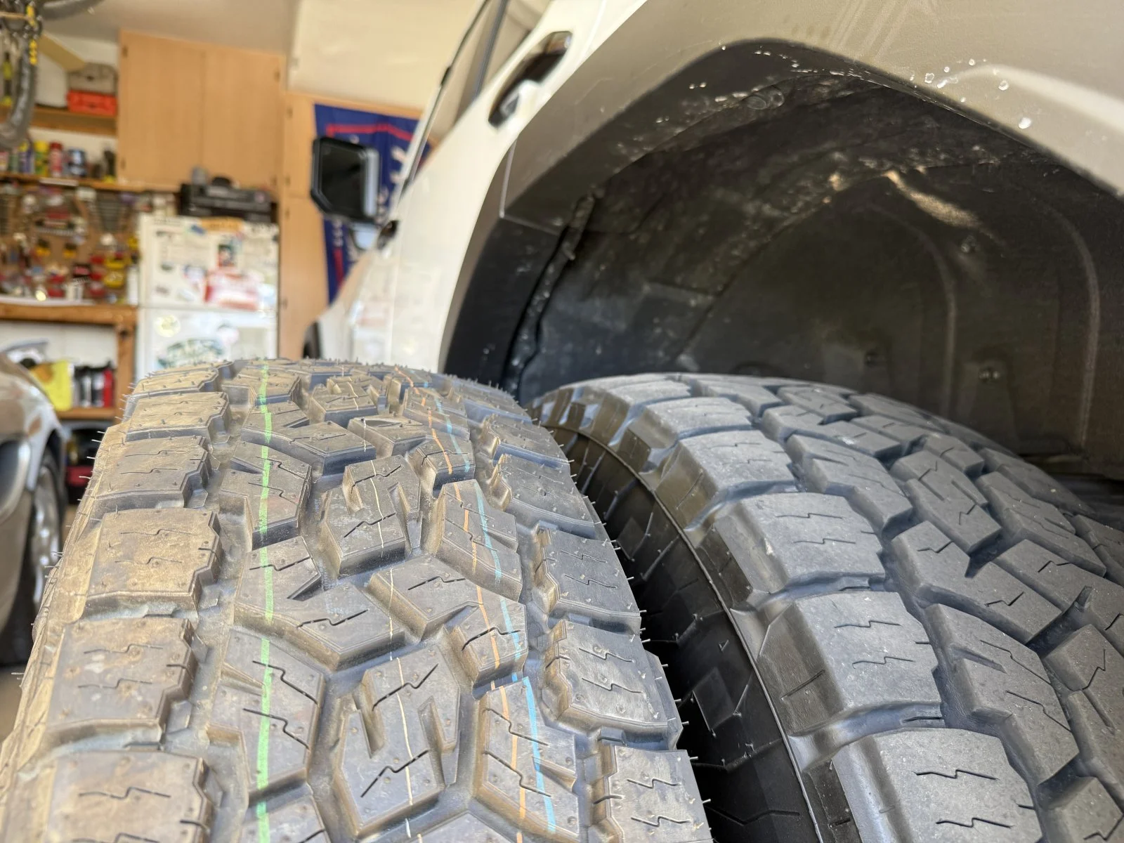

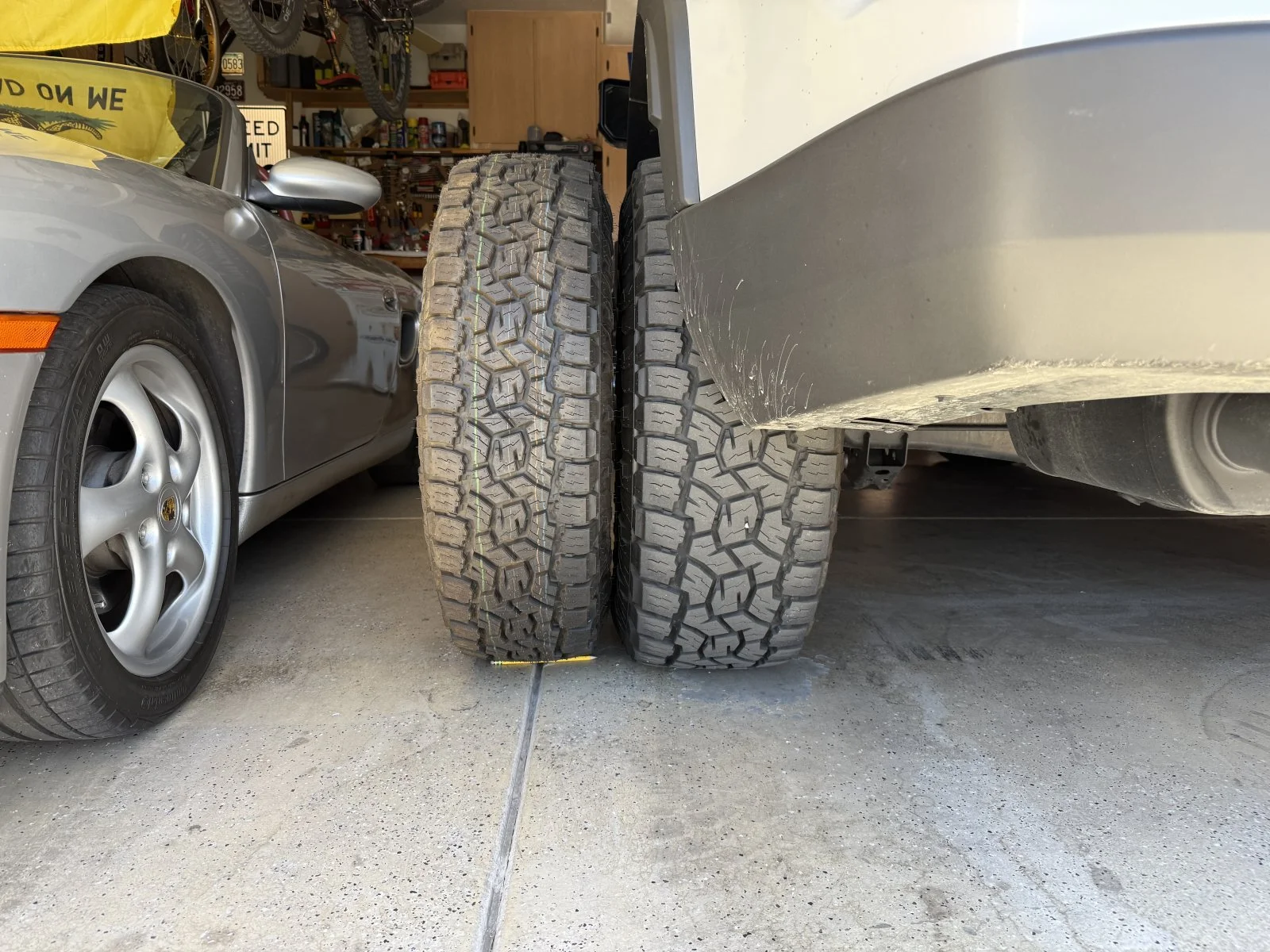

Here is the 34x10.5x17 wheel & tire compared to my 35x12.5x17 - it's actually higher than the 35 because it has no weight on it:
Here is the 34 on the left and the stock 33 on the right (265/70/18):
Re-installed the spare in the under-cargo stock area. Managed to tuck it up a bit more snug against the forward tabs. It's now not even touching the recovery ring. Also note how clean the backside of the Toyota 4Runner wheel is now. It's the little things that matter.

NOTE: I dropped the spare and tried to cranj it straight up and it wouldn't self center properly, so I had my wife crank it as I crawled under and centered it into place to fit, it's worth the sacrifice to me even having to do this because it actually fits in the slot
NOTE: I dropped the spare and tried to crank it straight up and it wouldn't self center properly, so I had my wife crank it as I crawled under and centered it into place to fit, it's worth the sacrifice to me even having to do this because it actually fits in the slot

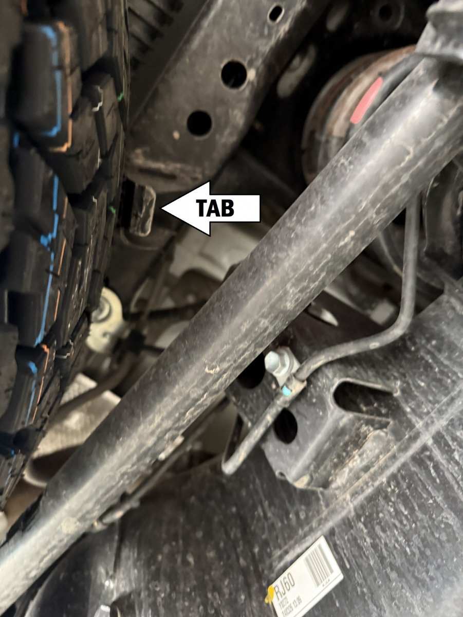

I fit a 34 x 10.5 x 17 and it legitimately fits - there is a piece, kind of a tab, behind the tire towards the axle that kind of holds the spare, and then the spare also has to clear behind the hitch and clear the back muffler. I can take more detailed photos but the 34 is pretty snug up against the forward holding tab.
I've heard others report that a 35 is just too big. Also note that a 35 x 12.5 will hang down vertically quite a bit.

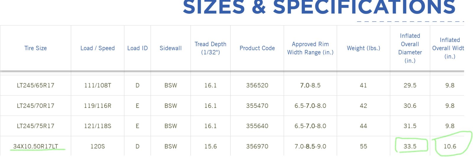

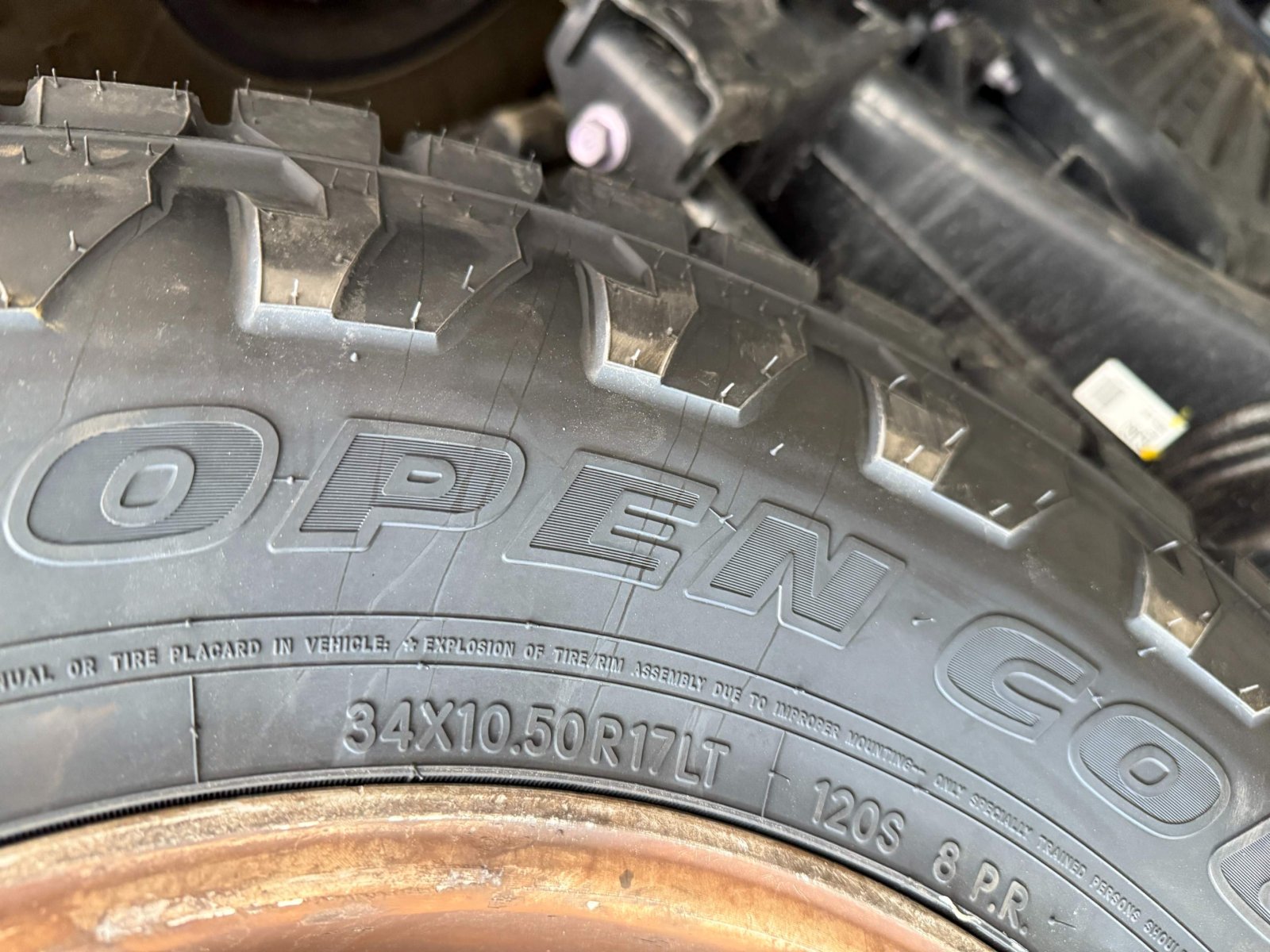

I can't tell from the pics but are these tires the Toyo Open Country ATIII 34x10.5Rx17LT's? If so, as all manufacturer's tires inflated sizes are slightly larger or smaller than the size listed on the sidewall These ATIII 34x10.5Rx17LT's are actually 33.5"x10.6" (see below and the link to Toyo's website: Toyo OpenCountry ATIII) . I was wondering why you have slightly more room than my 285/75R/17 Open Country RT Trails which are 33.9" BUT they both fit which is awesome.
Yes, they are Toyo Open Country ATIII in 34x10.5x17
Like you mentioned, I crawled under there to guide the tire as I slowly cranked it up. I didn't use my wife to crank, I used my cordless driver with the spare tire crank shaft in the chuck. I was able to reach the trigger on the driver and slowly crank the mechanism while I was under the truck and guiding the tire. If you crank the tire up crooked it won't seat properly.
Also, regarding my fit compared to the fit of your 285/75/17.....my width is listed as 10.6" and your calculates out to 11.23". The width might have something to do with the overall fit up in the spare tire space.

Yes, as I showed you you in your other thread, I fit a 34” tire in the spare. The downside will be that it has to go in at a different angle due to its size and the retaining brackets towards the axle resulting in the tire being more exposed and less “tucked in” compared to the stock spare.
Will it fit? Yes. Does it potentially cause other problems? Yes, but only depending on how you use your GX.
