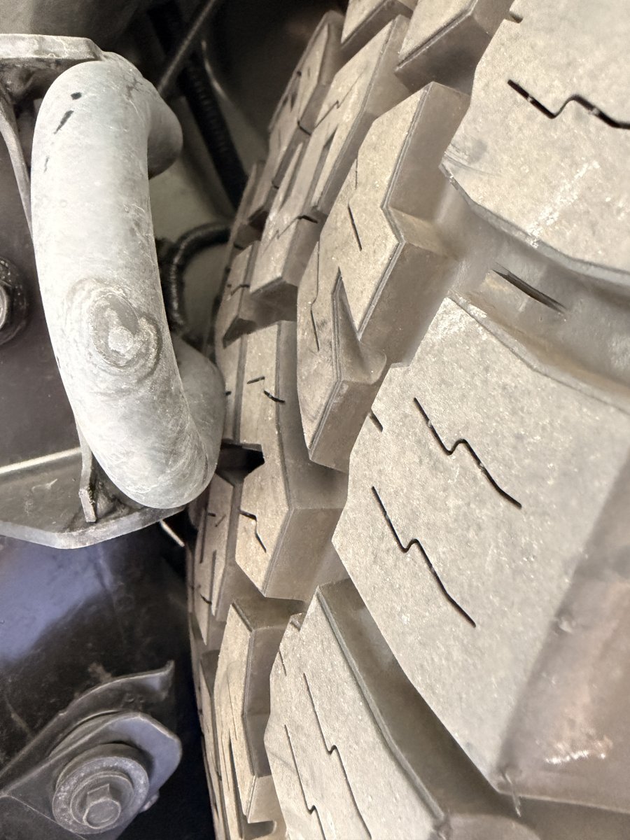

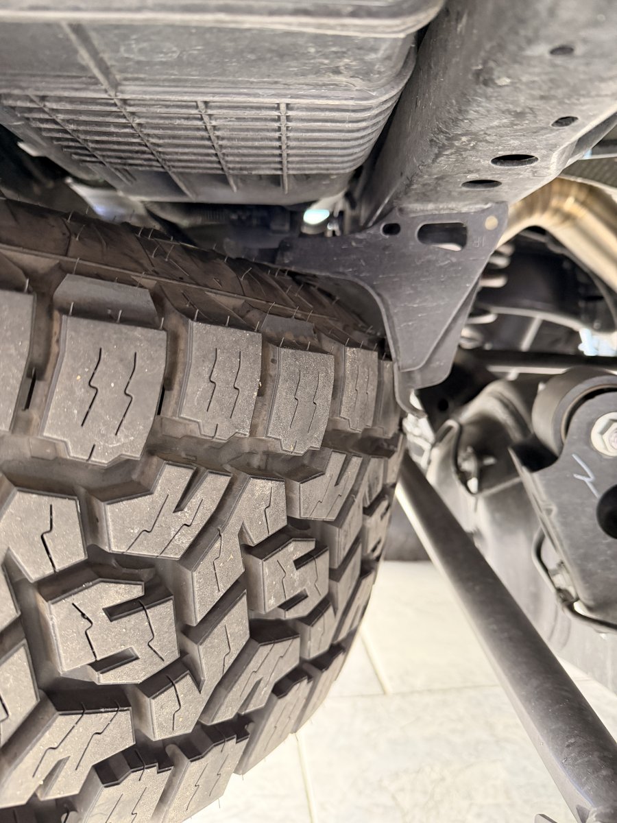

Yes a .2 inch difference. My previous statement still stands. It will fit if you angle it in more but it will droop down more since it won’t fit properly in the 2 brackets near the axle.
See how in this photo that the tire is only contacting the bottom 1” of the bracket? A larger diameter tire will have to slide down further since you are being limited at the bumper side

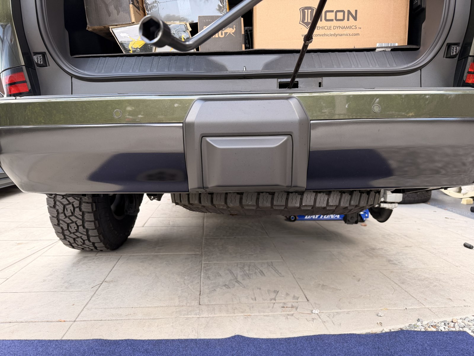

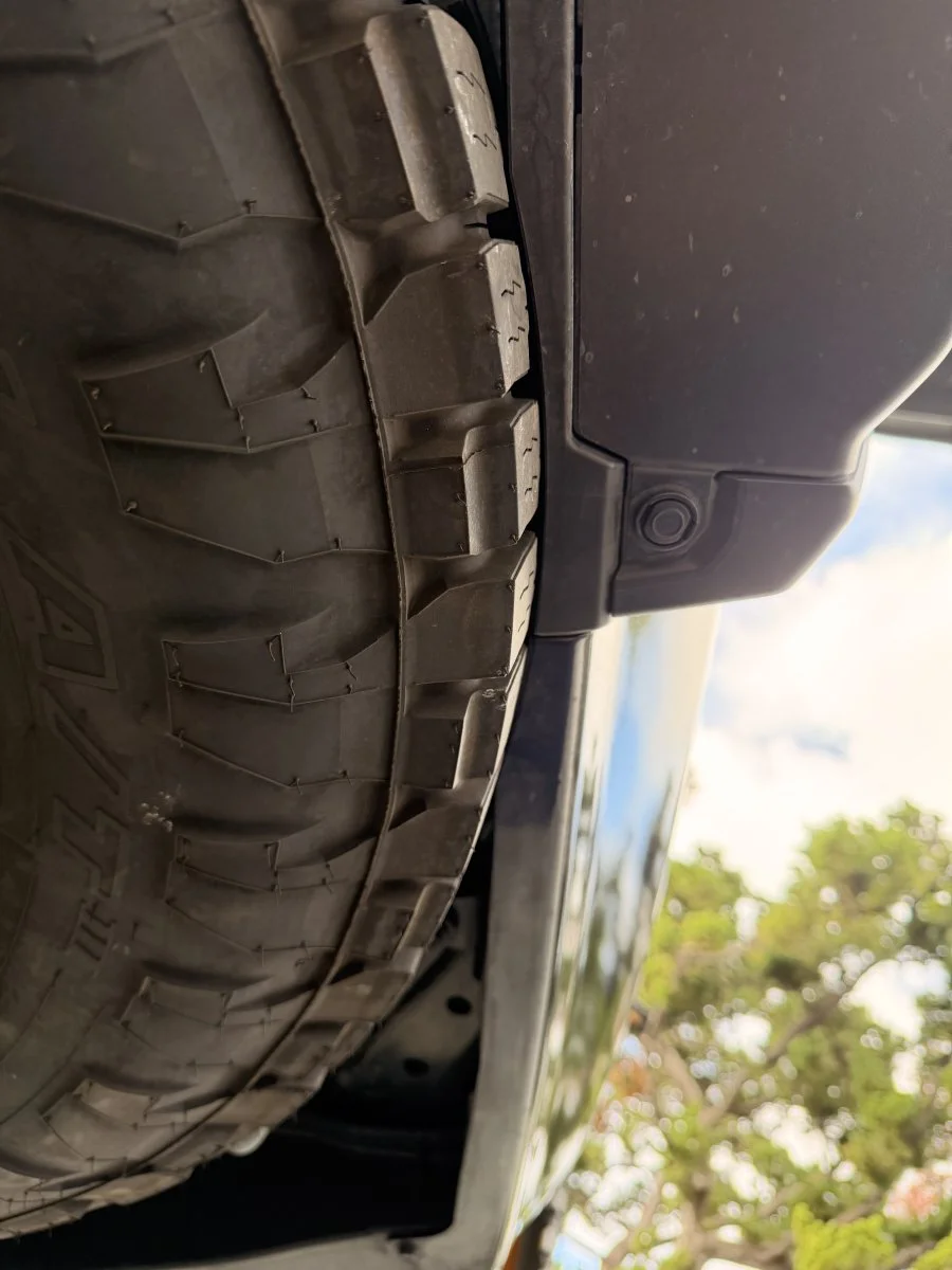

Bumper side
But to stay on topic. After fitting the 34” (33.9”) in there there’s no way a 35” will fit without major modification
