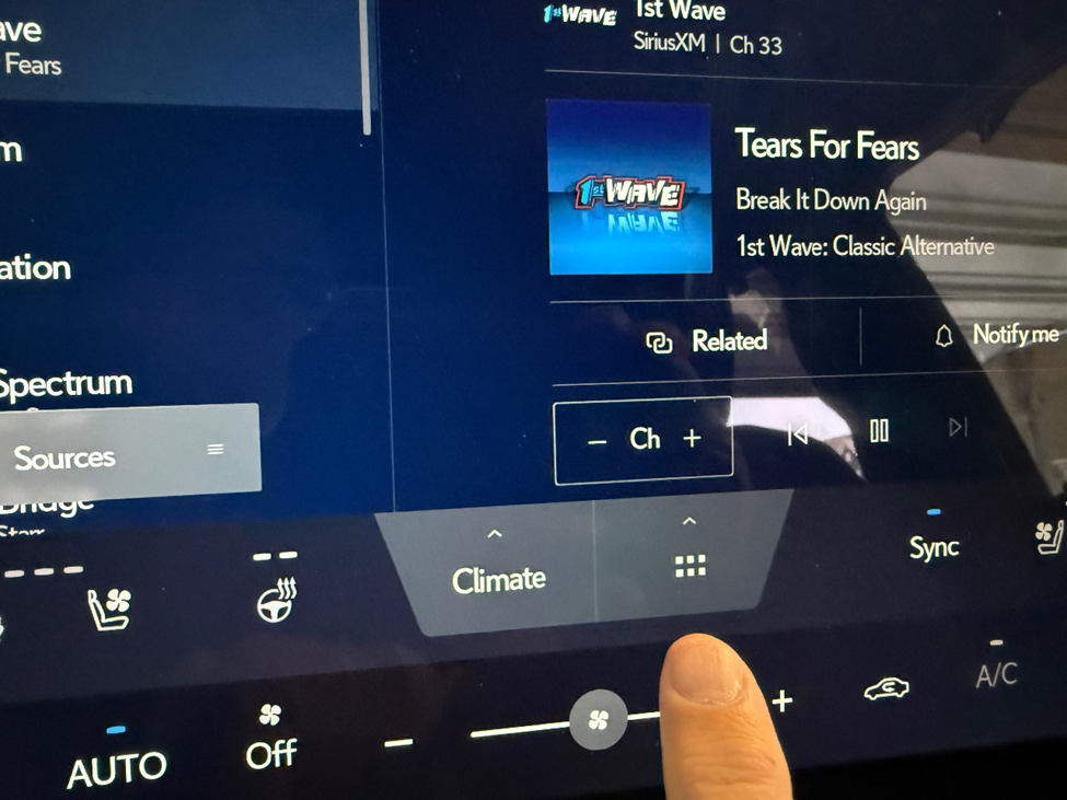

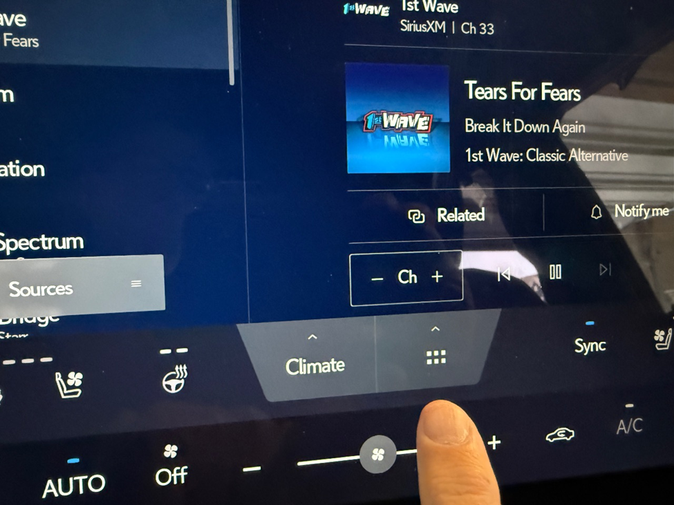

I just spent a couple hours running errands in ~95 degree temps. The "Max Cool" feature more than kept up. Just one button push from the "favorites" screen, so no need to fiddle with stuff. I ended up dialing back the fan speed after a while.

7. Finally, your max settings are just one click away from the shortcut screen.
