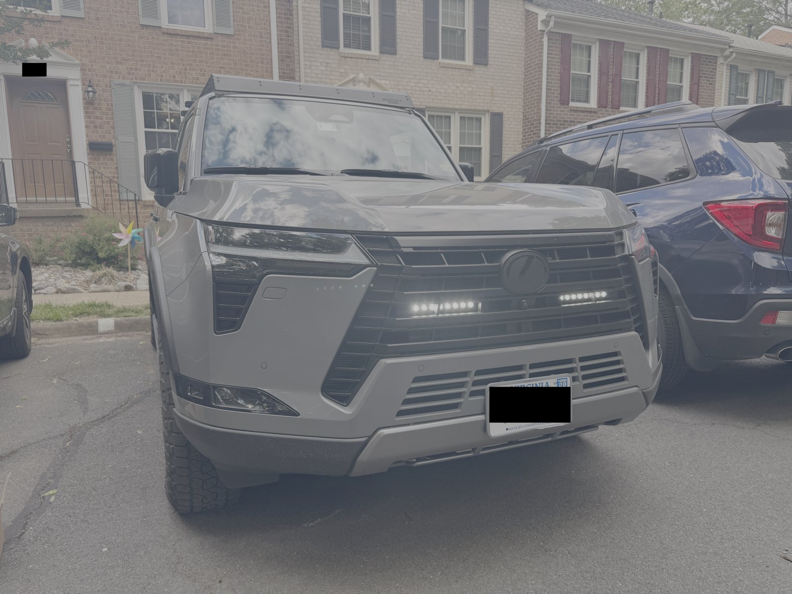

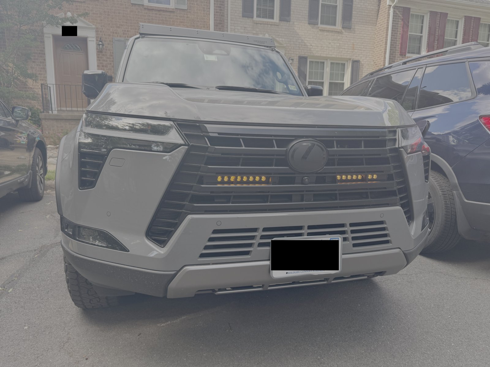

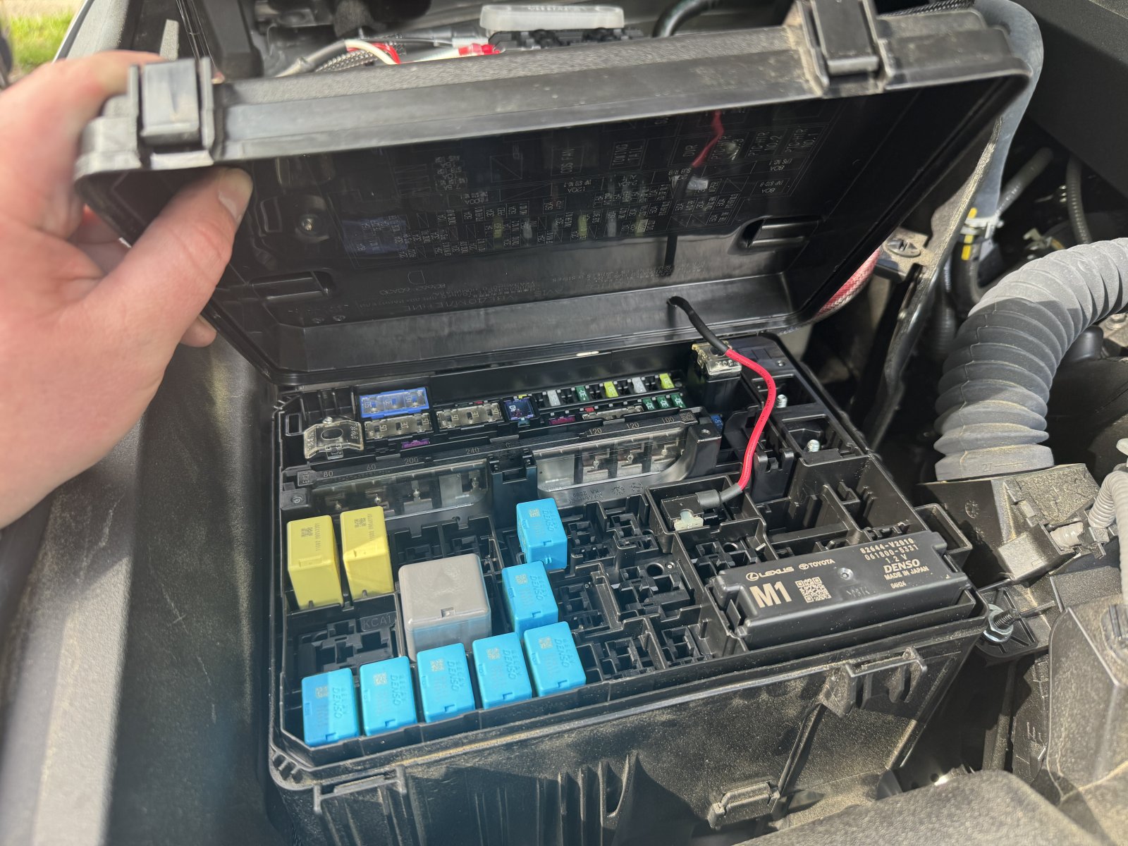

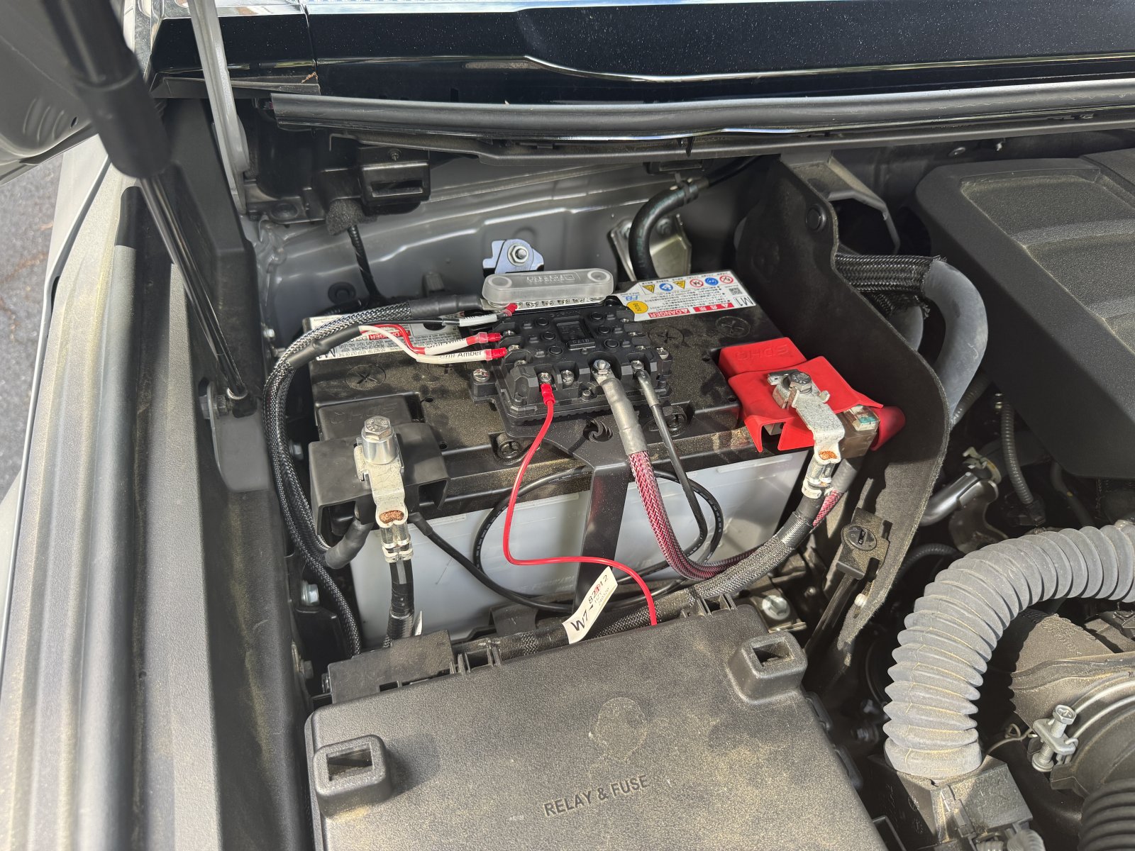

Completed installing the M&R 11in. Very happy with it! Install was easy enough thanks to the detailed walkthrough from Mike. Paired it with a Garmin Power Switch, Blaze Outdoor Kit, SDHQ Terminals, and Fuse Tape to STB-IGR. Made a custom Y wire harness with two Deutsch DT 3 Pin connectors. With the fuse tap, amber comes on with the engine.

Thanks for the feedback and love the extras to make your install legit. Appreciate the support once again
Sorry, I was speaking about the auxiliary trigger wires, did you tap any fuses to enable automatic trigger?

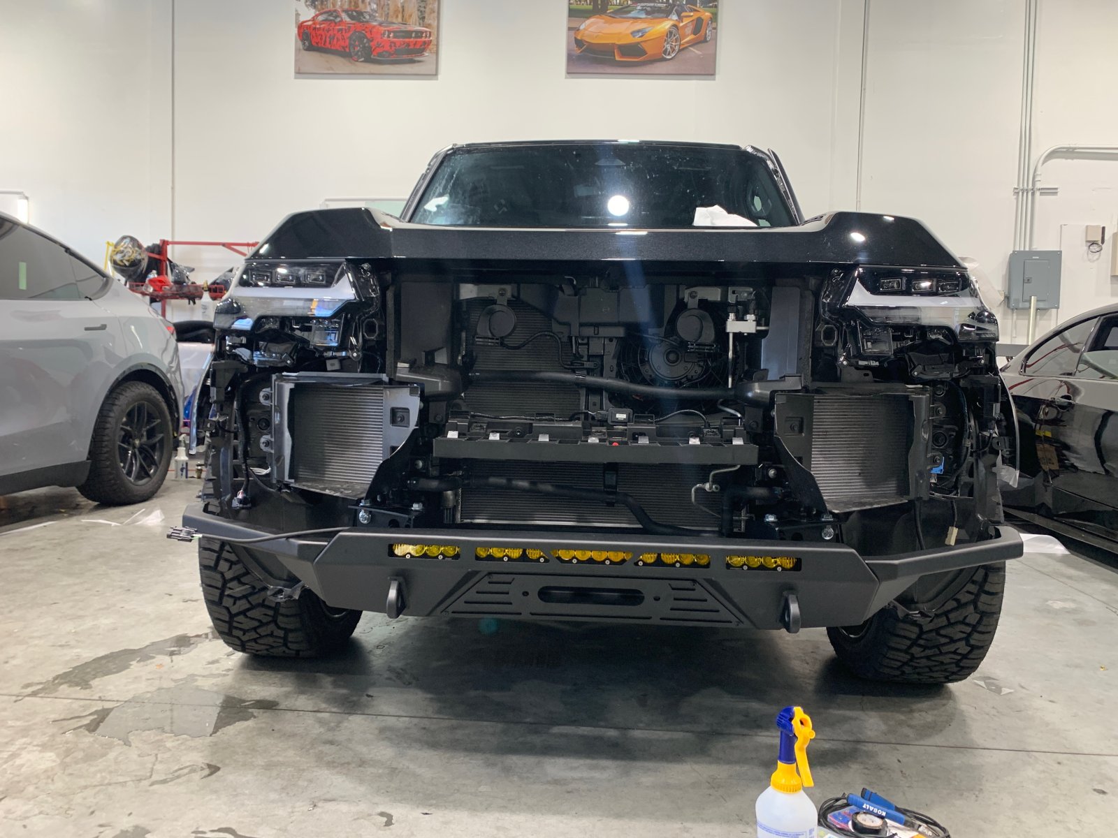

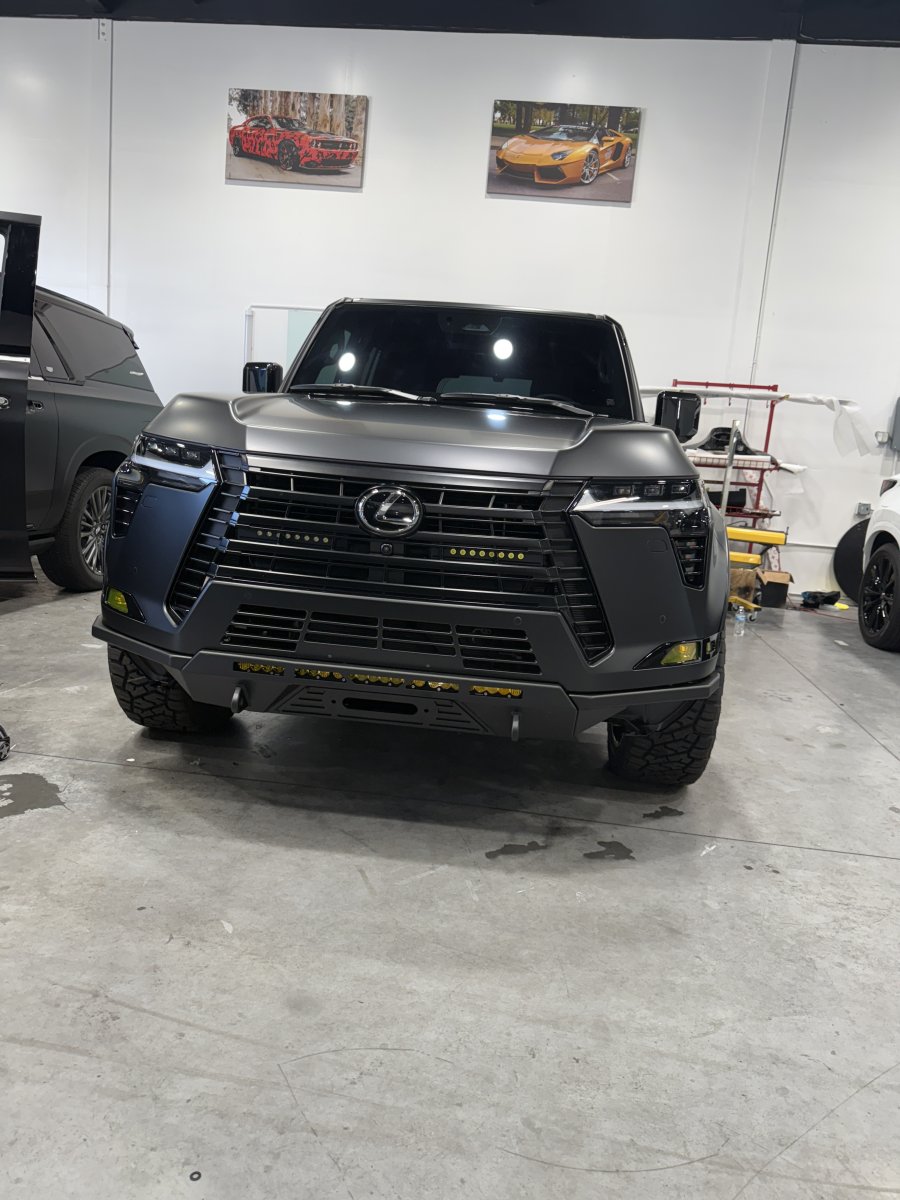

The shop is installing this M&R kit for me now. Can’t wait to see the final result. Also will have the CBI bumper with the Baja Designs 30” light bar w/ amber DRL backlight.

How long does it take to remove the front grill - is that a nightmare?
It takes about 20 minutes after you've done it once. It's no where near as bad as it looks. I've done it twice, and have to go back in one more time unfortunately. I bought a Bluetooth dongle for the warn winch that I will need to plug in and route the cable. Then everything will be accessible from under the hood. I wired the winch to a blue sea manual power cut on the front passenger side. You have to use that if using the Bluetooth remote because anytime the winch has power, it's draining the battery.
How long did it take you the first time - anything to be focused on when doing it - or 'oh shit' moments?
You have to clamp the washer fluid on the driver side and disconnect one plug, passenger side disconnect one plug. Basically everything was an oh shit moment because I was afraid of breaking it.. took me maybe an hour the first time. But there's A lot more bolts and clips to remove the first time because the lower assembly is still attached. The CBI front bumper installation video does a pretty good job of covering how to remove it.
