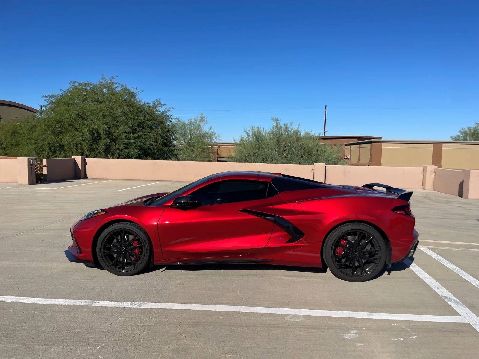

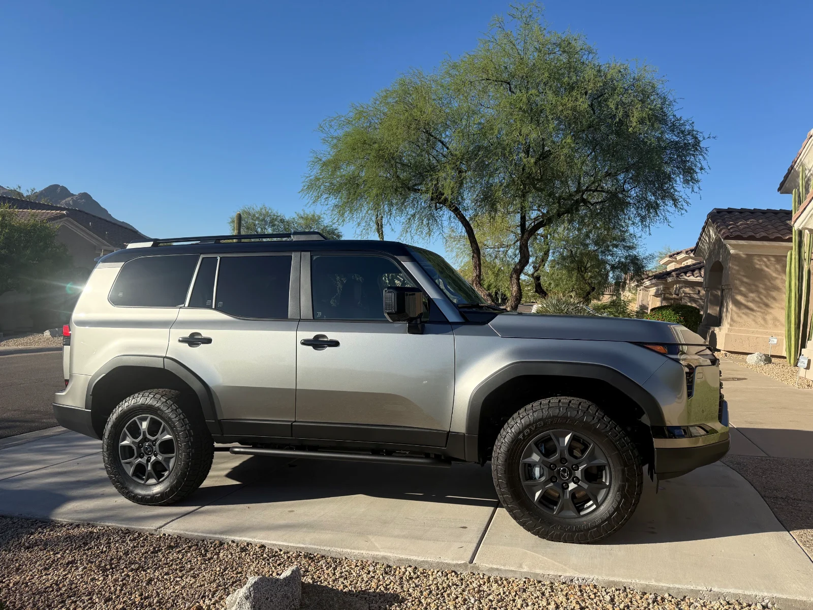

The deionizer is from CR Spotless, its model DIW-20. It is a game changer for sure. I went with CR because they have a rein exchange program, which is fantastic. Oh and the "integrated Resin Bypass" option, so you are not connecting/disconnecting the hose every time. A few things, I am a huge fan of ceramic coatings, professionally applied and PPF the hood/fenders/mirrors at a minimum. I had Feynlab Ceramic applied to my C8 2 years ago, the GX was done 6 mo ago. For PPF I really like Xpel, its treated me well. When I got my GX the dealer installed 3M on the hood, looked like orange peel and had to go. Here is my routine with all that said -

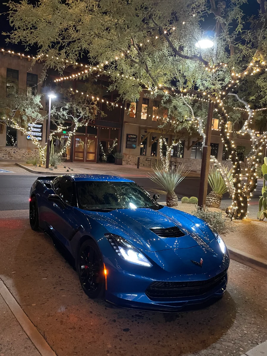

My 8yo C7. Better than new paint!
Grandsport? I have always wanted a C7 GS w/ steel brakes. Ran into an iRacing employee at a local autocross event a few years ago who absolutely dominated with his C7 GS.
