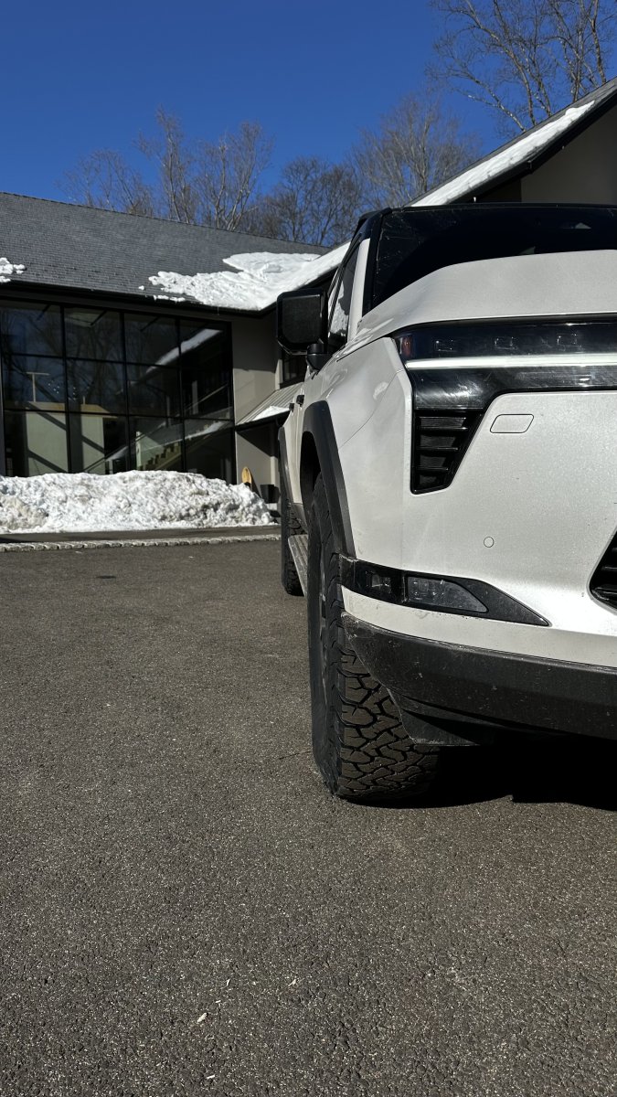

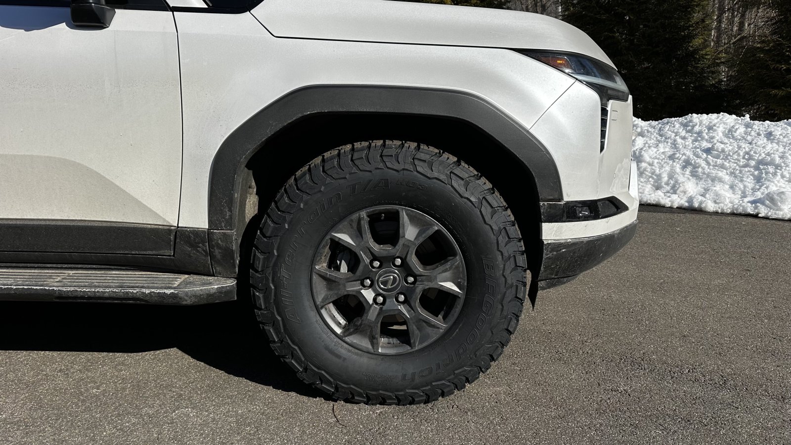

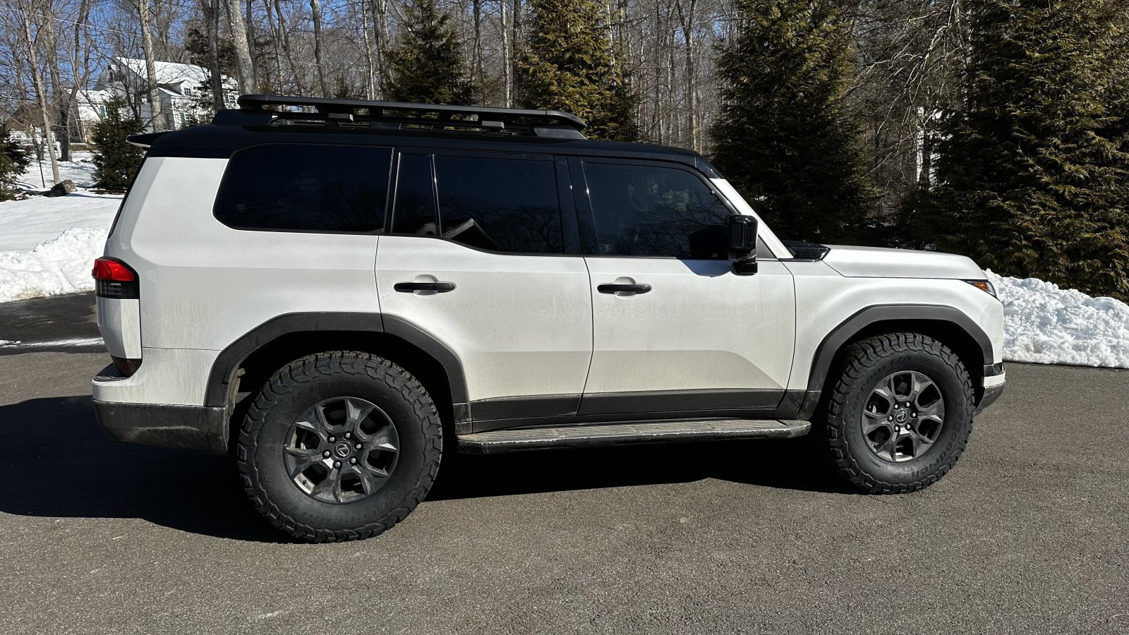

I just put 285/70 Toyos on my stock 25 OT. So far zero rub at full lock in forward and reverse, and they didn’t have to remove the crashbar or modify anything. Definitely looks better and the tires fill out the wheel wells without looking stuffed.
That looks really good. The 24 I have really could use a level. Are you running a spare in the same size?
