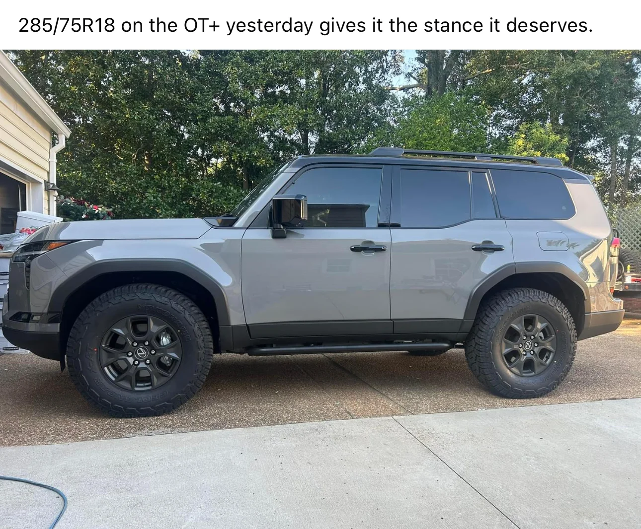

You may need 1" spacer to fit according to Westcott. There are some who say it fits without any modification. Maybe the mud guards will need to be removed. I'm thinking about getting this size as opposed to the 275 version.
This picture indicates the tire fits without any rubbing.
