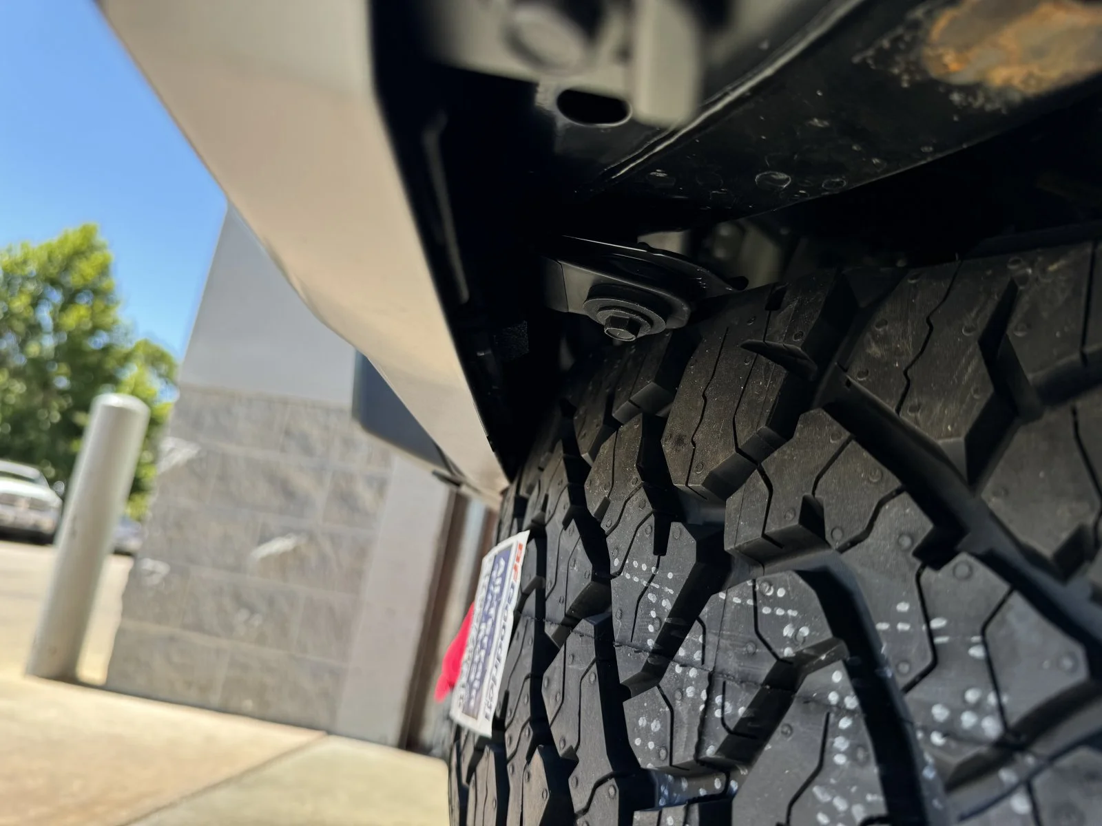

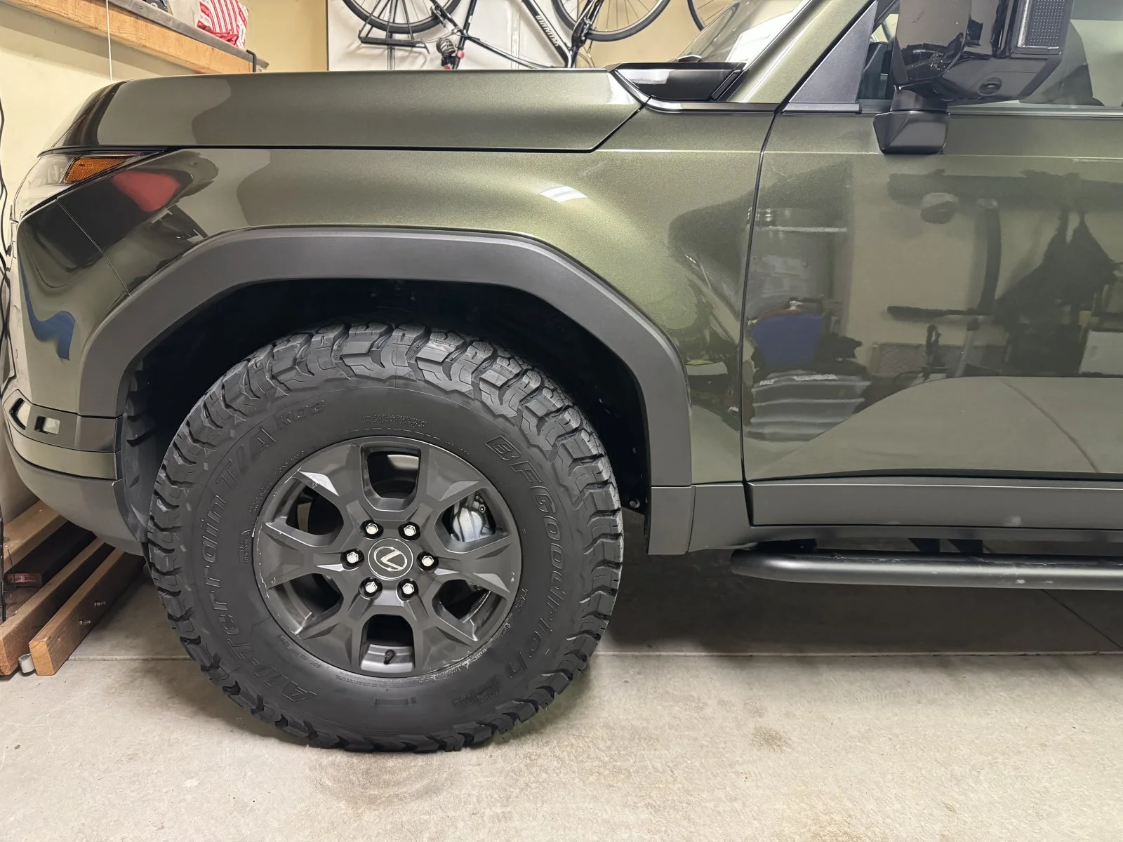

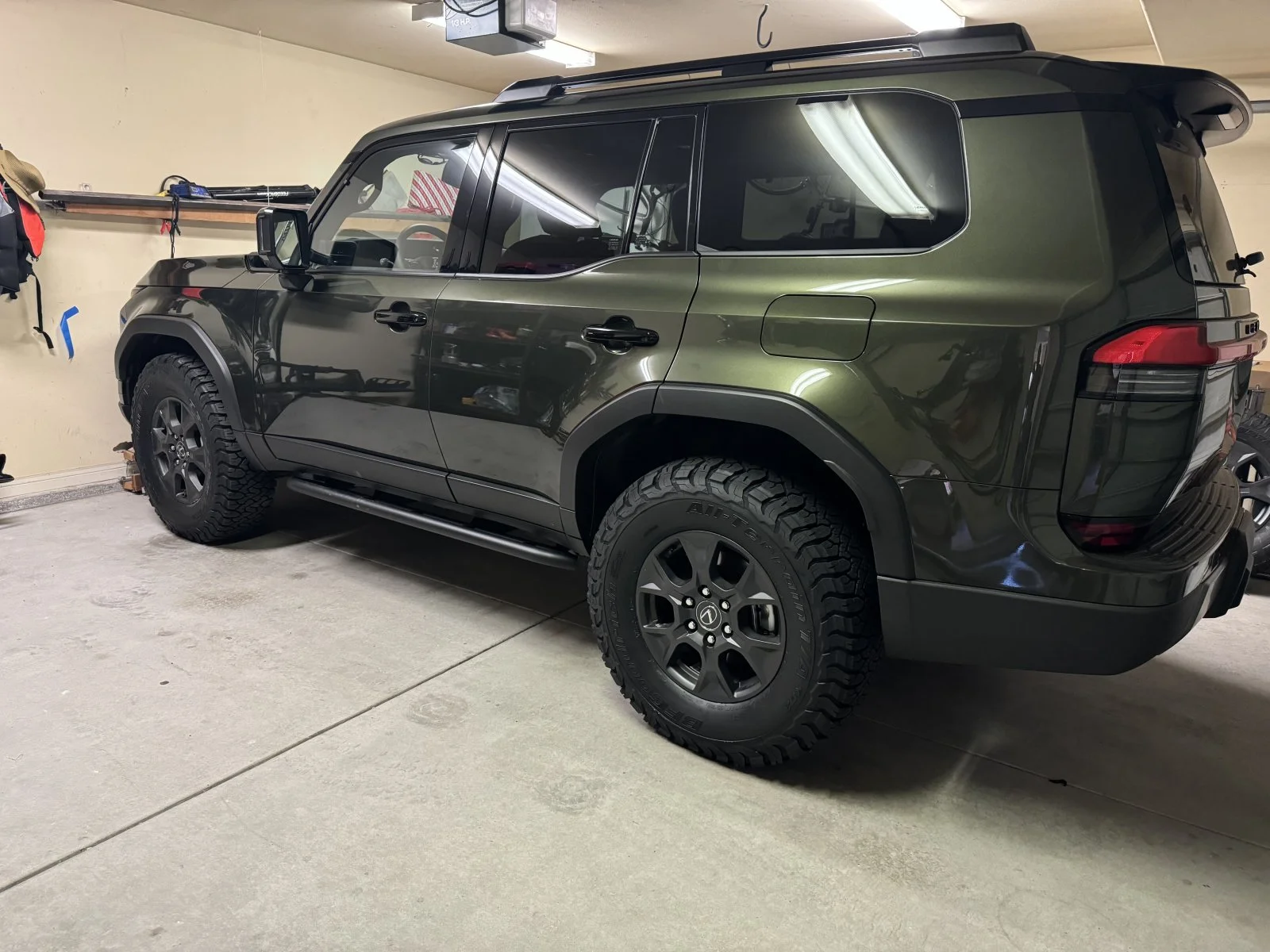

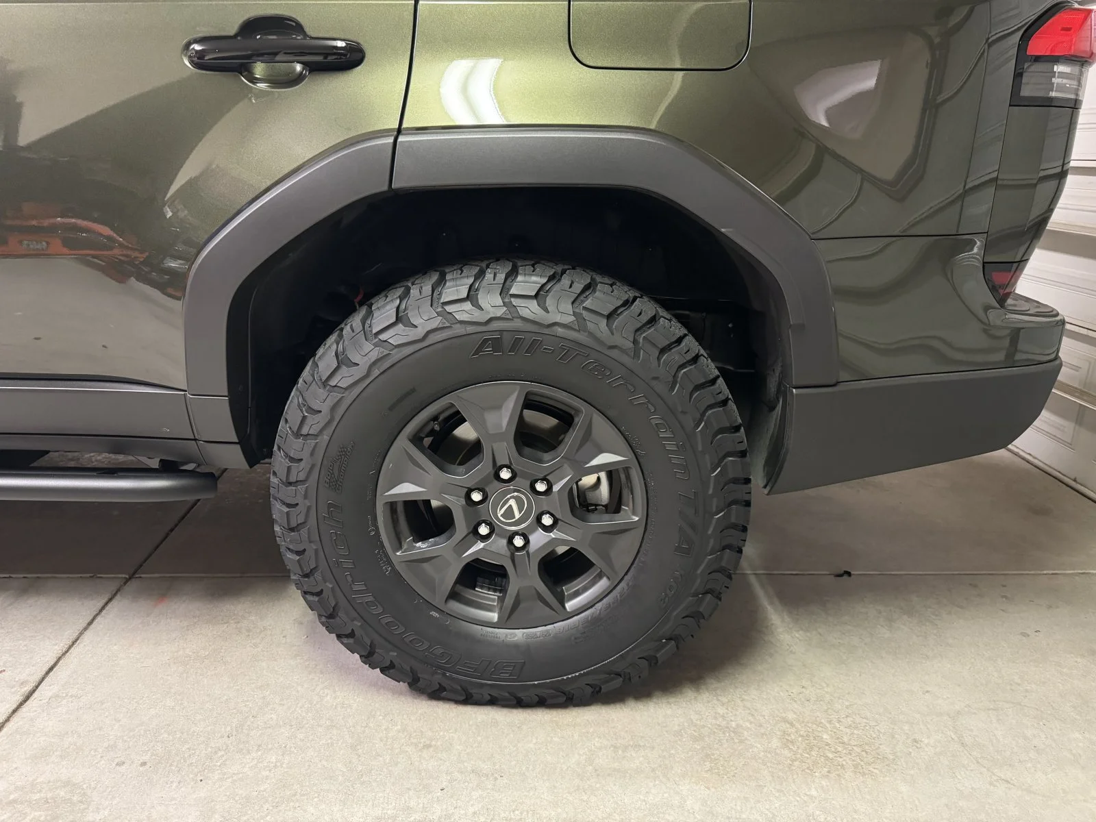

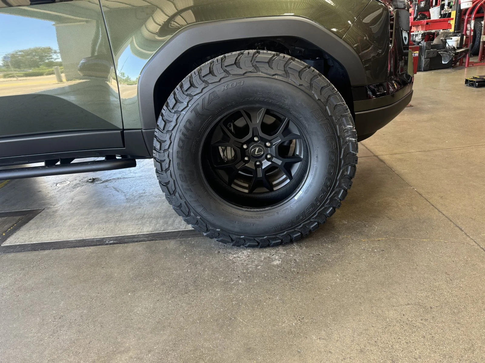

I test fit some 35s, 34.82 inch tires to be exact, and they fit. As per Westcot Design video it does contact the crash bars on the inboard aft of the wheel well but can easily be removed. This fit was without a lift. Only one of the tires came in so they weren't installed. The picture is of the test fit on the left front.

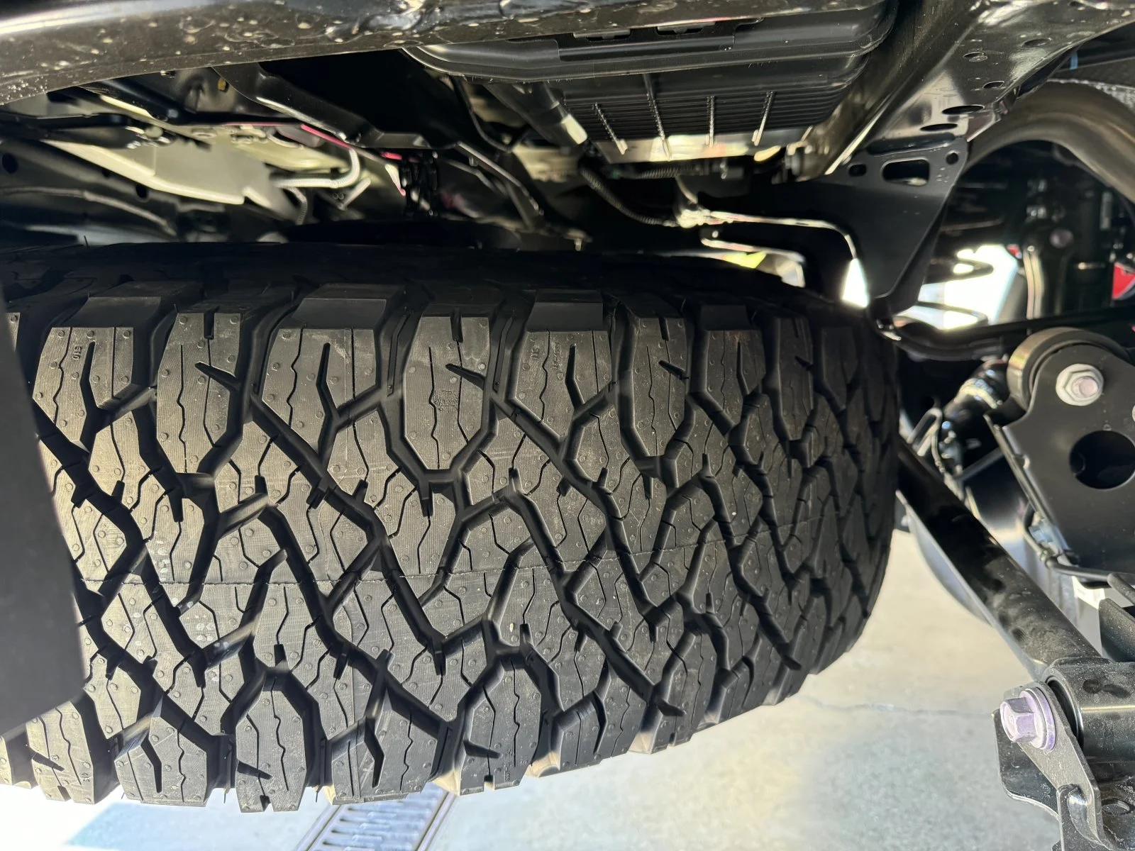

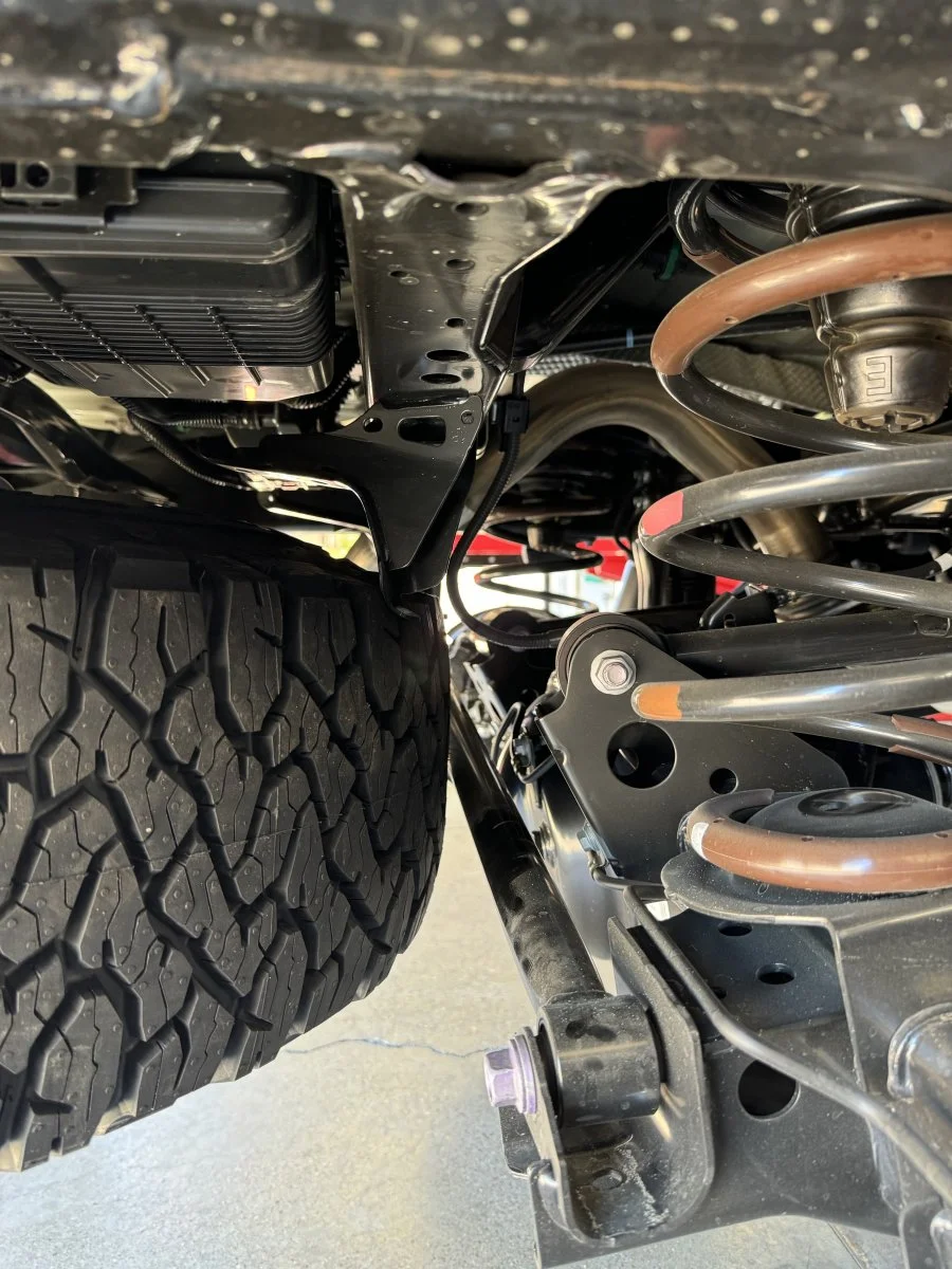

I also tried the underside spare. It did not initially fit. You can push the front onto the brackets that keep it from the panhard first and it then contacts against the trailer harness bracket and the recovery hook on the right side. They are both removable. I think it may fit if those are removed and installed once cleared and at low pressure. I'll update that status once I have the tires.
All this is on the original wheels.

Can you post some pics of the 35 in the spare location? I’m going to be test fitting a 34 down there as soon as I can free up some time with the tire shop. It looks like there is a good inch or two of room to work with down there.

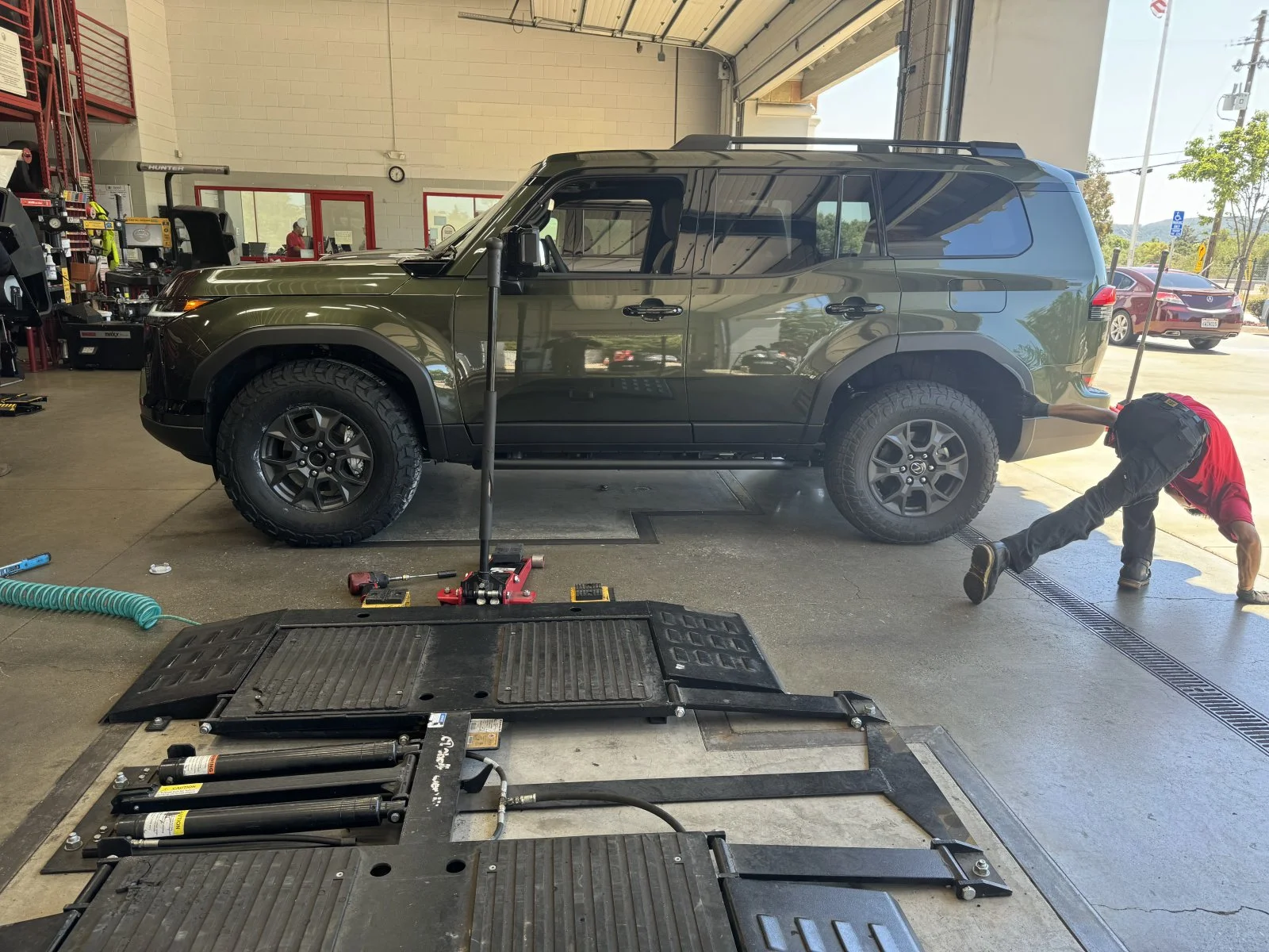

Here is the 35 not fitting. It’s pretty close. I may try a used tire to see if I can get it in there.

Here is the finished product. The spare did not fit but working on a solution. I think it’s close enough that a modified track bar or used tire may do the trick.

Nice work. This looks awesome! Love the use of the OEM wheel. How does it ride on the KO3's vs the Toyo's?

Did you have to add a lift kit? If not, did you have any issues with rubbing when turning the front wheels?

Yeah, 35 just isn't going to fit under there. Maybe an uninflated 34 will fit. I picked up a set of used OEM 4Runner Gen 4 (2003-2009) wheels. They are 17" X 7.5" with an offset of +30. I'll be using 1 as my spare and I'll try to stuff a 34" tire under there.

No lift kit yet. There are two brackets on not aft and aft inboard brackets that need to be removed. They are bolted on and accessible without removing the OEM tires. There is plenty of room and no rubbing stop to stop.

Rides really well. As expected it makes it smoother over the smaller bumps, potholes etc.
Those KO3's only come in E-rated right? If that is the case, it is surprising to me that they'd run smoother. I would have expected the opposite since E-rated is pretty stiff compared to stock tires. What PSI were you running the stock tires and also the KO3's? Also, would love it if you could post some video of some articulation etc.

Hello, it did not require a lift kit, no rubbing at standard right height.
