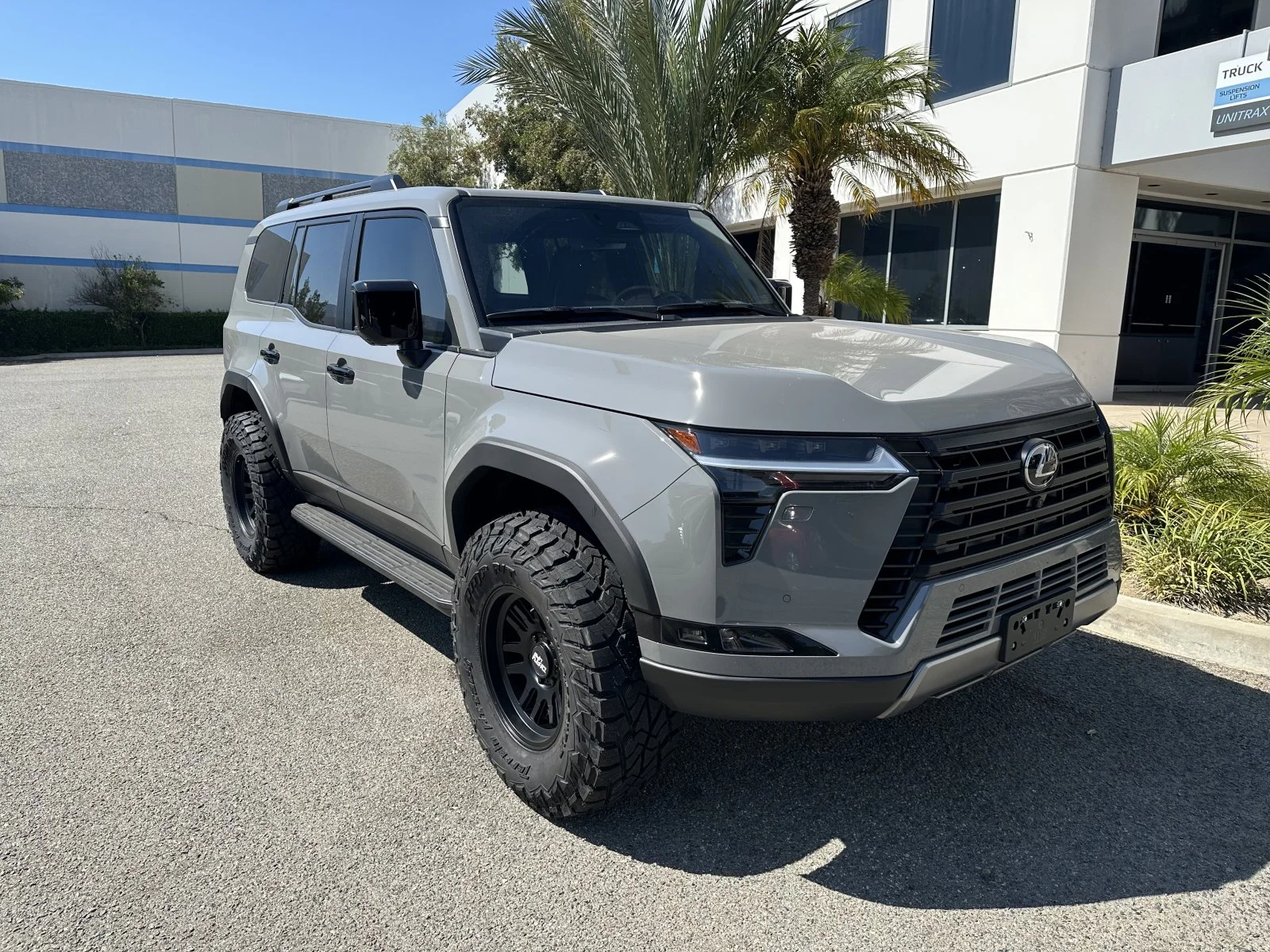

indeed 35 fits easily
Lexyjoe - Those tires look great! I have the Overtrail + and would like to upsize tires without doing other modification. Do you have any rubbing? I notice that you went with a wider offset. If I want to keep the whole tire inside the wheel well do you think I would have a problem if I go with 35'?
Yes you will rub with a full 35 without modification. There are two rubbing points. If you go with a more negative offset like 0. It will be the front edge bumper and the front bracket area. I can take pics. If you go with a higher offset like 35 to 45s it will hit the inner bracket area and most likely the outer areas too.
I think the sweet spot if upgrading rim is +35 offset if you want it flushed. A tires size of 285 70 17 would not rub. anything higher it will rub. If upsizing tire from the overtrail 18 inch rim its probably 275 70 18. This is without lift or modification.

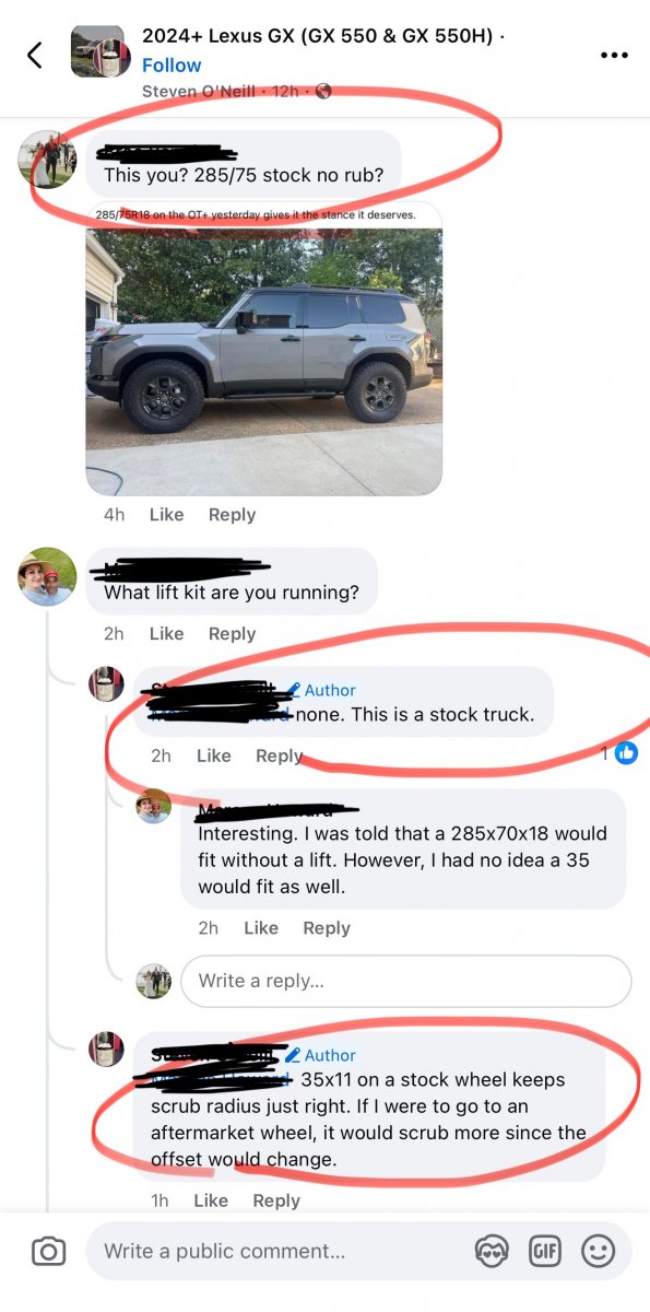

Do 35s fit on stock ‘24 GX? Facebook user claims yesView attachment 11302
That confirms my research, although I dont have any first-hand experience fitting 35s. 35s will fit on a stock truck as long as your wheels have a high offset (>40). The stockers have +50.
