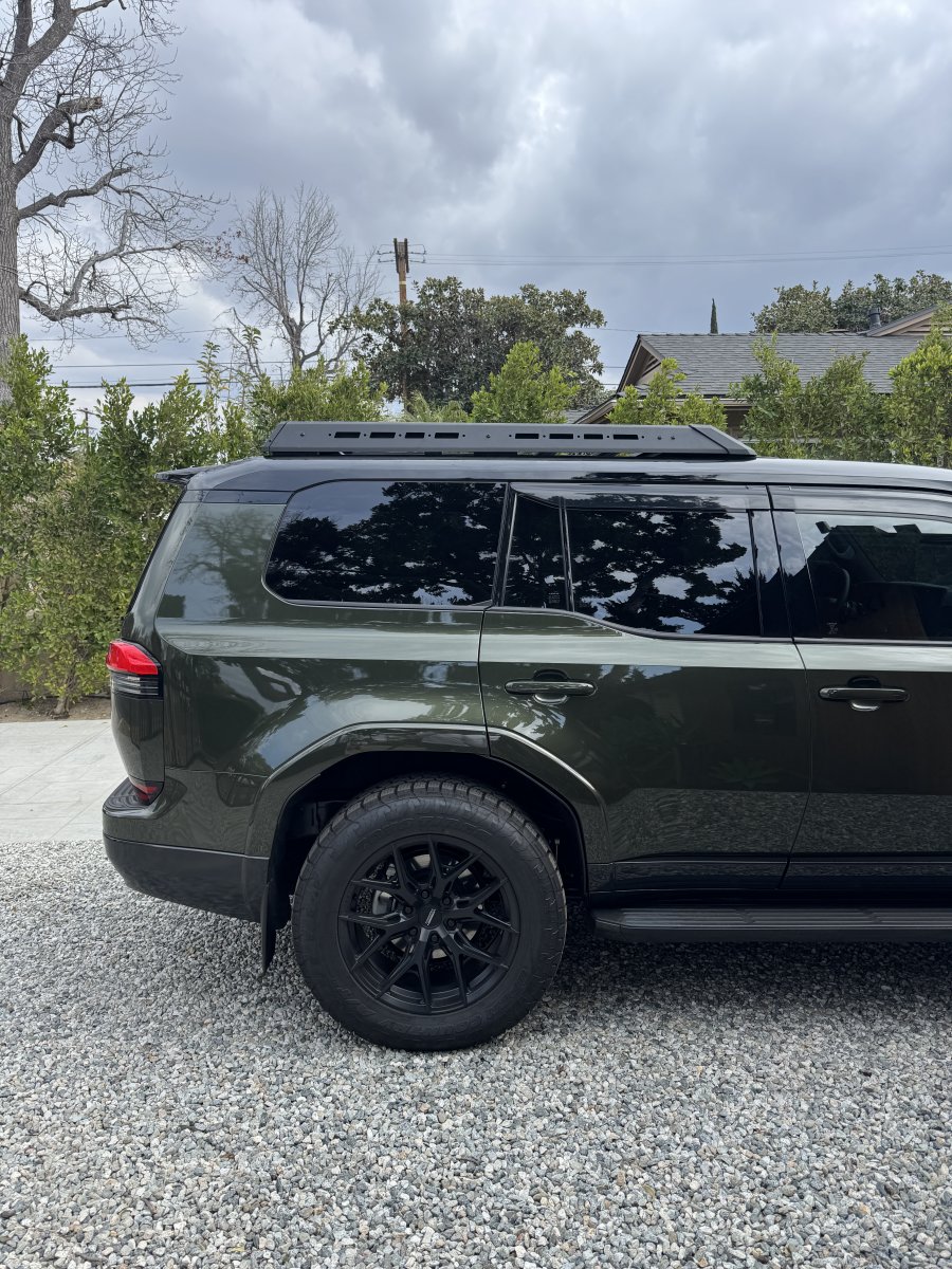

I had it done when the PPF was done. It's kind of gloomy now, but can send a picture later. I don't believe they pulled anything off since it's a fairly flat piece to wrap and just wrapped it on the truck
I also did clear PPF on the entire front end last year and gloss black vinyl on the fender flares but the added cost of the running boards didn't make sense to me... I figured there would be a cheaper alternative somewhere down the road as I wasn't sure if I'd keep the stock boards....

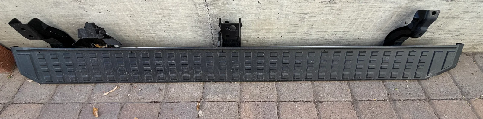

I removed the factory rock rails and added running boards from a 6th GEN 4Runner which I bought off of FB Marketplace for $140. They are the same as the Landcruiser running boards.
