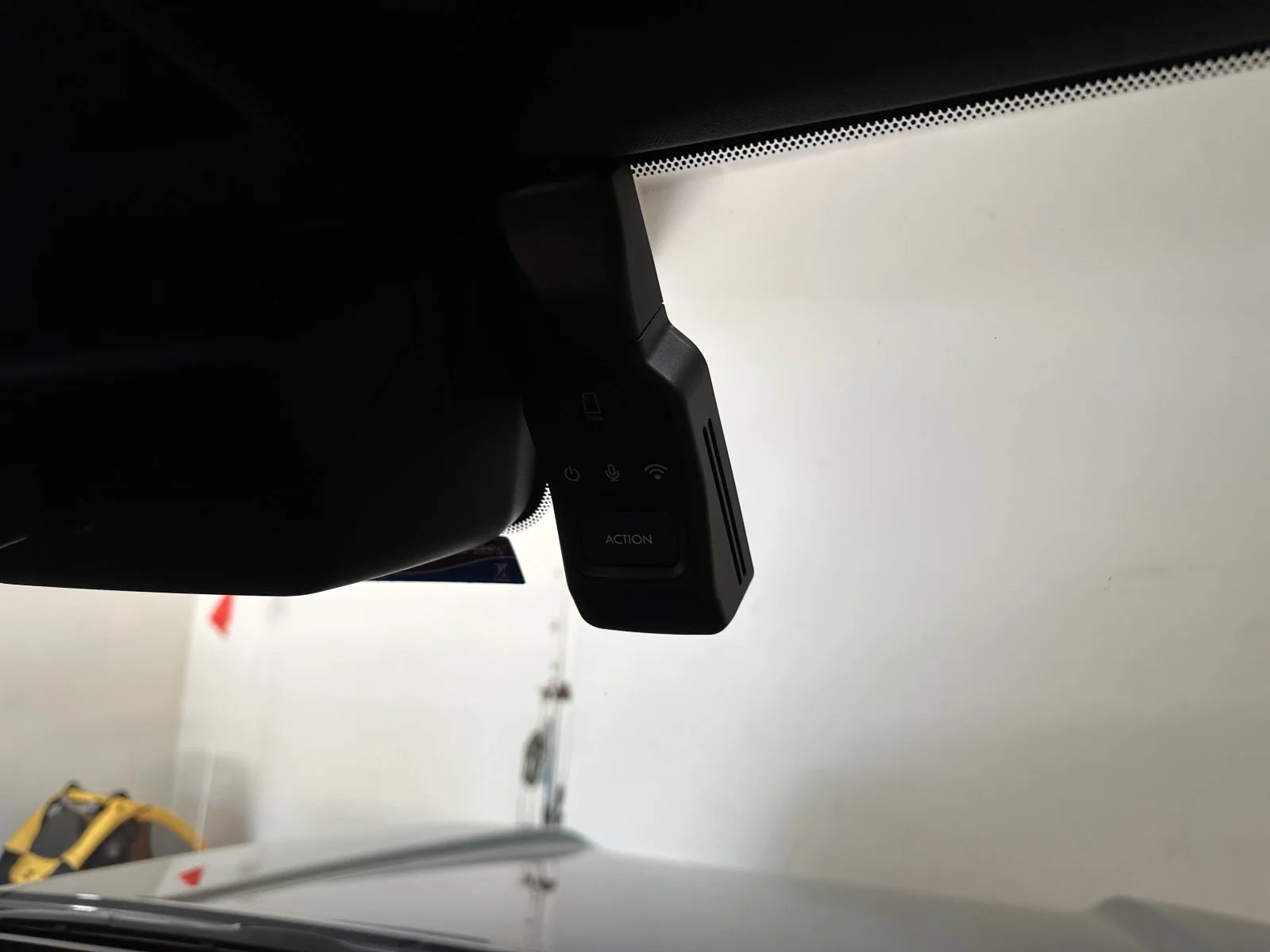

I press the wifi button on the dashcam then go to my ultra s23 (android) and I see the dashcam network but when I select it nothing happens at all the app tells me to do exactly what I just did
Can someone share how they connect the dashcam to the app? It is driving me crazy

in your phone's wifi settings, when you select the dashcam network, you will need to enter the default password. 1234567890.
Then in the app (at least the ios pne), you have so swipe down feom the homepage where it says swipe to connect. it took me a couple tries. also if you have any sort of vpn or ad blocking software on your phone, turn it off

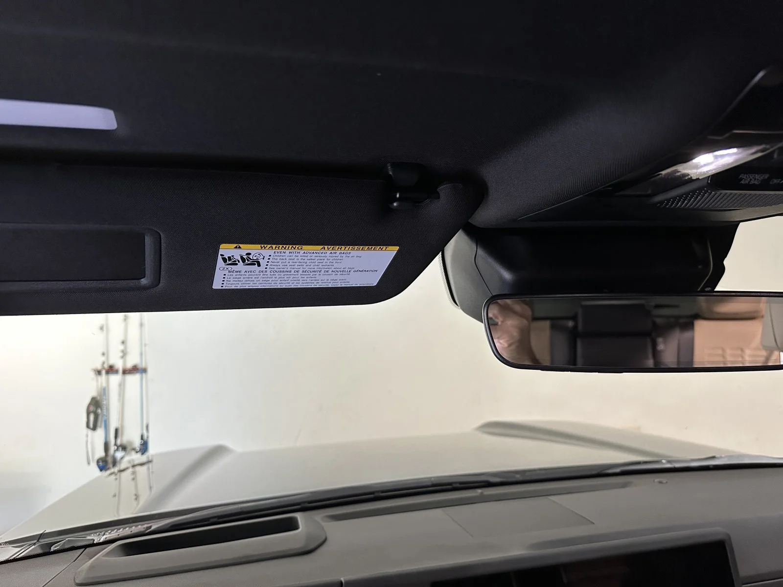

Do you guys think the dealer will install it on the Passenger side... or is it policy they mount it on the drivers side?
I asked and they gave me the "we are instructed to yada yada"...BUT my dealership installed it on the passenger side. They had me sign off that I requested it be installed there. The installer said Lexus knows this is an issue for driver visibility so he really didn't give me a hard time about it. Just ask to talk to whoever will be installing it.
