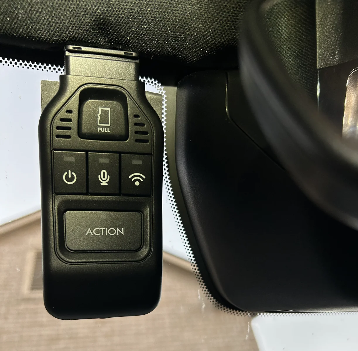

I successfully installed the OEM integrated dash cam in my GX. The process took three hours as I worked slowly and carefully. As shown in the picture, I removed the top portion of the camera to ensure it wouldn’t obstruct my view.

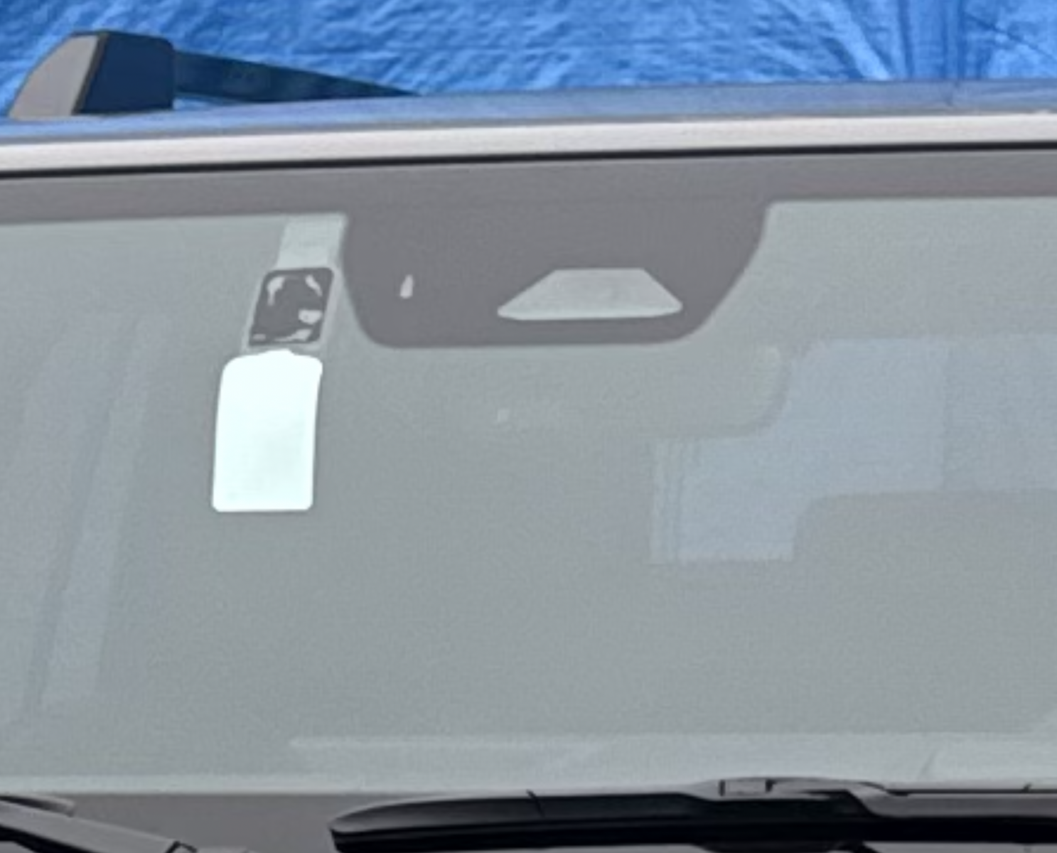

Dealer sent me a picture of my just-arrived 2025 OT. It looks like they are now installing the dashcam on the passenger side.

I took delivery of a GX550 OT+ yesterday - dash cam came with it - thankfully, it was installed on the PSSGR side from the port!
I can't believe Lexus ever thought mounting that hideous thing on the driver's side was a viable option. Just an oversight somewhere because of RHD in Japan? Seems ridiculous, but who knows.
