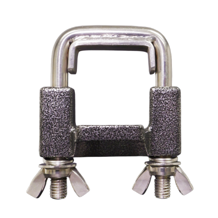

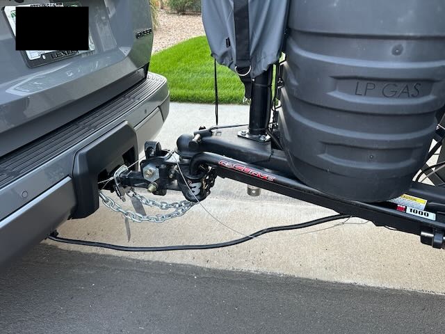

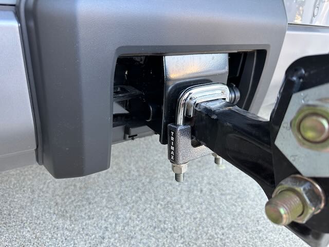

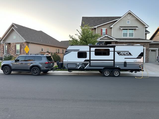

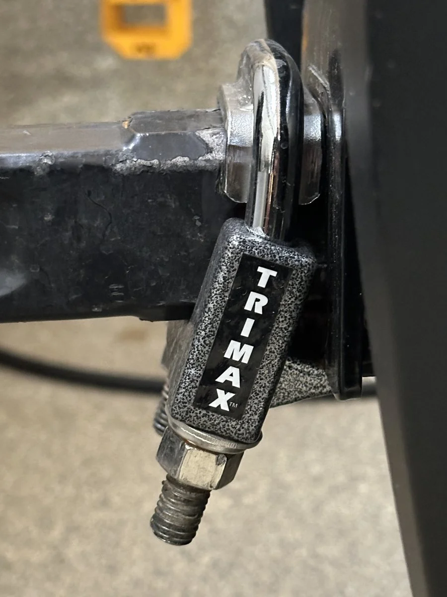

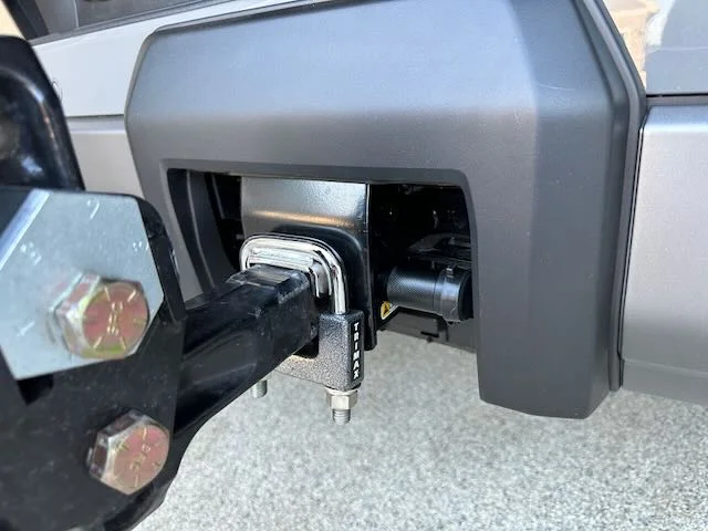

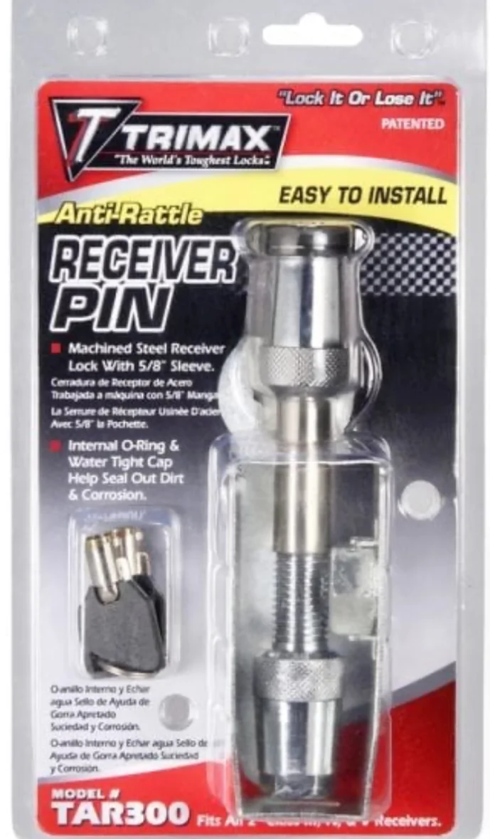

Moved my Trimax hitch over from my truck.

I tightened it to 80-100 ft-lbs. I based those specs on lug nuts and the fact that it keeps loosening, but you are right, the U-bolt has bent. Seems fine so far and can be removed/installed without issue.
Thanks, certainly makes sense but contradictory to the Trimax's website. I called and they claimed yes, only hand tighten and when I told them that's not what the packaging said, they ask me what I want.
It seems that it's working for you and what you're doing makes sense, thanks..

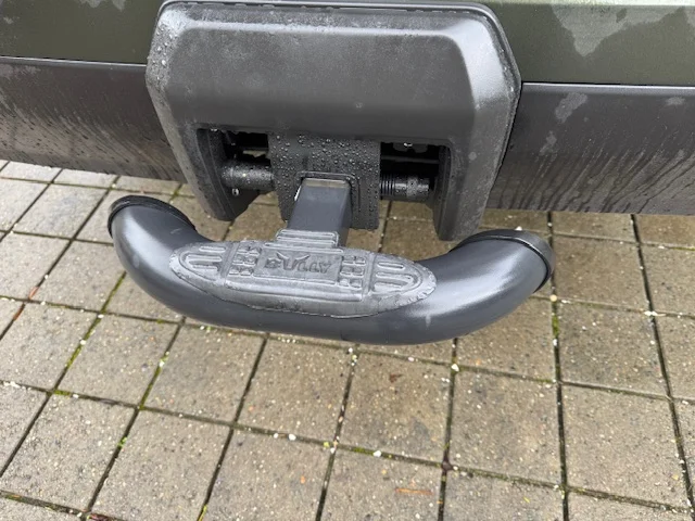

Hi all, I reinstalled the bully back bumper guard I had on my GX460 to my GX550. We are on ferries a lot and got a few times softly rear ended as the cars are loaded very close to each other, so the bully guard addressed this concern for good. Finding the right lock pin was a challenge though given the different size of the GX550 tow hitch and as I wanted to keep the upper tow hitch cover. I got this one from Amazon and it fits well once you position the rubber rings on the lock pin properly.

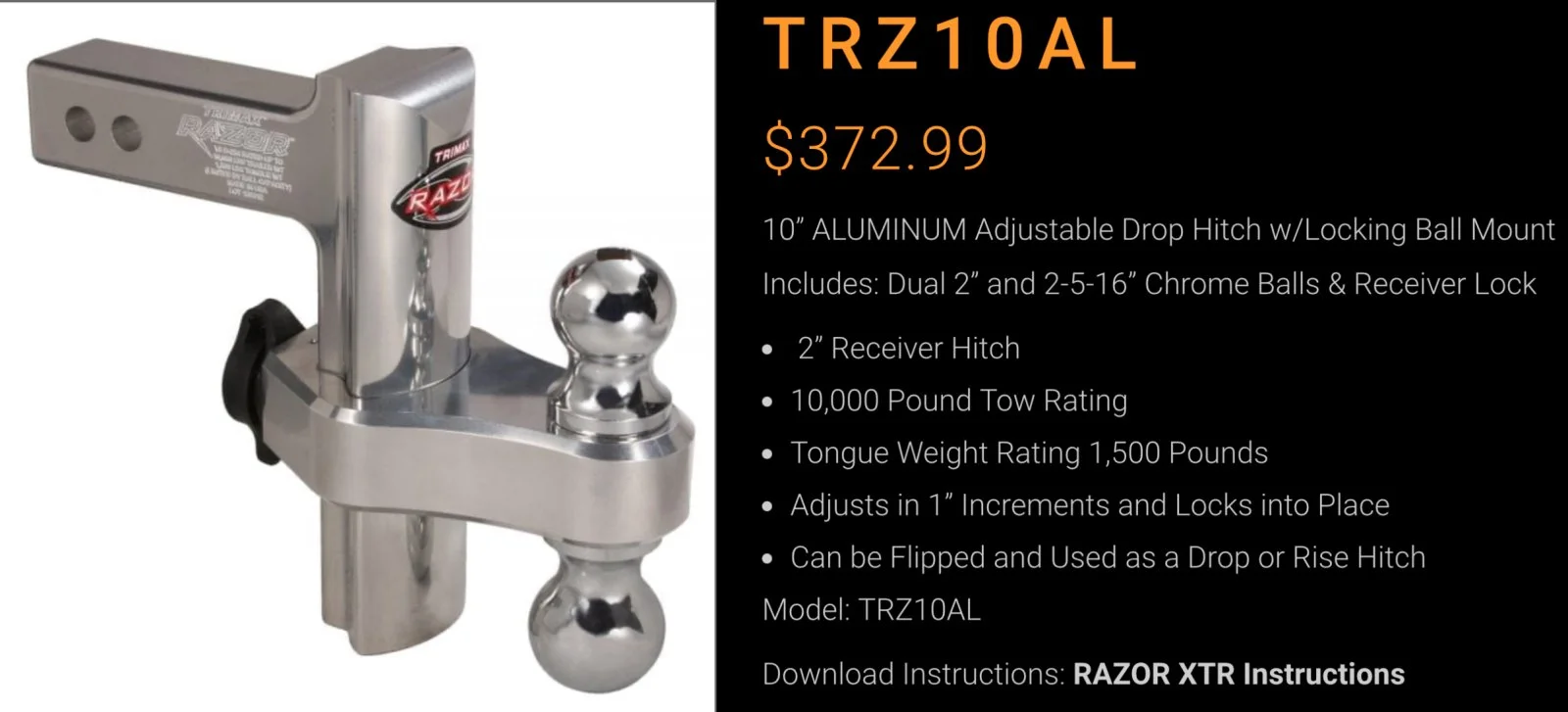

Has anyone experienced the height difference in hitches compared to gx460? I used 460 to tow my boat and hitch had a 2 inch drop. Now I had to get an adjustable hitch that goes to 9 inch drop.
I wish there was a way to lower vehicle with suspension.
