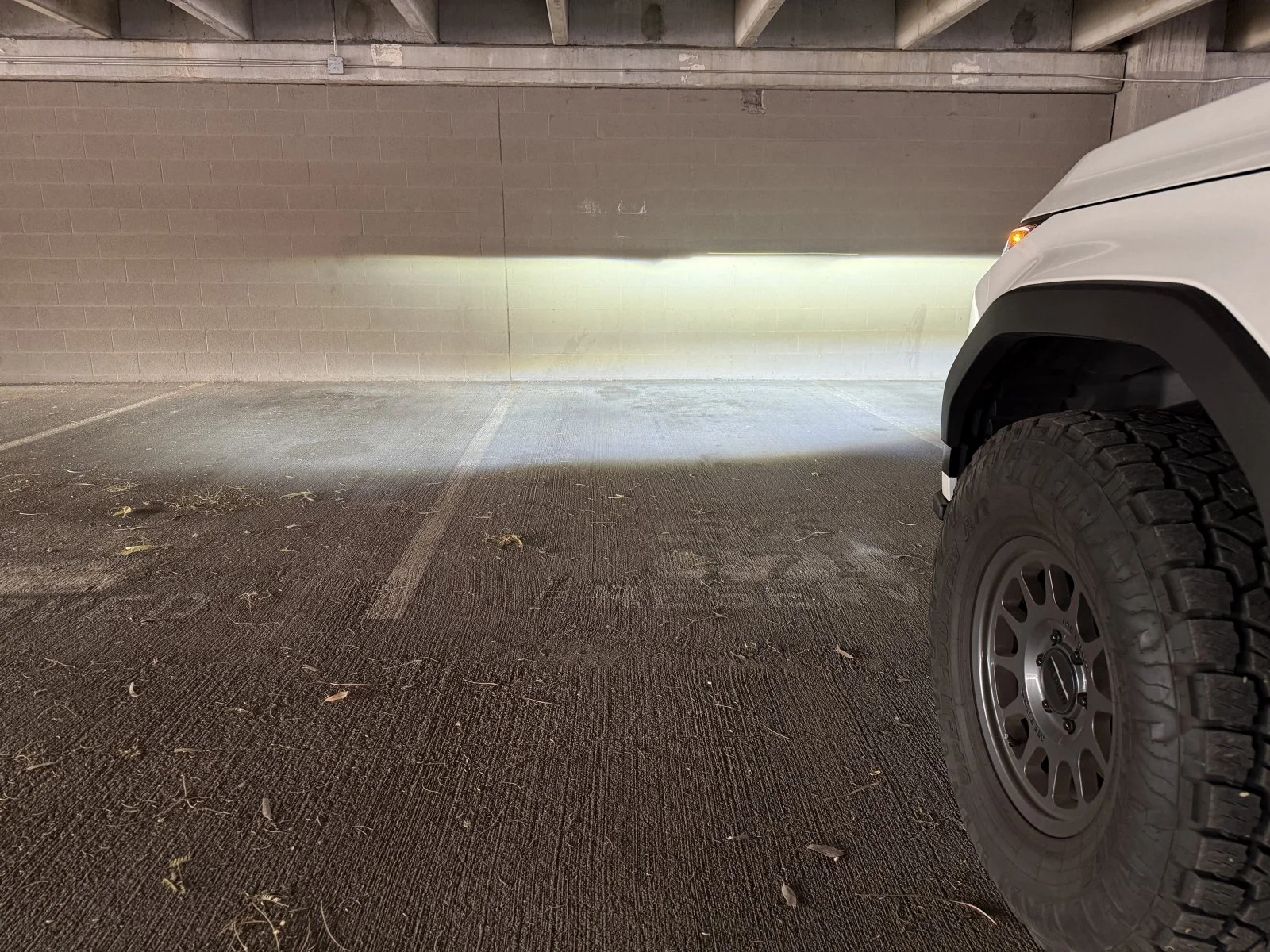

Another tip is to find a lower level (dark area) in a parking garage and measure out the 20-feet from the wall on a flat area of the garage. Then slap some tape up 44" on the wall and do your thing. This is how I always aim in my auxiliary lights. My driveway is sloped upwards so I can't do it at home.

I adjusted mine downward a while ago. I parked with the headlights 20 feet from a vertical wall and I marked 44" on the wall with some tape. The driver's side headlight is set a bit lower than the passenger side from the factory and I kept mine that way. I assume the driver's side is a bit lower to account for oncoming traffic approaching on the driver's side in this country. I adjusted mine to about 42" above ground level and they are still too high - people still occasionally flashed their brights at me. I need to lower them another inch or two.
I'm going to adjust mine later today and I'll grab some pics of the vertical adjustment bolts. I just reach in there behind the headlights with my right-angle socket driver and slowly make a few turns and you can watch the light creep downwards.
I dropped my headlights down a bit more. Look for the gray plastic bolt-head behind each headlight, about the middle of eachheadlight (see arrow below). As munkeeboi mentioned above, there is a second set of gray bolt-heads out towards the outer edge of the headlights but apparently these outer bolts are for side-to-side headlight adjustment (I haven't touched those).
Clockwise lowers the headlights. Just a few slow turns are all that's needed. The bolt-head is 8mm.
