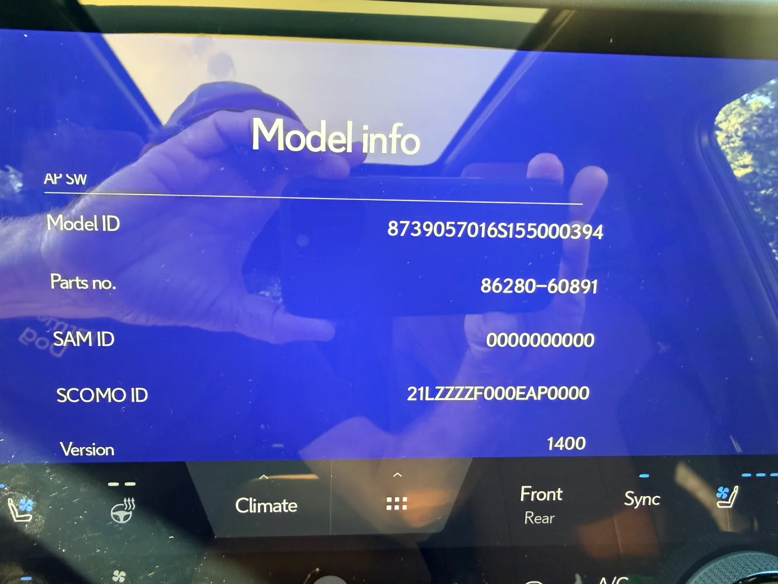

I'm on software 1300, and they won't update to 1402. Even the base-speaker RX loaner sounded much better in the rear than my Mark Levinson.
