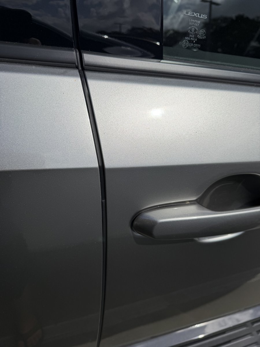

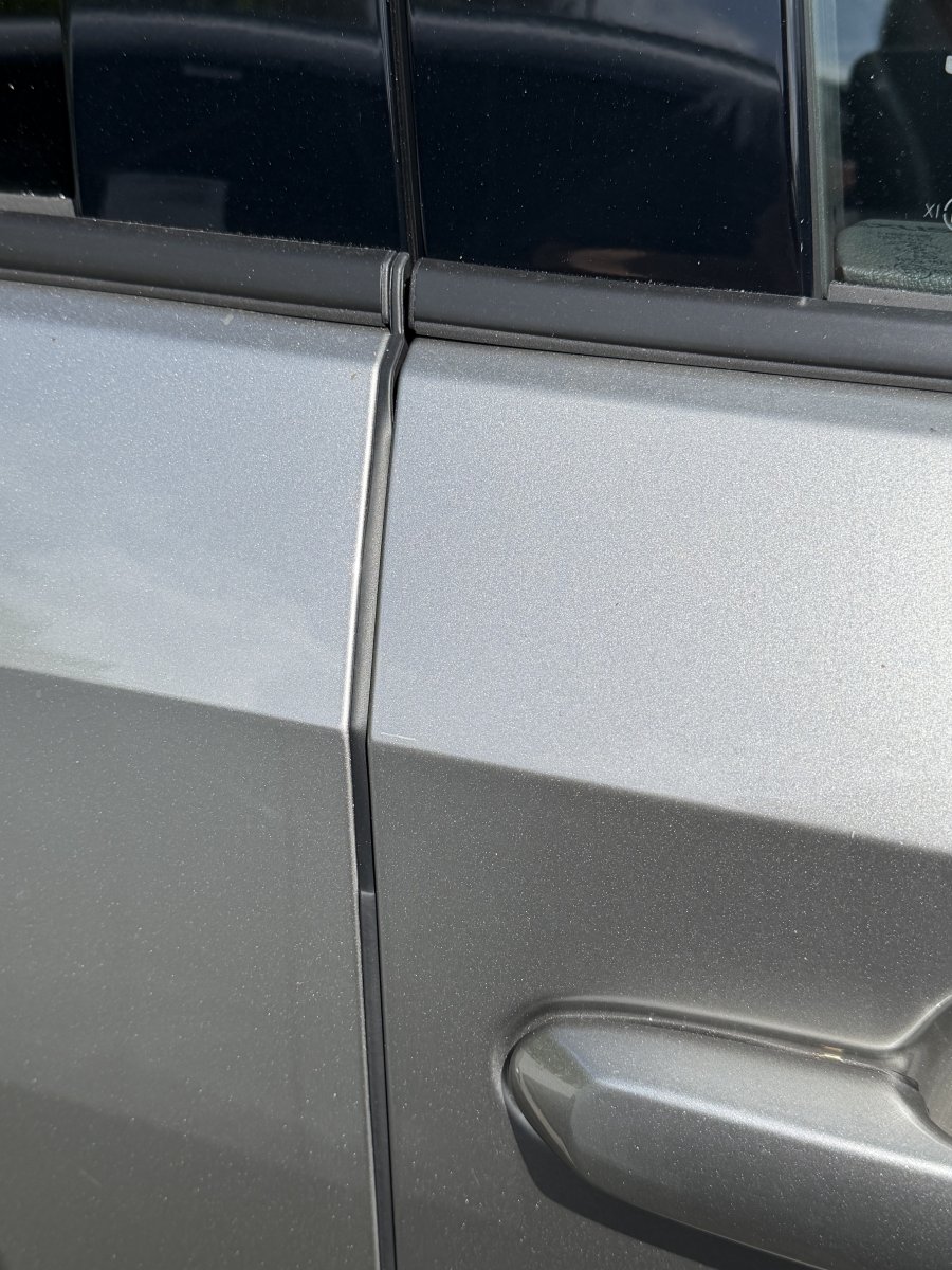

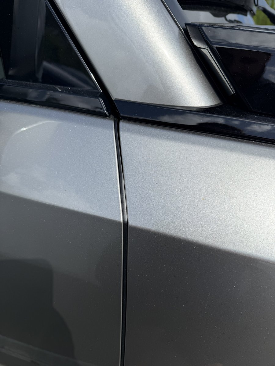

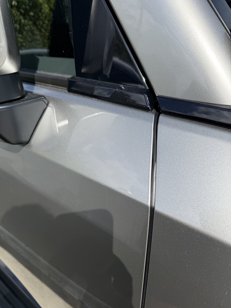

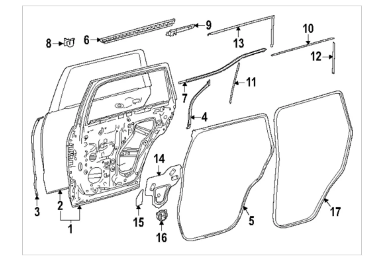

Could someone with an Overtrail+ please post a few photos of the door seals?
SFLGX posted:
For instance I noticed the trims that have the thicker glass also have extra seals between the front door and rear door and front fender and I wanted to add that to mine, except the seals clip into the doorframe itself with little plastic clips and trims that don’t come from the factory with it don’t have the holes in the door frame for the clips, meaning the OT+ has a different door compared to the regular OT.
I've noticed wind noise in my driver's side front door up around the forward edge of the window where the window top dives down where it meets the A-pillar. I've obsessively cleaned all the rubber seals and I can't quite nail down where the wind is making the noise. I'd like to add some additional rubber seals around the doors, if possible. I realize I can't use the OT+ seals (unless I happened to find OT+ front doors).
One thing I miss about my 2013 Land Rover LR4 is the door seals. It had a double-row of thick rubber seals completely surrounding all 4 doors. The doors closed like submarine hatches and were absolutely quiet.
I happened to be picking up parts at my dealer. Here you go. It’s from a Premium Plus but same seals:
ah.....so those body gaps are filled with seals. Interesting, thank you!
Yeah. To my knowledge the inner seals are the same, it’s just some weatherstripping along the gaps of the doors. Along with the dual pane front windows. I haven’t driven one back to back to see how much of a difference it really makes.
Can anyone post a pic or 2 with the doors open and how those seals attach to the door itself?
Edit: looks like the LX has similar seals and they seem to attach with 3m tape.. can anyone confirm?
They attach via little yellow clips
