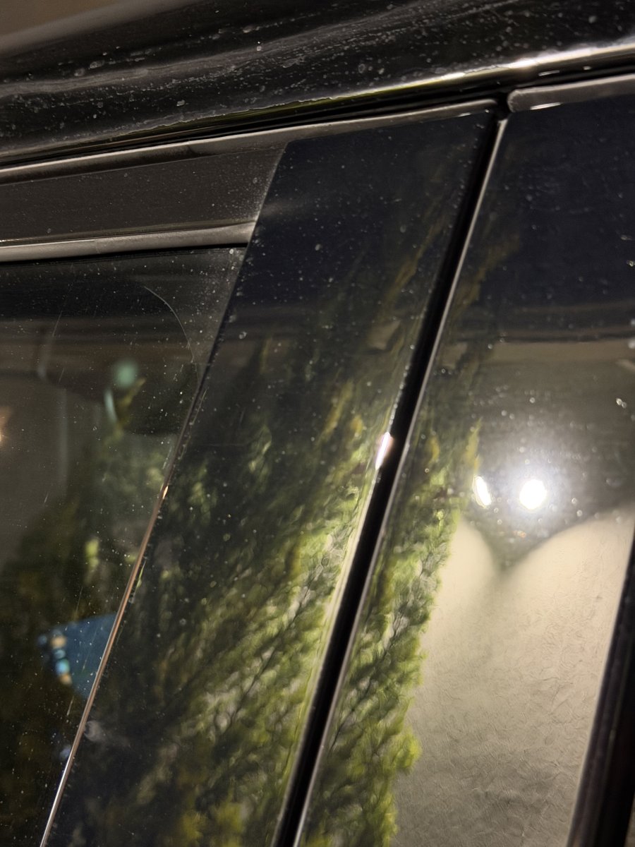

Overtrail plus glass

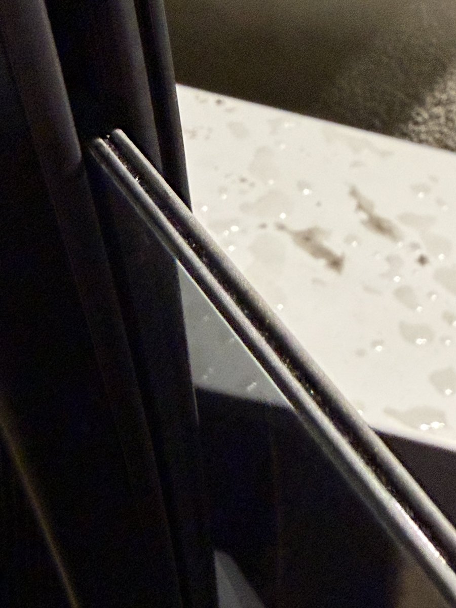

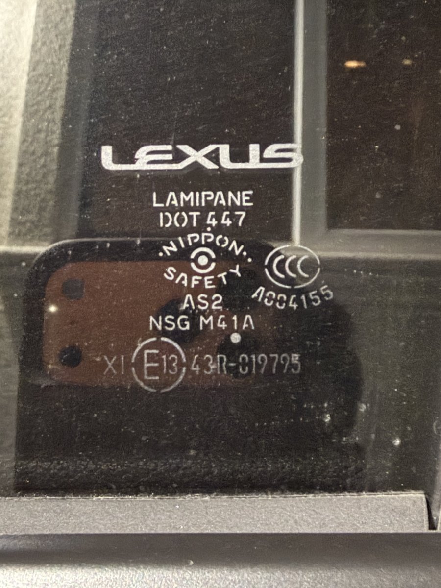

25 OT+ driver side window

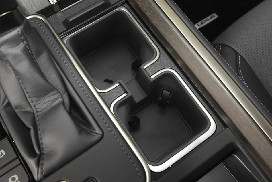

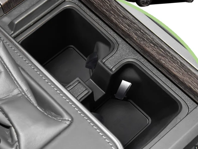

Would be interesting to see if you do it. I've found those by poking around other models at the dealership and via pictures. Most of those are very subtle and wouldn't be noticed, like the cupholders. Very minor and kind of strange they would even do that
OT + for instance:
Regular OT:

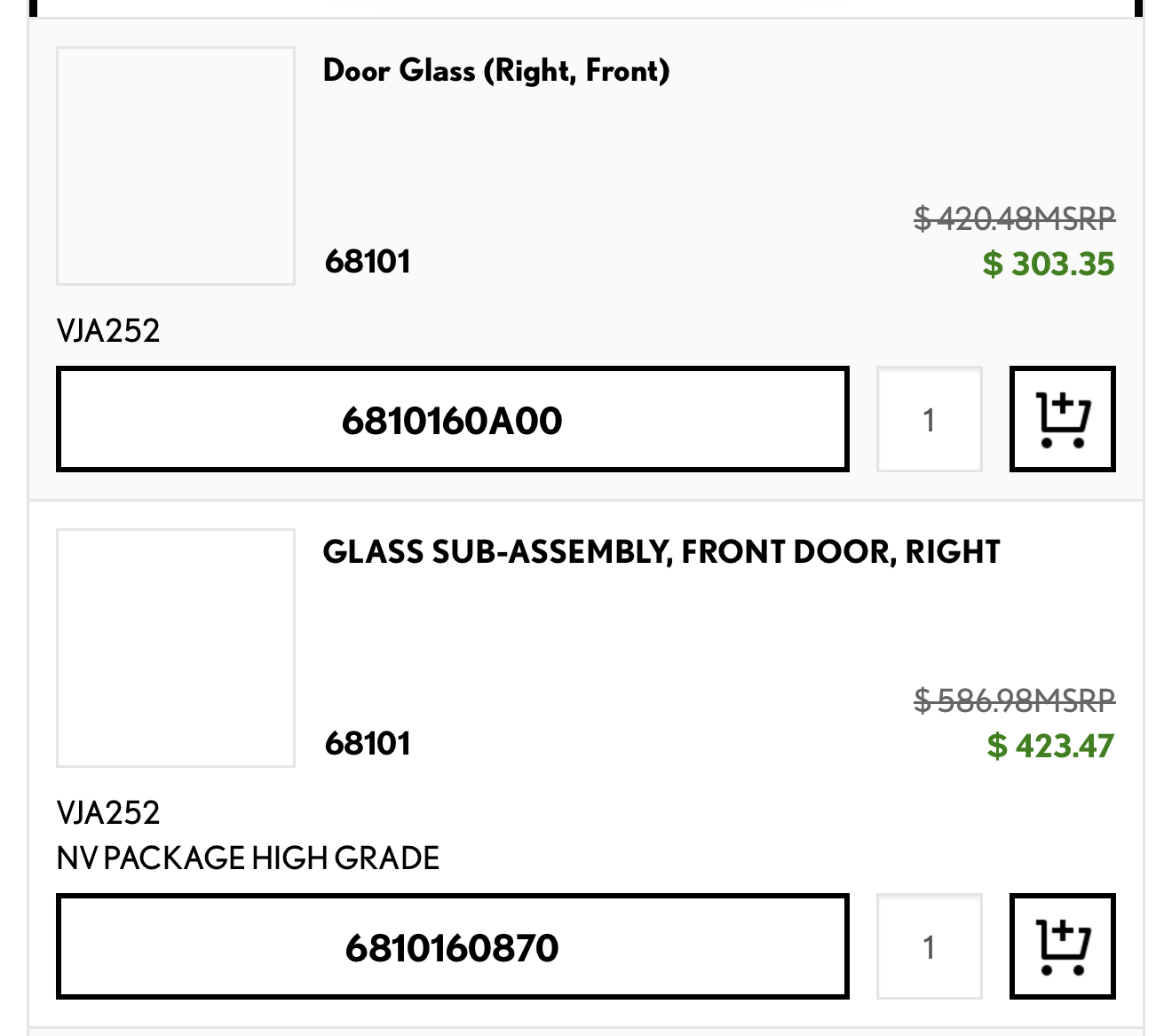

According to parts.lexus the side glass is the same for Overtrail and Overtrail plus
It’s not. The pictures here have proved it. Top is overtrail and premium glass bottom one is all other trims (premium plus, ot +, and lux trims)

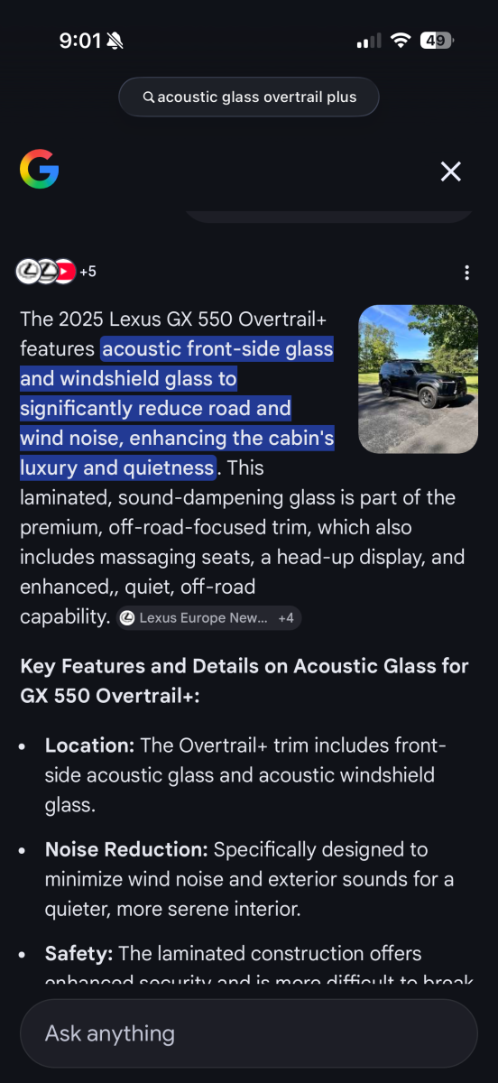

So is this double pane side glass only available on the vehicles with the Mark Levinson system?
when I search Lexus acoustic package, it seems to show only on the upgraded sound package.

No. It’s also on the premium plus which doesn’t have the ML sound. Basically all GX models except the base premium and regular overtrail has the double laminated side glass.

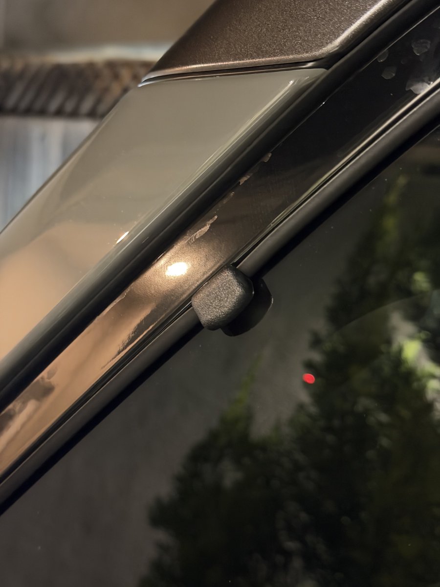

It can’t be. The glass is thicker and would require different channels to fit. That’s why the ones with the dual pane glass have that little nub on the front of the window frame. You’d probably need to upgrade all the window seals etc, which I’m not even sure if they’re compatible.
For instance I noticed the trims that have the thicker glass also have extra seals between the front door and rear door and front fender and I wanted to add that to mine, except the seals clip into the doorframe itself with little plastic clips and trims that don’t come from the factory with it don’t have the holes in the door frame for the clips, meaning the OT+ has a different door compared to the regular OT.
