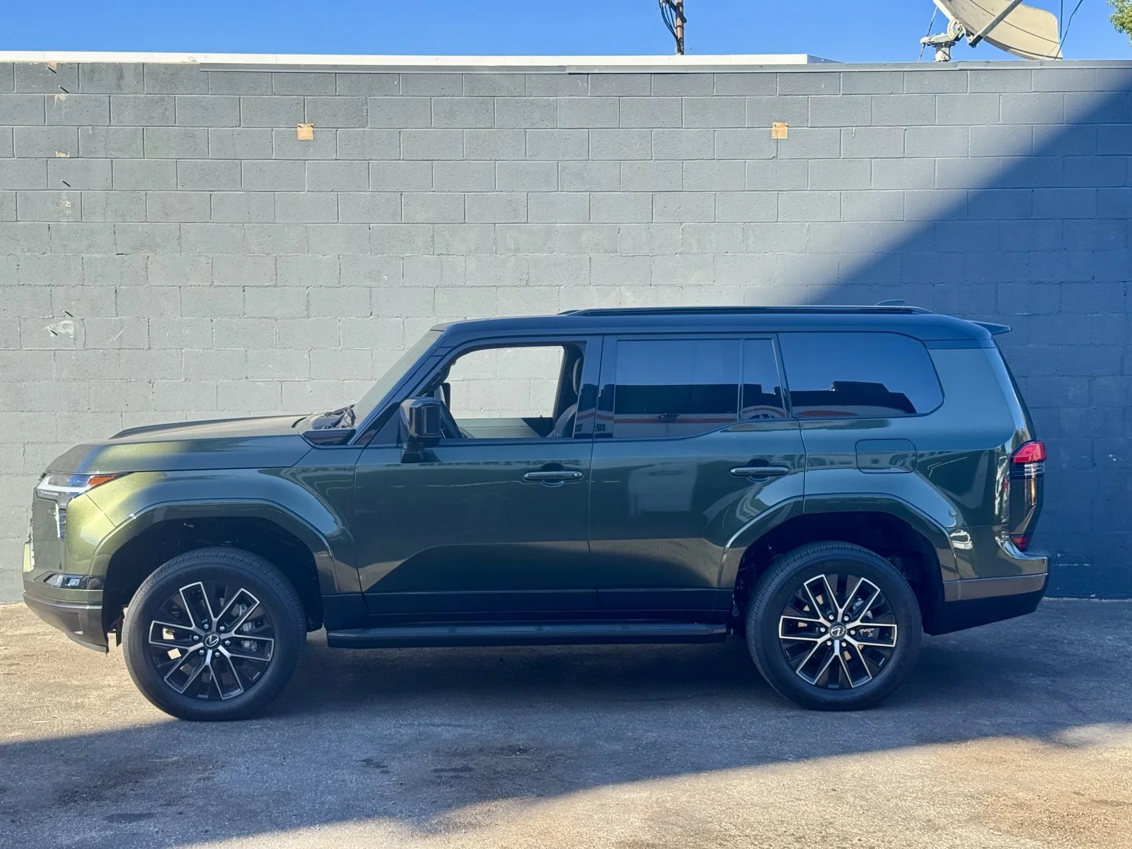

I only did the Peak top spacer in the front for a 1.25" lift. My GX still has 1" difference between the rear and the front when measuring from the center of the wheel to the fender.
No change in ride and gave me the mild lift and leveling I was looking for.

Looks good, any reason you opted against doing the rear?

Well executed and looks perfectly leveled! Doubt I’ll level mine but if I do it’ll be front only.

Thanks, your photo convinced me to go with Peak! I had a Westcott kit on order for about 7 weeks and after dealing with their terrible customer service, I cancelled my order and purchased the Peak kit yesterday. Got my tracking today!
