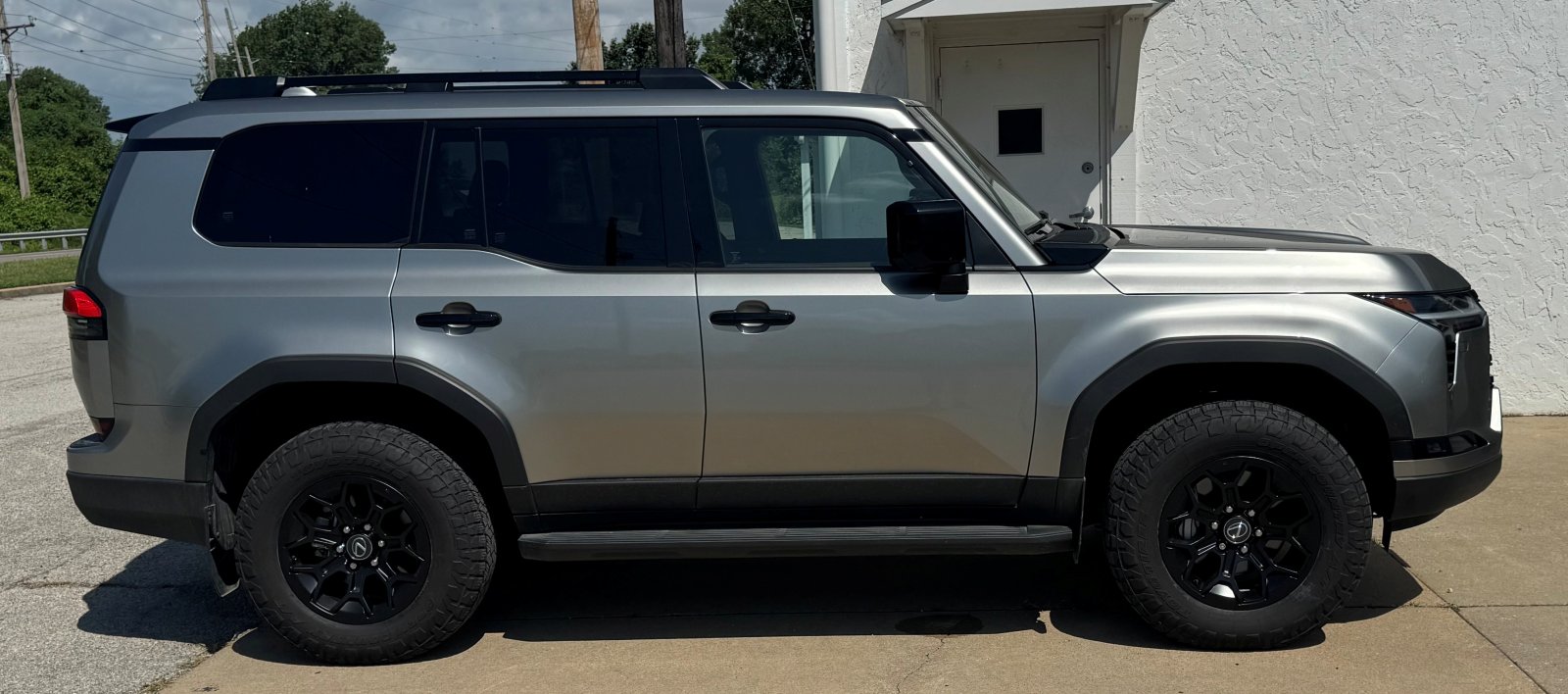

Just picked mine up this morning from the dealer for road force balancing and alignment after I added the spacers and factory Tacoma TRD Pro +20mm offset wheels on stock Toyo tires..
