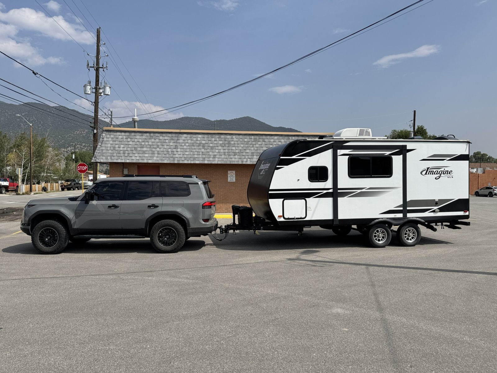

Dropped the GX off at Slee this morning. They are working me in over the course of this week as I have an extended trip coming up starting next week. As mentioned earlier, getting the ADS suspension. Last week, I was towing my off-road camper into the wilds of Utah again. You will remember I was having trouble with sway on pavement whenever the road began to have roughness or undulations. Not doing any real measuring, I began to perceive my trailer wasn't quite level with a VERY slight upward angle at the hitch. I found a different receiver that dropped the trailer hitch about 1/2" more making the trailer level.
I then went and weighed the total rig once I was all loaded up getting weights for all three axles. Driving up I-25 from Colo Springs, I had 42 psi all around for the GX and 60 for the trailer. The road behavior was unsettling at around 63 mph. Didn't like the behavior at all. After getting my weights (I have misplaced my weight sheet but recall the front axle was carrying 3000 lbs), I checked out the "load inflation tables" for KO3 tires for my tire size. Discovered I was way high on tire pressures! According to the tables, I needed to be at 34 psi on front, 35-36 on rear axle, and 50 psi on the trailer (trailer also has KO3 tires). After a few hours and a rain shower that cooled the tires, I adjusted the tire pressures to the new numbers. I drove up I-25 again and things were drastically better! I never expected that.
So, the new hitch and the change in tire pressure made a huge improvement. NO SWAY and vastly improved stability! I was shocked at the difference. Before, along with higher tire pressures, I was using Sport+ which "seemed" to control things better (the tendency to sway). And I now found the TOW/HAWL mode was significantly a better setting. I found my speed hitting 78 mph a couple of times as things were so stable (but I quickly backed off those speeds). But was often running 73 mph which I never dared do before. I was even beginning to think I didn't need to upgrade the suspension. But the behavior in rough stuff (on and off-road) and knowing the improvements DJ has seen, I decided to continue with the new suspension. I had Kings on my 2016 4Runner and I want that behavior back.

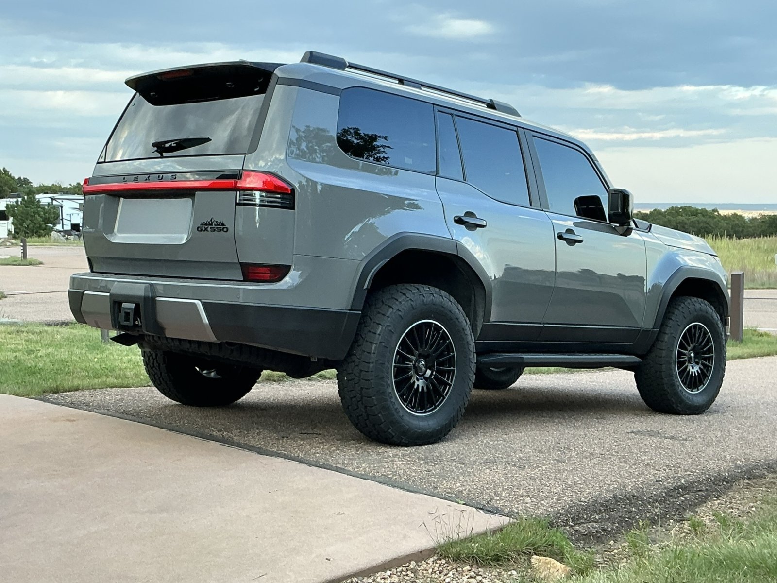

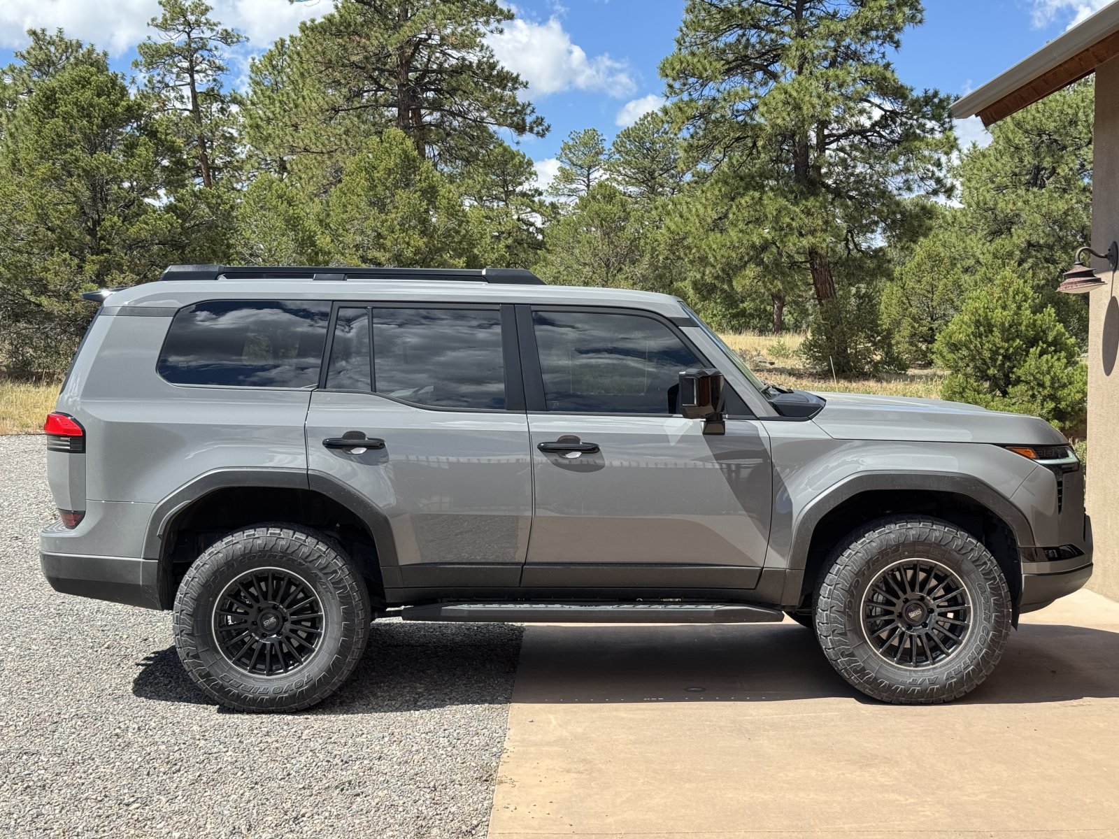

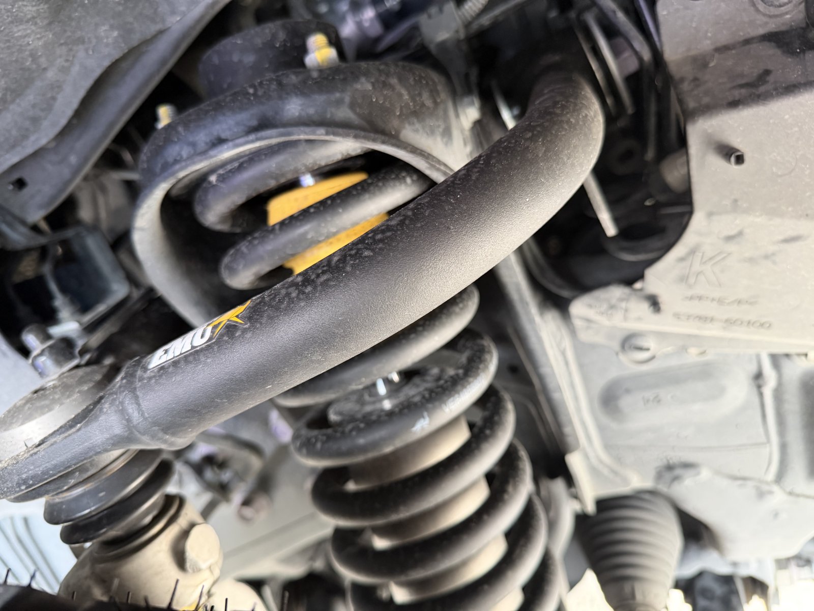

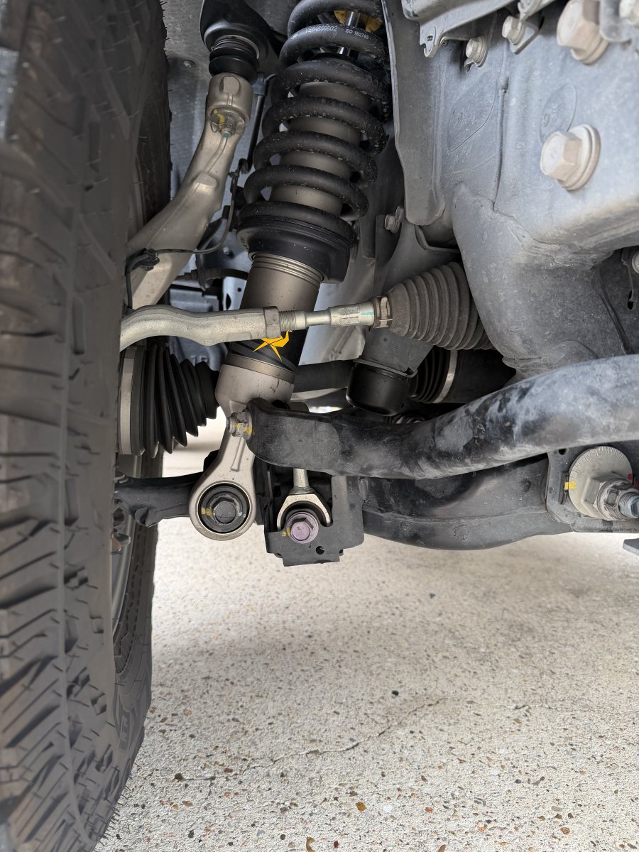

In a word, OUTSTANDING new ride!
I’m working on some good in-depth descriptions for everyone..so keep an eye on this post as I add edits, etc.
EDIT 1:
In one word UNBELIEVABLE!
Please excuse my ‘kid with a new toy’ enthusiasm, but that’s really what this MT64 suspension upgrade is for me!
The truck has been transformed. It’s like I drove across Colorado to Slee Offroad with a so-so riding vehicle, and then traded it in for something more fun, safer and smoother. I’m super happy I ponied up the $$ to do this. I didn’t totally trust or understand I’d get this much improvement, but I was wrong. It’s outstanding.
My 2024 Overtrail now steers with essentially perfect response and precision; there is no longer any lag or body movement waiting for the AVS system to respond. Everything on the road is now a true one-handed operation. I was able to drive as fast as I wanted..within common sense bounds of course, but could easily have gone much faster no matter the road surface. Yes, I gave the new suspension a good test. 🤫
It never waivered, the truck never jumped around in severely bad sections of road at speed (as it did previously, regardless of AVS setting), all the dramatics are gone. I was able to dive into high and low speed sweepers with complete aplomb and near abandon, and quickly learned I could go even faster than I had previously. It was a quick learning curve!
I drove over on US 50 and 285, with about 33.5 psi cold on a hand gauge (not the TPMS or Viair gauge) on the same SL Terra Grappler G3 tires I’ve had the past several months, 275/70R18. I returned the same way with the same tires and same psi.
I intentionally began driving through and over all kinds of badly deteriorated road sections. Through many of the high speed sweepers I did everything you’re typically not suppose to do while cornering: I was braking, downshifting and intentionally hitting torn up surfaces - all at the same time. At first I was in disbelief..so I did that over and over again. No nose dive, no sudden shift of vehicle weight, no abrupt change of course. Just total composure and float and holding the line. Much safer.
I did have some time on city streets too, running errands at Stevinson Lexus and a local Costco. I had to dial back my speeds there too; the GX now seems to want to go faster and faster. It’s far more plush now on crappy local streets.
And it seems the vibration issue is virtually gone. I no longer felt it yesterday. I will confirm over the next few days. 🤞
Slee did a great job. Their installer has now done several of these kits; he is basically their LC250 and GX550 guy. They did the realignment, checked the headlight adjustment. We also talked about a few other things, and took a quick test drive including on some rutted dirt in MTS Dirt mode. Everything was normal, but the ride is more pleasant now.
I was fearful that I might miss ‘having’ the AVS; that I might miss fiddling with the mode selector every time I wanted to go faster, or get a softer ride in town, or make a change for a really broken stretch of road. That fear went out the window really fast.
It’s as if the MT64 has its own internal brain. Softer and plush on city streets, instant response driving over junk, and excellent, confident composure at higher speeds. It’s great not having to think about the suspension anymore!
Absolutely amazing! Again, I’m super happy with this upgrade!

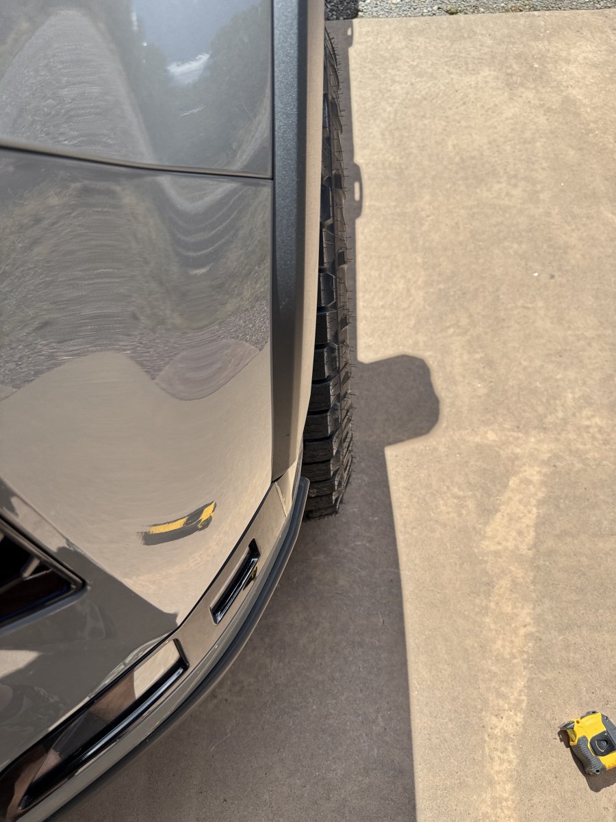

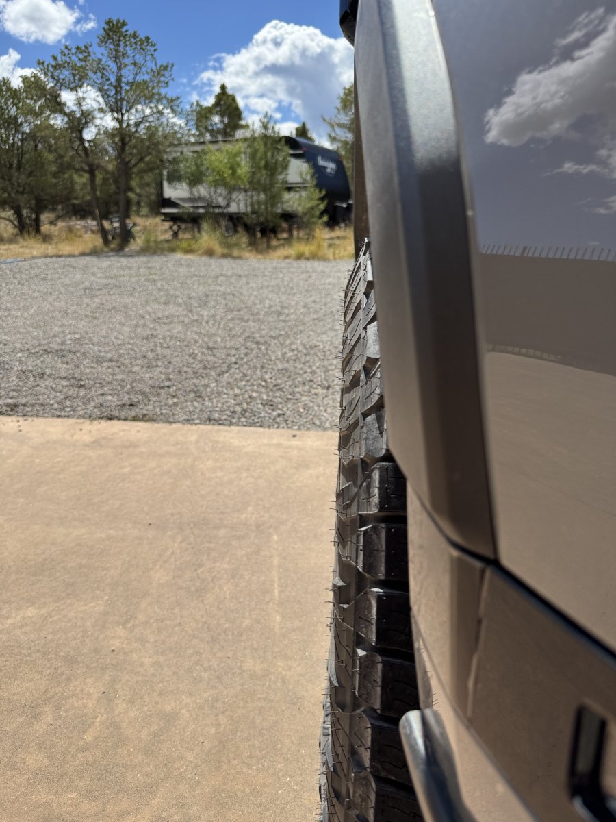

Some of you may have wanted some before and after measurements, which I failed to do. 🤔
I can do some post-install measurements later though. But Slee aimed to accommodate my towing needs also. So we ended up with a little bit of designed-in rake to handle occasional bigger rear loads. I hope to get the trailer hooked up in a couple weeks and try it out.
However I can definitely see and feel the lift. It’s a very welcome change.
IMO this is how the Overtrail trims should come. Or at least this should be offered as either a PIO or DIO. It just makes the truck that much nicer.
I’m also contemplating larger tires and new wheels in the future. However, my GX now handles and rides so well..that I’m a bit afraid to change anything!

I wanted to give you a sort of ‘final update’ of my own experiences while towing after my recent upgrades. The final key for me was upgrading to the E rated tires (Toyo 285/70R18, mounted on 18x8 +25 rims) just 2 weeks ago. I haven’t been as disciplined or detailed as you in weighing my double axle trailer which is a full 8 feet wide, very tall, about 22’ long hitch to tail. But basically I’m somewhere in the range of about 550 tongue weight. I use a WDH (solid bars) which also has an anti-sway mechanism. The hitch ball height is adjustable in 1.25” increments. My first tow I used 50 psi cold. I may play around with that pressure in the future.
The huge improvements and my ‘towing goals met’ I chalk up 70% to the MT64 suspension upgrade and the final 30% to the E rated tires. The new tire stiffness, resistance to lateral rolling (deformation), and a tad wider track (tire/wheel combination) are the tire’s contribution. I’m guesstimating about 3/4 to 1” wider track gained each side, based on the new slight poke - which looks great BTW.
We returned from our C.Springs ‘camping’ trip on Saturday. Before departing I debated whether to once again drop the ball height down. On the way over it had been at its ‘normal’ position, and the trailer was just very slightly nose up - depending on where I stopped to view it.
So I dropped it down for the return. It was the final key to making everything essentially perfect. The trailer now has a very slight nose down ride, the GX sits about perfect, the braking is safely normal, and I don’t have to consider installing airbags.
I’m super happy with the setup now. It pulls really well. It corners great. No sway, no weird bobbing up and down, bad spots on the road are immediately muted, no unsafe or scary input to the steering wheel, etc.
Yesterday I made my first ‘high speed’ non-towing run on the newly completed setup, tires set at 30 psi cold the previous day. If you’re familiar with the US-50 Delta-GJ portion you know it’s a super undulating, wavy road, with some lateral stunts thrown in for good measure.
I cruised that 75-85+ without issue, the tires and suspension working extremely well, floating through everything one-handed with great composure, really astonished and realizing I could have done 90-95 (but wouldn’t do it on that 65 mph road). I travel this stretch often - none of my other vehicles could do this so easily.
So..if there any questions, let me know! For myself I’ve met all my goals, I’m really happy with the new underpinnings on my GX. 😀

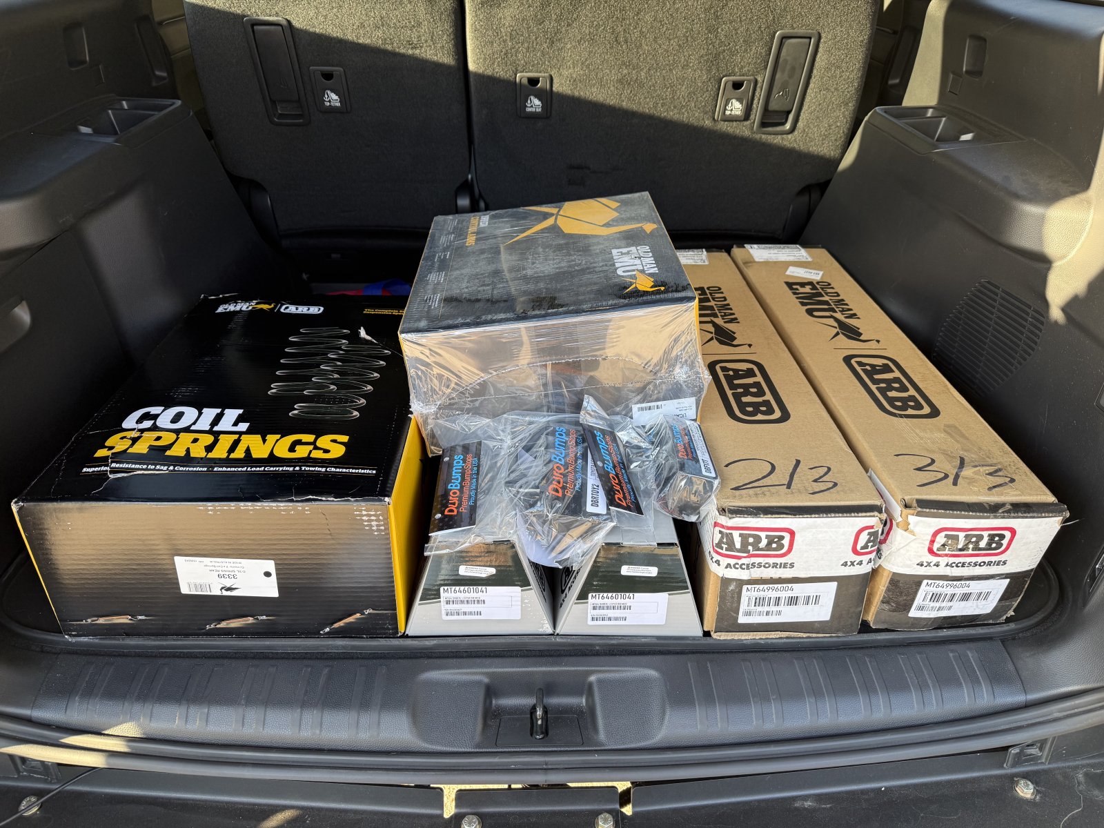

Having the OME MT64 suspension kit with DuroBumps installed tomorrow. Felt an upgrade was necessary after installing the Dissent bumpers front (w/ winch) and rear (w/ tire carrier). The extra weight affected the ride (more sway and some bounce / a little unsteady on turns at speed) and ride height. Thanks for all the info on this thread. Not sure I would have pulled the trigger without all the feedback.

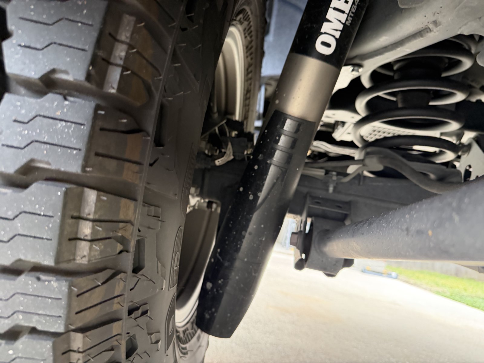

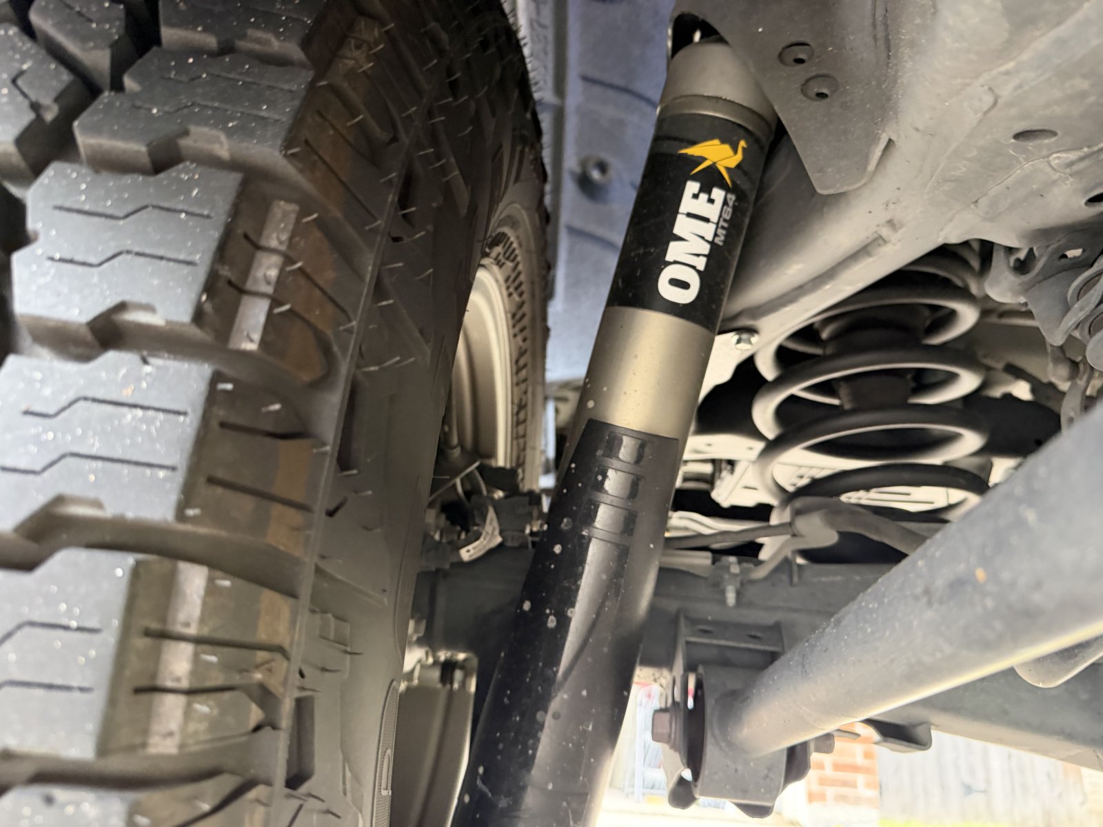

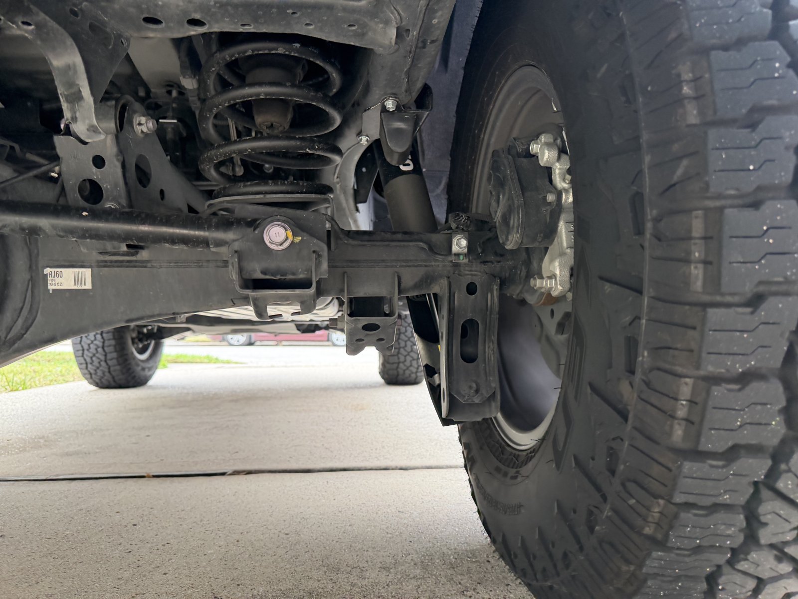

I've put about 3,000 miles on the MT64s. Smooth, Firm, Composed. Smoothed out a lot of rough edges with the suspension. Rough patches that would produce a washboard effect are completely different. I'm still aware of the rough road but the GX doesn't hop around any more. Back seat still shakes at highway speed, but less than before. Turns feel pretty close the Sport Plus setting with AVS. There is a little give at the start of turns but the suspension very quickly responds and holds the body steady. And that's where the composed feeling comes in. The suspension always feels in control. All of the jumpiness and and uneasy feeling of the OE suspension with the extra weight of the fenders is gone. I did the 2126K set rated for extra 220-330 lbs in front and 440 lbs in the rear. I considered 2128K which is 880 lbx in the rear, but chose 440 based on the weight of the Dissent add-ons and spare tire being at 340. Hopefully adding any additional equipment (auxiliary gas tank, drawer system, recovery gear) won't make me regret that. Time will tell but so far I am very happy with this suspension. One other observation is that the vehicle was noticeably taller. Added over an inch of lift compared to Westcott.
