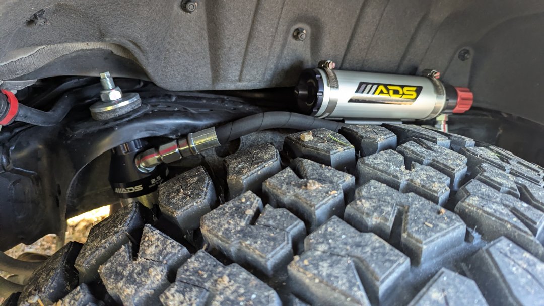

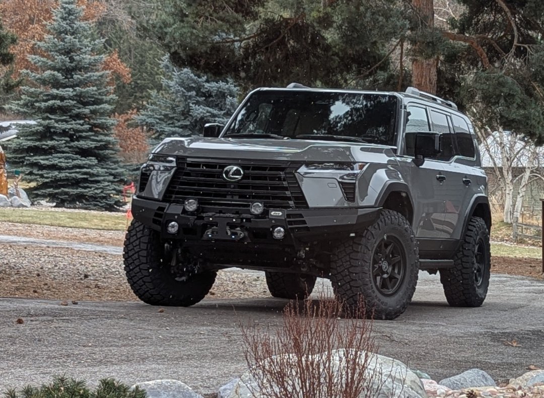

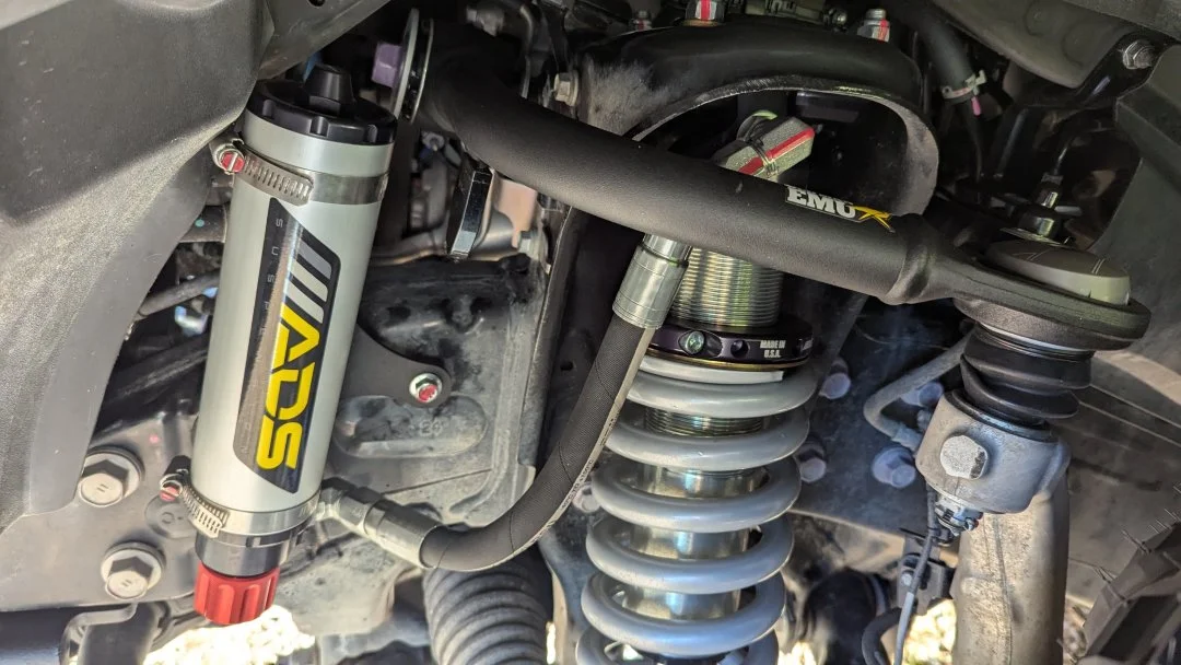

Slee's ADS suspension,
35x12.5 17 Toyo Open Country R/T Pro
Looks great!

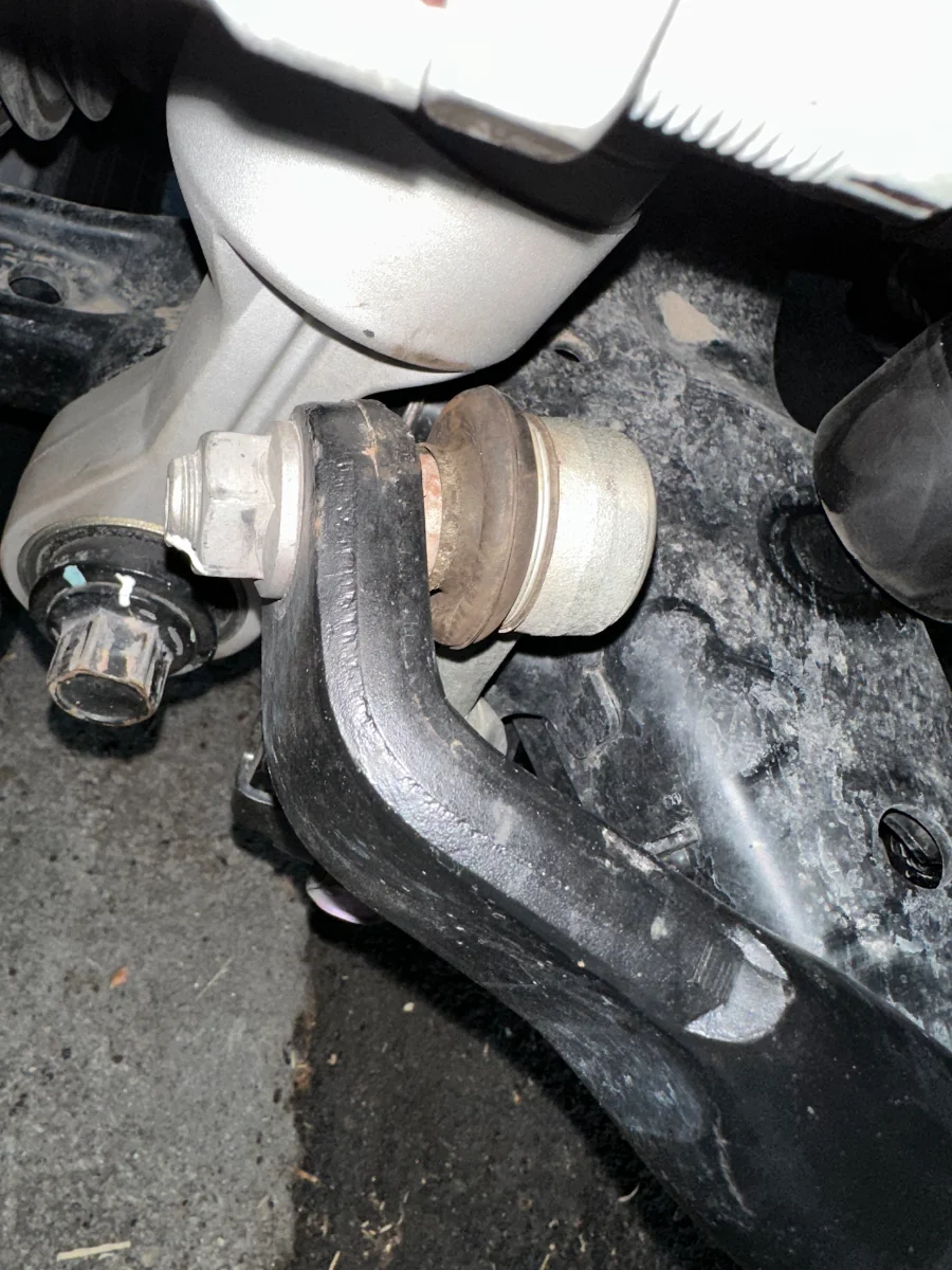

The front MT64 shocks are almost touching the swaybar end links. Had a quick chat about this with DrKDSS and he's aware of the issue but it's not obvious if it'll actually bind under some conditions. I'm going to run some experiments. I'm told it's an issue with 2.5" or more of front lift and the specific MT64 wide body, but it looks like Kings and others have similarly wide bodies.
As for the AVS- I'm going to do by best to waterproof the (now unused) connectors. Although everyone says no CEL/dash lights after disconnecting, I've seen several places mention that you will eventually get an AVS error message if the battery is disconnected for long enough. The computer will run a system check and scan for the AVS shocks when power is back. From my understanding, the only way to clear that code is to reconnect the old (possibly rear only) shocks to the connector to clear the code, then unplug again. Hopefully, never going to see this happen in real life.
