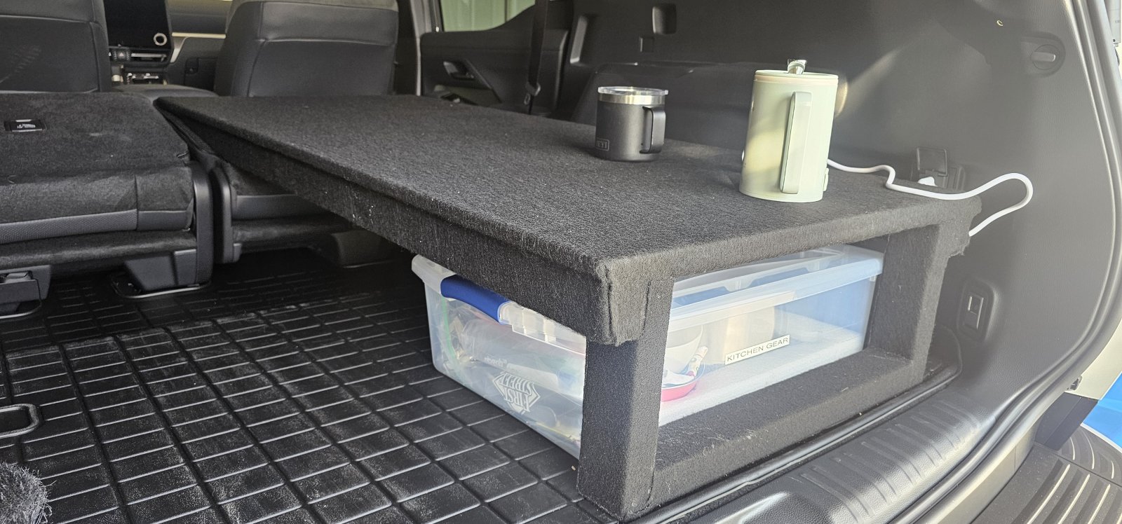

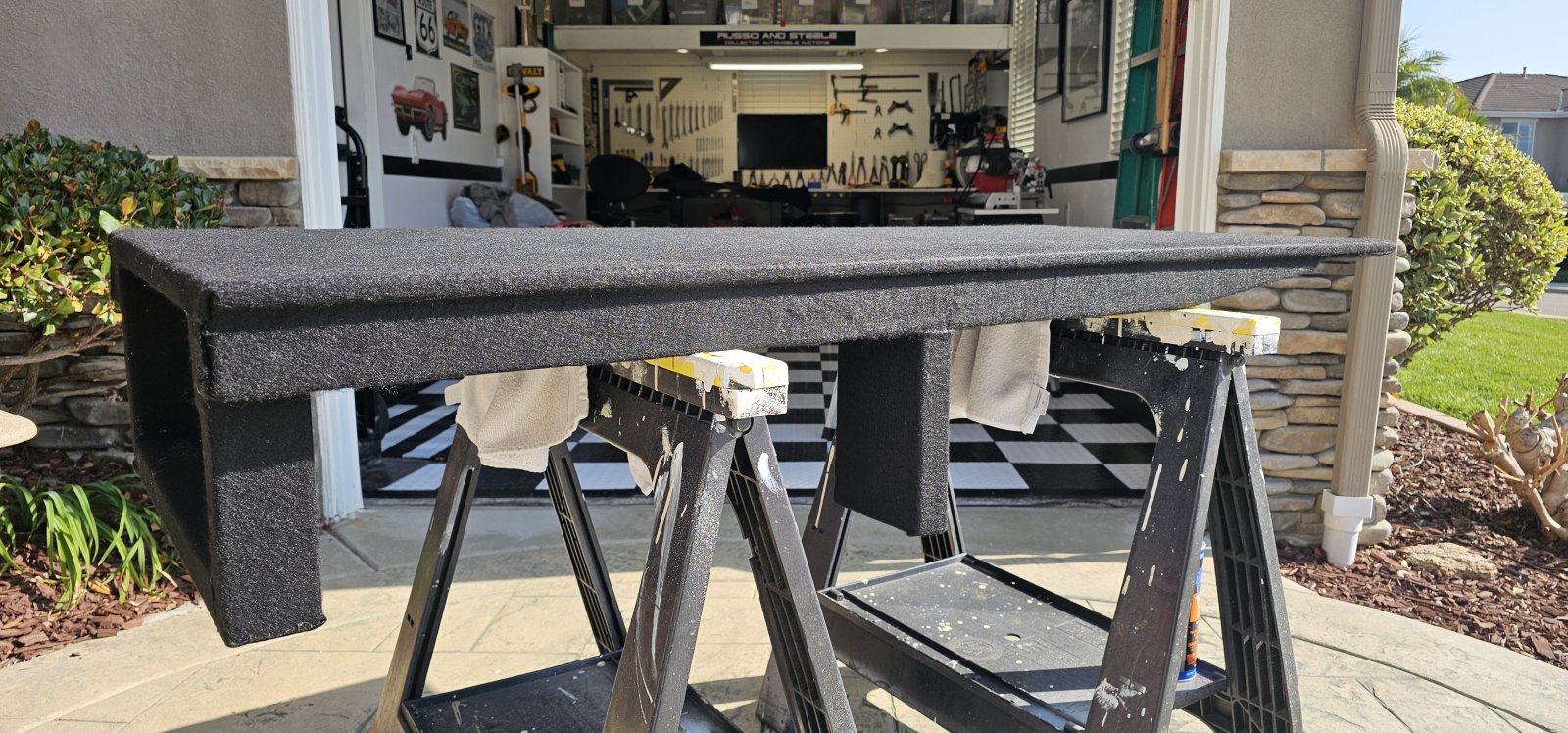

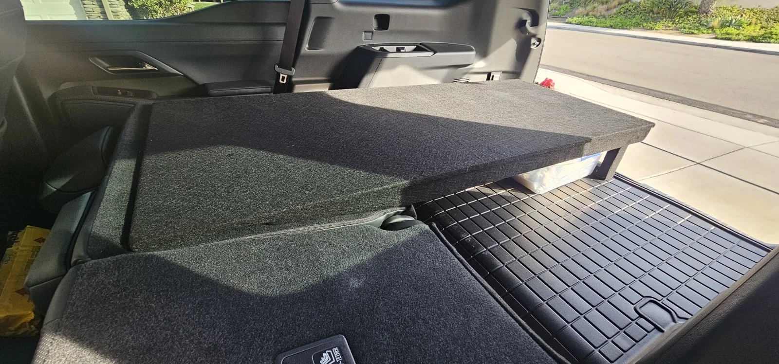

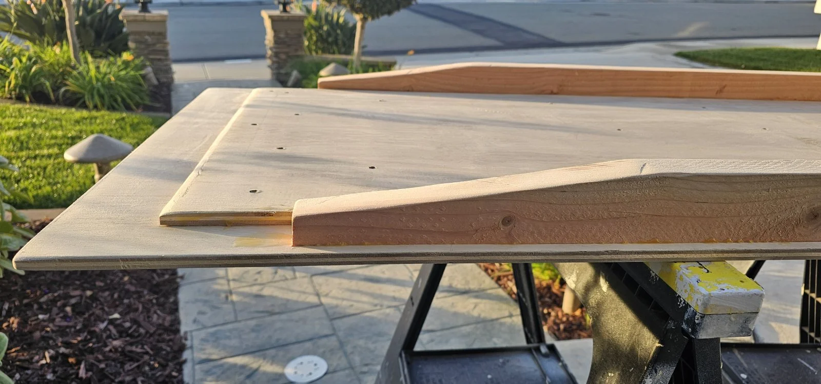

I built a simple bed platform for the back of my new Overtrail. I used two sheets of 3/8" plywood, and added a couple of 2x3's for support rails. The bed is level and it provides space for storage under the platform. I covered it with black felt, so it looks quite presentable. It's very sturdy, with no flex at all. Best of all, it's very easy to move in and out of the truck as required. I will be testing it out tonight on a trip to Joshua Tree.

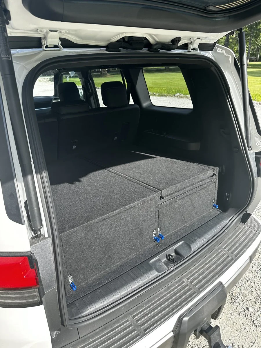

Any dudes or dudets looking for a platform or storage system for the rear cargo area? Sleeper platform, sliding drawers, sliding fridge, etc etc….Air Down Gear Up is about to officially release them! They worked with Ben from Dissent Off-Road on their new LC250 and worked with me for the GX550. It’s SUPER LEGIT!
