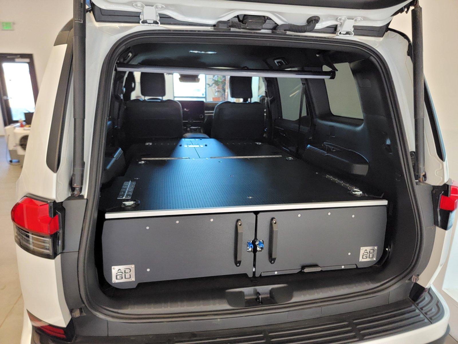

Any dudes or dudets looking for a platform or storage system for the rear cargo area? Sleeper platform, sliding drawers, sliding fridge, etc etc….Air Down Gear Up is about to officially release them! They worked with Ben from Dissent Off-Road on their new LC250 and worked with me for the GX550. It’s SUPER LEGIT!

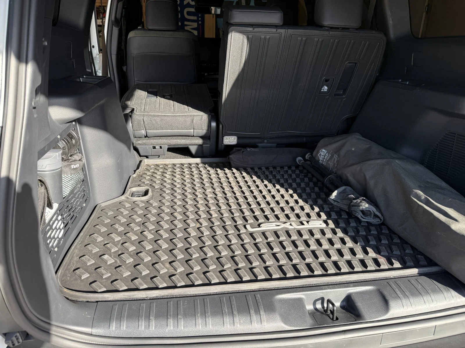

The Overtrail rear cargo area with rear seats folded in half (not tumbled forward) is 43" wide at the narrow point between the wheel wells and, on my truck, 74" from the back of the driver's seat in normal driving position to the inside of the cargo door.

There will be plenty of room in the GX550 Overtrail front-to-back for this 72”-long platform. For my driving position, I have about 76” to 77” of length between the driver’s seat back and the inside of the rear cargo door. The seat slides forward plenty (a good 8-10") but the limiting variable is the center console which is 80" from the rear cargo door. The 24"-wide single platform will obviously fit width-wise and so will the Duo platform. The Duo is 40” wide and the width between the narrowest point in the cargo area is 43”.
The length and width of the platform will fit but I was wondering if the layout of the legs on the platform would work, and if the adjustable lengths of the legs would work. So, I worked up a quick sketch of the rear cargo area (Overtrail, no third row seats). These measurements are with the thick Overtrail rubber rear cargo mat installed. See the image below.
The Hele website and their videos say the range of adjustability in the platform legs lets you go from a floor-to-top-of-platform-frame measurement of about 8.75" to 14". I’m assuming the frame tubes are about an inch in diameter so the real adjustability is about 7.75” to 13” to have the frame clear something like the seat back. And you can adjust in 0.5" increments.
The spacing of the three pairs of legs on the platform should work fine. The length between the rear-to-middle and middle-to-front legs should work, with the middle pair of legs falling right into the dip in cargo floor immediately behind the second row seats. Note that the platform frame is 72” long with the front and rear legs set in about an inch and I’ve assumed that the middle pair of legs is in the middle of the frame, or 36” from the front and rear.

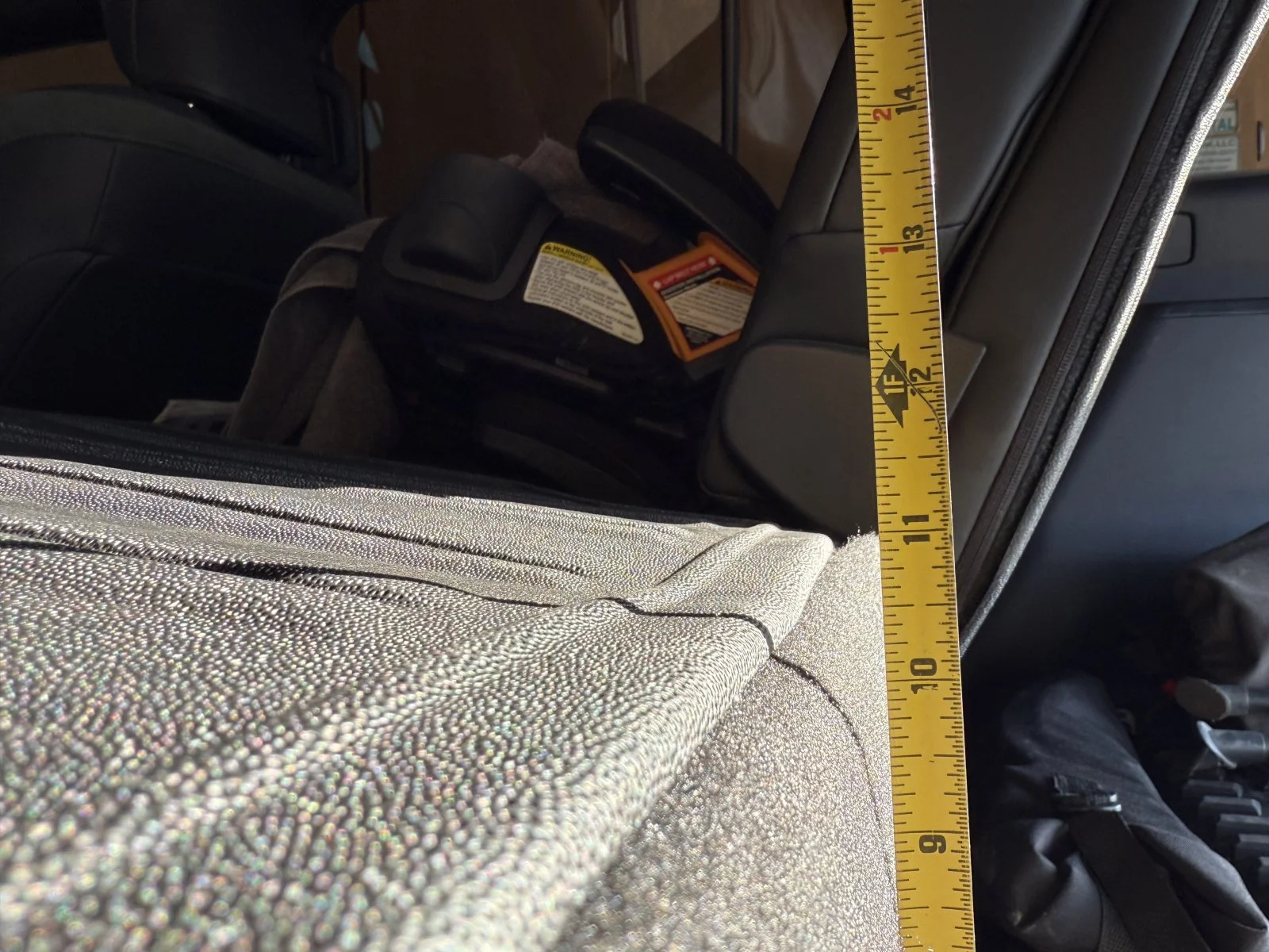

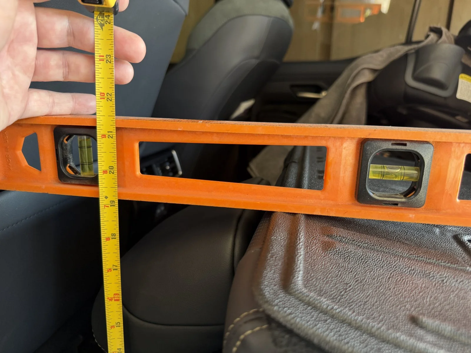

The limiting variable for the length of the legs to work is the height of the forward edge of the second row seat when the seats are folded “flat”. They don’t really fold flat – the forward edge is a bit higher than the rear edge. The forward edge is 19” above the second row footwell floor. The level line of the forward edge is about 13.5” above the dip in the cargo floor directly behind the second row seat. Note that the 19” measurement is really 19-1/8” but the folded seat will compress when you’re lying on it – it may compress a couple inches. So technically that 13.5” height measurement behind the second row seat is about 1/2” over the max adjustability of the platform legs but it should hit the floor when the folded seat is compressed.

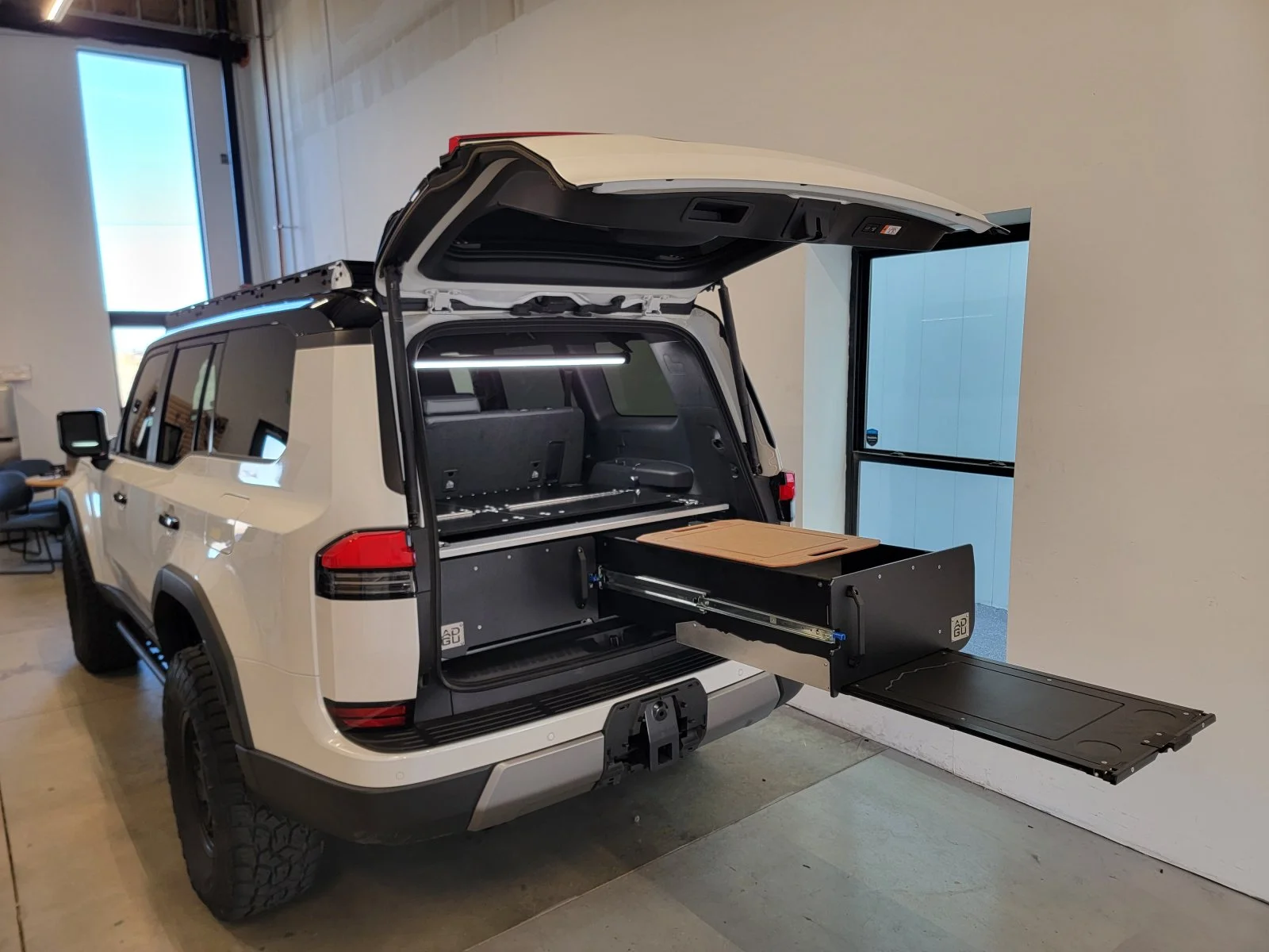

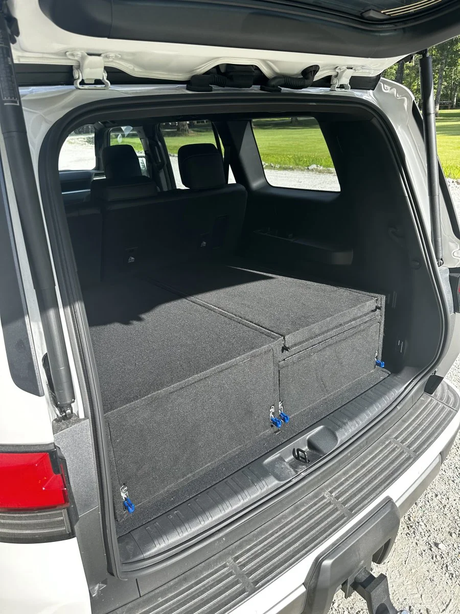

Finally made it to this forum! Thanks for the post, we had a great time creating your system. We've done a handful of installs since then and have optimized more of our sleeper and mounting brackets. We gotta get you set up with the new brackets!
Our sleeper sets up in seconds and allows you to retain your 2nd row when the sleeper is not deployed.

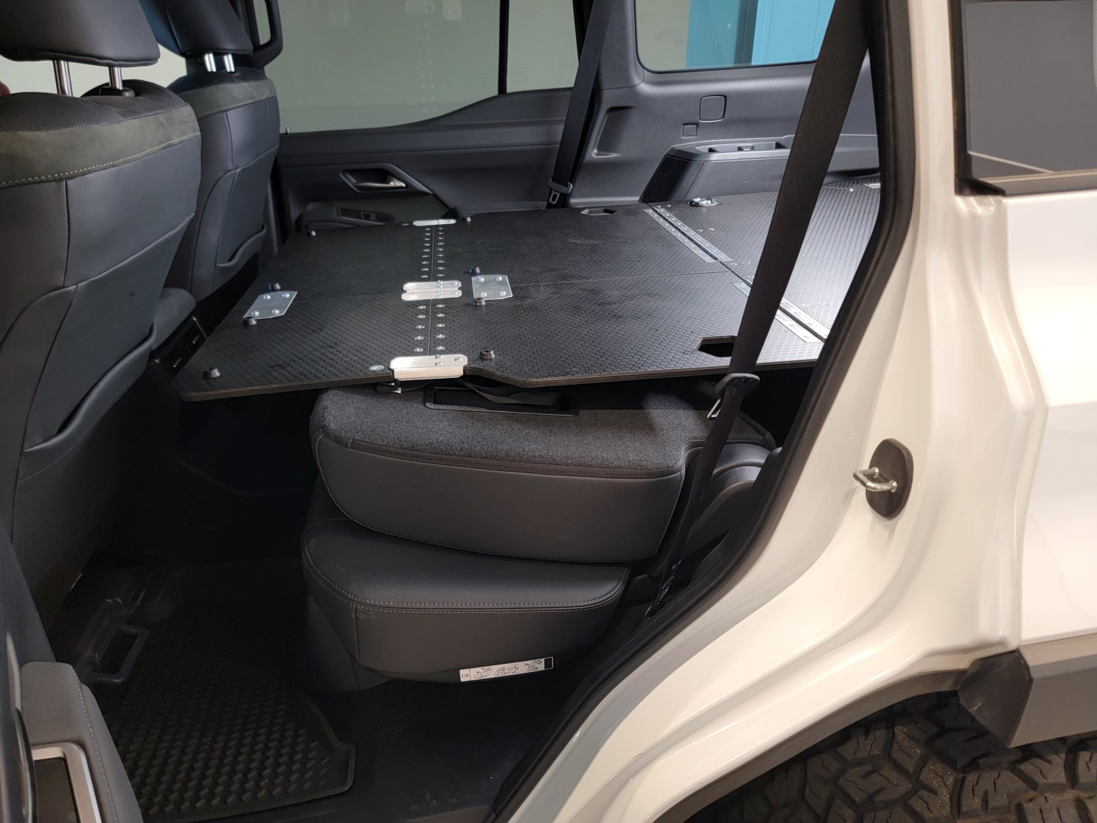

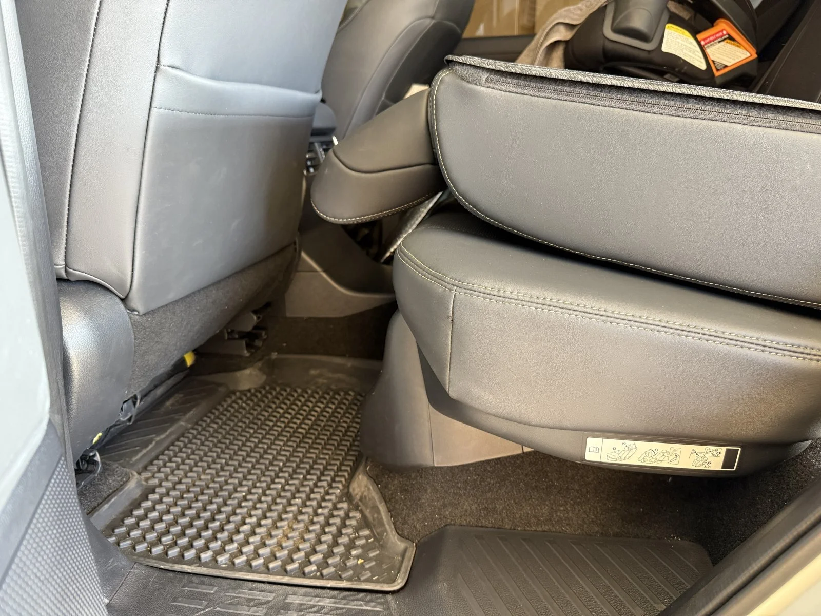

Great picture of the folded second row taken from outside the open rear door. I was wondering how that arrangement worked. Looks like the sleeping platform just unfolds and rests on top of the folded rear seats?
That is correct, the sleeper just rests on the back of the 2nd row. We have some trickiness happening with hinges, reinforcing plates etc to create a rigid sleeper when deployed.

For family composition reason, I ended up with the Luxury+ with captains chairs (my heart breaks for the MTS and Crawl Control). From looking at the pictures, the captains chair fold down to the same angle as the bench seat. Is there anything else preventing this system from working in a Luxury+? I could probably answer this in my own if I had an OT cargo space to compare in person. Thanks!
