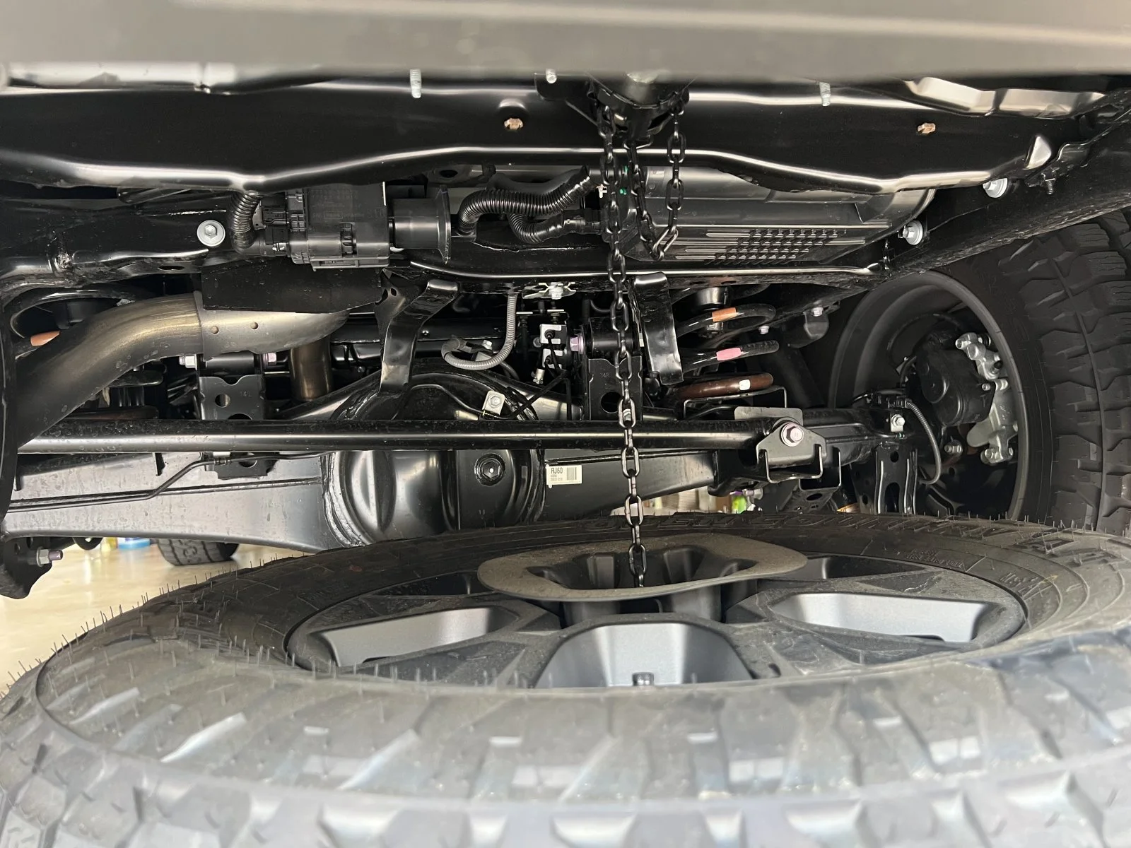

I've found a number of sources of rattling on my GX Lux:
  • The rear spoiler is not securely mounted as designed and can definitely get a rattle going
  • The covers on the rear glass latch rattle slightly
  • The third seat belts, even when docked into the seatbelt holders, still rattle a bit
  • The spare tire has about 8" of chain hanging down (WTF is that for?)

The chain is what lowers the spare to the ground. It might have come down through the wheel instead of spooling inside the middle.
