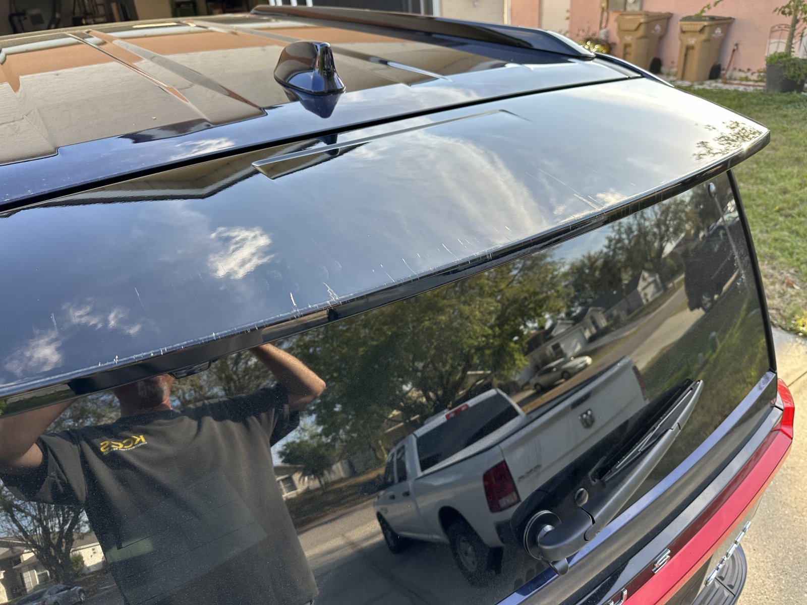

So this is my first post. In December the wife and I traded our white 2017 4Runner Limited for a Blue Luxury GX. We love the GX, wish we would have went with white because the blue is a nightmare to keep clean but that’s another story. I love the blue but it’s a magnet for dust and pollen (Florida).
Well tonight I was cleaning the GX and got in a rush and did one of the stupidest things I have ever done in my life and pulled the GX in the garage with the rear gate open. Somehow I missed all those warning sounds and hit the garage door with the rear gate spoiler. Luckily it didn’t break but it got scratched severely. We just got our 5000 mile service and I can’t let that go as is so I called a friend of mine who is a really good painter. He’s going to repair the scratches a repaint it to match for me free of charge but I have to remove it and drop it off to him. Has anyone removed their rear gate spoiler and if so do you have any pointers? Thanks in advance!

I opened the back window and it appears to only be held on by the 2 outer 10mm bolts. Ours has been loose feeling since we got it. There might be a 3rd under the plastic cover, I’ll know Thursday for sure lol

I found a PDF of how to remove a 2024 Land Cruiser spoiler on the Land Cruiser forums. Lots of complaints there with them being loose as well. Doesn’t look too hard. Unsnap the cover unsnap the wiring harness for the 3rd brake light, and remove 6 bolts, close the window and slide it off.

Well tonight I was cleaning the GX and got in a rush and did one of the stupidest things I have ever done in my life and pulled the GX in the garage with the rear gate open. Somehow I missed all those warning sounds and hit the garage door with the rear gate spoiler. Luckily it didn’t break but it got scratched severely. We just got our 5000 mile service and I can’t let that go as is so I called a friend of mine who is a really good painter. He’s going to repair the scratches a repaint it to match for me free of charge but I have to remove it and drop it off to him. Has anyone removed their rear gate spoiler and if so do you have any pointers? Thanks in advance! View attachment 9171
This video will show you how to remove it. It is for the Land Cruiser but the same concept. I had to remove to install the Westcott ladder.

The instructions @Gator posted earlier in this thread were very helpful if you need to replace the entire rear spoiler. Only took me a total of 45 minutes to replace the entire unit!
