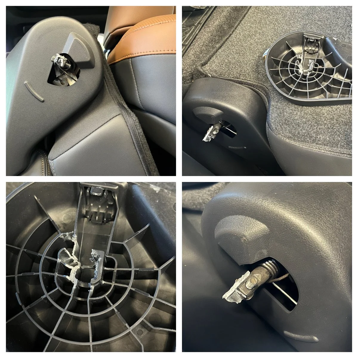

My 2024 GX is only 2 weeks old and the second row seat lever has already broken! I barely put pressure on it to access the third row and it snapped off in my hands 😡 It's total plastic crap. Who at Lexus thought it would be a good idea to have flimsy plastic to move a metal bolt??

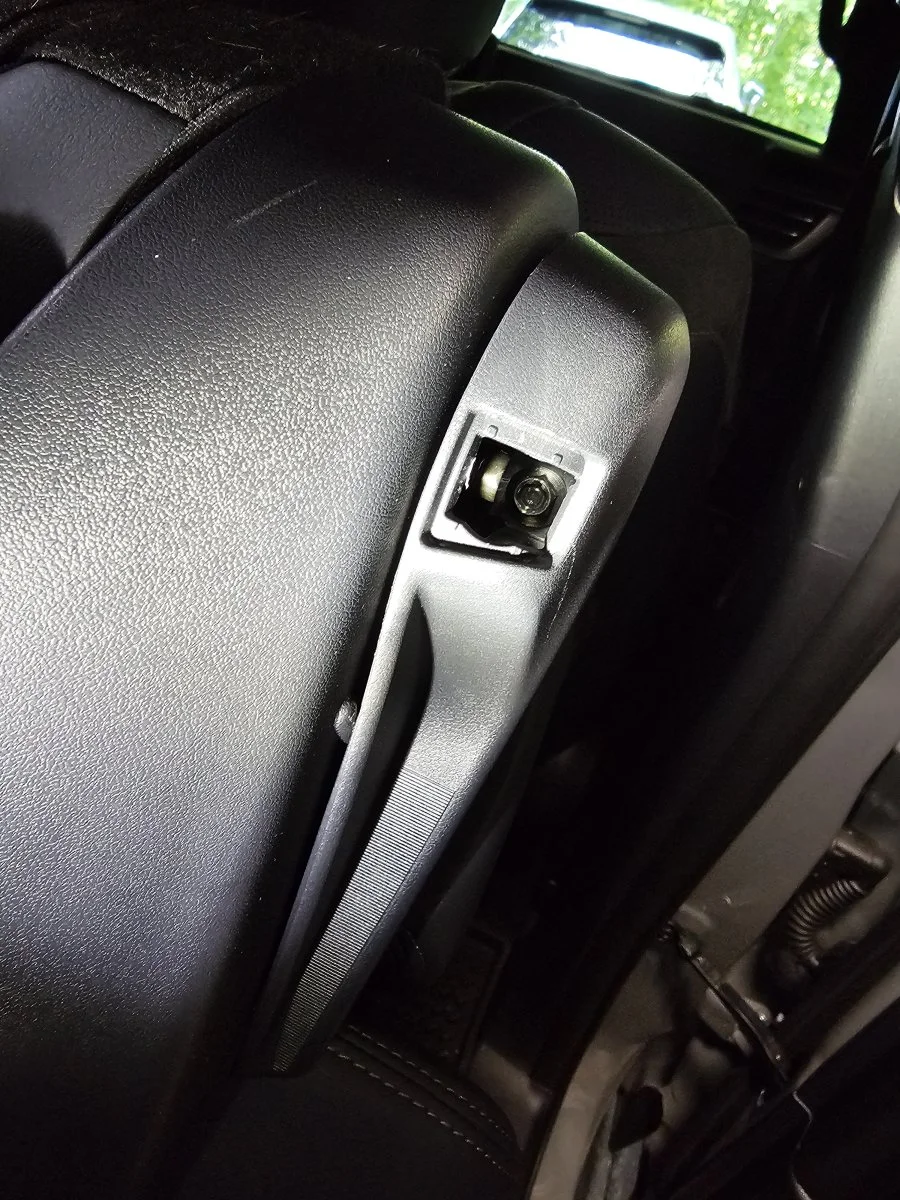

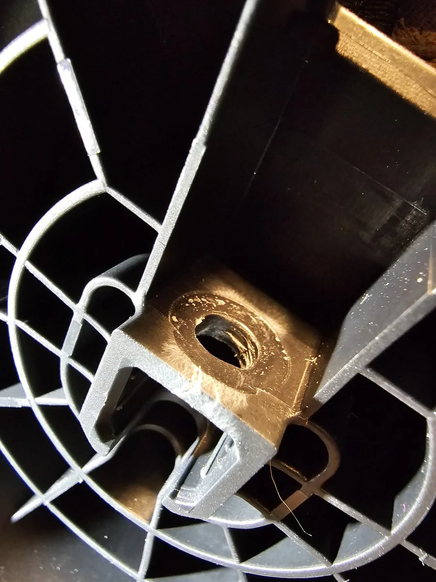

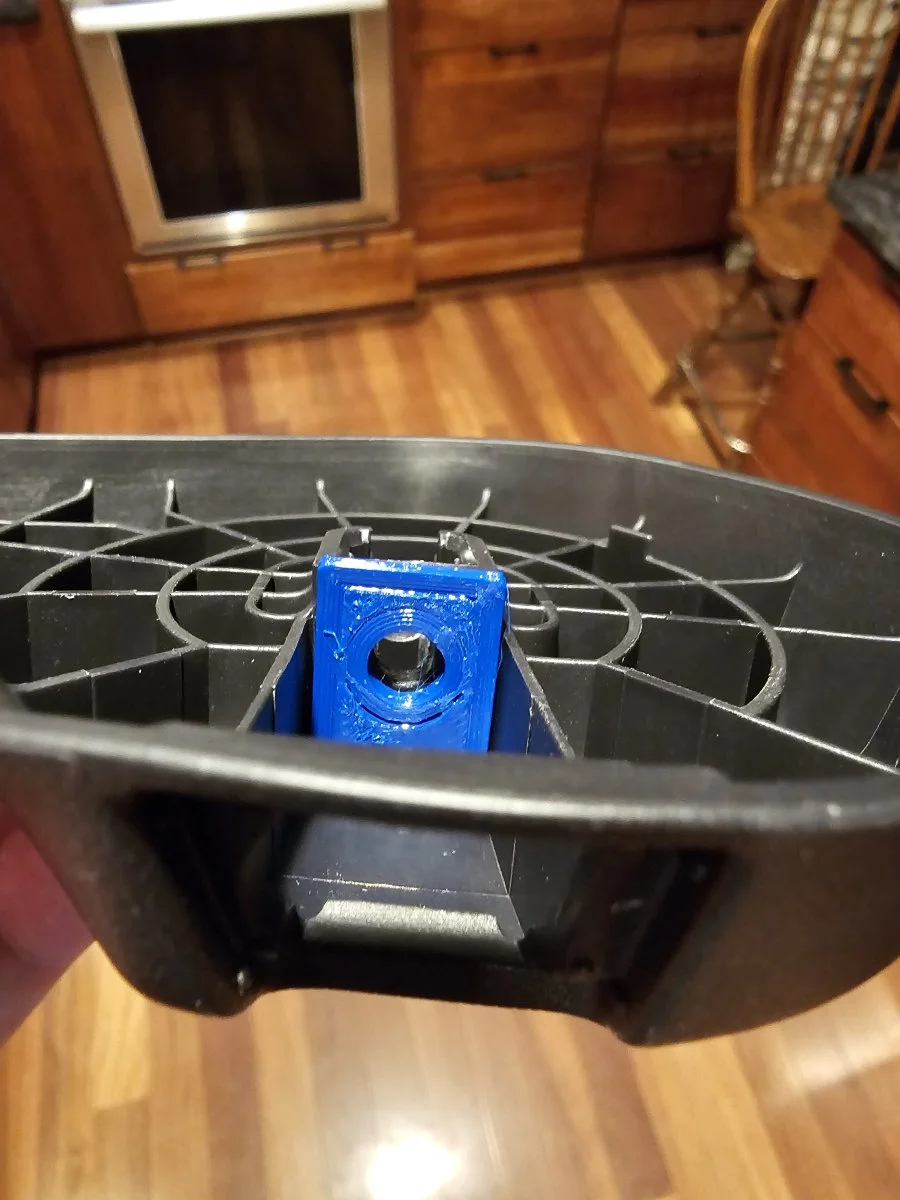

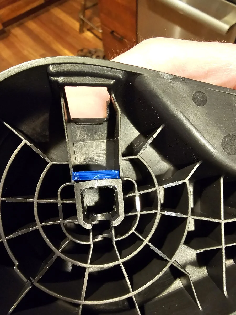

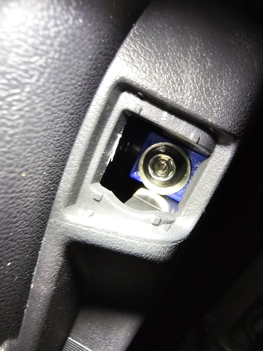

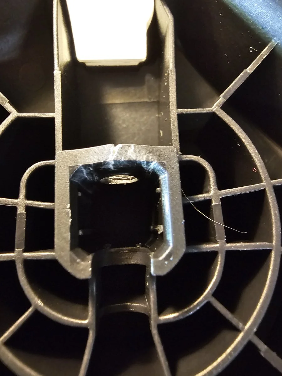

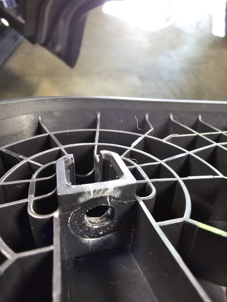

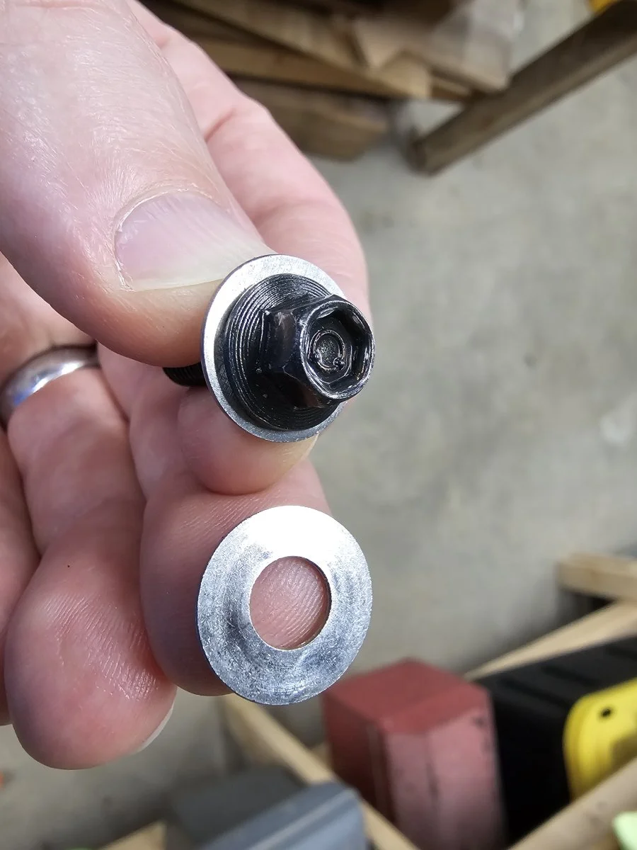

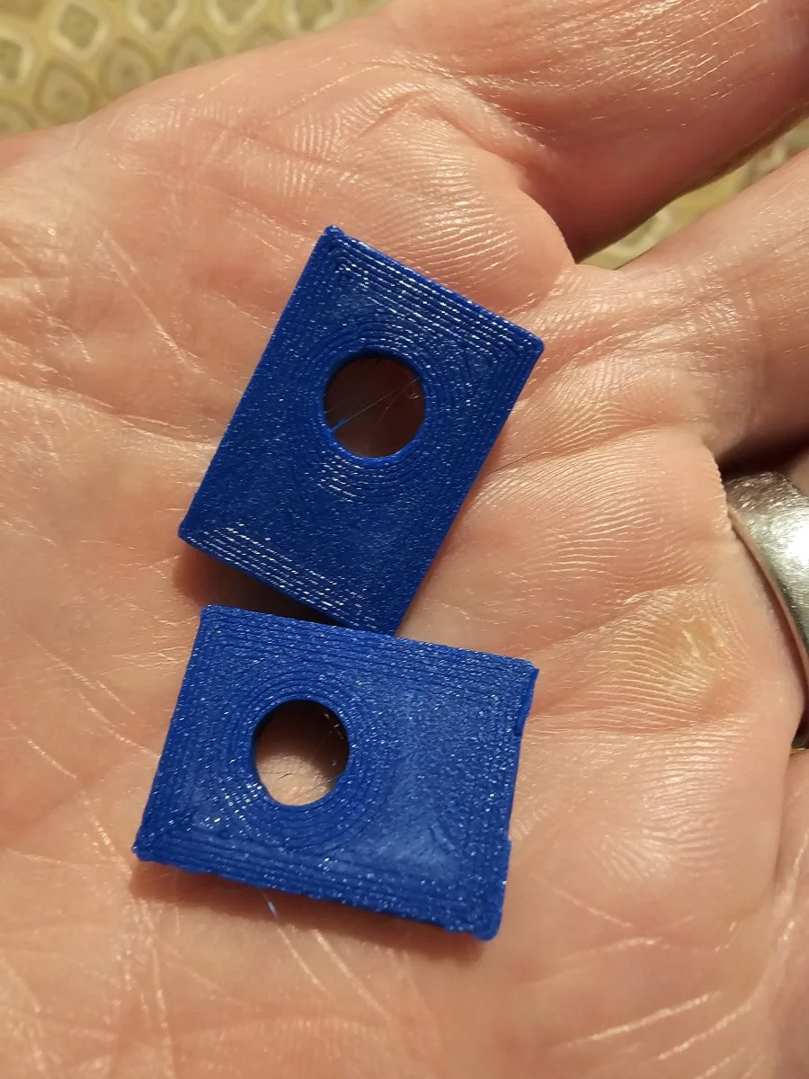

Hey guys, I have goodish news and badish news. I'll start with the bad. I took my rear seat levers off today, which was pretty easy. I have rarely used the levers, only flipping the seats a few times in total. But both seat levers showed small cracks just above where the bolt goes through. I was trying to figure out how to reinforce it with epoxy, but it just didn't seem like it was going to work very well. Now for the good news. I ended up printing some small inserts to add some extra structure between the bolt head and the lever surface, and I added another washer just a little larger than the bolt head to make it a little stronger. I don't have any empirical evidence that it will be a long term success, but I feel pretty good about it and I didn't have to epoxy anything. In case you want to do something similar, flip the seats forward (carefully if course), use a flat blade screwdriver to pop the cover of the bottom of the lever, use an 8mm socket to remove the bolt from the lever, take the bolt out and slide the lever off. The insert I made was 3mm x 15mm x 22mm. Put the insert in, and put it all back together. Cross your fingers. Good luck.

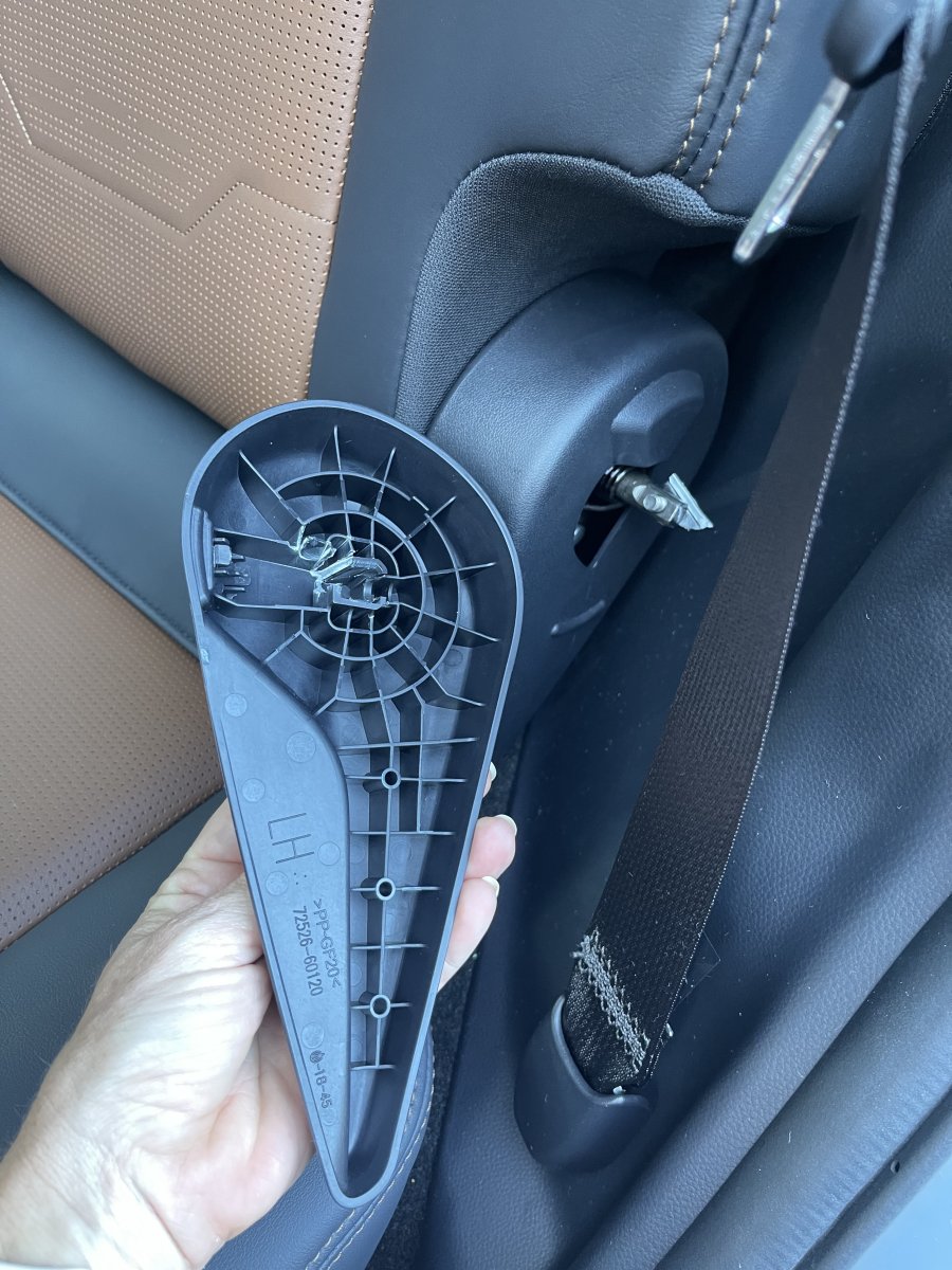

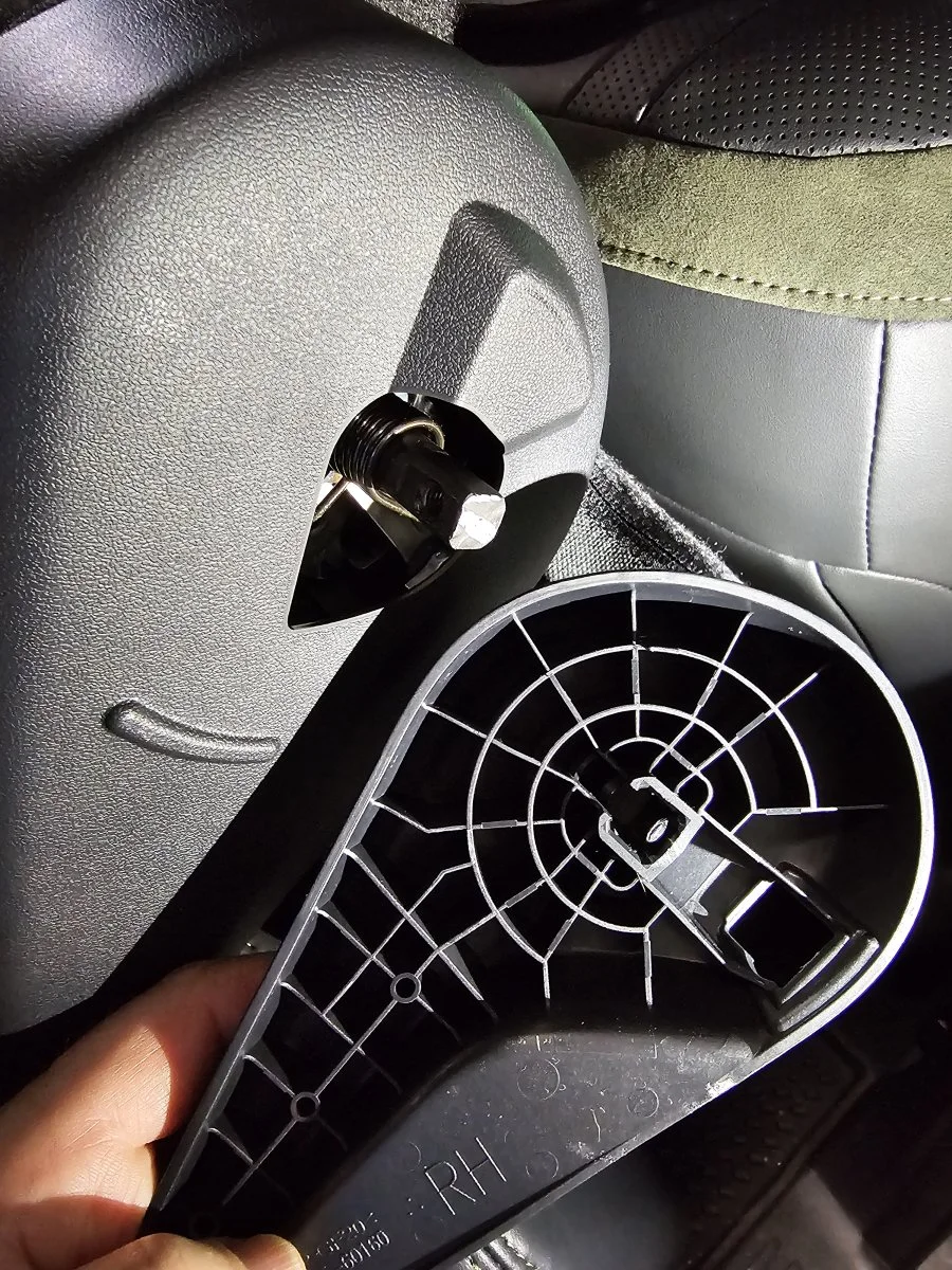

I recall seeing this thread and then bam!, it happened on my Lux+. Dealer overnighted the part and is fixing as I type. Unfortunately this solution is likely only temporary due to the cheap design Lexus allowed to move forward. I’m no engineer but kind of easy to see that a plastic handle is not going to work with a metal screw that is under tension and requires additional force to engage the mechanism.

Yeah, they need to modify that part just a little bit, or add something like what I did to fix this for current owners, because otherwise eventually they will ALL break.

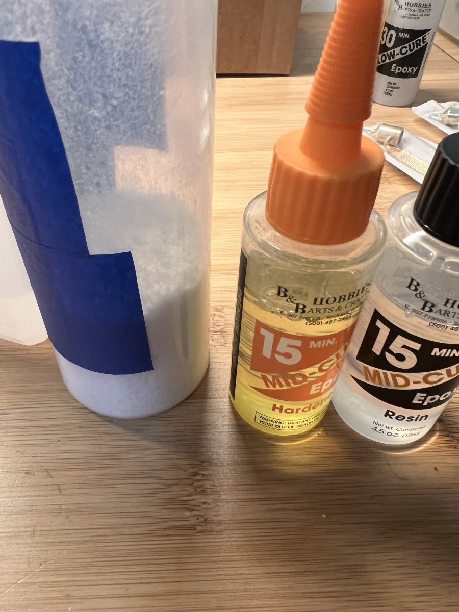

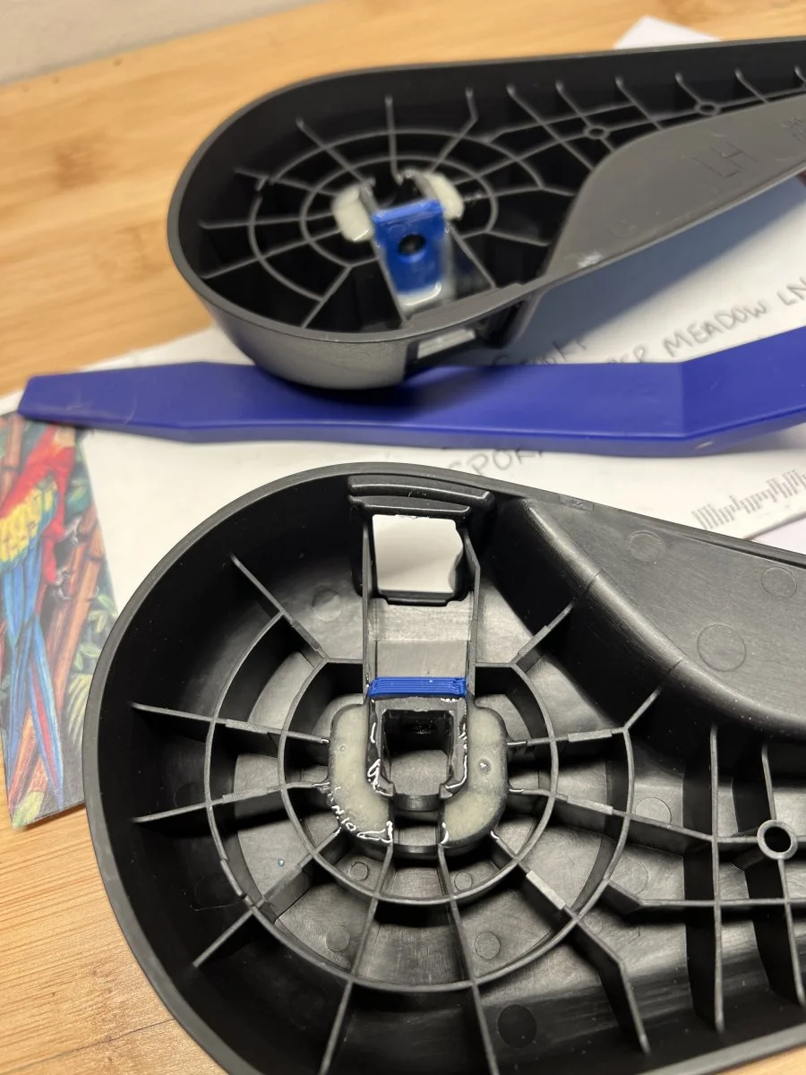

"@SethGX" was gracious enough to send a set of his expertly crafted reinforcing tabs. Took mine off today to perform the mod. Noticed almost zero torque on the bolts and as a result mine had no damage. Also took note the plastic seemed extremely hard and plenty strong so almost decided not to bother. Here are a few pics of what I did. Main difference is using 2 part epoxy with "cotton flocks" filler for extreme rigidity. Filled all the cavities surounding the tab. Will add blue loctite on the bolt. Game over!
