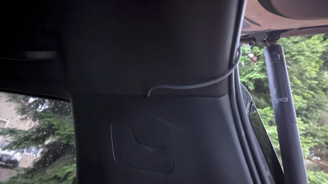

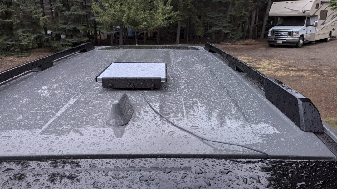

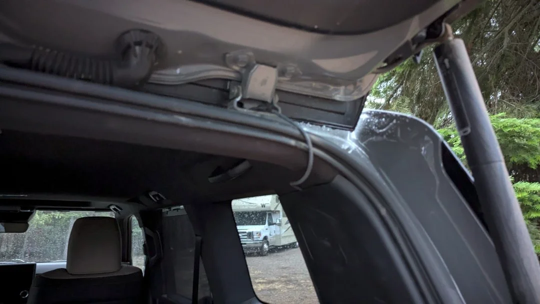

This is the magnetic mount I used:
Magnetic mount
The mount is simple and sturdy. I have two. I removed the magnets from the first and bolted it directly to the roof rack on my 200 Series Land Cruiser. Swapped three thumb screws for 10mm bolts which are used to remove the Mini from the bracket. The magnets are strong and "rubberized". The 4 removed magnets are very useful for other things. The second mount, using the magnets is on the GX.
Rhetorically speaking, I'm not too worried about theft for many reasons. For one, I'm not sure a thief you could use it given the serial number and registration process. Plus, much easier to pick one up off the ground at a campsite or RV park these days. Finally I assume they are all going to be obsolete in a few years when your "phone" directly connects to the satellites.

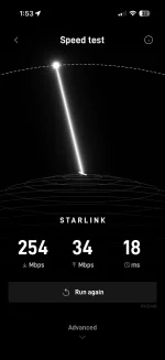

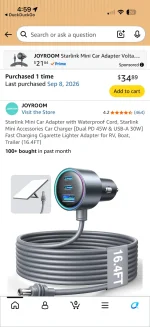

I did a test install today with the Starlink Mini, and the 8 magnet version of 48Njim’s mount. I also tested the Joyroom 5m length cigarette lighter adapter, which worked fine.
I was able to pull a good download speed while driving around my neighborhood at about 25mph.
