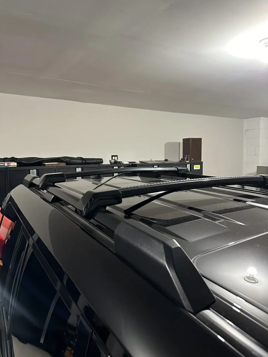

Reporting back…. I’m pretty convinced the vibration sound is from wind vibrating against the roof from the cross bars. I installed the Rhino Vortex strips but at the same time I noticed the cross bars have that weird rubber strip on the bottom similar to what folks are pulling off of their OEM racks. It’s a really odd shape strip to put under something aerodynamic. I decided to pull those off as well - they come off easily with no damage.
Happy to say the vibration is greatly reduced, though not completely gone. I used to be able to recreate it whenever I wanted with feathering the throttle when going 35-40 pretty much anytime, but now I rarely hear anything and can’t force it to happen. It still seems in certain conditions/speeds enough wind hits the roof in such a way it cause the buzzing vibration sound, but not enough to annoy me anymore. I still might try adding some paracord around the bars and see if it eliminates it completely but for now I’m satisfied.

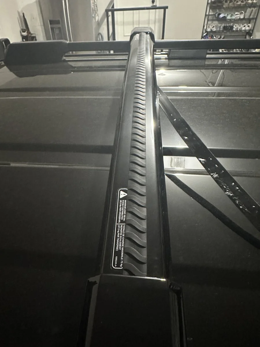

And the vortex strips are actually functional, adding grip and padding to the top of your bars and they look nice too. Also very easy to install and can be removed later. Here’s a couple photos of the vortex strips and the rubber strip I removed.
You can see the strip hanging down off the front bar below as I started removing it, and the vortex strips are installed.

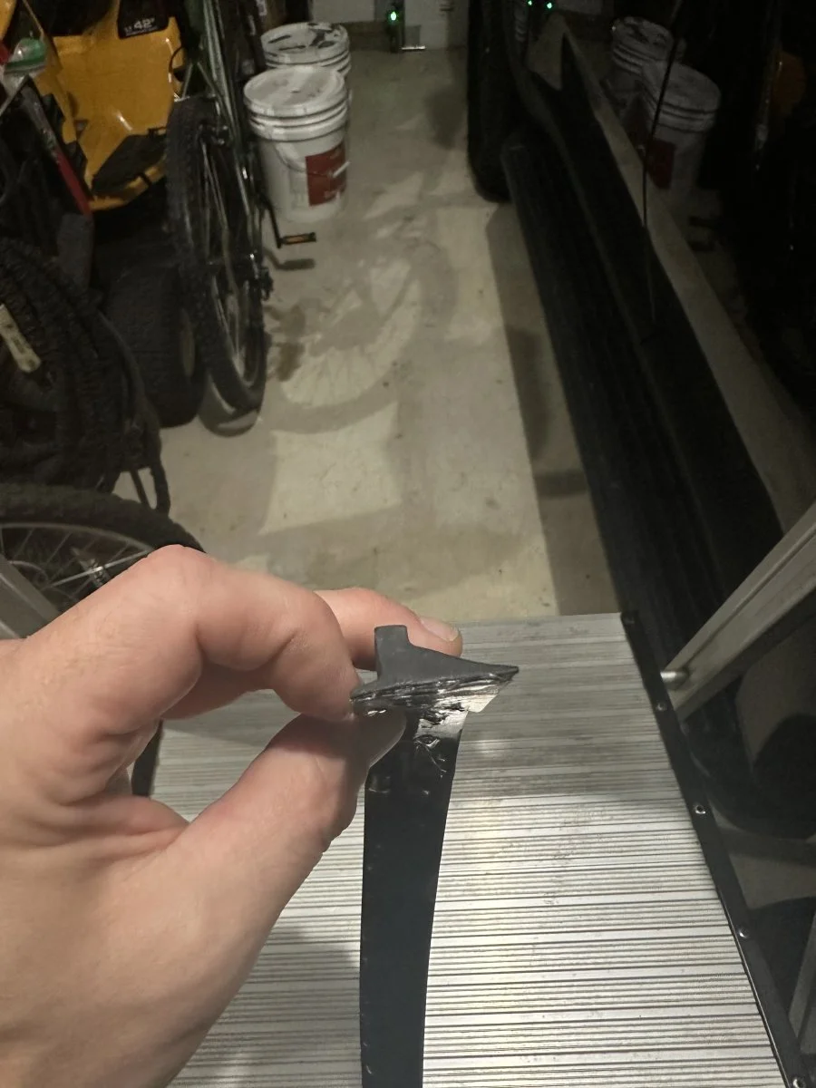

This is the profile of the rubber strip. The rectangular part was pointed frontward which seems like it would just force high velocity wind straight down at the roof. I can’t for the life of me figure out what the point of this was and why it was added. Why would you need rubber under your cross bars? They look nicer without it as well.
Another photo with the strips installed and the rubber strip half pulled off.
Hope this helps someone else.
is there any chance the bars were installed backwards and the rubber piece was supposed to be along the trailing end? Still doesn't make sense as it it would be creating lift that way they would be facing.
With all the engineers at Lexus, who would've thought they would fail so miserably with their roof accessories for the GX.
Looking at the profile of the rubber strip, either way you position it, it still directs air into the rectangle portion, and it was already positioned so that the slope part was facing forward. But there really isn't a way it would have made sense. It's very very silly and seems like an afterthought. I've been trying to figure out what in the world they were trying to accomplish when adding that strip. I can't think of a single purpose it would have been intended to solve for.
