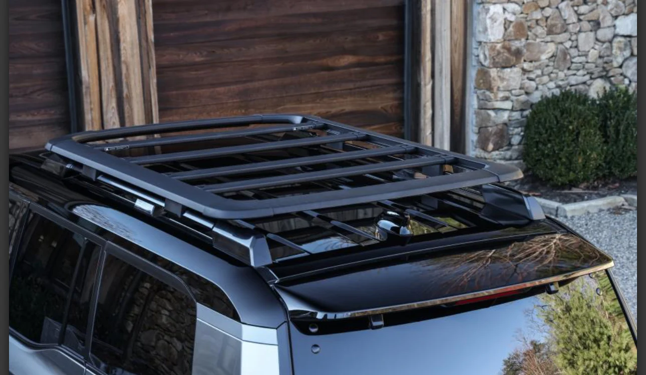

Hi I just purchased a premium plus and this exact thing happened to me! I live in CT & my dealership fixed it! the vibration sound (not feeling) was actually caused by my roof rack. I believe they call it a low profile roof rack. It’s the bulkier one. my dealership had to completely take it apart piece for piece and insulate it. I believe with “felt”
materials and as soon as they rebuilt it, I drove off of the dealership with it and the
sound was gone. I didn’t believe that the roof rack was deflecting air so noticeably and especially at low speeds to be causing this kind of low rumbling sound between 23-35mph while cruising(no acceleration or braking) but honestly I’m so thankful that it’s gone. It was covered under warranty. I attached the Lexus website photo of the roof rack that came with my package for reference
