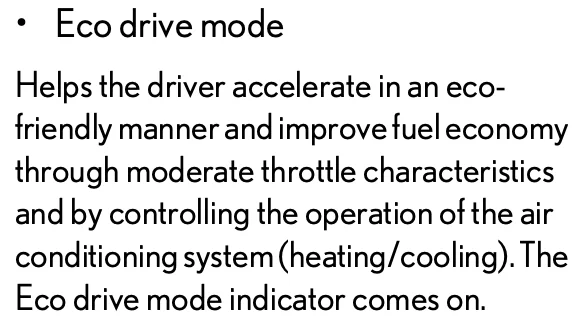

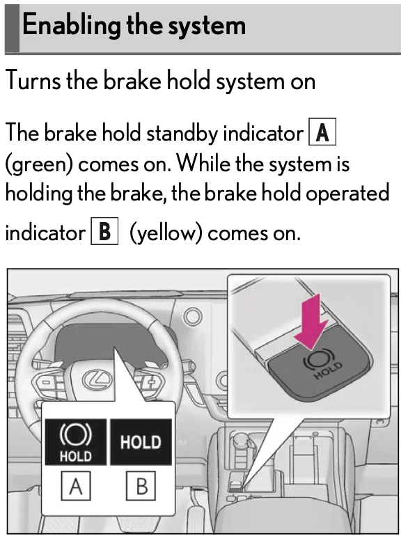

Do you have brake hold and/or eco drive mode enabled?

Update- Did not have the brake hold or Eco mode enabled.
So I did some experimenting with all the various driving settings this morning and the delay is A LOT less noticeable when Sport S mode is activated.
When transmission is in Manual mode and vehicle is at a complete stop and physically in 1st gear, the Acceleration delay is non existent after accelerating.
Put it back in "Normal" drive mode and when I start to roll on the throttle from a dead stop I still notice slight hesitation, as I continue to roll on the throttle it kind of feels like the tranny downshifts and then quickly accelerates. This delivers a kind of jerky uncontrolled feedback. Not sure where to really go from here except keep driving it and breaking this machine in. I will bring it up to Lexus when i go in for my 1st scheduled maintenance.
