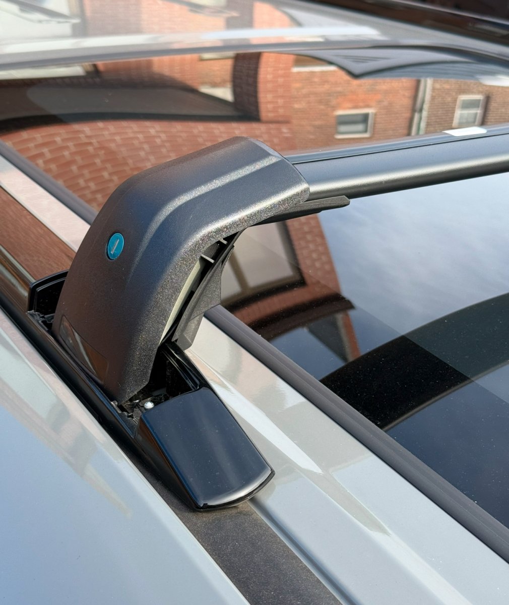

This might be worth a try if you need something in a hurry that doesn't break the bank? Made for flush rails:
Thanks! I placed an order. I’ll do this as a halfway option until I can figure out which rack I really want. Do you know if I’ll need a tool to flip open those clips on the flush rail on the prem/lux trim?

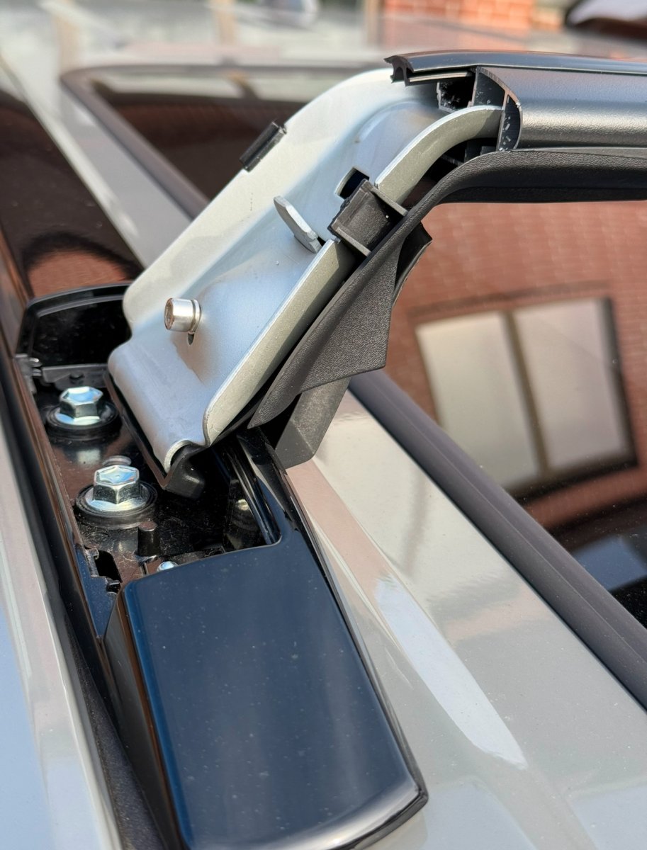

I just received these and I don’t think they were advertised correctly. They look like they “clamp” onto the flush rail, which in reality it would just be clamping onto this little plastic piece. I think the real solutions should bolt onto the roof. Looks like the cover is really bad fitment too. I’ll probably return this. Still need to find a cross bar that will fit. :(
Also the plastic cover/clips took 5 secs to take off with a plastic pry tool. I had some with my ifixit PC kit. Easy peasy. Now to look for other crossbars. This is a pain.

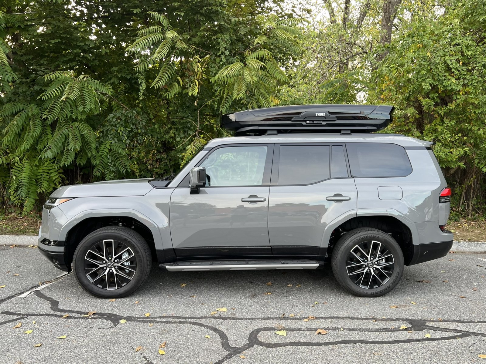

While waiting for Thule or Yakima to release their crossbars for GX550 ( OEM flush rails crossbars seems to be sold out or removed from Lexus dealer sites), I installed our Thule Motion Alpine box on the OEM flush rails roof rack. Surprisingly the clamps work and sits secure even if the entire box sits on top of the rack. The Alpine box length is the same as the Motion XXL. Some pics for reference. With the OEM 20" wheels, overall height is approx 90 inches.
Also note that the flush rails are not the type where you can slide the cross bar clamps freely along the rails. The rails do not have indents to clamp on. I think you will need to get footers that bolts within the bolt holes/openings provided.
