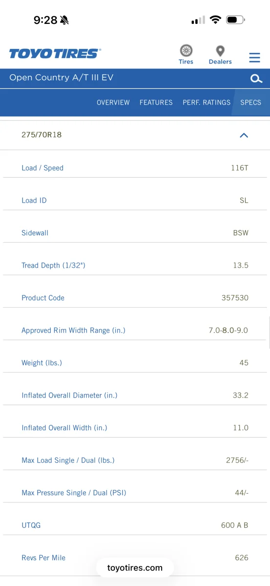

275/70/18 toyos only come in an E load correct? Appreciate the help guys.
Comes in an SL as well that weighs 45lbs. It’s what I run.
