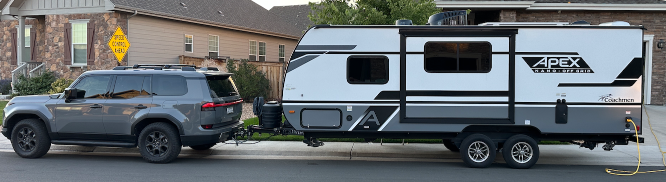

Here is my 5000# trailer with approx 800# tongue weight and another 100# WDH.

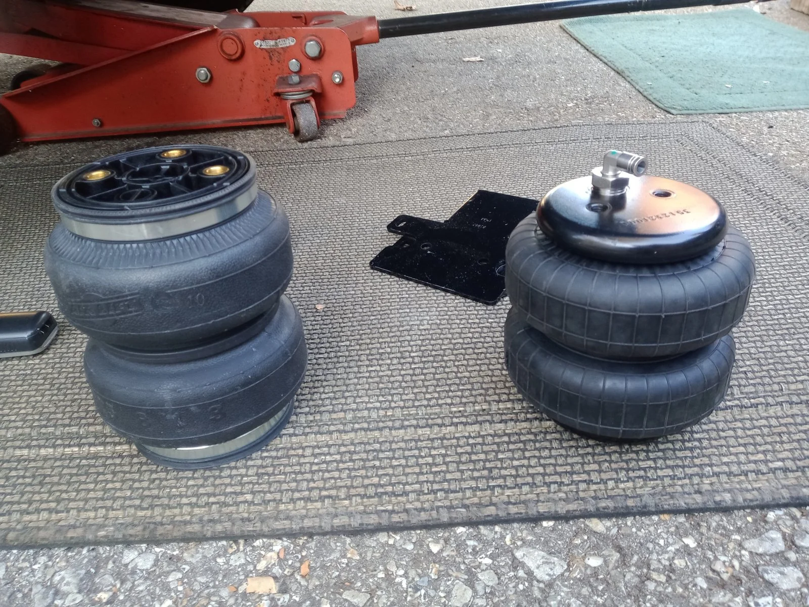

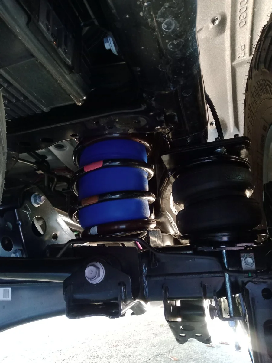

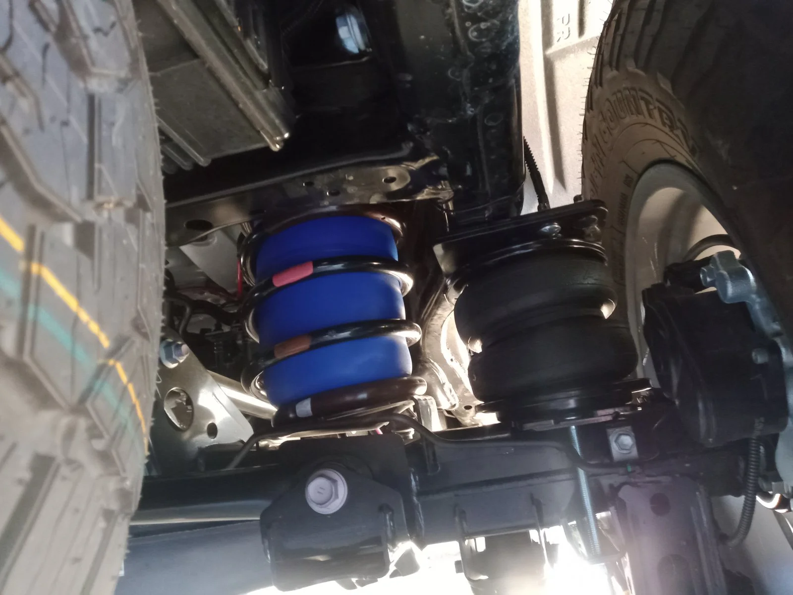

Would like to ask the brand of these airbags and where you got them. I have been looking for some, obviously I didn't do well in my search. Thanks!

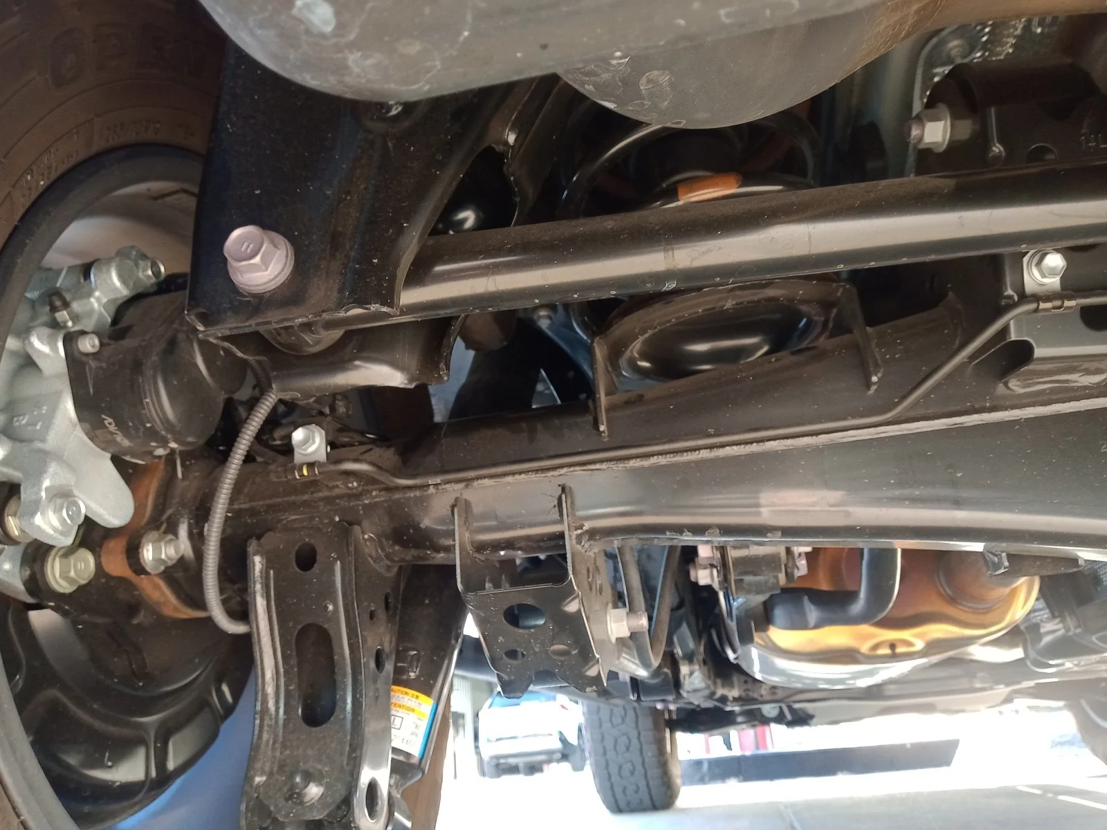

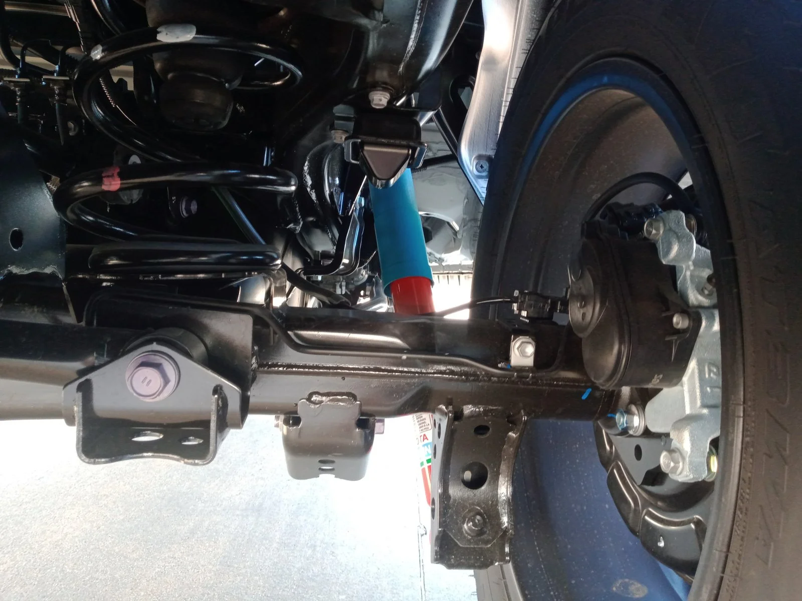

Parts I used. I cut 3 tapered donuts off the taper damper from inside the coil spring which worked out perfect. My GX550 was bottoming out the bump stops when I hit dips on some roads even though I have an Andeson weight distribution hitch. I did not use the side backet on the Tundra Airlift kit. The axle is the same on the 2022 thru 2024 TRD Tundra but the frame shock holder is welded on the frame in a different spot. The bump stop is the same bolt pattern and the Tundra axle to frame is 8 inches vs Gx550 6.25 inches. Coil spring is taller on the Tundra. Side bracket is not needed IMHO as the steel plates are very thick and strong. Ride appears to me like stock with zero air pressure.
https://www.etrailer.com/Vehicle-Su...Cruiser/2017/F4164.html?VehicleID=20171014419
