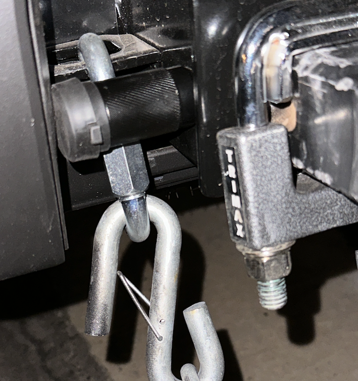

My most immediate issue is that the hangers for the chains are way too small. Attaching the chains and breakaway brake is like solving a puzzle. Has anyone found a good solution? Perhaps a shackle?

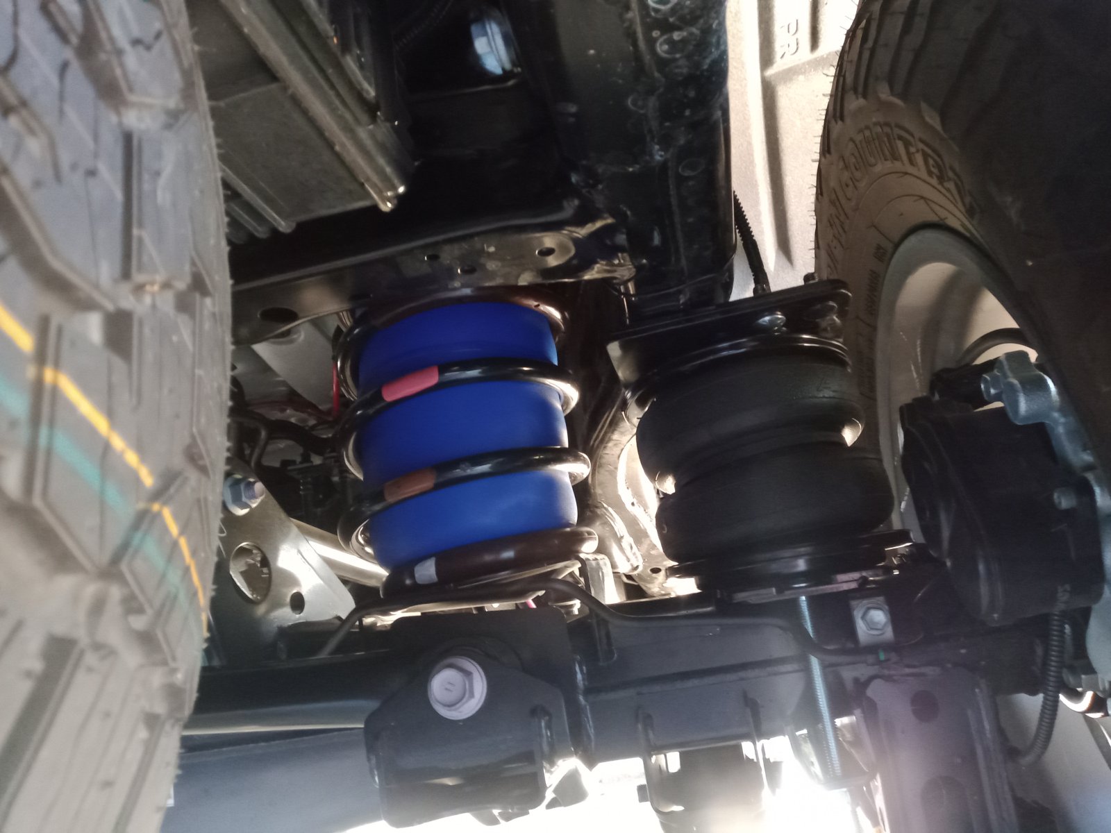

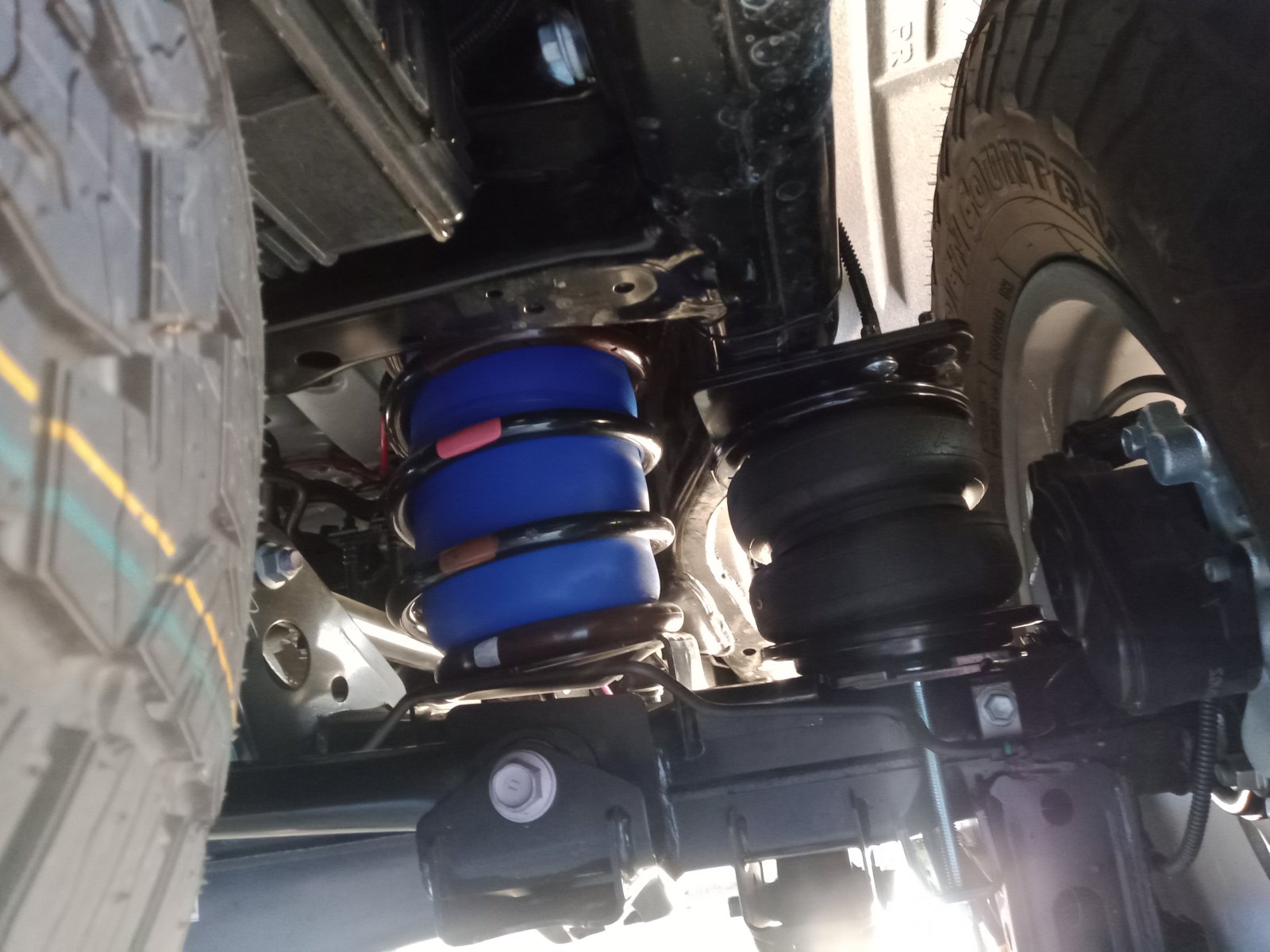

This took care of my 2.5 inch sag. Only need to put 10 psi in these which rides nice. it also lifts the rear 3 inches at the push of a button.View attachment 4491
Love your solution here. Have a couple of questions. Does the Firestone (blue) airbag support weight or just expands against the spring coils effectively increasing the spring rate? Is the Airlift bag the one that allows you to take care of the 2.5 " sag? Or is it both bags? TIA!

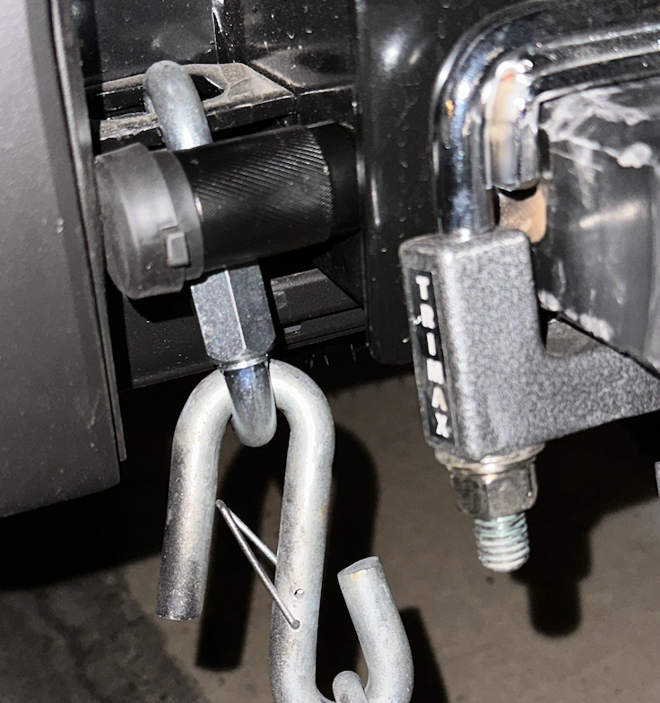

I added these to make it easier to chain up. Highly recommended.View attachment 5060

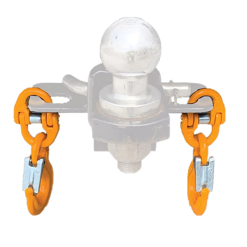

We'd struggle to be able to use this set up in Aus as we need to use rated equipment when towing, and for safety, I'd like to know that if something happens, the chains will do there job catching the trailer and not break away.
Those 'S' hooks are not load rated, I've bent them when using them on a boat winch, similar to those 'quicklinks', they have no rating and are just bent up mild steel. I wouldn't be trusting either of them in an emergency.
I'm curious to know if there would be enough room to fit hammerlocks, some people are moving towards fitted hooks, but I'm not keen on having something that is hanging and swaying around permanently, but hammerlocks may fit in and make it easier to put a shackle on.
That’s an interesting solution. Keep me informed if you find out they work. Part of my issue is I’m towing a Kimberley Karavan and the chains need to loop through the vehicle attachment. The holes in the hitch are barely large enough to accommodate the chain. However, I like that method because it’s really strong and I can easily adjust the length and sag of the chains.
Parts I used. I cut 3 tapered donuts off the taper damper from inside the coil spring which worked out perfect. My GX550 was bottoming out the bump stops when I hit dips on some roads even though I have an Andeson weight distribution hitch. I did not use the side backet on the Tundra Airlift kit. The axle is the same on the 2022 thru 2024 TRD Tundra but the frame shock holder is welded on the frame in a different spot. The bump stop is the same bolt pattern and the Tundra axle to frame is 8 inches vs Gx550 6.25 inches. Coil spring is taller on the Tundra. Side bracket is not needed IMHO as the steel plates are very thick and strong. Ride appears to me like stock with zero air pressure.
Thanks for sharing this!!! I HATE sagging rear ends, so I airbag my tow vehicles. Can you please help me understand why you did double airbags? Might the Airlift bag compromise, articulation more than the Firestone bag that is placed inside the coil? What compressor and pressure monitoring system are you using for the bags inside the coil?? Are you using two of the same? (One for Airlift and one for Firestone?)
