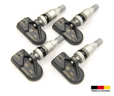

no dealer trips, no tool pairing? cant recall the last vehicle I had to do anything to when doing this, but its my first toyota/lexus. Care to share the link? lots of cheap "genuine" on ebay and many from what looks like HUF group in DE.
Most 3rd party TPMS sensors can be setup to clone the ID's of your OEM set by the installer so there's programming needed
