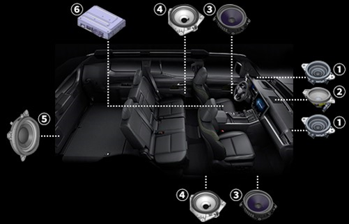

The Premium Sound System, composed of 10 speaker units and an 8-channel class-D amplifier, achieves well-defined sound-image localization and reproduces music in outstanding quality and clarity under any environment. It is capable of delivering adrenaline-pumping bass expected of a hardcore off-road SUV and recreating a sophisticated acoustic environment.
①Right/left ends of dashboard panel9 cm CST Driver**× 2
②Center of dashboard panel9 cm midrange× 1
③Inside right/left front doors18 cm woofer× 2
④Inside right/left rear doors16 cm full range× 2
⑤Inside liftgate20 cm subwoofer× 1
⑥8-channel class-D amplifier × 1
**Coherent Source Transducer Driver, originally developed for TAD-branded high-end speakers and featuring a concentrically mounted midrange and tweeter to achieve better directivity
Just to clarify, is this the system that is the base system installed in the GX OT?
This configuration is the Base system, the only interesting feature is there are 10 speakers in 8 locations, given the concentric CST drivers on the sides of the dashboard.
