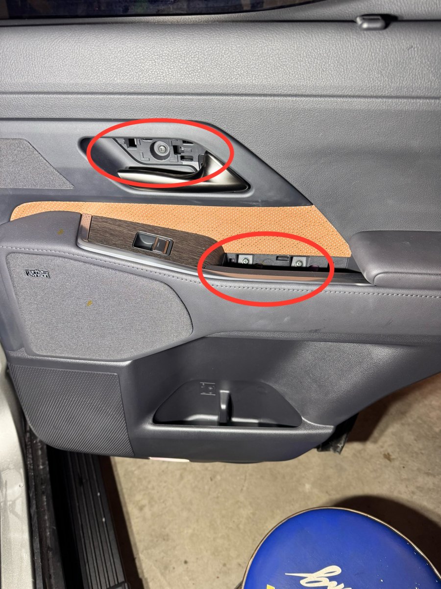

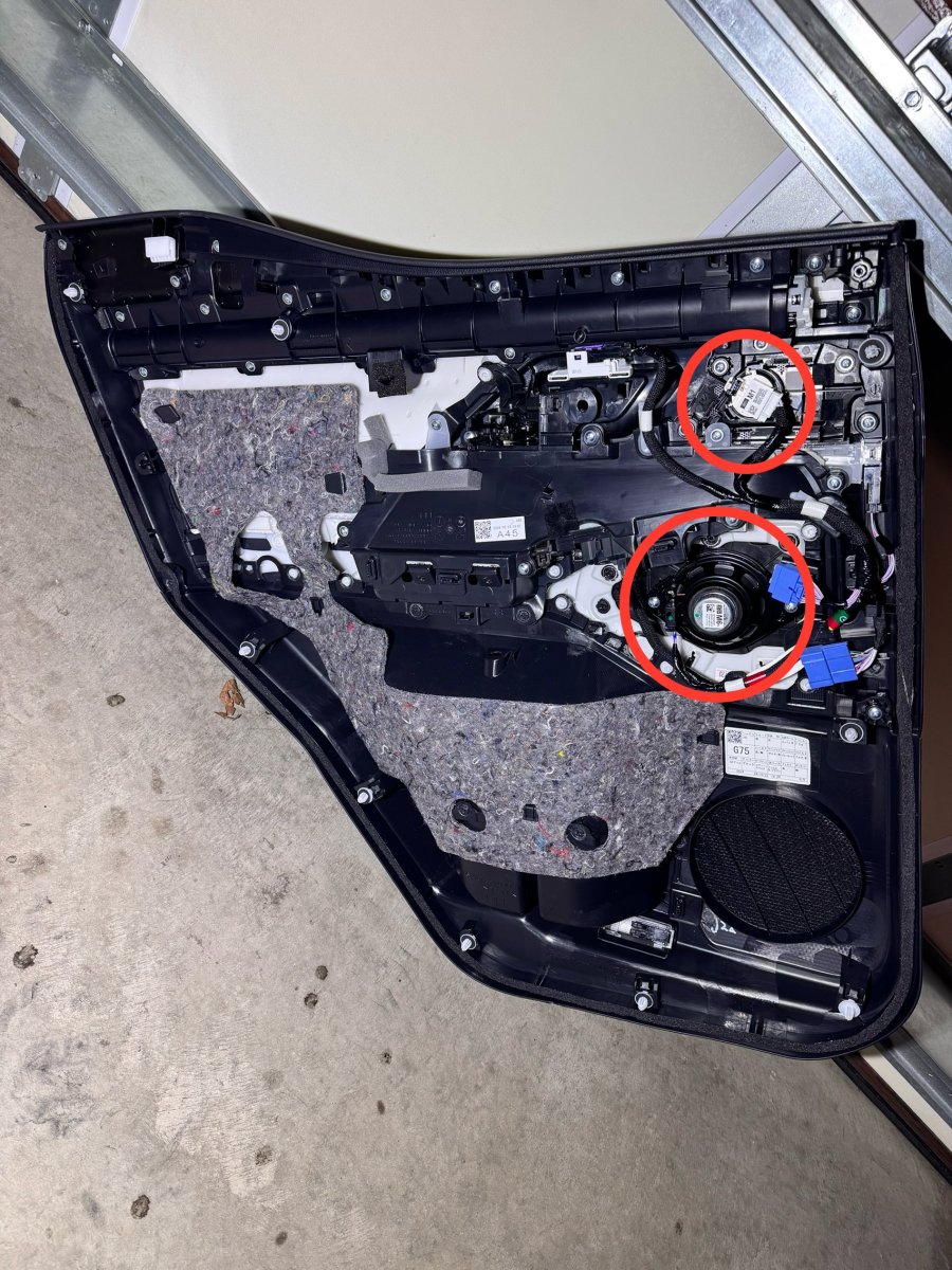

The door panel is very easy to remove. You need to pop off the two covers, circled below, and remove three screws. Then, the panel just pops straight off of the door. No pulling upward at the top. All of the pop fasteners face the same direction.
Once the panel is popped loose, there is one screw holding the door lock popper from the inside. Unscrew it, then disconnect the door handle cable, blue main wiring harness and small clip connection for the puddle light at the bottom of the door. Having a stool or other way to support the door panel while accomplishing these steps is helpful. Then the panel, with both speakers built into it, can be removed from the vehicle and set aside. The two factory door speakers are circled below. Make sure ALL ofmthenwhitempopmfasteners come off with the door. If not, then simply pop the off the door and reinstall into the backside of the panel.

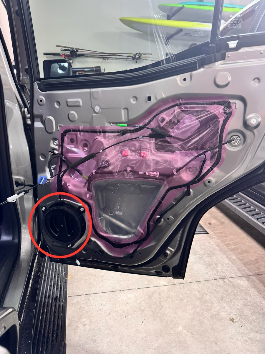

There is a plastic speaker place holder in the door, with wires connected into it, but there is no power running through the wires. I believe these wires would have power, if your vehicle was equipped with the standard sound system, but in the ML equipped vehicles, they do not.

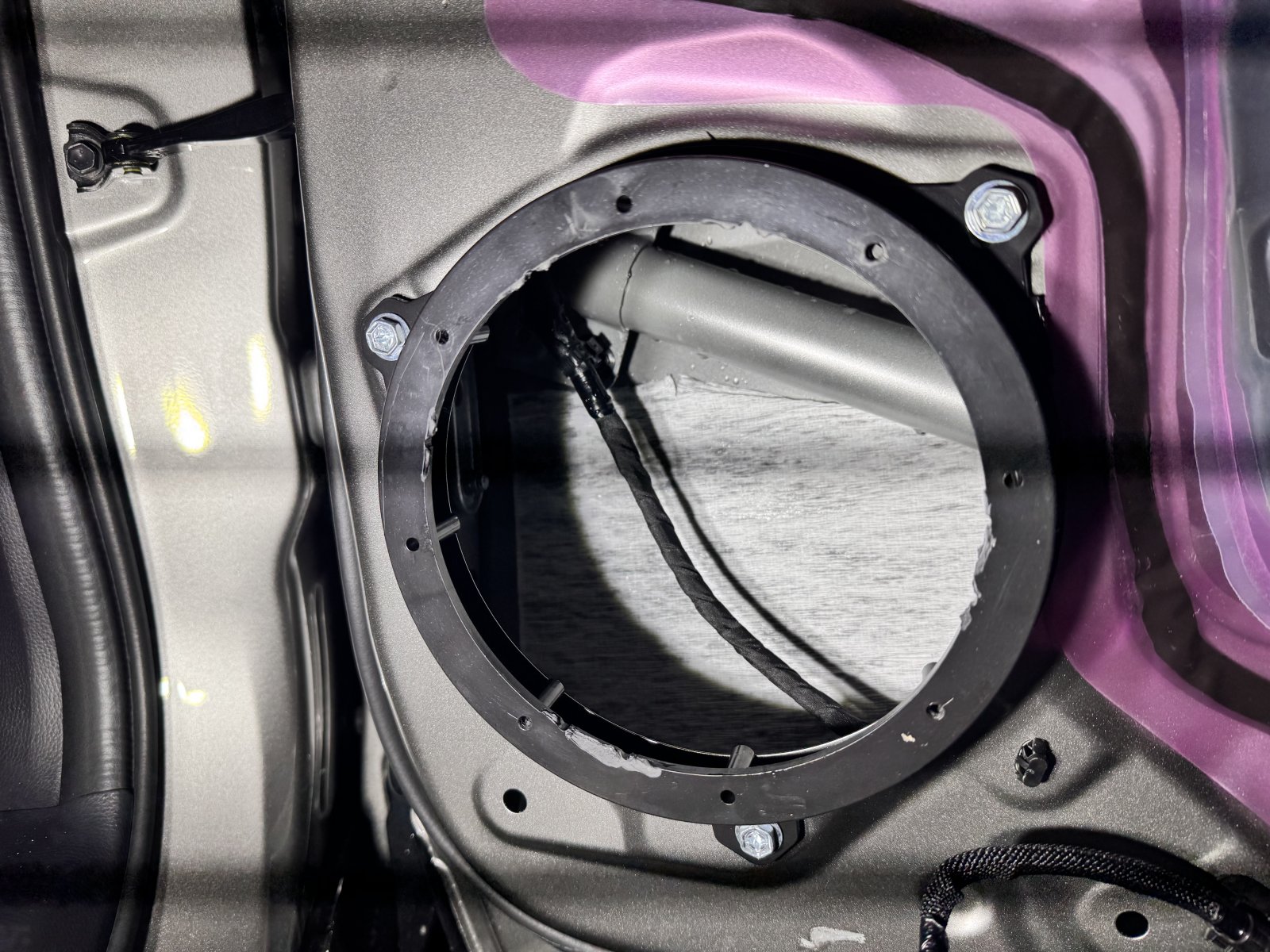

After removing the “fake speaker”, I installed the JSP speaker adapter brackets. You will need to break off the inside tabs of the brackets, if you are using 6.5” speakers. They are made to do this, as they can accommodate 5 1/4” or 6 1/2” speakers. I also took advantage of having access to the inside of the door, and placed a little butyl tape on the door skin to help with sound deadening. Though, I’m not sure this is necessary! I also installed the speaker baffles, but cut a circle out of the back, to help with bass response (due to reviews stating that the baffles may cut down on that). That was probably not necessary, either…

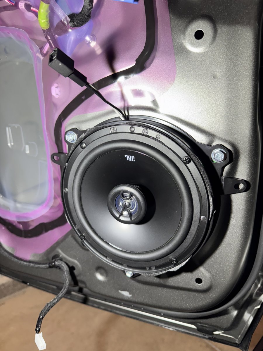

I used the Metra adapters to connect the new speakers to the existing power going to the mid speaker in the door. I did not want to splice or add another speaker for fear of burning up the amp, which is around $1500-$1900 to replace, so I effectively deleted the mid speaker and now have a 6.5” speaker, mounted in the lower door, using it’s power. The sound could be better, as I believe the amp has built in crossovers, to limit how much bass is going through that channel, but, the system sounds much more pleasing to the ears, without the insane levels of mid/high emanating from the second row. It sounds much more like it should now!
I had to install the new speakers upside down, as the wire adapters were not quite long enough. This should not affect the sound quality. I plugged the non-powered original lower plug into the mid speaker, just to hold it in place, and plugged the mid speaker’s original connector into the new speaker wiring adapter. Then, connected the door lock pop up, handle cable, main wiring harness and puddle light and reinstalled the door panel.
The system is still missing the addded bass I was looking for out of the second row door speakers, but I am happy with how it came out. This can be done for around $100 and about an hour of your time!

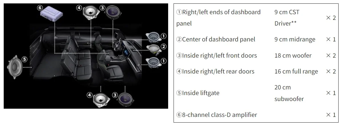

I have a base OT with the base sound system. I feel that the back of the truck aft of the front seats has practically no sound because all I have is that lower foot-level 16 cm full range speaker in the rear doors. I'd prefer to have a 18 cm (or about 6.5") woofer at foot level like you've done, AND the 16 cm full range speaker higher up in the door where your ML system has that speaker. The D pillars in the cargo area should also have a pair of full range or mid + tweeters facing forward.
When you pack up the truck with gear, that foot-level full range in the rear doors is useless. At least with a woofer down there you'd still get some benefit.

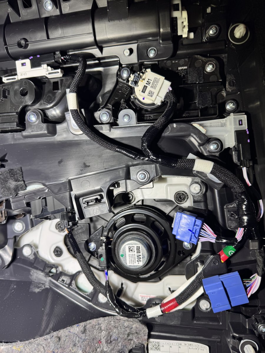

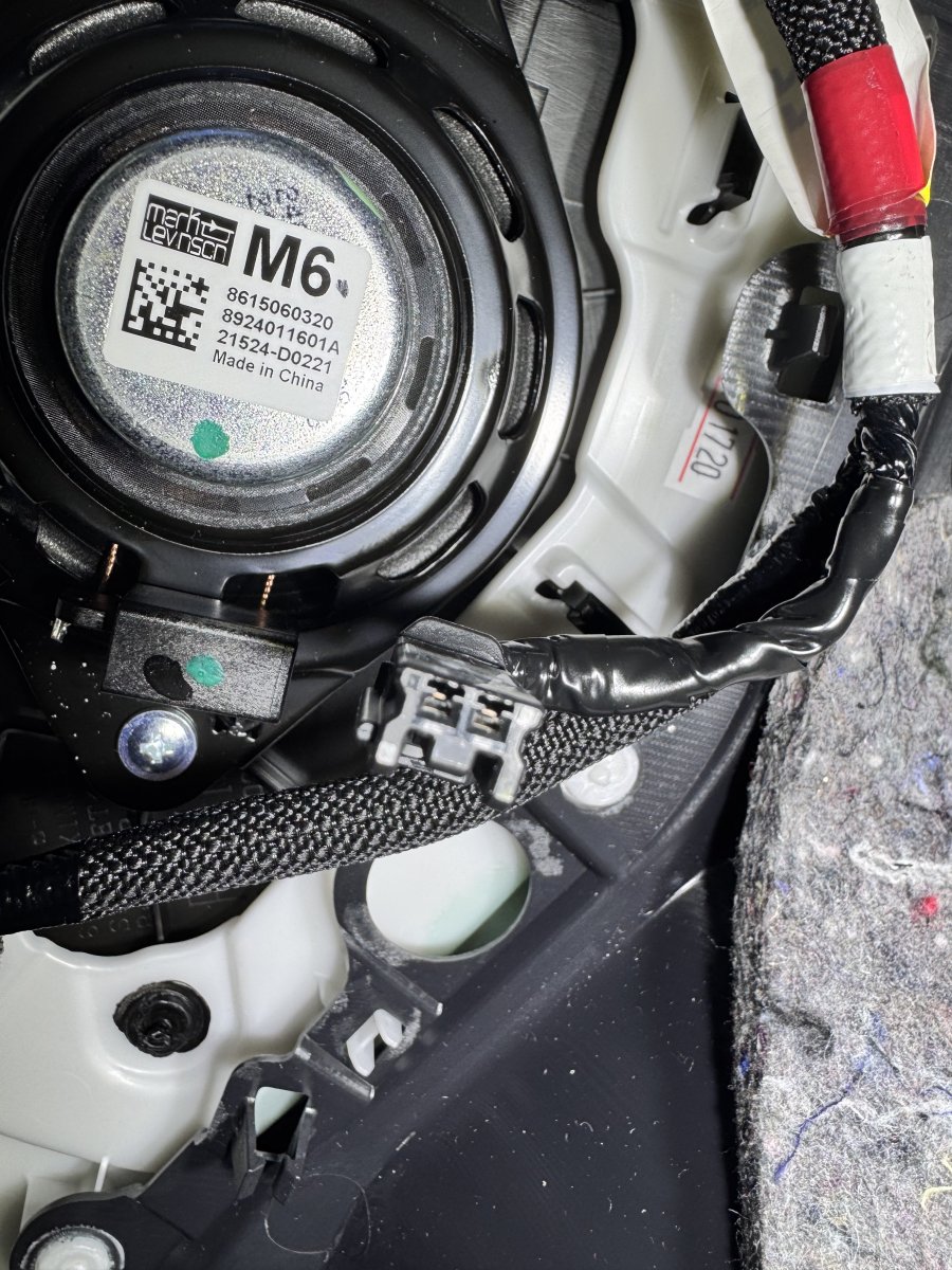

What was the ohm load for those mid and tweeters in the doors? Did you happen to get a close-up picture of the them?
I did get close up pics. They do not show Ohm or wattage, unfortunately…
I did get close up pics. They do not show Ohm or wattage, unfortunately…View attachment 7341
Appreciate the reply.
Trying to get a better understanding of the ohm loads of the speakers and the amplifier watt output. You could swap out the mid speaker and get a matching ohm 6.5" for the door to get the correct ohm load for the amp. More research is needed.
Yep, me too… if the stock midrange is 4 ohms it will be an ez upgrade.
