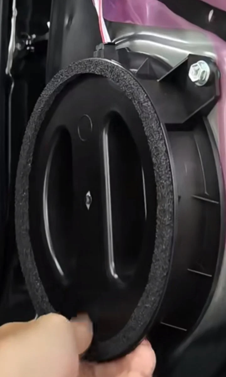

Update from dealership.

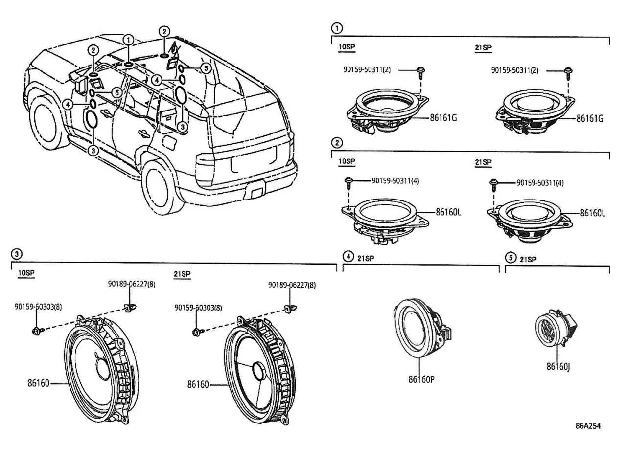

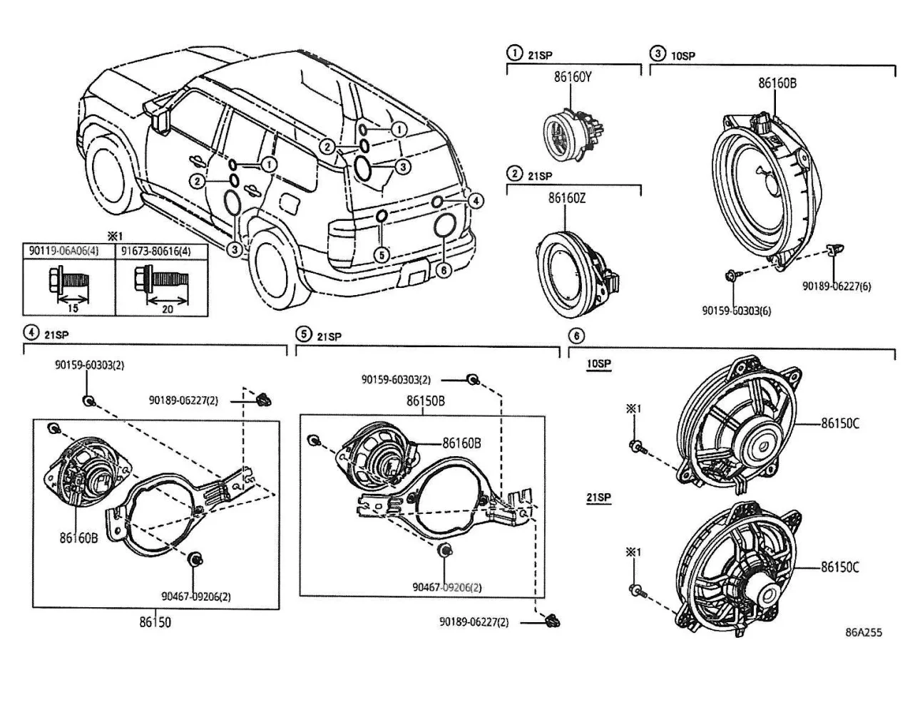

They removed the rear door panels and showed me the "dummy" speakers and said that all ML's were like this. The speaker map another forum member posted indicates otherwise.

Lux+ owner here. There are blank plastic speaker hole fillers in the rear doors of the ML equipped GX550’s. Yes, the connector is plugged in, but has no power going to it, and the plastic piece appears to only serves as a place holder for the speaker, and perhaps to maintain some rigidity in the door. Interestingly, the two other door speakers are mounted to the actual door panel, and come off with it, when you remove it from the vehicle. I may attempt to splice into the larger of the two door speakers, to add a 6.5” speaker to the bottom of the door. Just not sure how or if the factory amp has that speaker’s lower frequencies tuned out…in that case, it wouldn’t help much to add another speaker back there.
And, the door panel just pulls straight off, once you remove one screw behind the door handle and two from behind the door pull. Pull straight off, no lifting up on the top of the panel. All secured with push in clips.

Regarding the GX specifically, the subwoofer placement in the tailgate is not ideal. Many would likely prefer it to have been housed in the rear quarter panel rather than the tire inflator. However, my guess is that this decision was likely made before Mark Levinson's involvement in the system's final tuning, and once again, there were priorities and design compromises made.
