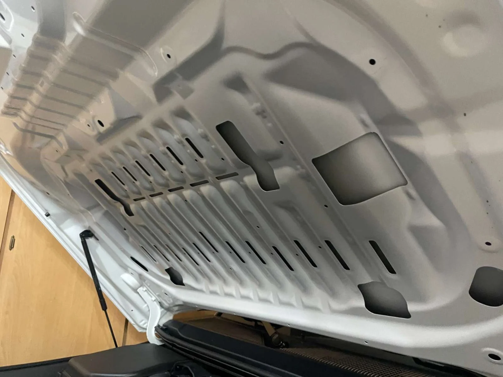

Sewell Lexus JUST called me to have my car come back in Friday to fix the hood flutter. It's about the adhesive that holds the hood to the supporting structure. They are repairing in their body shop since they have a fix now. I should have it back Saturday or Monday.

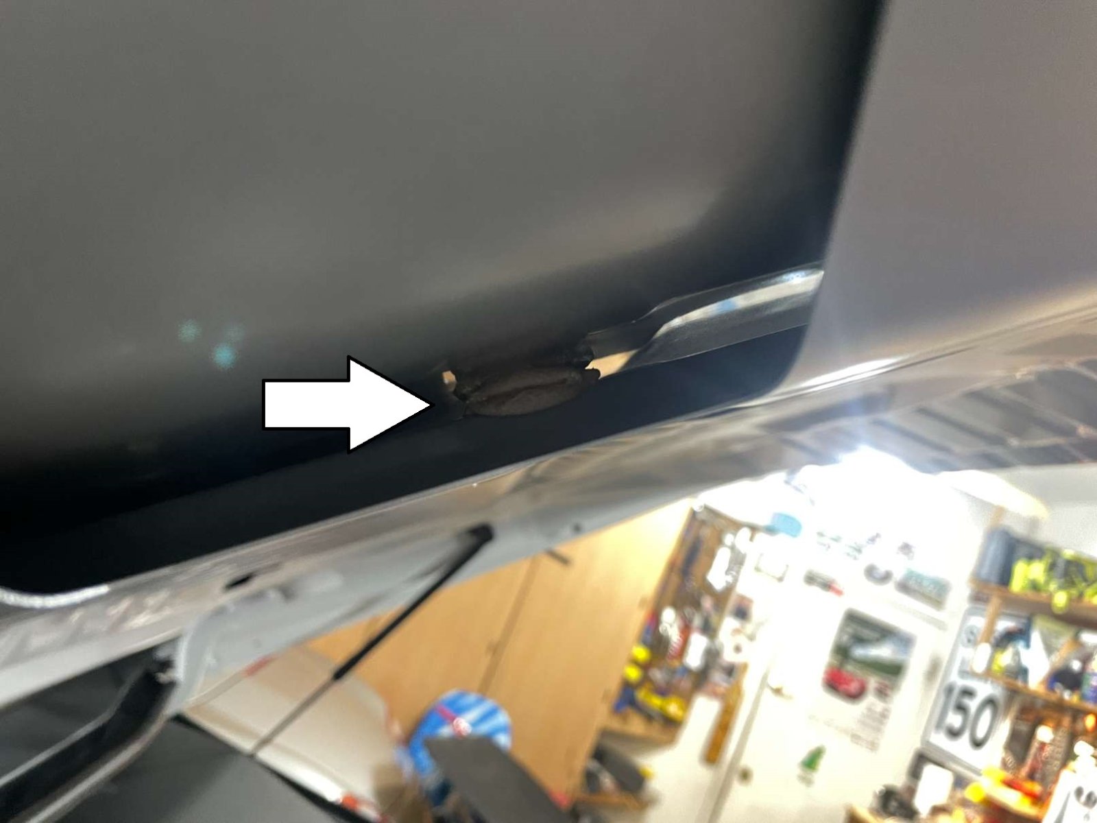

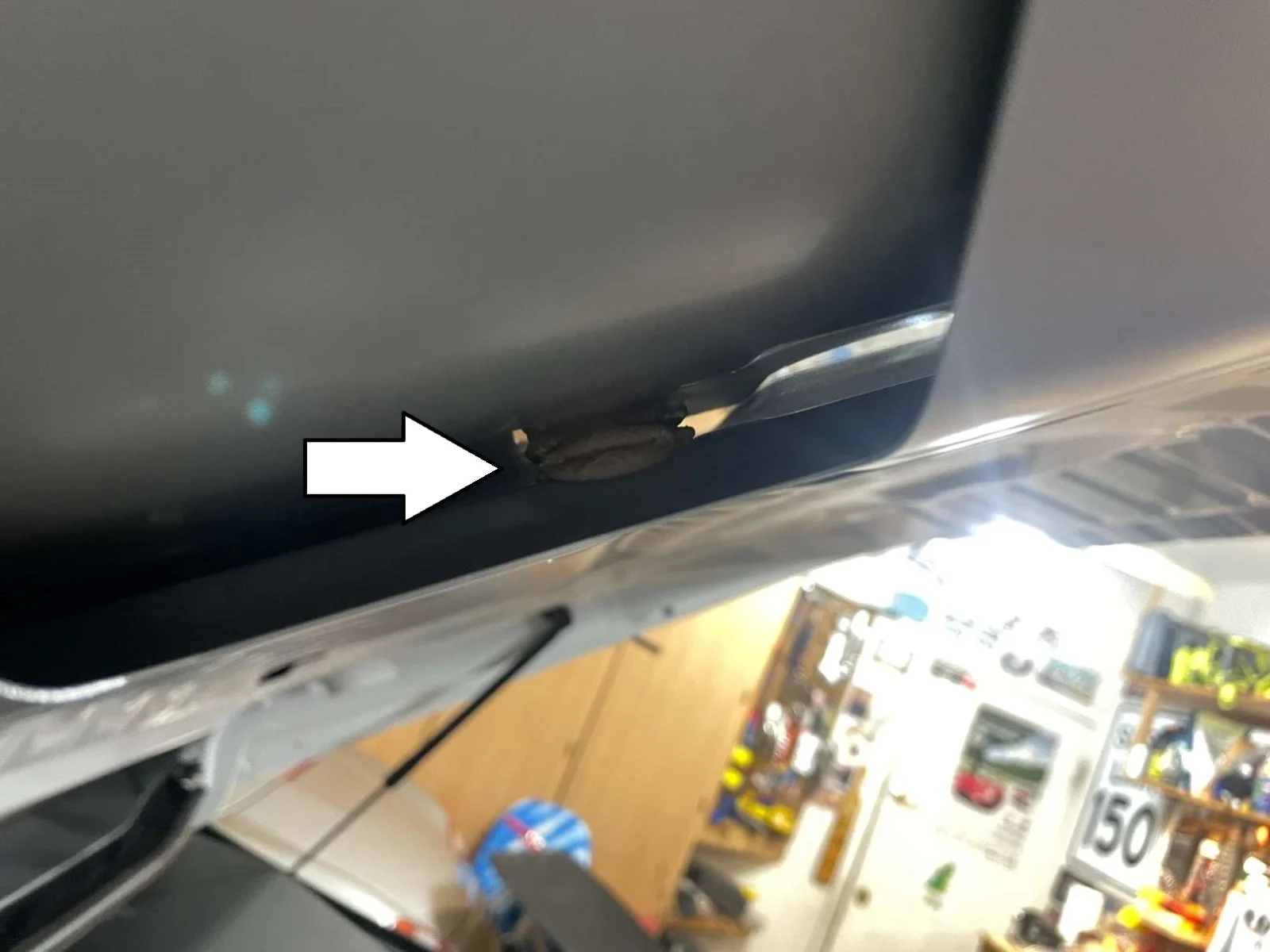

They will probably just squirt some thick toothpaste-looking adhesive up in the gaps between the very stiff inner structure and the outer hood skin. The same stuff that's in there now (see the arrow in the pic below), just more of it.
Yeah mine has a complete color change wrap on it. They are removing the adhesive that gets disconnected from the structure and replacing with new "goo" to bond them together securely.
