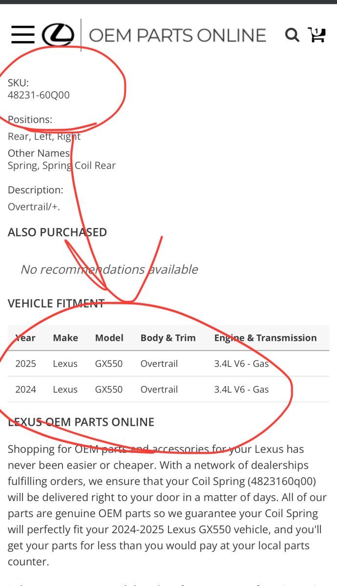

When I search the part #s from the OP the front says “2025 coil spring” and the rear says “2024-25 coil spring” leading me to believe the rear spring is identical. Is that the case? If so, I would definitely only swap the fronts
When I search the part #s from the OP the front says “2025 coil spring” and the rear says “2024-25 coil spring” leading me to believe the rear spring is identical. Is that the case? If so, I would definitely only swap the frontsView attachment 17203
The rear spring on the 25 is definitely different than the rear spring on the 24 I and others had. If you look at the measurements that I posted, you can see that by swapping the 25 for the 24, the car goes up about 1 inch front and rear.
