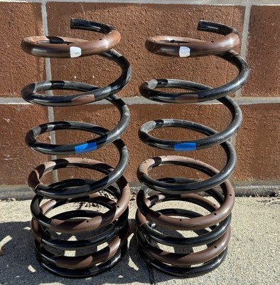

The rear spring on the 25 is definitely different than the rear spring on the 24 I and others had. If you look at the measurements that I posted, you can see that by swapping the 25 for the 24, the car goes up about 1 inch front and rear.

That is odd. When everyone here was looking into this issue we found different part numbers. I saw that on the online sellers as well as the Lexus dealer (where I ended up ordering mine). At the request of someone I counted the coils in the ones that came on my car and the 25 springs that someone else had on hand and they were different. And as I said, the measurements I did fairly carefully clearly indicated a more or less identical increase in lift front and rear both. Perhaps they’re no longer selling the original 24 rear springs?

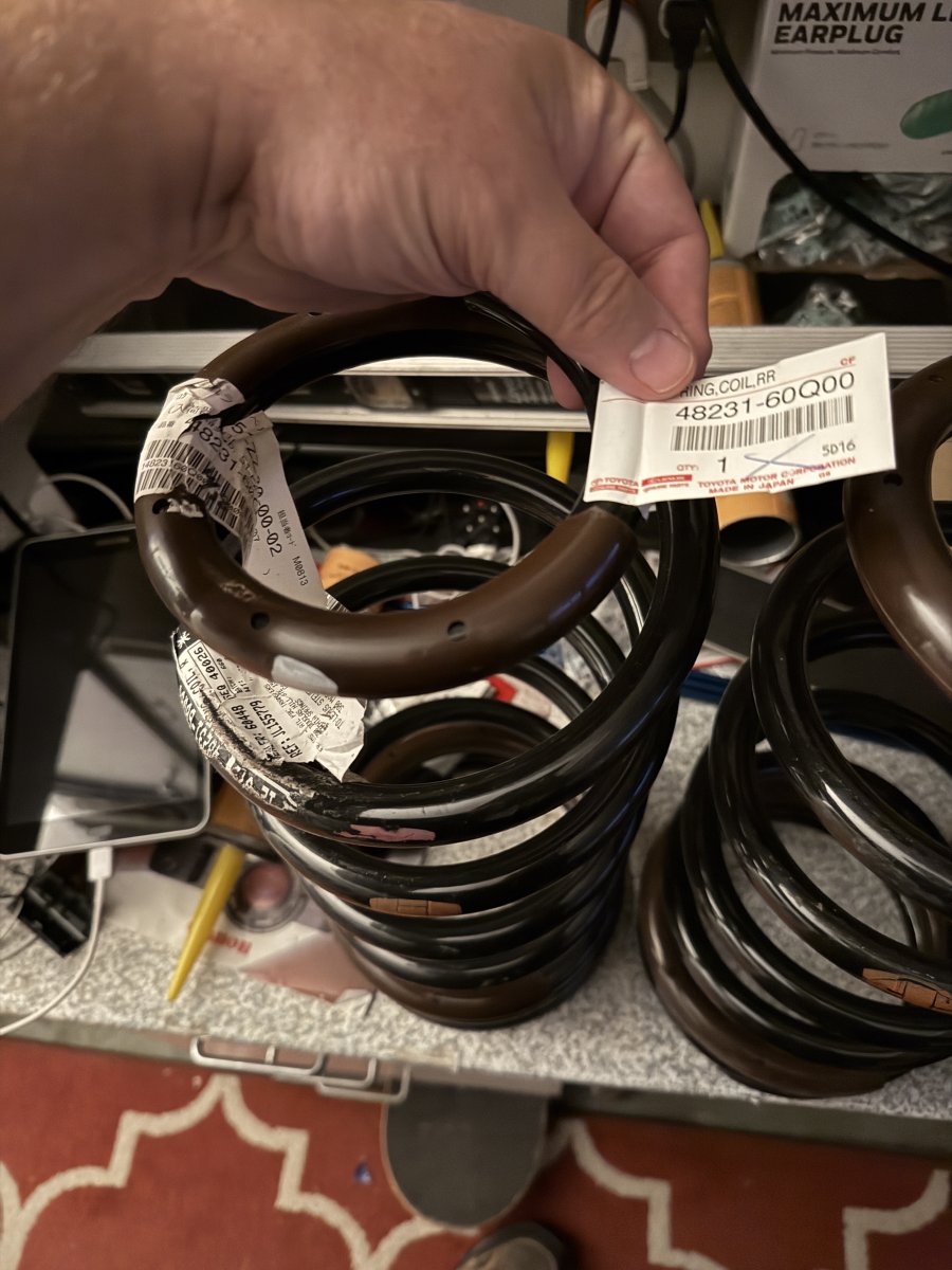

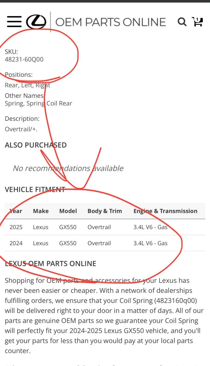

When I search the part #s from the OP the front says “2025 coil spring” and the rear says “2024-25 coil spring” leading me to believe the rear spring is identical. Is that the case? If so, I would definitely only swap the frontsView attachment 17203
Hi, confirmed by looking pre-install picture of my purchased coils that is the 2025 part number. I can confirm it works on a 2024 (mine) and provided a 1” rear lift.
Looks like they are only making the new part number going forward..
Looks like they are only making the new part number going forward..View attachment 17204

i'm not sure you want to mix n match springs. it sits high because it's designed to carry some load. if you're not feeling like adding some load in the rear, a pair of 24 or even non-lift, light OME should be < $500 for the pair but don't get your expectations too high other than appearances.
also shorter springs will be stiffer not softer. the 25-24 spring change has longer/softer rear and same length/stiffer fronts.
