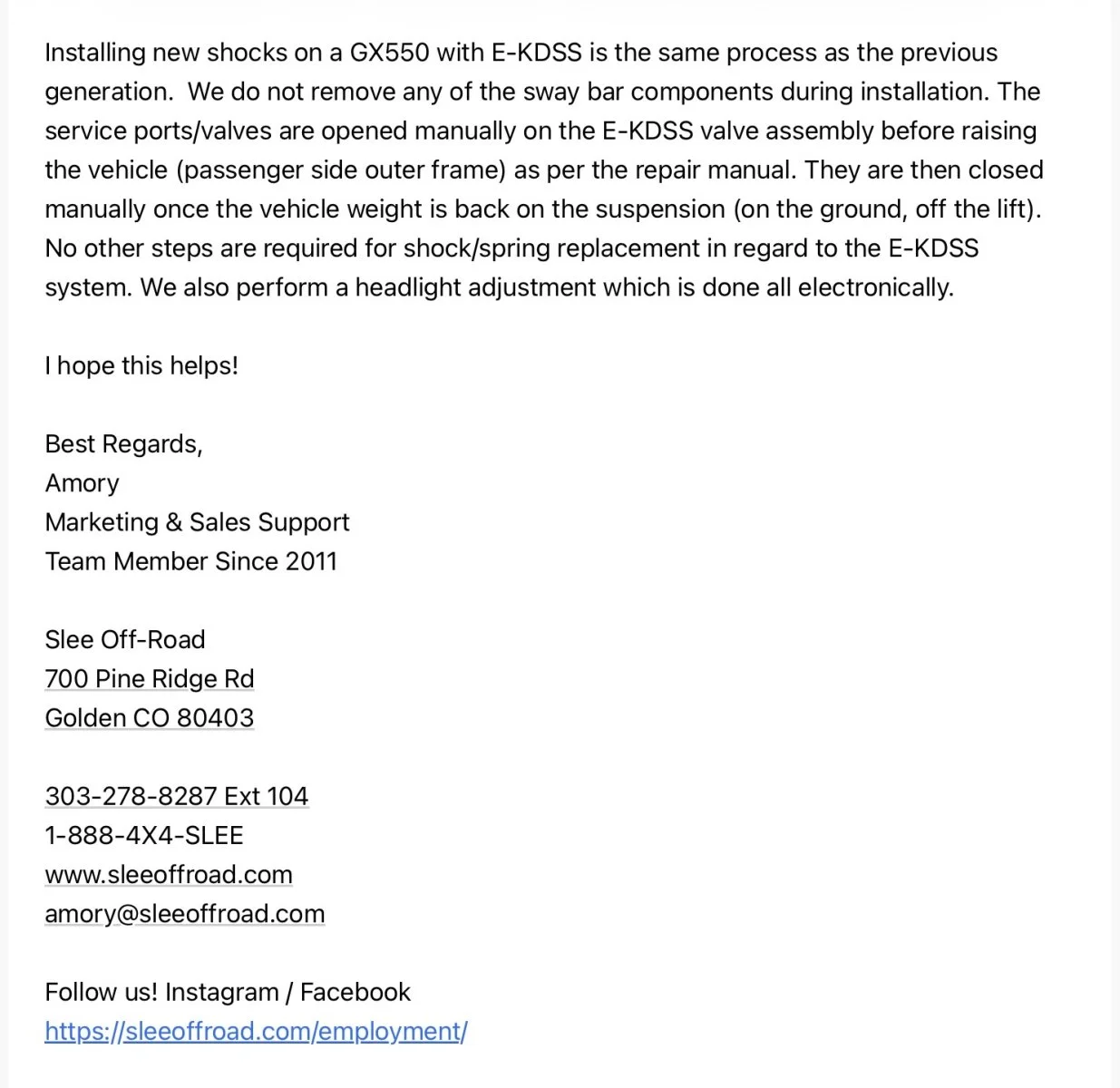

Not trying to hijack this conversation, but thought I’d add this short description of how the EKDSS is apparently suppose to be accommodated during suspension work on our GXs. Last year there was some similar discussion.
So after I had my MT64 lift kit installed at Slee I asked them a couple questions. See the attachment with their answer. Maybe this will be helpful to some.

Good info - it might have paid more at the dealer, but have read on the forum some folks dealing with a nightmare where the 3rd party shop had an issue and who was going to pay for the fix.
That is fantastic, just shared with a shop. I was looking for this type of info just last week. Very helpful indeed. Thanks again for sharing what the team at Slee noted. I hope to have a set of 2026 springs installed soon.

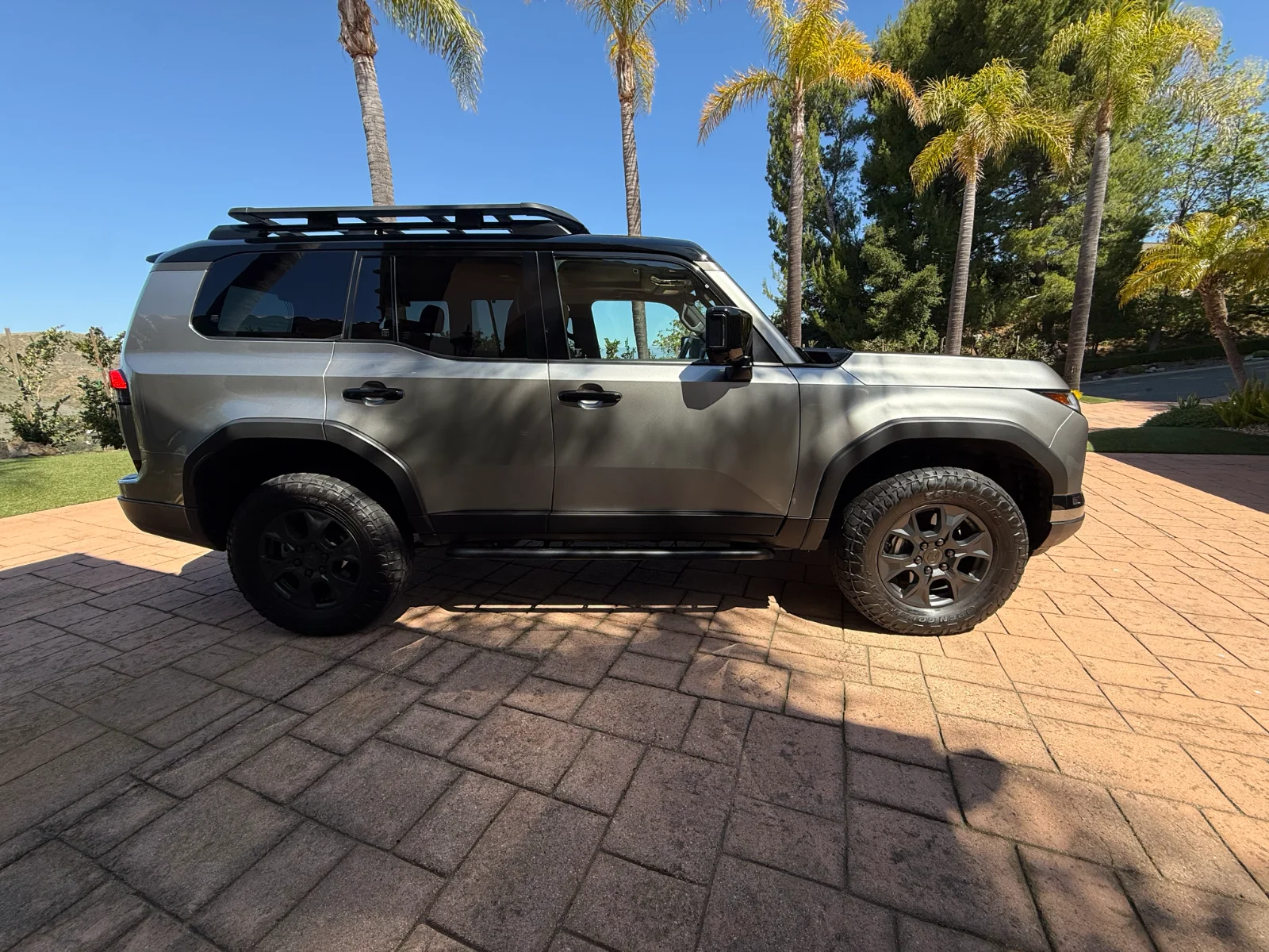

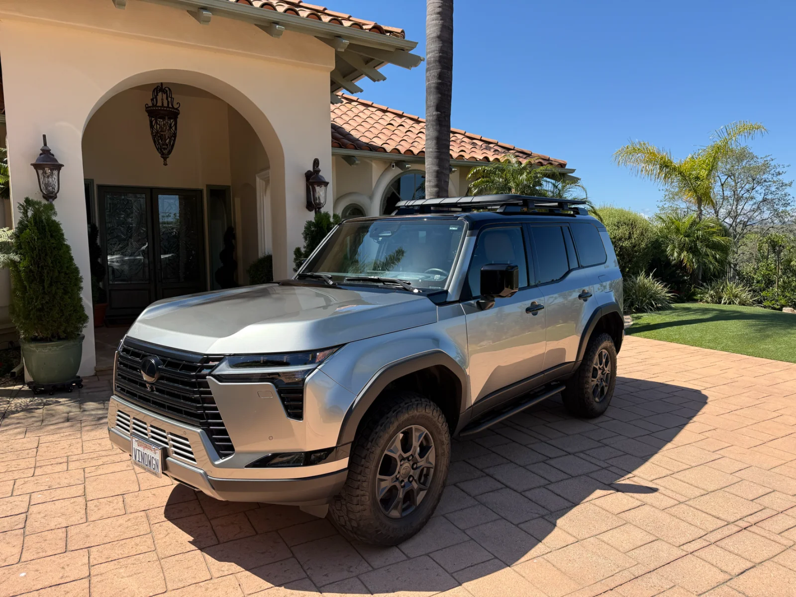

Pics do not do very much - measured from the tire to the wheel well edge. Look at Lexus of Akron - $1100 - no sales tax, could not find a better price anywhere else on line. If you stand next to the front wheel the vehicle does feel larger/raised; but nothing obscene or disproportional.

Looks like I may do on my own. Any photos of the front eKDSS sway bar valve/bleader/pressure relief location would be appreciated. Also, is the rear less of an issue? Maybe just disconnect the bar end links? Was also wondering if it could be put into off road drive mode like rock or dirt that may release it and keep released after turning truck off? I saw the Slee note prior.

My gut says let the dealer do it - they are liable for issues and since it’s the dealer the warrantee is good. If you do anything to the EKDSS it’s a $5k+ mess given some of the folks that has issues from good 3rd party installers.
I thought about buying the spring compressors and trying it out- but at the end of the day the possibility of an ‘oh shit’ moment made me go to the dealer.
Hmmm. The note provided by sleeping team sounded promising. I'll take at as a fair warning though. Any other advice...it's free by the way.
Note that the Slee basic explanation I posted references ‘the repair manual’. It does sound simple. But I would want that manual on hand so I could see all the details, warnings, etc..if I was thinking to do the work myself.
