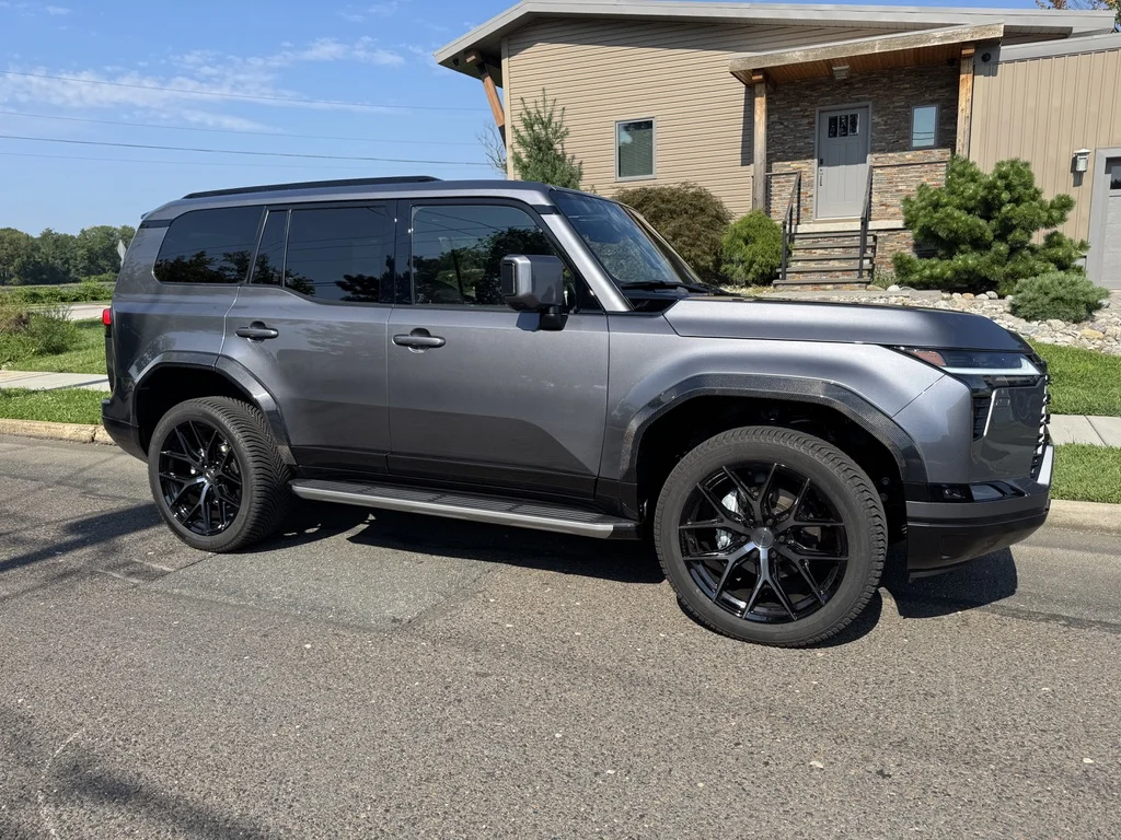

Hello, I'm looking for a set of 24OT springs to lower the rear of my 25 premium. If the other model of the 24's are lower/softer please advise as I would be interested in those if thats the case. I do think it needs it and I don't take it off-road. The rear looks too high to me. The light gray on the front side is a reflection.View attachment 19152
Only the 25OT got a lift vs 24. Your premium plus is the same height as the 24 premium plus models. Putting springs from a 24 won’t lower your car unless you have the 25OT springs on it for some reason. The gap is more likely due to your aftermarket wheel well trim and wheels/tires.

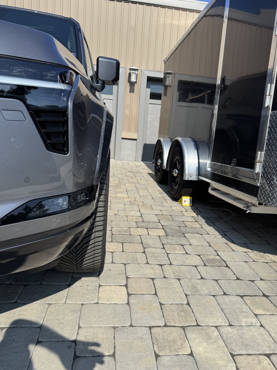

I bought the Vossen HF6-4 22x9.5 +30- DA wheel that were supposed to be flush as I'm not a of the poke wheels. With the Michelin CrossClimate2 285/45R22 the tires stuck out 3/4" +. No rubs on the wheel wells though and the cross tracks are great on dry, in the rain and the snow. I fount the NYtop fender flair and they did the trick for me. They are carbon fiber and pricy but worth it. Fit is nothing short of perfect. Had a minor issue and customer service was outstanding. I they made more parts that I would want, I would have them. Pic attached for the poke view.

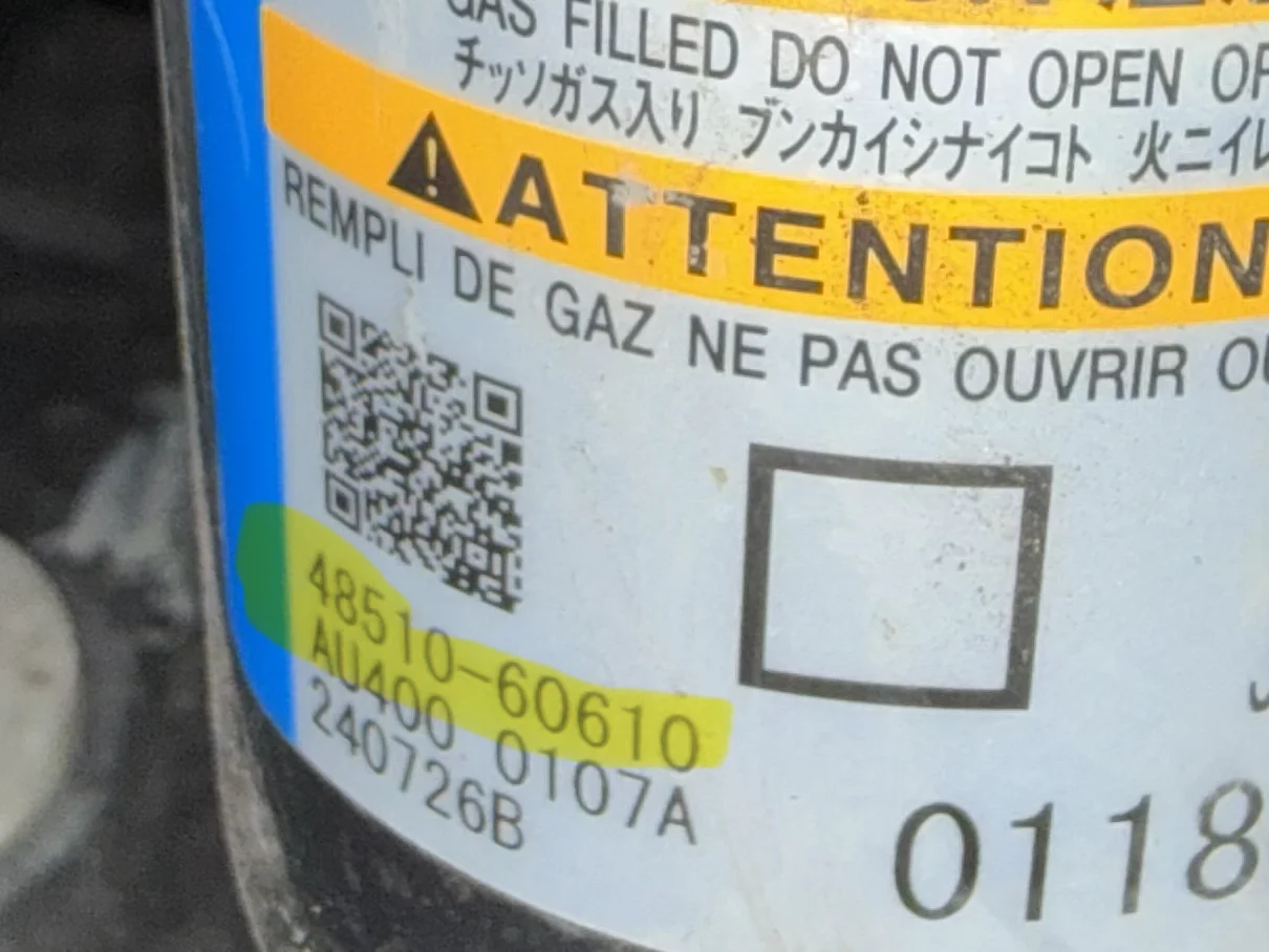

If someone has a 2025 Overtrail - can you validate the mark number on your front struts. See picture below - want to verify they are the same part mark number - 48510-60610

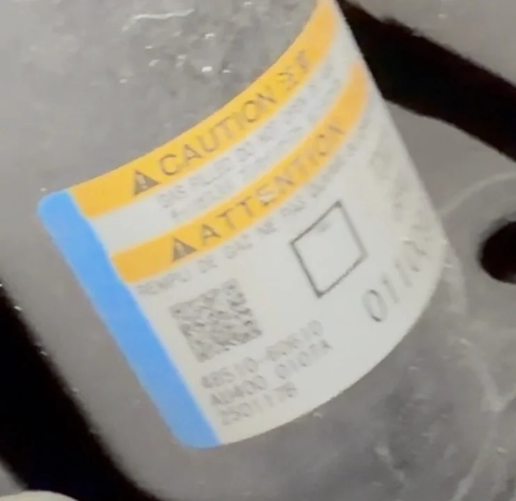

If someone has a 2025 Overtrail - can you validate the mark number on your front struts. See picture below - want to verify they are the same part mark number - 48510-60610View attachment 20311
Dealership techs are goons sometimes … makes no sense

I changed my '24 front springs only to '25 to level it. Got it done at Lexus and they didn't give any push back. The shocks are the same. Part #s don't change, only spring #s.

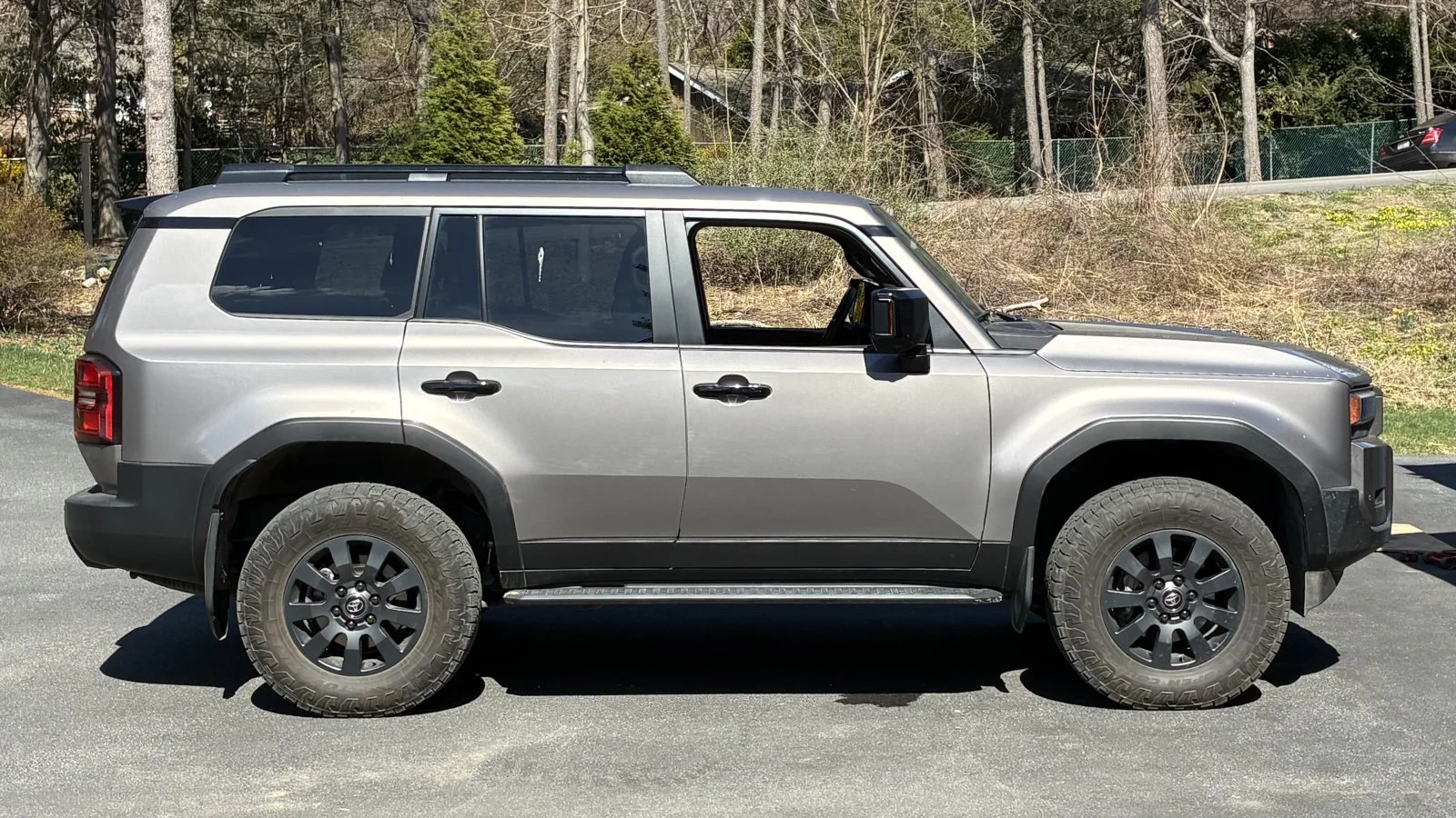

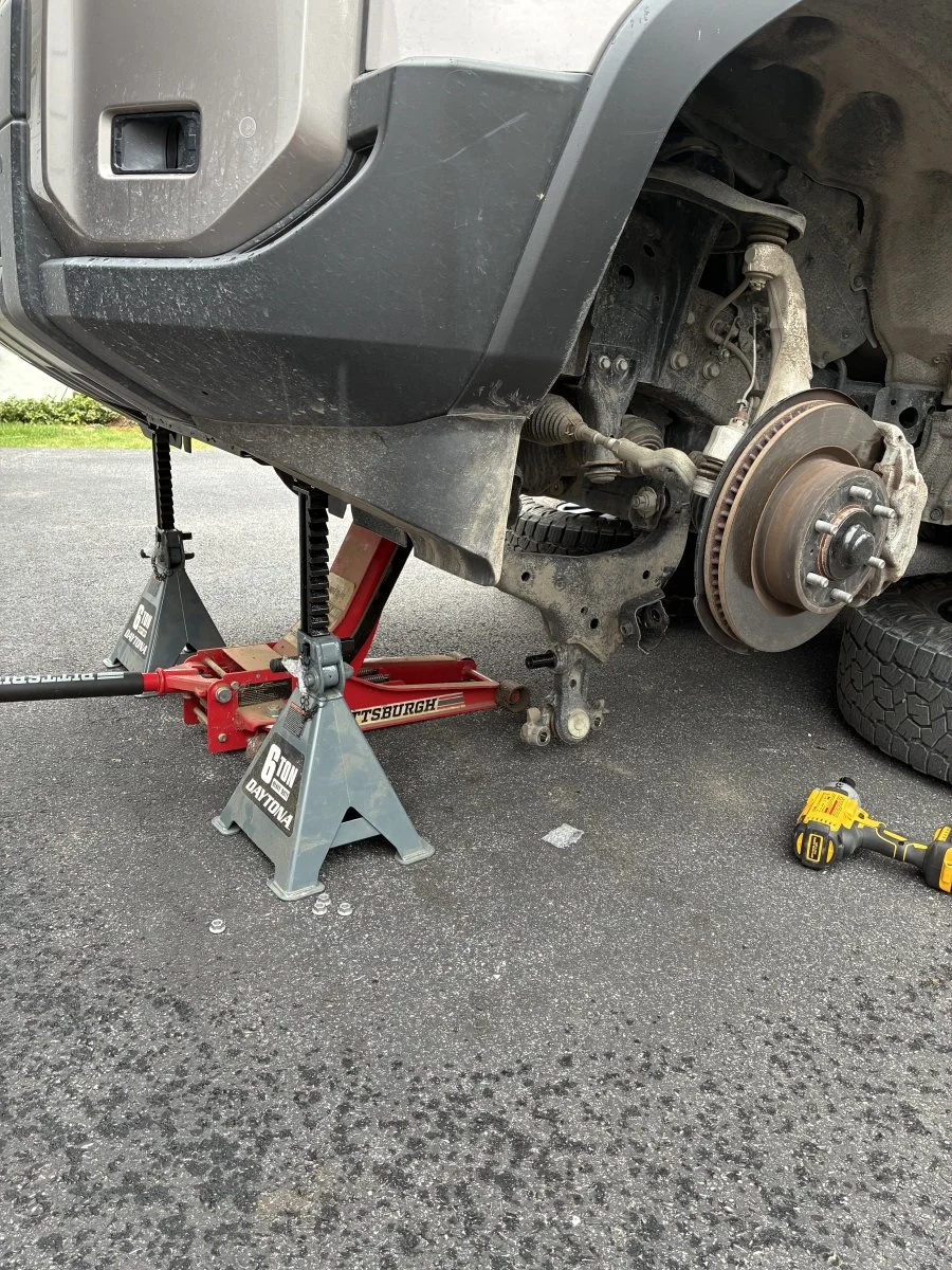

Quick update here. Dealer canceled my order after I posted this and I lost interest for a while. Recently picked up new takeoff coils from a 2025 overtrail and did instal them on my 2024 lc250. Long story short, front raised 2”, I was hoping for 1.5”, oh well. Hopefully this comes down slightly over the next year as the coils get broken in. The extra 1” is due to engine weight difference (4cyl vs 6cyl). I didn’t use the rear coil as the GX spring felt much softer when I sat on it and was the same height extended as the LC coil. LC probabbly uses stiffer coils because of the battery pack. I ended up putting a Westcott 3/4 spacer in the rear paired to my stock coil. I had the kit kicking around in the garage. The end result is really no change in driving manners and an absolutely level rig. Total time for the swap including compressing the struts was 4.5hrs and if I did it again it would probably be 3. I didn’t take any before pics cause someone was parked next to me but here’s an after and the jack/jack stand setup. By the way, Vevors Strut compressor, the single sided one, is awesome!
