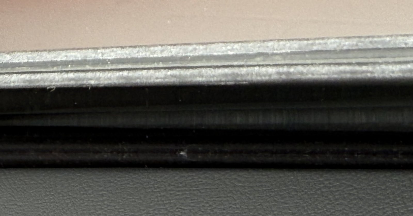

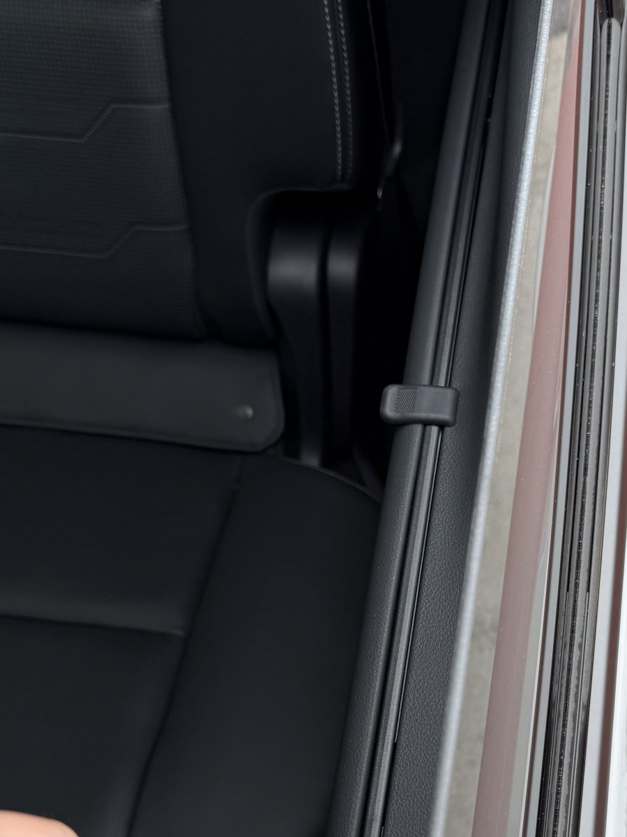

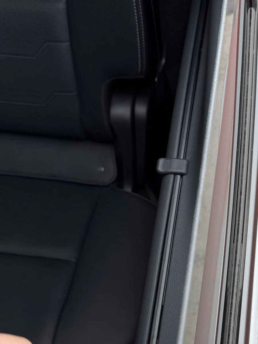

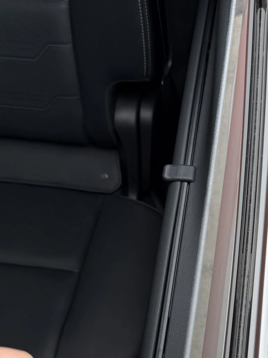

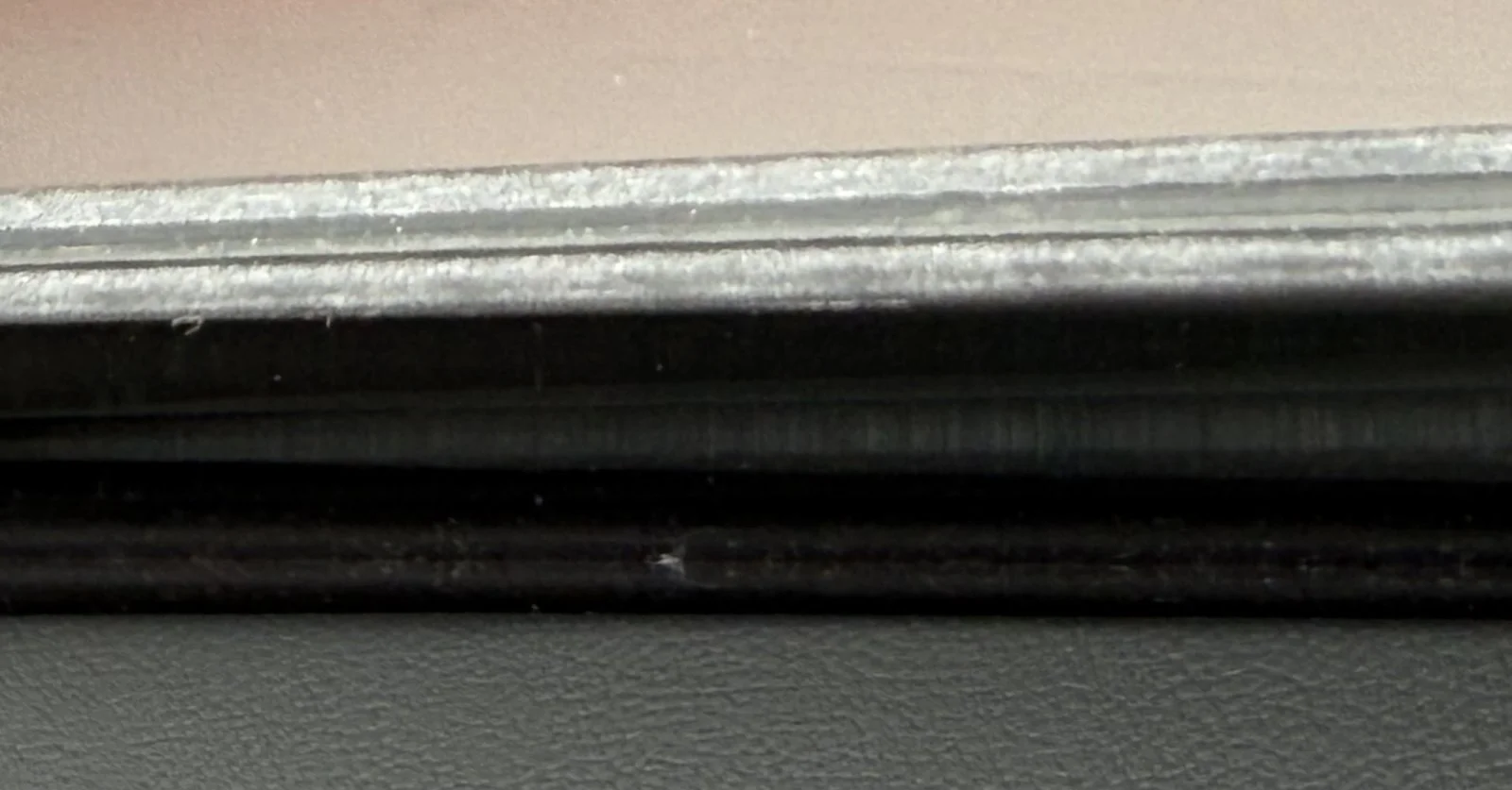

It appears that on my lux+ the front windows have acoustic glass. But not the rear windows. You can see the multiple layers on the front and just a single layer on the back. What do you guys see?
View attachment 11439View attachment 11440
The front windows are laminated glass the back are tempered. Not sure that has anything to do with acoustic, but it explains why you see layers on the front windows.

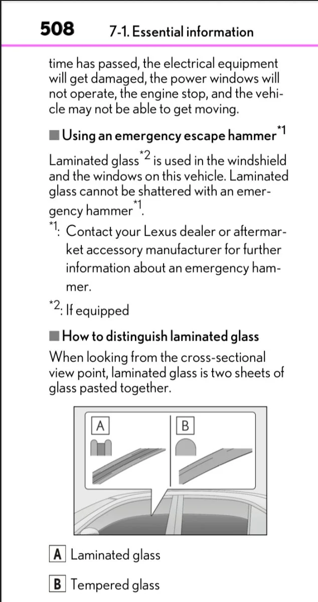

Owners manual says all GX 550 have laminated (aka acoustic glass). Page 508. If you look up same in the LC owners manual you will see the LC only has laminated in the windshield.
Lexus has a foot note “if equipped”. the OT does not have the laminated glass on the front windows.
On my premium, only the front windows are laminated and have “Lamipane” etched into the glass. The rear windows are tempered and etched with “Temperlite”. The windshield is “Lamisafe”. Just look at each window etching to verify.
Not true. Laminated glass is designed for safety and keeps the glass intact when shattered. Acoustic glass is specially designed for sound reduction.
True, but although not true “Acoustic” glass, Lexus uses that term in its marketing of laminated glass as the laminated dual pane has better sound attenuation than a single pane of tempered glass.
