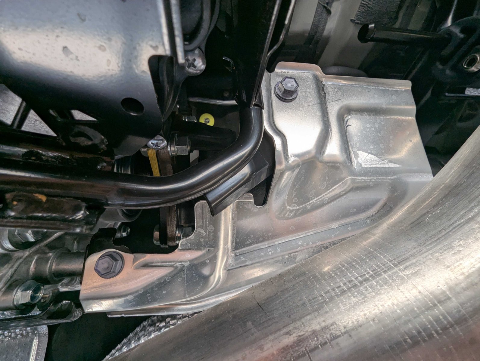

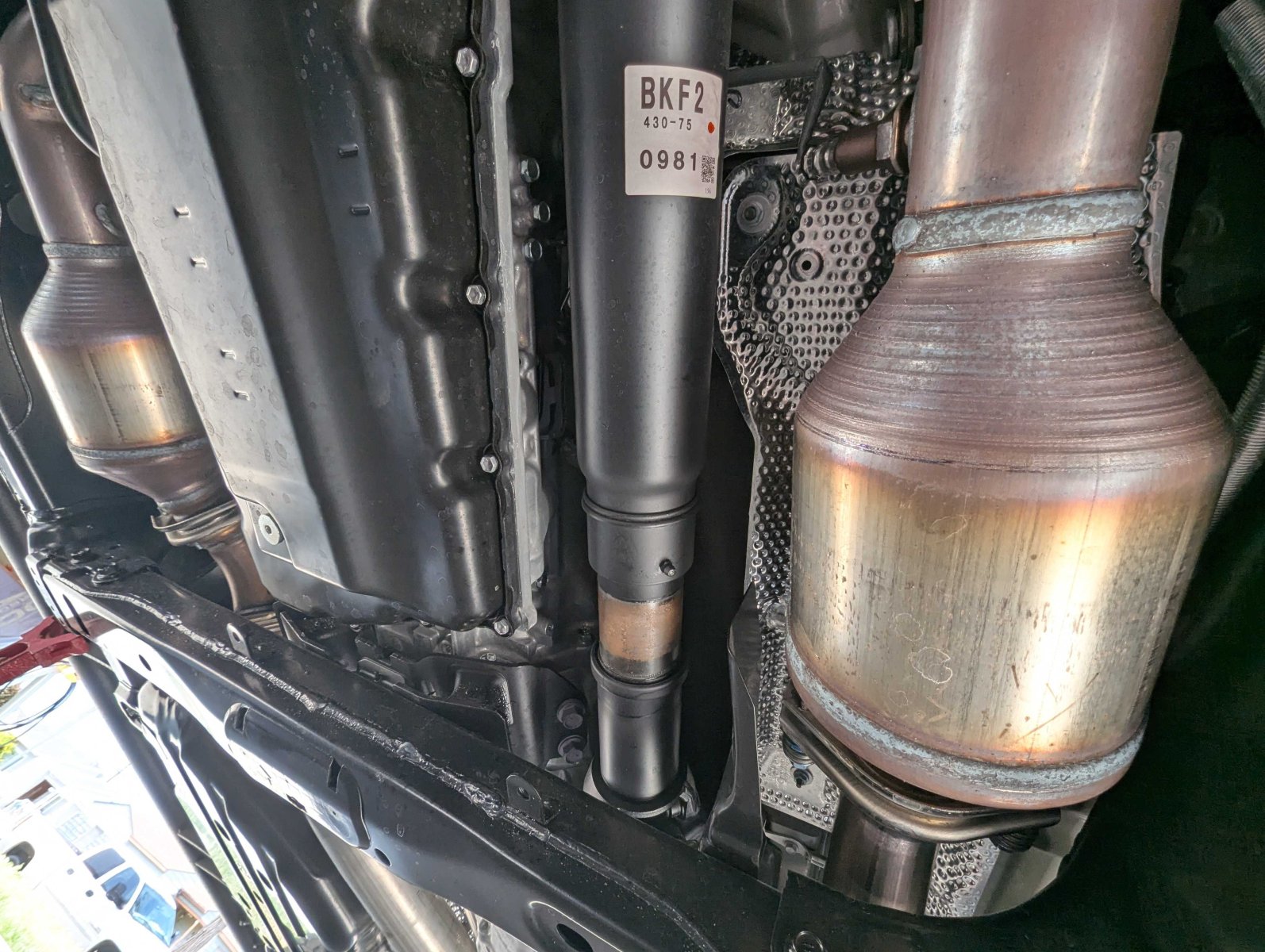

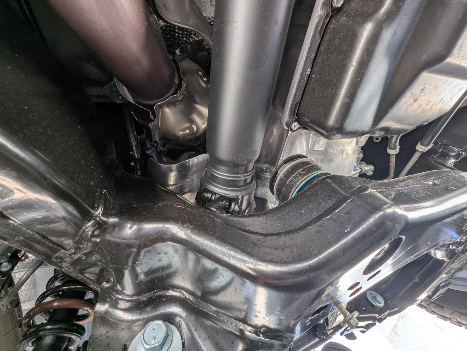

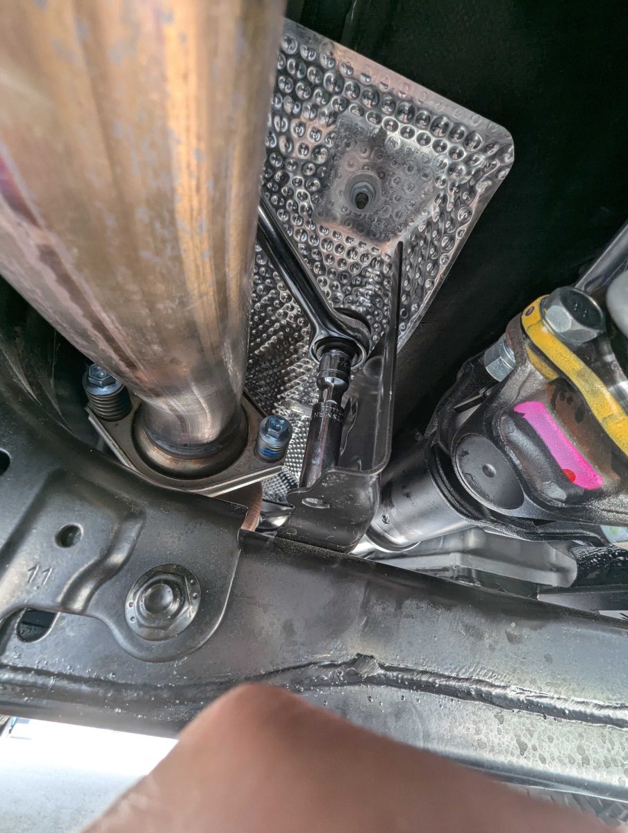

Did my first oil change yesterday, and greased the driveshaft while I had the skid plates off and everything up in the air. Obviously, it does have zerks! The GX550 has a front propeller shaft and a rear propeller shaft. The front has 3 zerks, one at each spider and one for the slip yoke. The rear has 2 zerks, one at each spider.

As suspected, the u-joints only had assembly grease and were not completely packed. It took about 5 pumps each before they started purging the old grease. I gave them all about 15 pumps total to make sure the old stuff was purged. DO NOT OVERFILL THE SLIP YOKE WITH GREASE. The service manual says to only pump until the slip yoke starts to move (about 3 pumps for me).
Its probably easiest to do this with the whole vehicle on jack stands and the transmission in neutral so that you can move the wheels and get the propeller shafts in the right position to access the zerks. I did have to remove two heat shields, one on the rear of the front propeller, and one on the front of the rear propeller. You will need a 12mm socket and an assortment of extensions for this.
