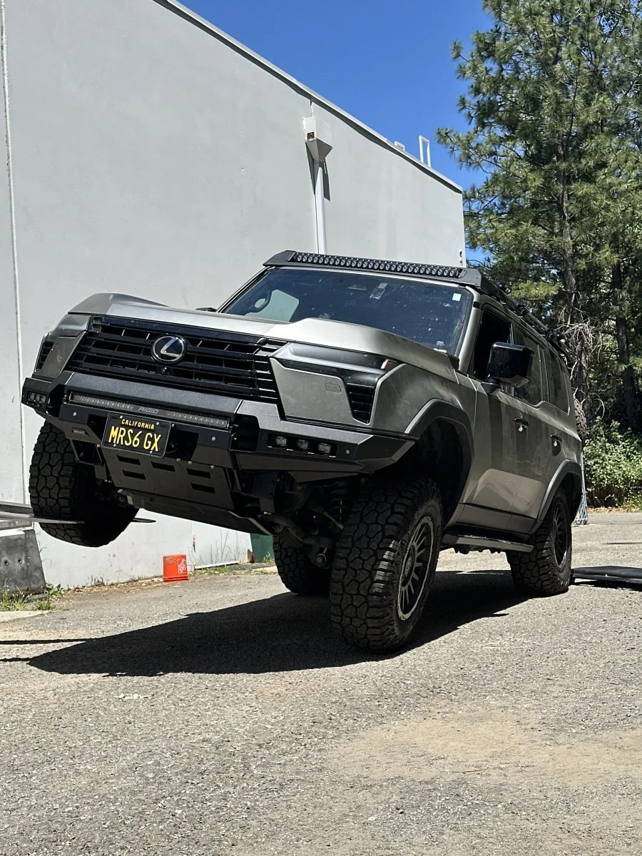

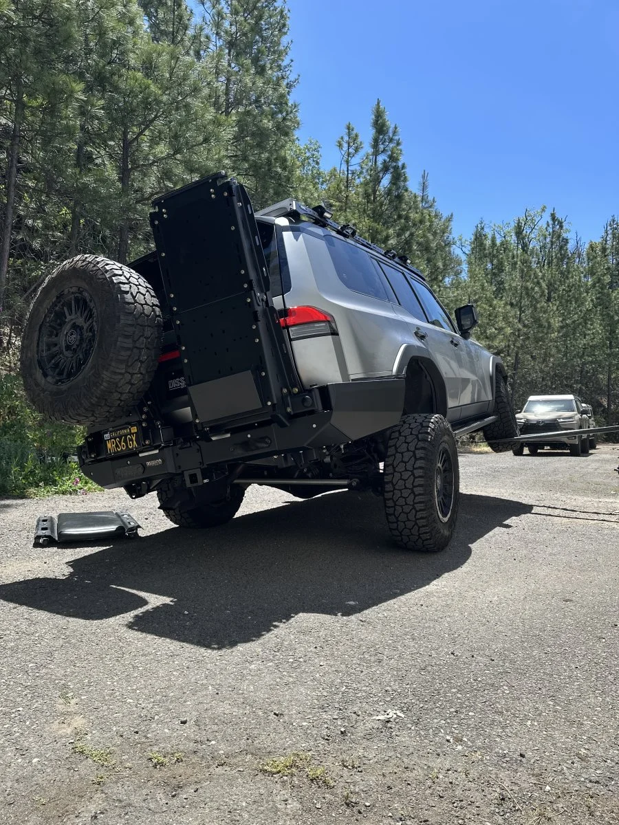

Yes. We’ve got the stage 10 CDEV Billet on our Overtrail+. I believe we’ve put about 7k miles on the ICON kit it so far. Love it. Haven’t put many dirt miles on it yet, because we’ve been working through some other upgrades. We’ll hit some dirt for a trip soon.
Not getting error codes unless the battery is dis/reconnected and the GX goes through a systems check.
Meanwhile, we just got put on a satin PPF at Beyond Wraps and bumper/sliders/roof rack at Dissent Offroad.
I have to find some time to do a full video on it as it sits today. :)

If you wouldn't mind at some point in the future (no hurry), could you provide a height measurement to a fixed point...say the top of a side mirror? I'm trying to determine how tall I'd be with this same Icon suspension. I can extrapolate how tall I'd be with my 35s and my Westcott roof rack. I want to still be able to fit in my garage and I only have about 3 inches to spare.
Right before we did the bumpers, etc… we measured center hub to bottom fender. With ICON CDEV (on not perfectly level ground) we were:
FL - 23 3/4
BL - 24 5/8
FR - 23 1/4
BR - 24 1/4
Icon lift with Dissent bumpers, winch, rock rails and roof rack (also not perfectly level ground):
FL - 23 3/4
BL - 23 1/2
FR - 23
BR - 22
Keep in mind, these were not measured in the same place and not exact… but gives you an idea of height. To be a little more accurate, I’d average the right/left together since I know I didn’t have a level spot to measure.
