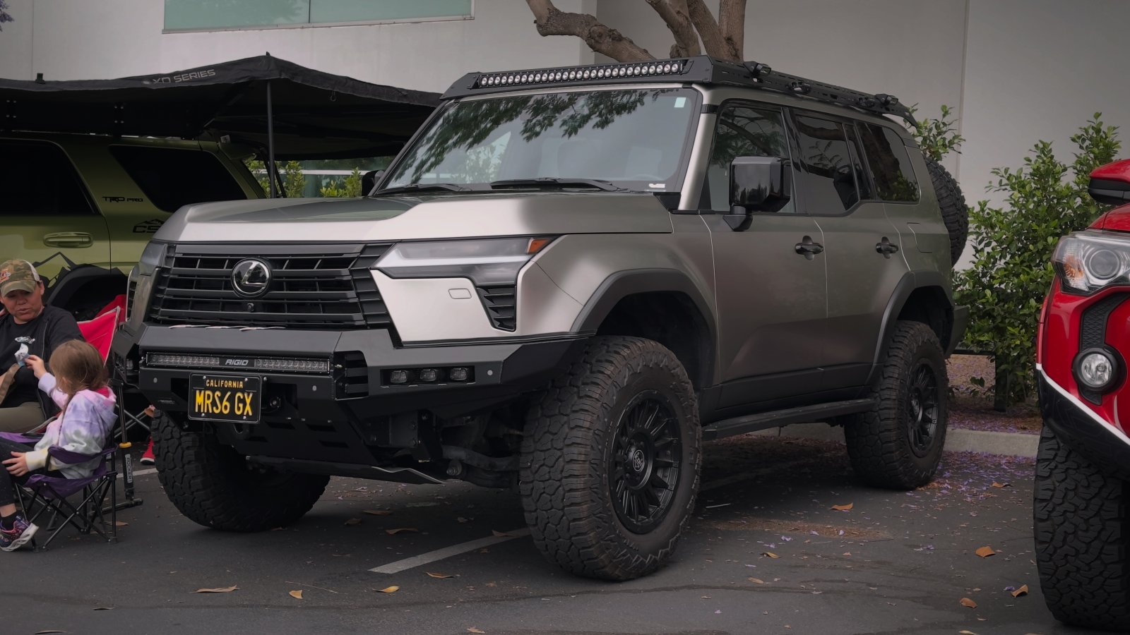

Check out this awesome GX build
Right before we did the bumpers, etc… we measured center hub to bottom fender. With ICON CDEV (on not perfectly level ground) we were:
FL - 23 3/4
BL - 24 5/8
FR - 23 1/4
BR - 24 1/4
Icon lift with Dissent bumpers, winch, rock rails and roof rack (also not perfectly level ground):
FL - 23 3/4
BL - 23 1/2
FR - 23
BR - 22
Keep in mind, these were not measured in the same place and not exact… but gives you an idea of height. To be a little more accurate, I’d average the right/left together since I know I didn’t have a level spot to measure.
You dropped 2.25 inches on the right rear?

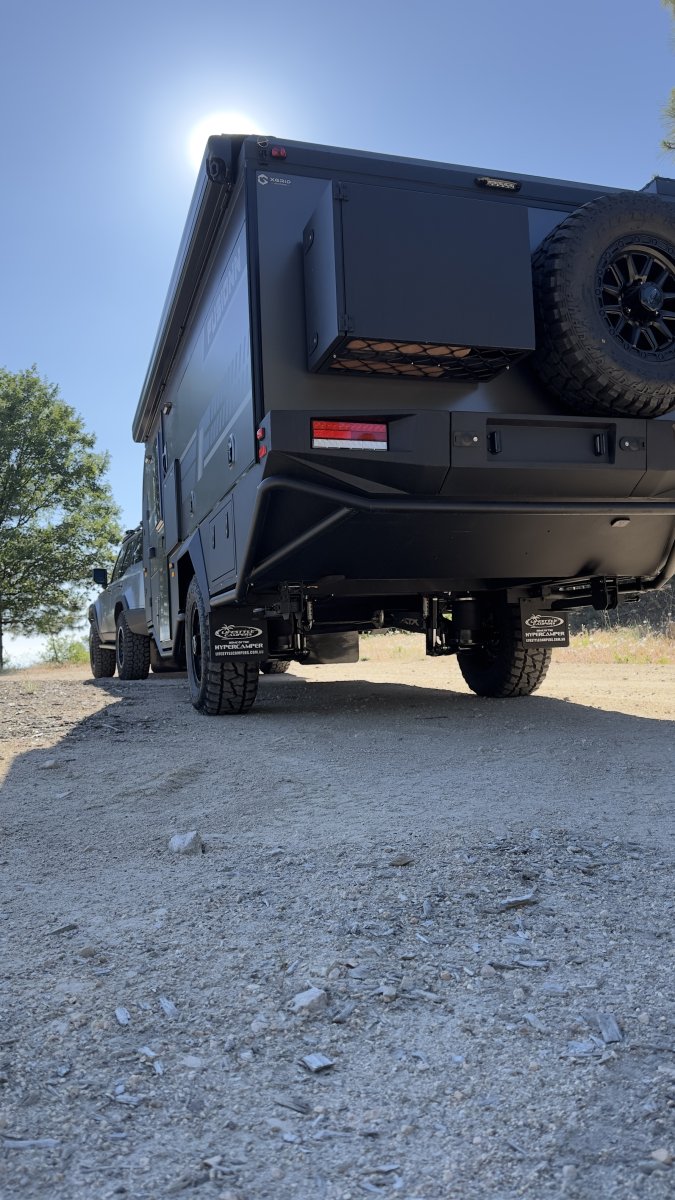

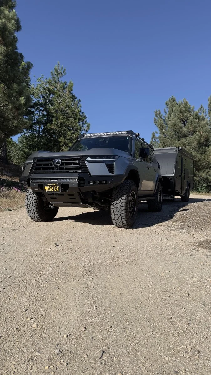

We went back to Icon for re-evaluation to factor in the bumpers and tow ball weight when towing. Swapped for a stiffer spring. A bit of a rake when unloaded, a small squat when loaded… but a happy medium. Felt good driving and I think this is where we’ll leave it.
