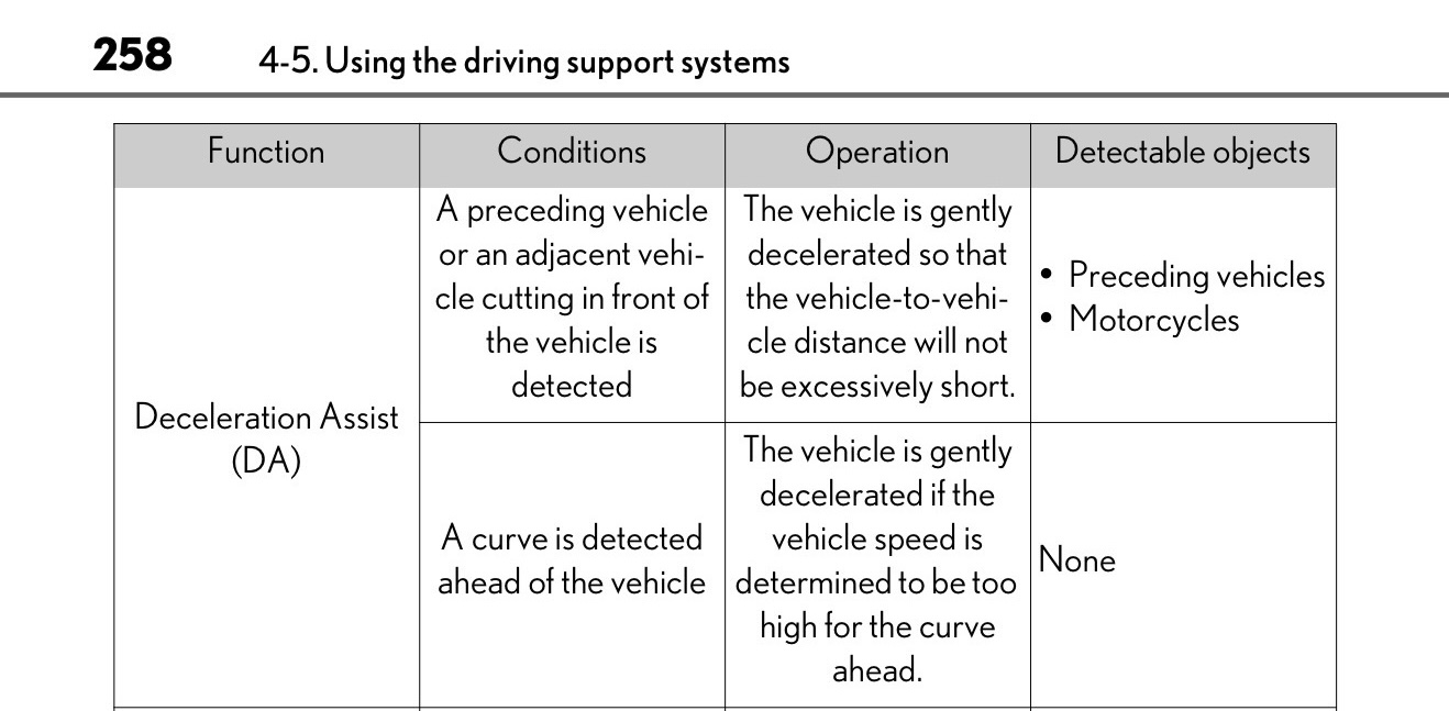

Yes. Go to settings - Driving Assist- Driver support - scroll down to Deceleration assist. To turn it on or off.
This is a setting that’s under the Proactive Driving Assist. So it only applies when Proactive Driving Assist is on. And it definitely isn’t going to change the transmission’s operation.
I already had this setting in the OFF position. It's pretty aggressive at braking you in traffic or at stop lights.
Think that is a different situation than what was noted. Transmission slows down with down shifts to maintain speed (not accelerate due to gravity or previously generated momentum). The proactive assist is mostly when approaching other vehicles. Some on the turns as well, but not when just coasting down hill.
Interesting. So does approaching a light with a vehicle in front of you count as proactive assist? Sure seems like the braking gets more aggressive to me.
I found that the truck was very aggressively braking itself when I was coming to a stop at stop signs or traffic lights. Like you're the little old lady who has to ride the brakes to stay 100 feet away from the car in front of you in slow-moving traffic. Very annoying and distracting so that feature got turned off right away. The automatic cruise control is equally annoying with aggressive braking if a car pulls into your highway lane waaaay ahead of you (and I have the adjustable distance setting at the closest setting). What ends up happening is that people behind you see you leaving a giant gap ahead of you and they just pass you on the right and you keep moving back in the rotation.
I also turned off the driving assist half way through our test drive in traffic. Not knowing how it worked, it created a jerky stop and go. We almost didn't like the truck because of that. Once the salesman turned it off (my wife was driving) it was night and day. After reading the manual and later trying it out again I found it can be helpful and less fatigue driving in limited traffic and stop and go areas. You can drive, coast and vehicle will do some braking if that is not enough without lifting the right foot to the brake. It does not complete the stop if coming to a light and a car is in front of you. You do need to intervene to stop eventually. On the highway with adaptive cruise, if a car pulls in front of you and is traveling slightly faster than you the braking is not applied.
