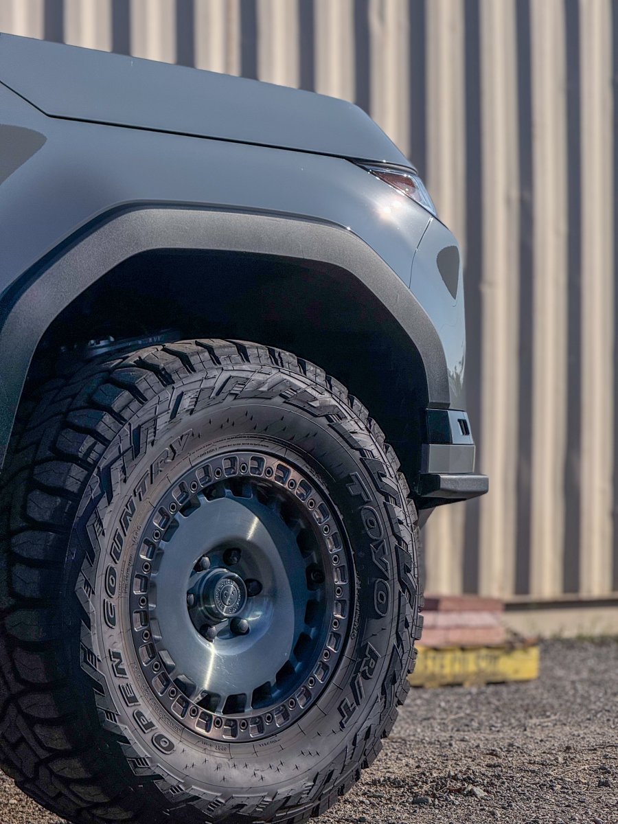

NEW WHEEL SET UP
Working in the wheel/auto parts industry for over 10 years has given me the knowledge and resources to manufacture my own monoblock forged wheels. Here is the first set I built for my GX. The spec is a little bit on the aggressive side but I think it works well with the factory Toyo AT Tires 265/70R18. It does have a slight poke and zero rub.
Finish : Gloss Brushed Gunmetal
Weight : 12.7 kg each
Material : Monoblock Forged

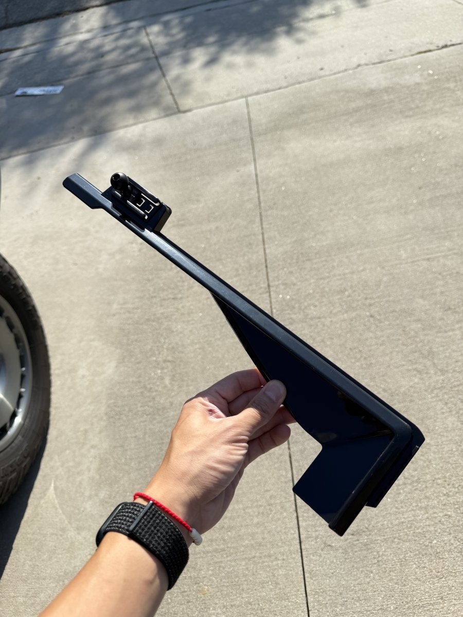

WINDOW VISOR

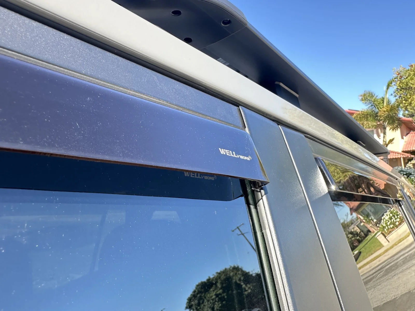

WellVisor - R&D Vehicle for WellVisor - August 2024 .

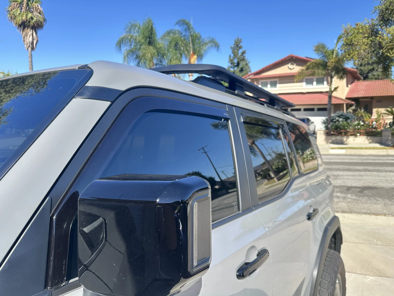

I was invited by WellVisor to try out their new visor for the GX550. This is the slide-in type, and the installation was very straightforward as it does not require any double-sided tape or clips. The visor does require a minimum of 24 hours to "settle in". The reason I mention this is because there's a safety feature for the window to roll down automatically if it detects something in the way (such as fingers, etc.). To let it settle in, simply leave the window closed for 24+ hours, and the window will work normally again without trying to roll down on its own when you try to close it.
I love how simple the design is and it sits flush with the door. Definitely a must-get accessory for all GX owner.

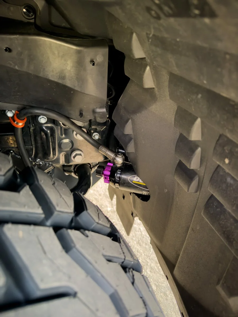

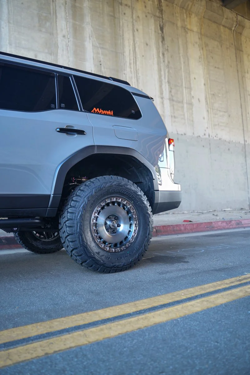

The GX is now installed with Dobinson MRR 3 Ways along with RRW Upper Control Arms. My new wheels came at the same time so I upgrade the tires to 35s as well. Here are some pictures to share!
I have about 1,000 miles on the Dobinson suspension so far. Since this is the first MRR kit installed on the GX, we encountered some minor installation issues, which were resolved after working with Dobinson. Their customer support was great—thanks, Dave! Due to the Overtrail being equipped with EKDSS, the original location to mount the reservoirs recommended by Dobinson for the LC250 didn’t work. We installed the reservoirs in front of the tires and wedged them behind the front of the fender liner. So far, I haven't experienced any rubbing issues with the 35-inch tires; there are about two finger-widths of space between the tires and reservoirs when in full lock. I haven’t had the time to take the car off-road yet, so I can't comment on whether it will cause any rubbing issues during that type of activity.

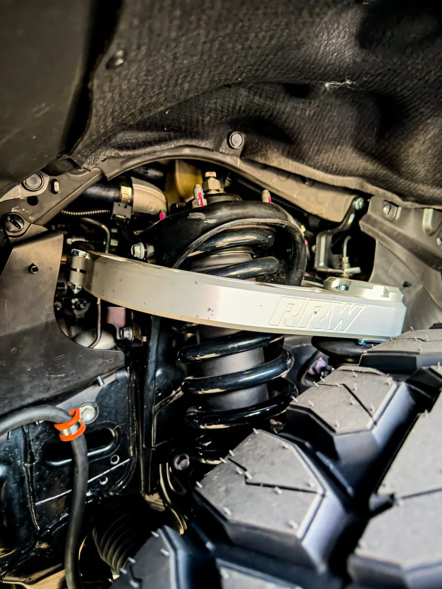

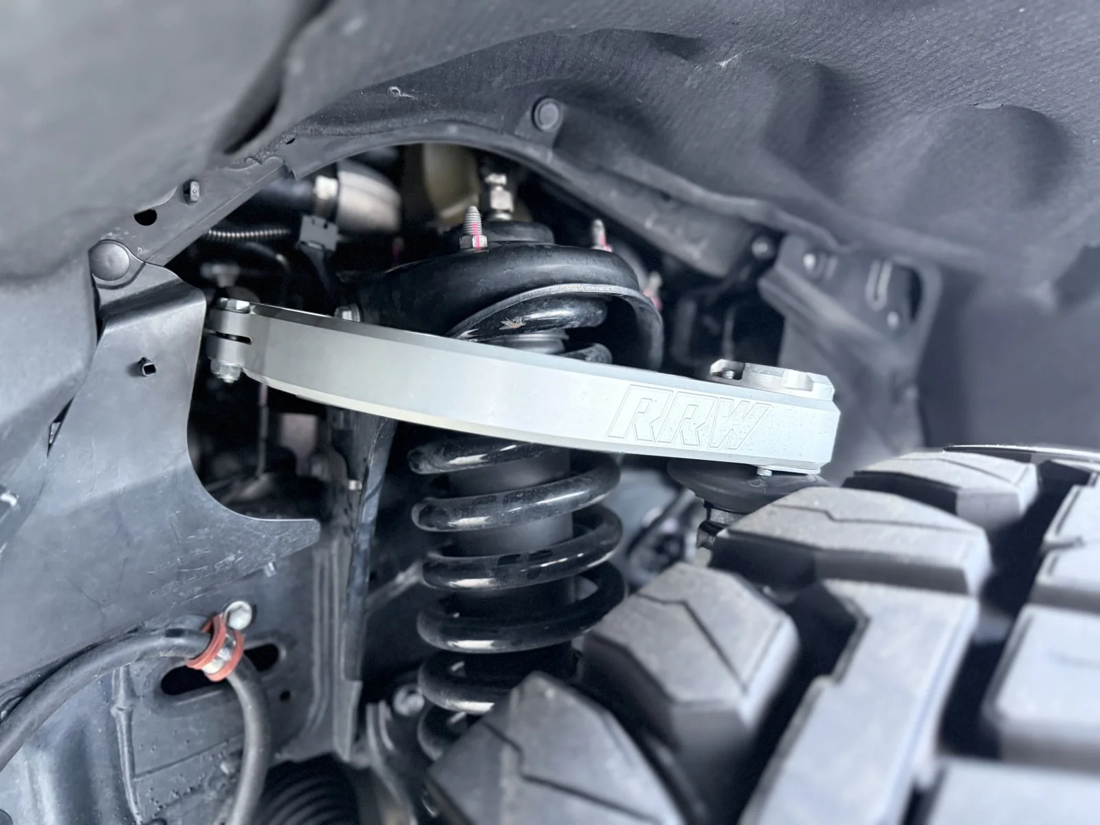

As for the Relations Race Wheel (RRW) billet upper control arms, they are a high-quality component and add extra flair to the build! The completely sealed uni-ball is quiet and requires very little maintenance since it’s sealed and doesn’t need frequent greasing. While billet upper control arms are pricey, you get what you pay for. I would 100% recommend them!
I also purchased the ICON adjustable track bar to help center the axle. During my first alignment, I faced numerous issues. Most alignment shops don’t have the proper alignment specs for the GX, and after getting the car back, the rear end felt like it was swerving left and right when I accelerated quickly from a dead stop. The adjustable track bar should help resolve this issue.

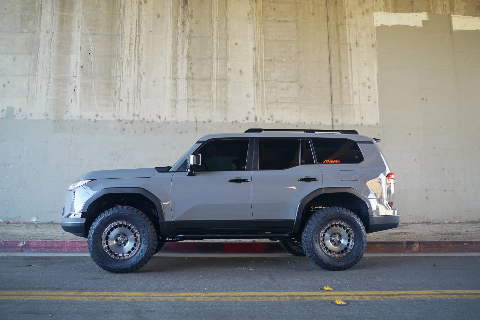

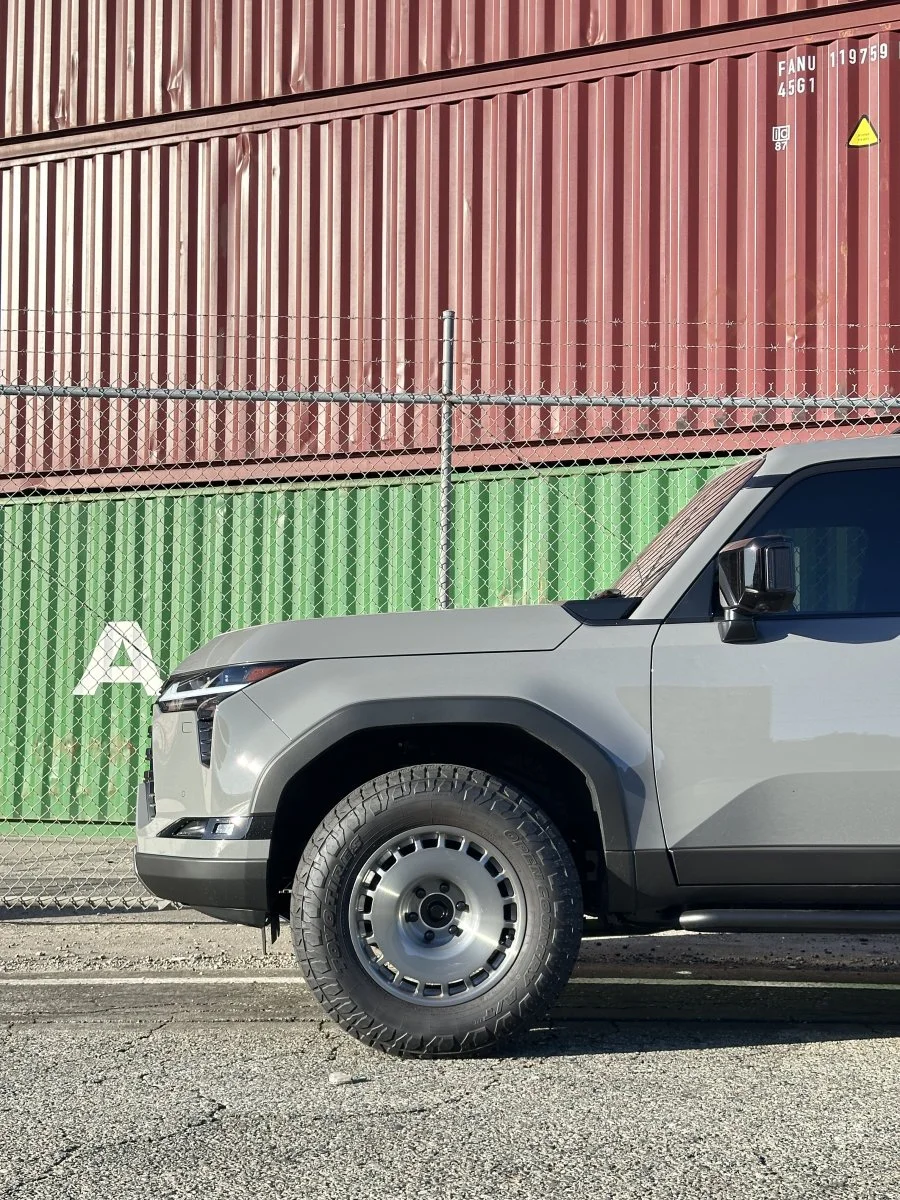

Last but not least, I upgraded to new wheels and tires! My previous setup with stock tires was fine, but I really wanted to go with 35s. I designed a new set of wheels with true beadlocks. This time, I’m running 18x8.5 with a +35 offset, paired with Toyo Open Country R/T 35x12.5R18 tires. I do experience slight rubbing when I reverse while turning the wheel to the left. I believe a slight caster adjustment should eliminate the rubbing issue.
I plan to take the car to Cleghorn OHV in the upcoming weeks as soon as my work schedule settles down. I will share more pictures and videos whenever I can.
Cheers, everyone, and happy holidays!

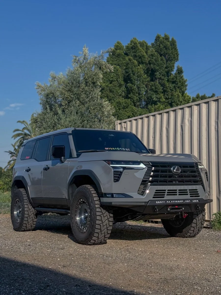

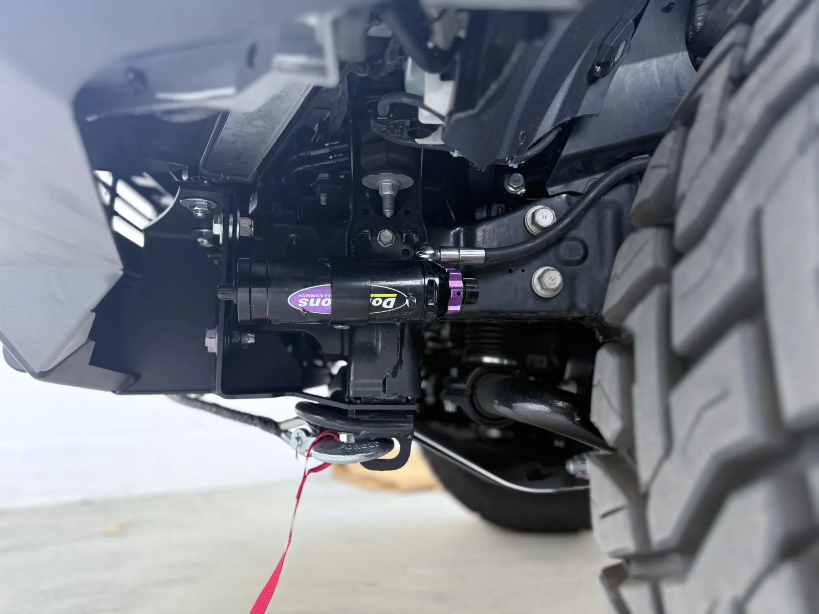

CBI Front Bumper arrived and installed Ryan @ Miyaki Motorports
At the same time, I also put in the Switch Pro / Baja Design single roll light bar/ Warn Evo 10s Winch
Arrived at Mikyaki Motorsports
Few installed Photos
Ryan helped me relocate the Dobinson MRR kit's reservoirs, and we also readjusted the ride height

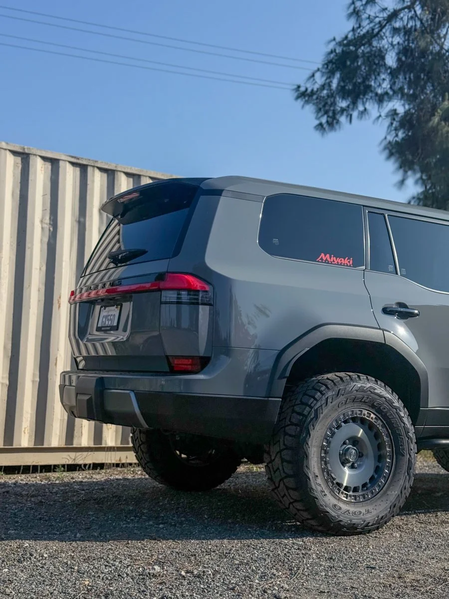

Rear bumper just arrived yesterday and I should have it installed by next week.
Feedback on the my current set up :
CBI Front Bumper -
The design is clean with a true OEM+ look. I’m not a fan of bulky metal bumpers, and this one perfectly matches the style I wanted to achieve for the GX. The quality is top-notch—welds are clean, and the powder coat finish is clearly high-end.
I’ve worked with other fabrication shops on my old 470 and 460, and surprisingly of them cut corners, though the lower price usually reflected that. With CBI, the price reflects the craftsmanship, and they delivered. I have zero complaints—the fitment is 100% spot-on and I expect the bumper will outlast the life of the car. This is one of my favorite mods to the GX.
Dobinson MRR 3 ways -
Here is my spec :
MRR 3 Ways
Front Shocks - MRA59-A440 - 2.5-3" Extended Travel
Front Coils - C59-820B - Black Finish ( For OEM look ) - 110-220lb Load
Rear Shocks - MRA59-A441
Rear Coils - C59-817VB - Black finish - 0-100lb Load
I’ve put about 5,000 miles on this kit since installation, and thanks to the 3-way adjustability, I’ve been able to fine-tune it to my liking. I always felt the stock suspension setup was a bit harsh for a factory ride. After installing the kit and spending many nights dialing it in, I finally got it to ride exactly how I want.
The height adjustability has been a huge plus—especially after adding the CBI bumper and winch. I was able to adjust the suspension to maintain a stance close to the OEM proportions, keeping the geometry as close to factory as possible. Customer support from Dobinson has also been excellent. They’ve been quick to respond to any concerns I’ve had.

RRW ( Relation Race Wheels ) Billet Upper Control Arm
After 5000 miles of driving. The UCA still looks brand new with the anodized finish. It performs great and looks bad ass
Gorgeous! Whatever wrap color you pick I would add that I really love the contrast black roof seen on some OT. Thanks for all this and future info!
Any wind noise with the visors? I had a pair of wellvisors on my gs350 and it had lots of wind noise on the driver side.
Did they say when they’ll be available for purchase?
Those window visors are pretty slick. I'm looking for something just like them....simple & unobtrusive. Here in AZ having your windows cracked a half inch or so but still covered is a great benefit. Let us know when you think they'll go on sale. Thank you.
I can't tell because the wind noise from the OEM roof rack is louder than any other noise. I just spoke with WellVisor, they said the first batch is still in production and they do not have an ETA when the official date for the release is. Once I hear any update from them, I will post it on here
Following for the Window Visor deets when their ready... I like to crack my windows but not a fan of the whistling (although I am impressed there isn't much buffeting in the 550). I am not a fan of the type that use sticky tape and am on the hunt for these for my 550.

Funny I was a fan of stick-on, which is what I had on the GX460. But after having this set on the 550, I like how settled the visors look. I will keep you posted whenever WellVisor provides more info on the release date.

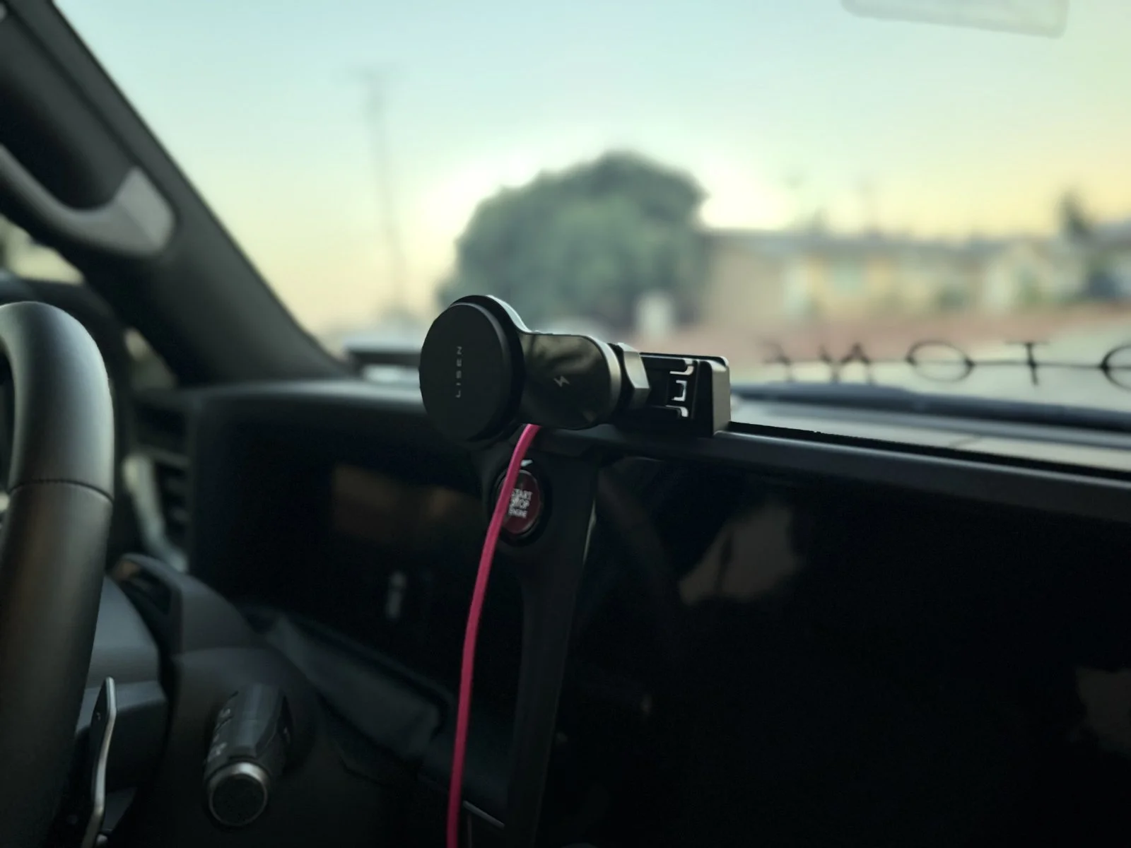

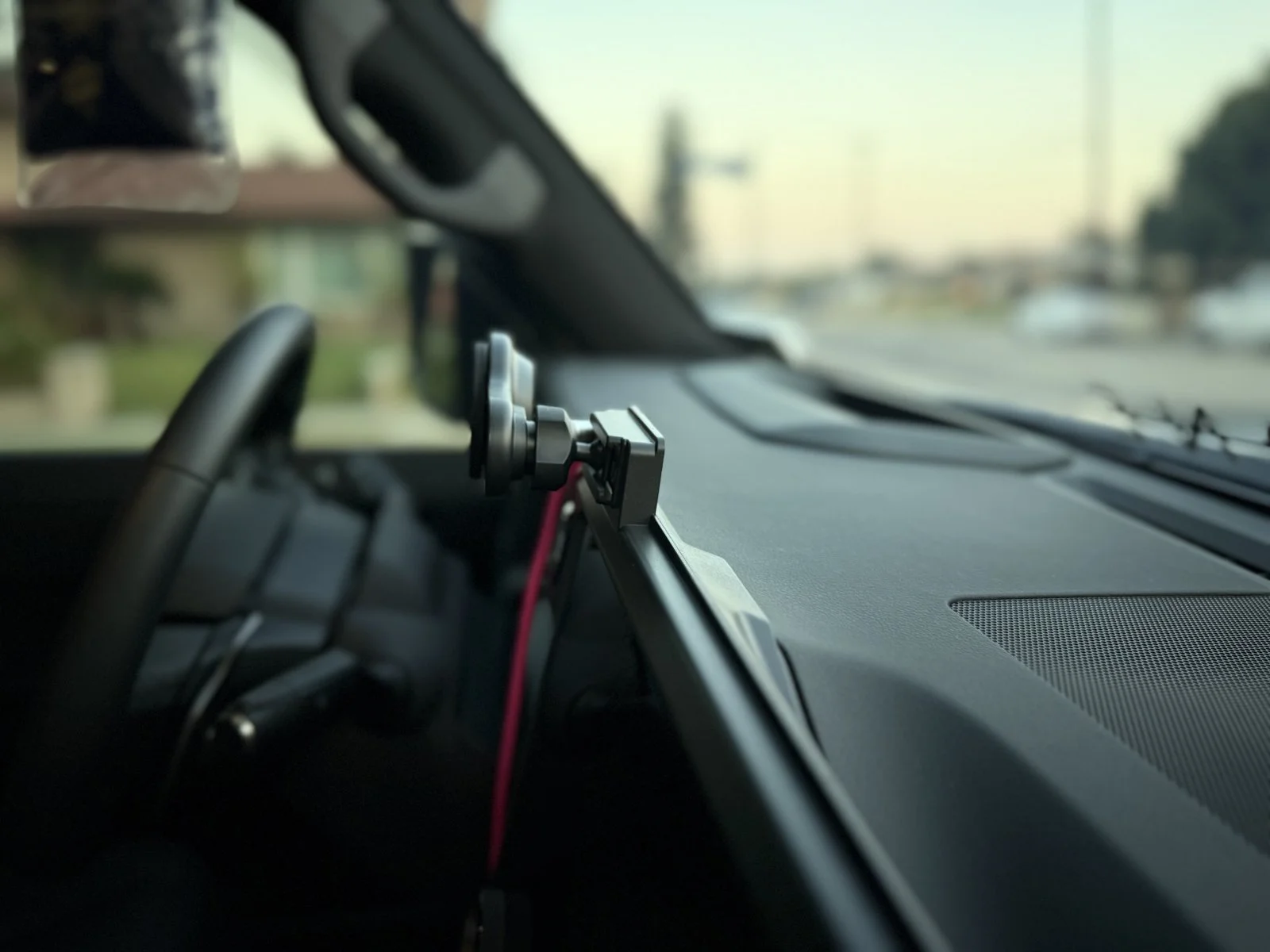

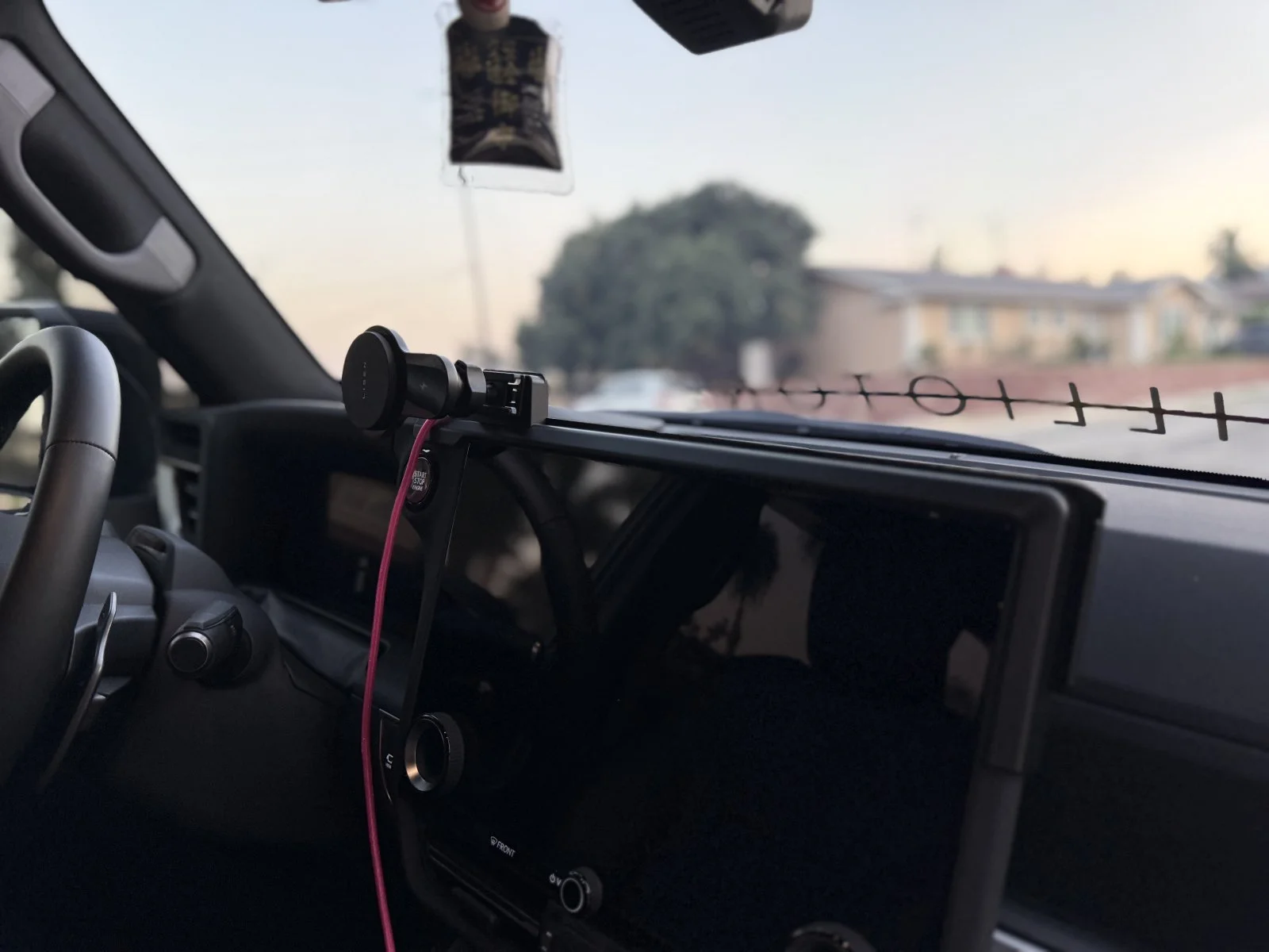

Just received this phone holder in the mail today. I will post a review with installation photos once the Magsafe charger arrives from Amazon tomorrow.
No doubt. Just pull the top rack off and stick it in the garage. Takes 30 minutes and it quiet as a mouse after that.

The GX model specific phone holder has been installed along with a MagSafe wireless charger. I would rate this item 7 out of 10. The installation was straightforward - it doubleside tapped and wraps around the top part of the monitor. My only complaint is that the mounting point from the bracket and MagSafe mount is not sturdy enough. The phone shakes on light, uneven roads.

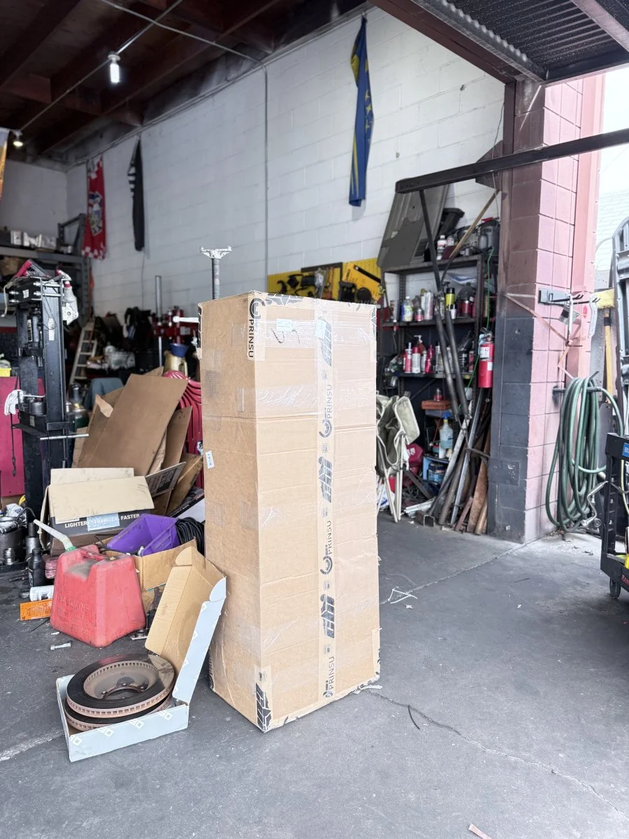

Look what arrived !!!

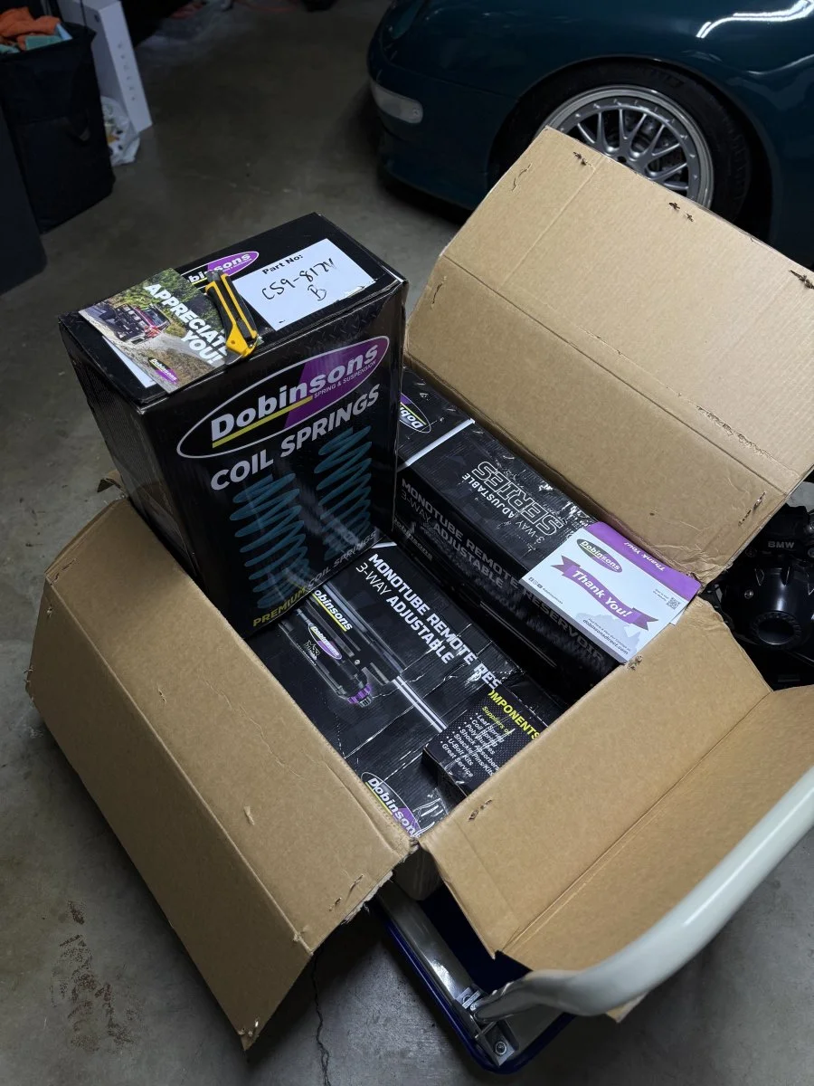

Dobinson MRR 3 Ways Arrived
RRW Billet UCA Arrived ( not picture )
If work allows, I should have the lift kit on by next week.
